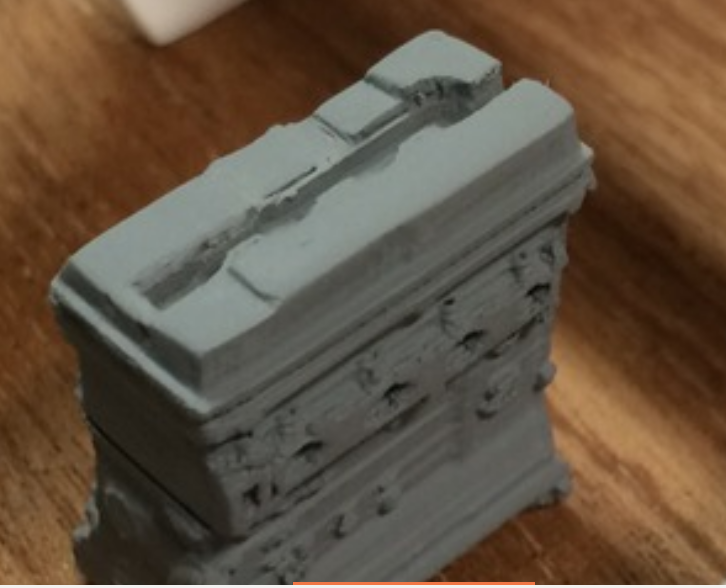

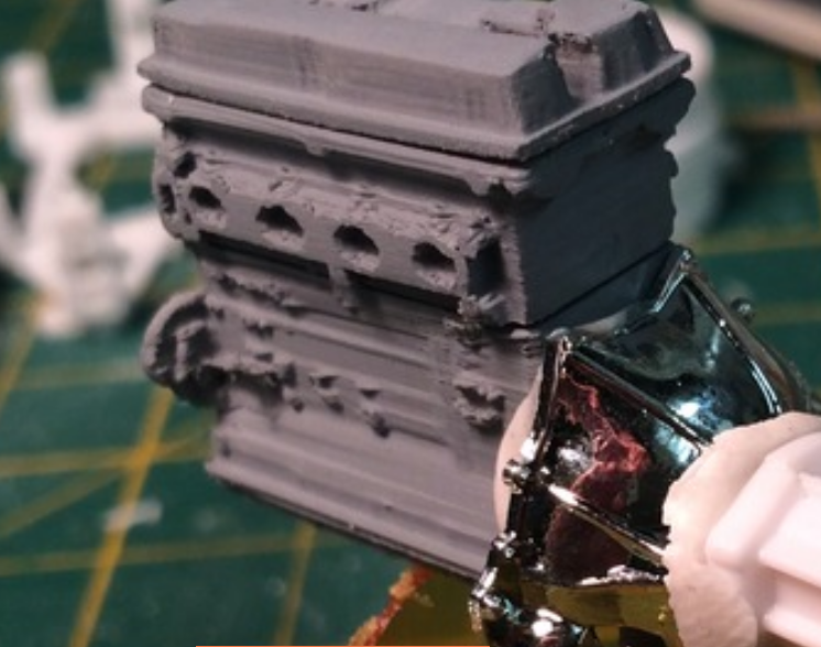

my66s55 Posted September 17, 2015 Share Posted September 17, 2015 (edited) This 3d printer does not print anything acceptable to my standards, or the vast majority of members on this board. Why do I say this? Look for yourself. Closeups of the op's print. If these are the results you want from a 3d printer, go ahead and waist your money. Me, I know better. Check me out. Follow my home 3d printed builds: http://www.modelcarsmag.com/forums/topic/101922-1935-lasalle-convertible-coupe-3d-printed-at-home-aug-30/ Edited September 17, 2015 by my66s55 Quote Link to comment Share on other sites More sharing options...

Impalow Posted September 18, 2015 Author Share Posted September 18, 2015 This 3d printer does not print anything acceptable to my standards, or the vast majority of members on this board. Why do I say this? Look for yourself. Closeups of the op's print. If these are the results you want from a 3d printer, go ahead and waist your money. Me, I know better. Check me out. Follow my home 3d printed builds: http://www.modelcarsmag.com/forums/topic/101922-1935-lasalle-convertible-coupe-3d-printed-at-home-aug-30/ Im not quite sure how to respond to this tactfully. I will say i have been following your builds, and your knowledge of 3d printing is one of the reasons I didn't purchase a much much more expensive printer at an earlier date. For that I thank you... I would not have been at all satisfied with that purchase. Now to me the first photo is decent... granted it still needs cleanup, some edges filed... hand work..etc.. but once that is done and the intake is in place, it is passable as a kit part. If you want a printer you can pull your item off the bed and paint and take to a your local model show.... this is not the printer for you... and will indeed be a "waste of money" This may be the printer for you if: want to make complex shapes that would be impossible, or incredibly labor intensive in styrene (not this engine, in all honestly I should have just scratch-built it) realize small details will need to be added back in by hand after the print is complete realize some sanding and filling will be necessary to remove grow marks. know how to 3d model are okay with 85% of your prints ending up in the scrap bin have an extreme amount of patience with technology have little to no knowledge of 3d printing want to spend under 400.00 Like any piece of technology its learning its limitations and then working around them to get the best results. Would i buy another one? probably not is it fun to play with? Oh yeah Will I keep trying to make model parts until I find its niche in my workshop? Yup... Quote Link to comment Share on other sites More sharing options...
my66s55 Posted September 18, 2015 Share Posted September 18, 2015 (edited) Thank you Eric, you've made my day. What I'm about to say is meant to be taken in a positive, kindly way and not harsh or negative . My post was not intentionally directed at you. From your opening post on, you never presented this 3d print to be anything other than what it is. My concern was that it seemed that others were seeing what they wanted to see and not reality. I was excited to see that someone had bought a 3d printer to use for model car parts printing. One of the major reasons for my w.i.p. 3d printing posts is to encourage others to get involved. Otherwise, I would just complete the model as some others have and say-here it is, I 3d printed this at home. The experience you gain from working with your printer will carry thru into future, more advanced printing machines. Now, as to your print. Take note on the 35 LaSalle post, I state, at least I think I did, that to get the best print with a filament printer, you need to break the file down into pieces. Teach yourself the best orientation of the part on the build platform. Learn when and where to use support material. You will see a steady improvement in your prints. Good luck, happy 3d printing. Edited September 18, 2015 by my66s55 Quote Link to comment Share on other sites More sharing options...
Lowlife ! ! Posted September 18, 2015 Share Posted September 18, 2015 For that sort of money I still think the engine block is great ! Sure it needs a bit of a clean up, but its also way quicker and more accurate than scratch building it. Im sure there are better printers out there that can produce something perfect, more expensive than most ( I imagine ...) modellers are willing to spend on something just to improve their models....This seems a good, reasonably priced printer, which with a bit of practice adds to the fun of building. Im not having a dig at anyone here, just saying I think its a great idea if you wanna try it yourself ! Quote Link to comment Share on other sites More sharing options...

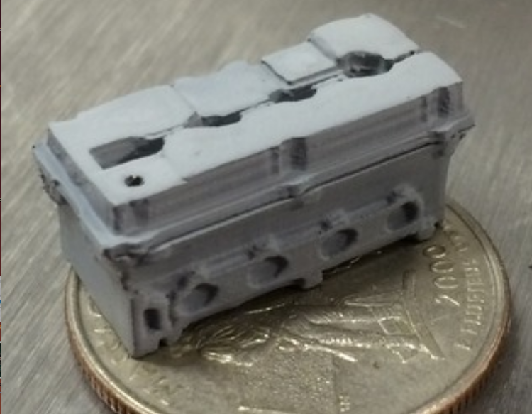

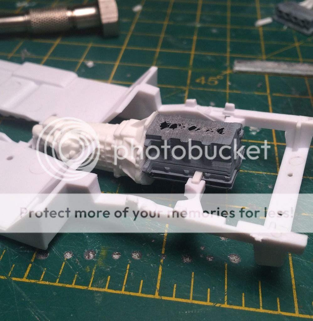

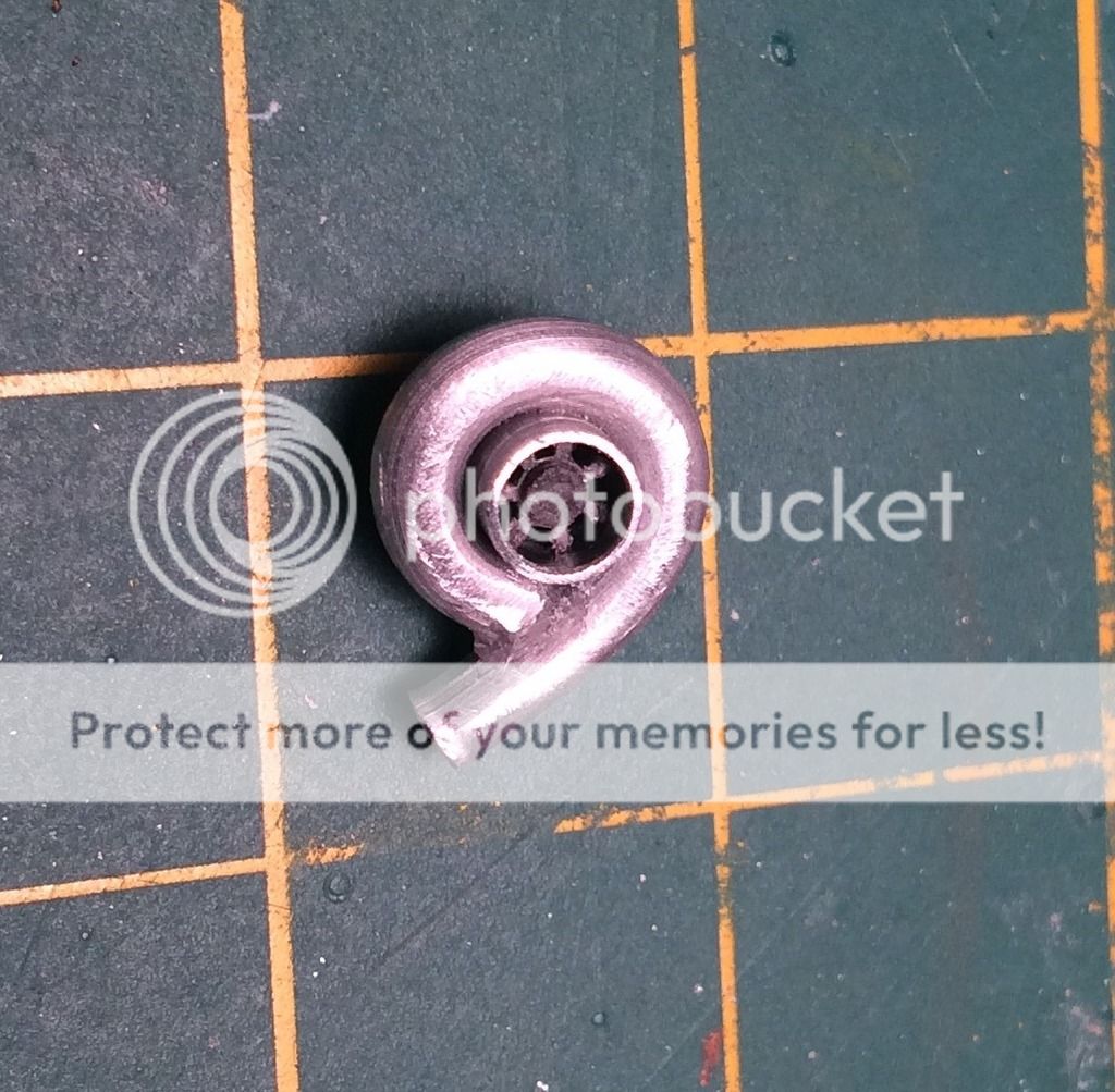

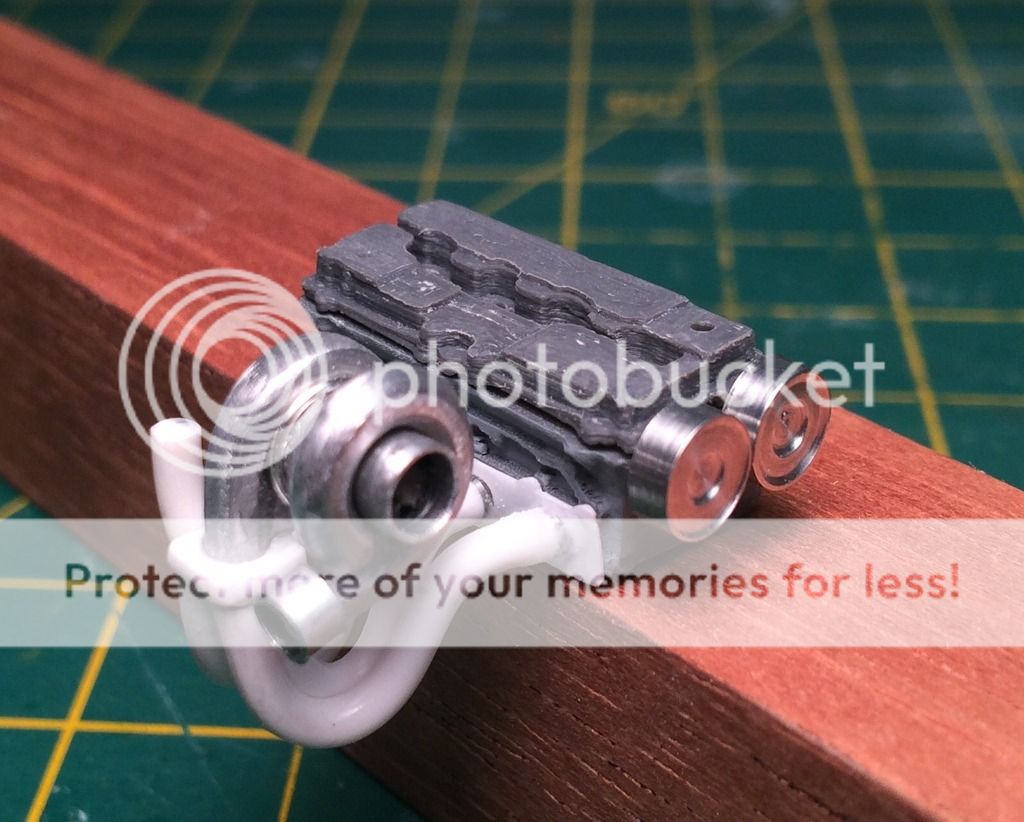

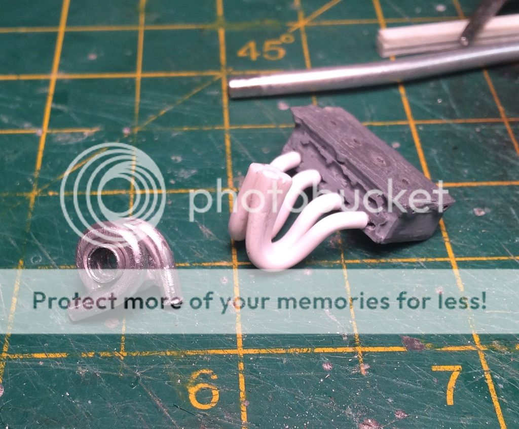

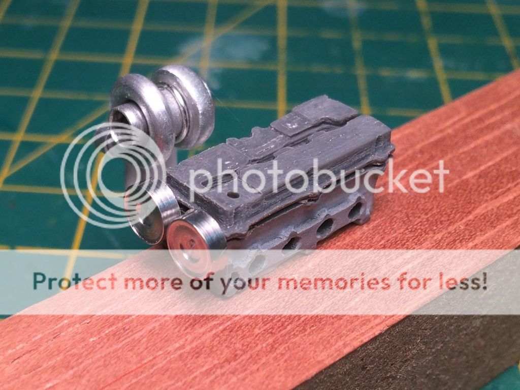

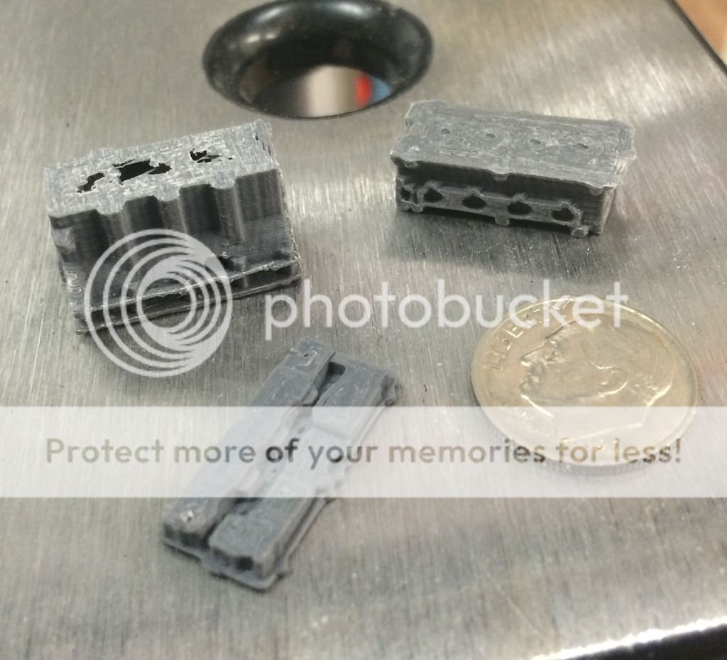

Impalow Posted January 4, 2016 Author Share Posted January 4, 2016 So big update here... I realized I am shooting for a march deadline on this bad boy, so i better get moving. Finally had some success printing ABS on my printer, this material sands/drills so much cleaner and easier... it also printed much "crisper" once I got things dialed in. again... not perfect but definitely workable... these are the prints straight off the printer. once i had a good block and head for mockup, I started working out the mounting and accessories. MAD resin 6-speed transmission mates up pretty nice, Im still going to make an adapter plate for this because the 1:1 engine would not bolt up to the T-56 Scratched the turbo manifold and turbo. 3/32 aluminum rod wrapped around some tube used a tyco HO slot car pinon as a turbo impeller Added some more detail to the turbo, band clamps and flanges.. turned cam gears on the lathe, and cut the exhaust manifold flange on the cutter. Picked up an Aoshima Liberty Walk Skyline and pilfered the flares off it. This kit:http://www.amazon.com/Liberty-No-04-Works-Hakosuka-Aoshima/dp/B00Z8G1QWW/ref=sr_1_5?srs=7759734011&ie=UTF8&qid=1451916066&sr=8-5&keywords=works Finally I decided on color the option... Pearl gray with gunmetal/candy blue wheels similar to whats below. Still a fair amount of carbon fiber, but keeping with modern mopar blue/gray color scheme just feels right. Quote Link to comment Share on other sites More sharing options...

bobthehobbyguy Posted January 6, 2016 Share Posted January 6, 2016 Killer project. Huge improvement on your 3d printed parts. Looking forward to seeing more. Quote Link to comment Share on other sites More sharing options...
Ace-Garageguy Posted January 6, 2016 Share Posted January 6, 2016 Very interesting thread. I've seen the cutters in action before, and you've done a fine job showing the potential. Nice work. Your print quality is certainly improving too. The block as-installed in the chassis is certainly to the minor-cleanup-and-primer-to-be-perfect point. Quote Link to comment Share on other sites More sharing options...
