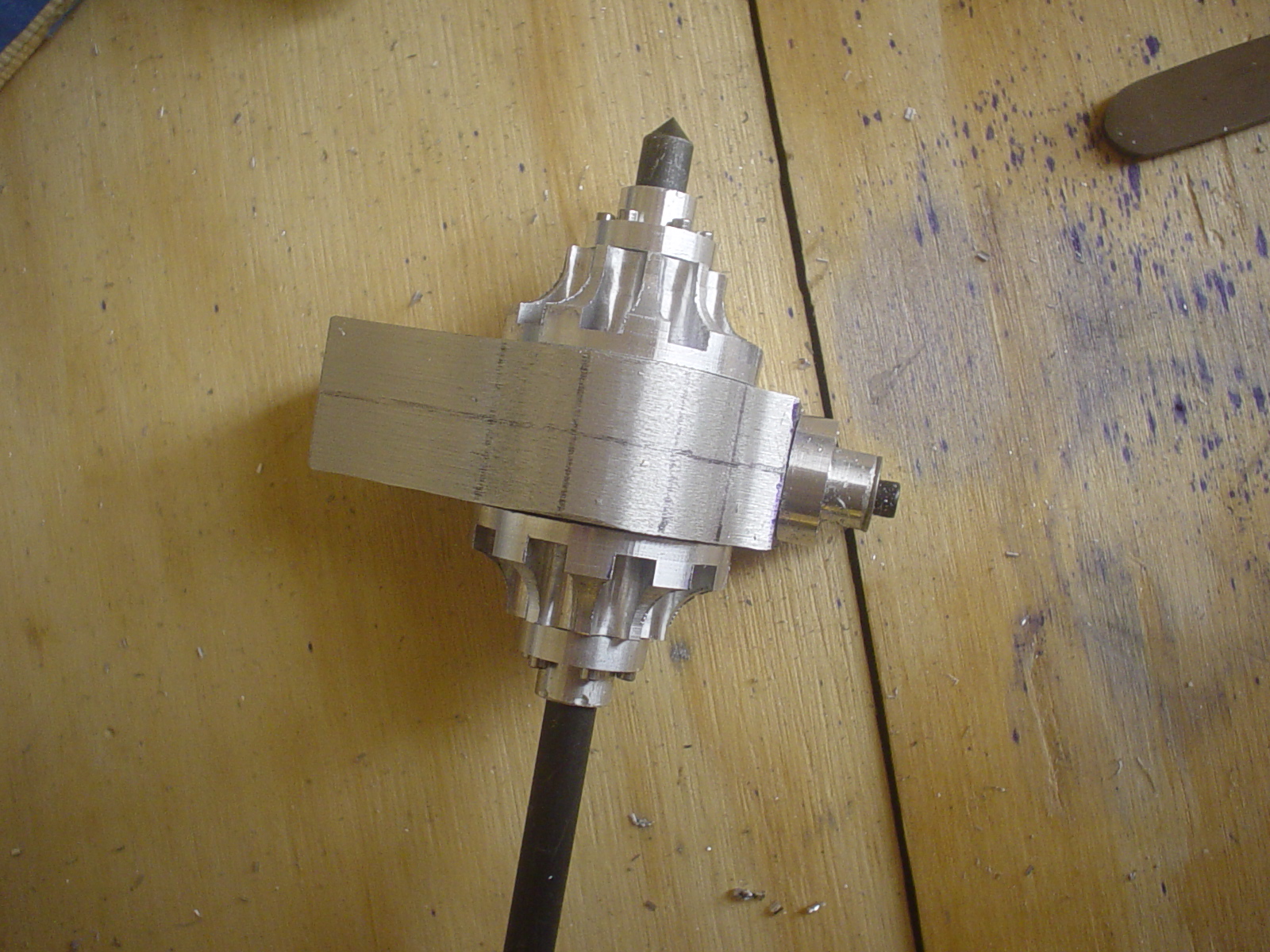

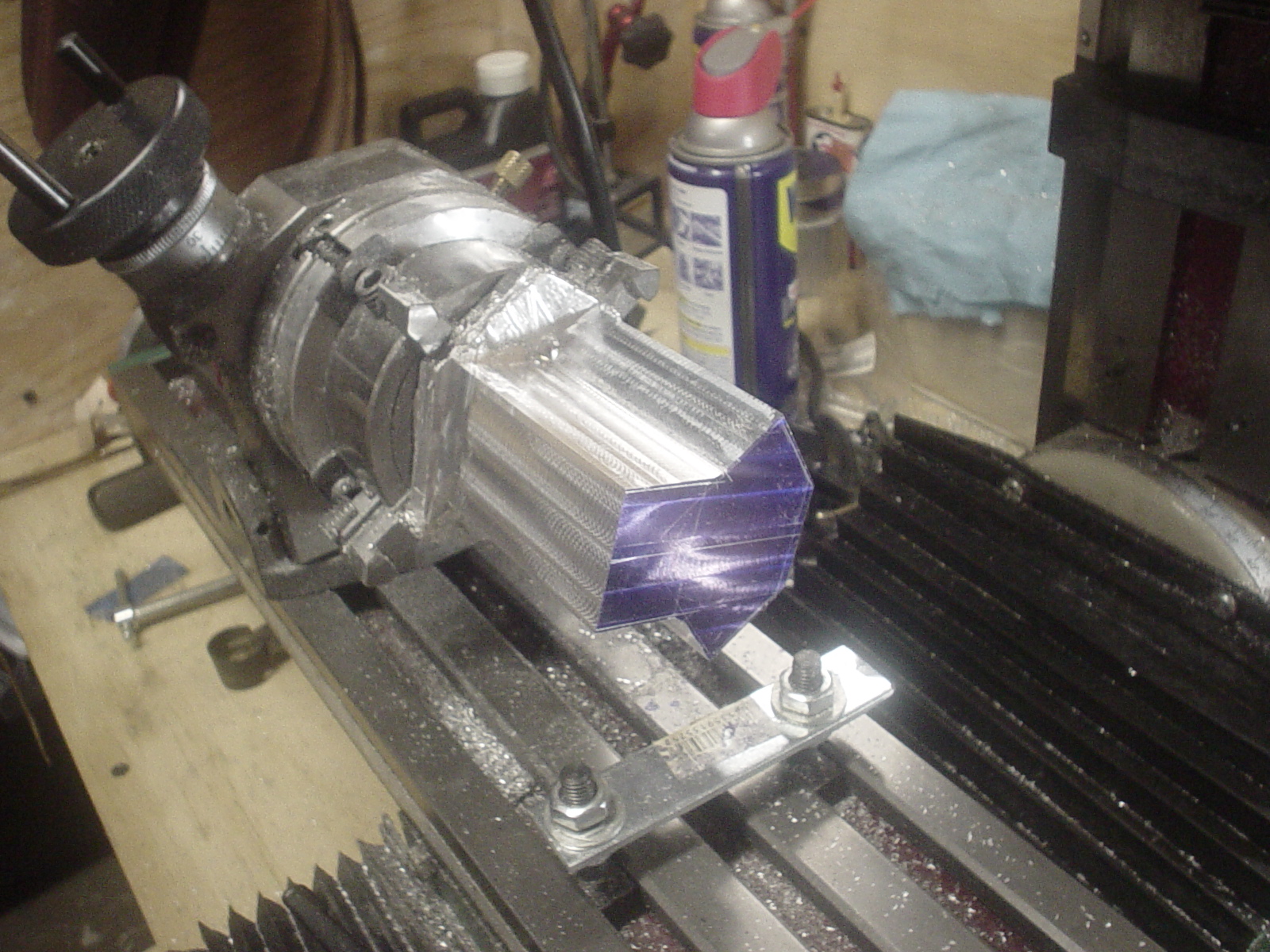

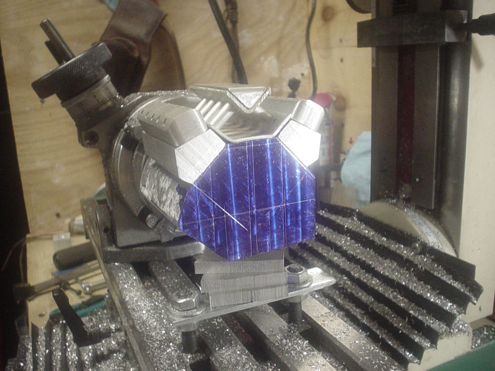

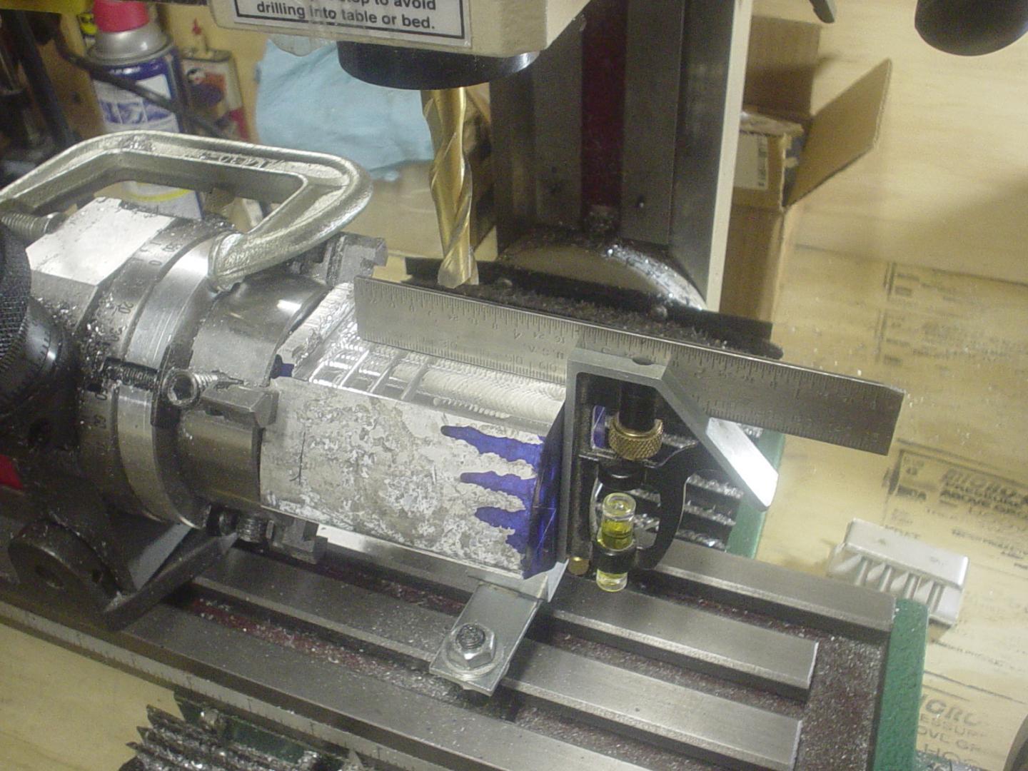

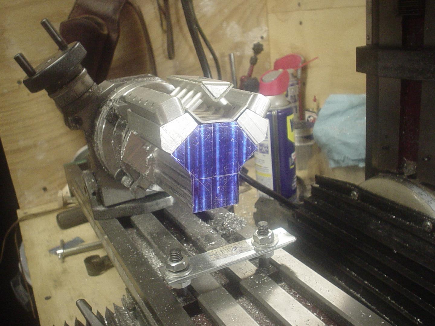

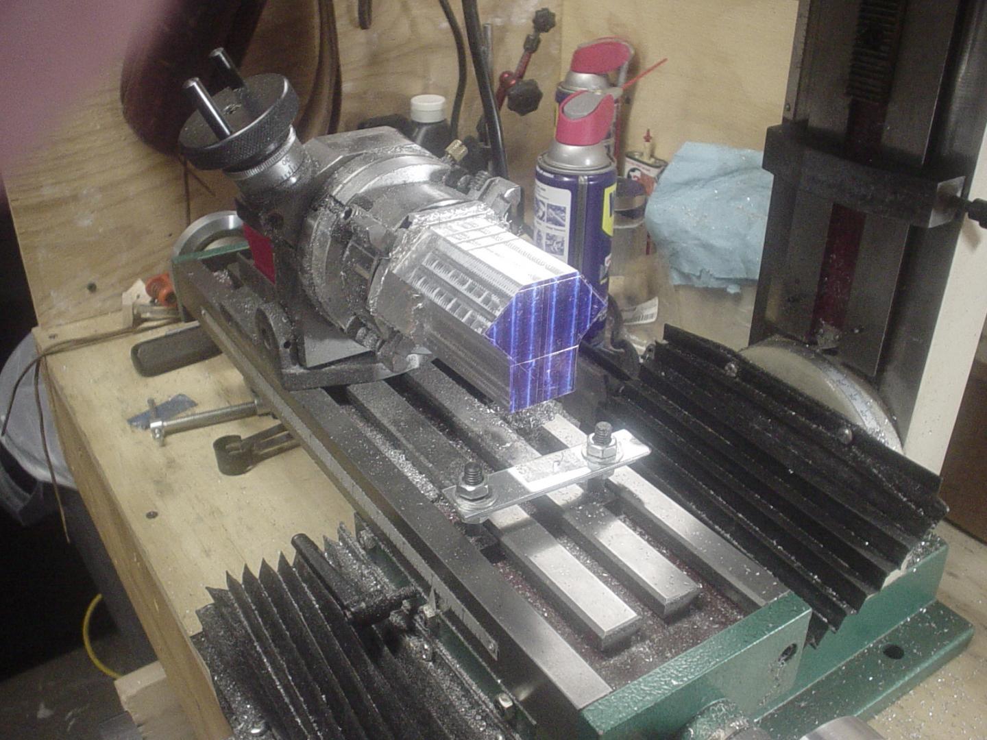

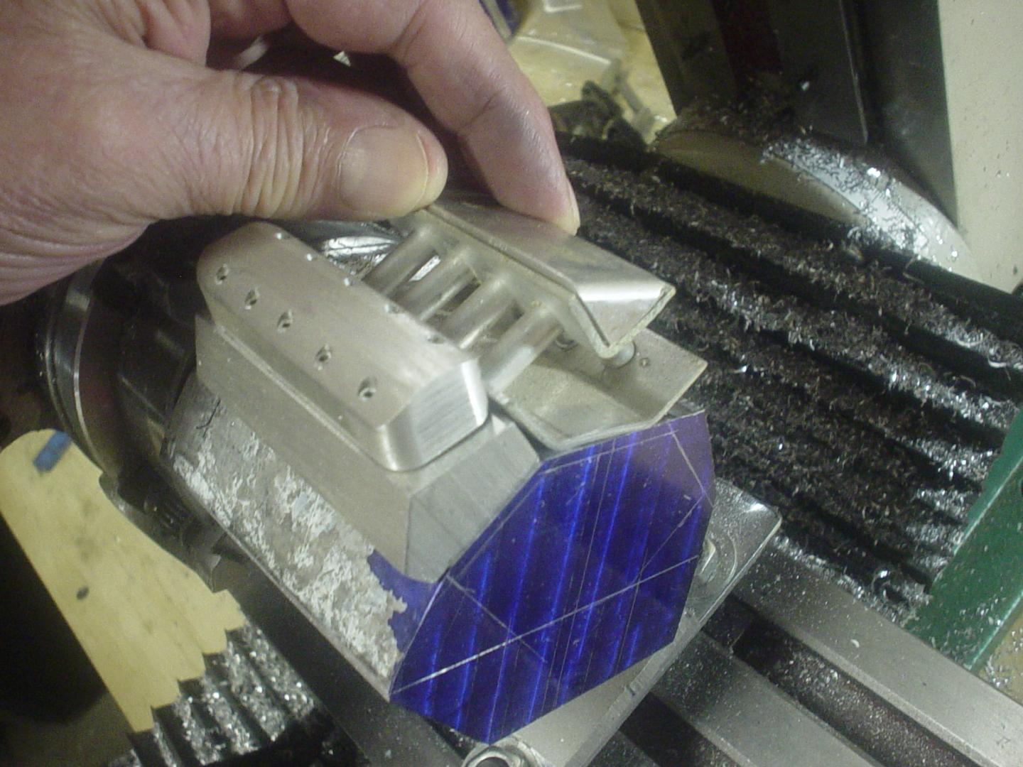

Decided to stop work on the top surface & rough in the cyl. banks.
It's square between the face & top & that makes me smile.
Rotated the block 45 deg with the table & roughed in a bank.
Start mocking parts together while I still have some wiggle room.  I have hours invested in several pieces that were built to fit the plastic kit block...manipulate the work on this one, so that it all comes together with good fit.
machshp125.thumb.JPG.93cd89551b4627151b7machshp126.thumb.JPG.bbca04c1ee107ce24bcmachshp128.thumb.JPG.4e3a52e9bc25c5e318b

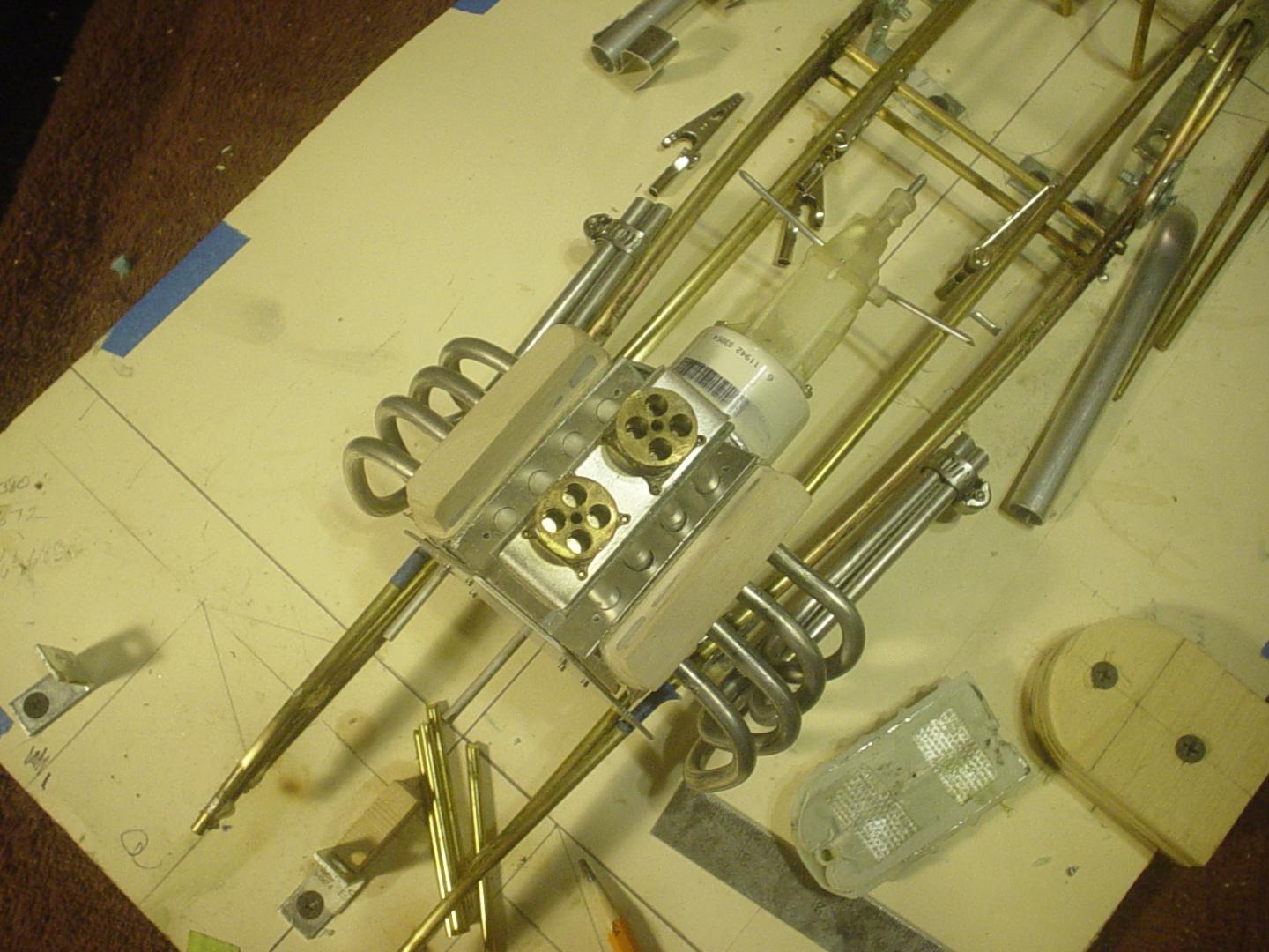

The intake manifold doesn't match the head angle very well on the near side.  When I look at it, seems like it may be a bending error on the manifold base plate.  Get the angle finder out & check it to know.  Also, the heads were shaped free hand on the belt sander & could easily be some slight angular differences between the two.

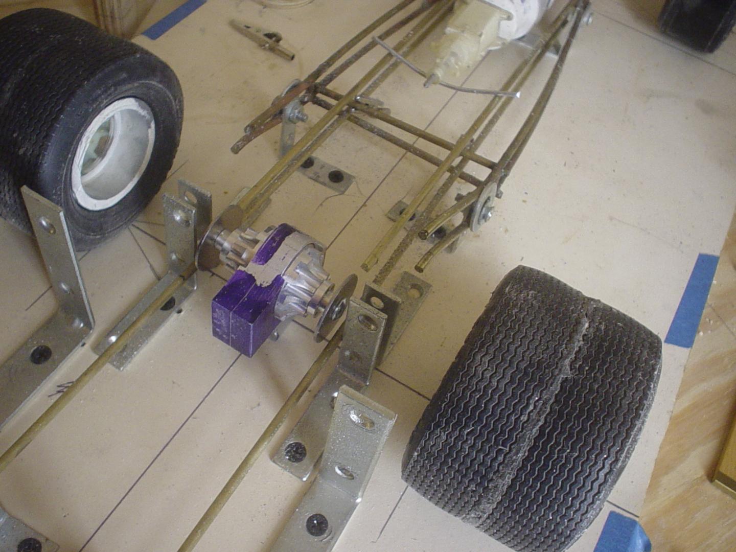

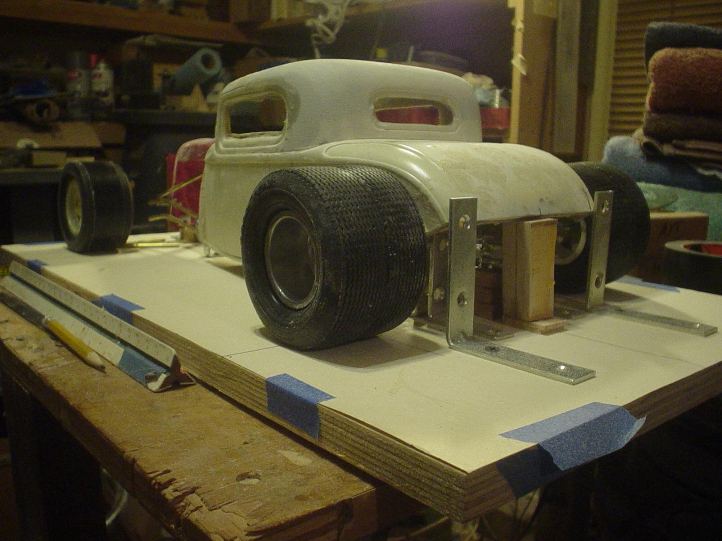

Since I'm reviving this thread...& since the thread no longer has pics of earlier work, thought I'd repost a few shots that will kind of reestablish the basic stylistic concept for the build.
It's a full tube frame, full cage car with double wishbone suspension front & rear.  The suspension is formula 1 inspired, as I really dig how flatly they skate through the corners.  However, much of the science that I'm studying for the build is coming from the roadrace stock car type builds, in that the engines are front mounted vs mid engine.  Think NASCAR at Riverside raceway, if you will.  Corner cars.

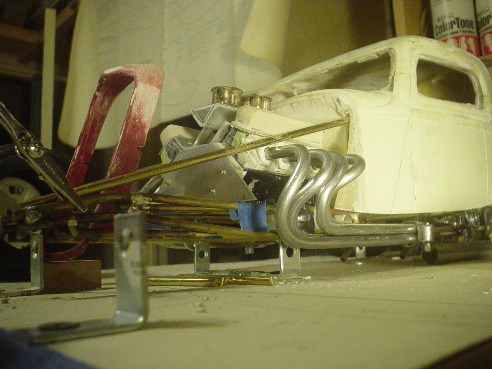

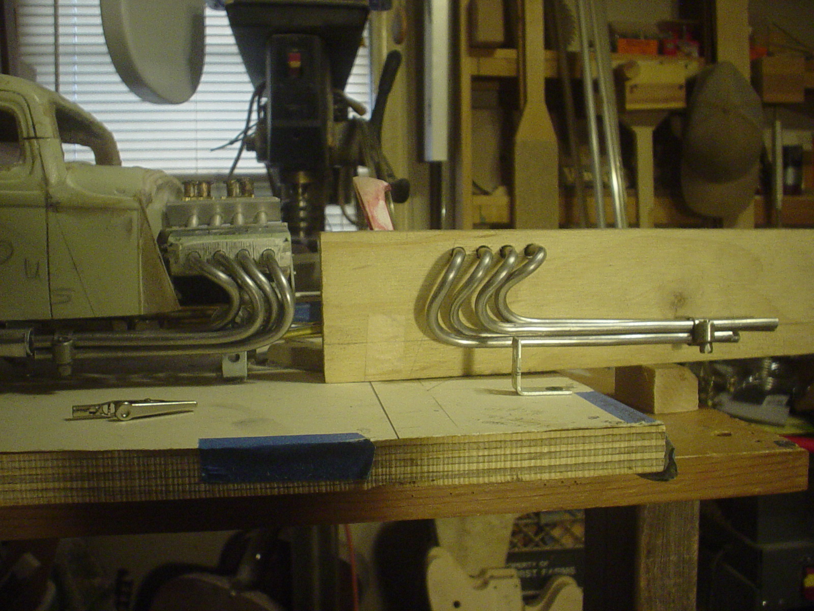

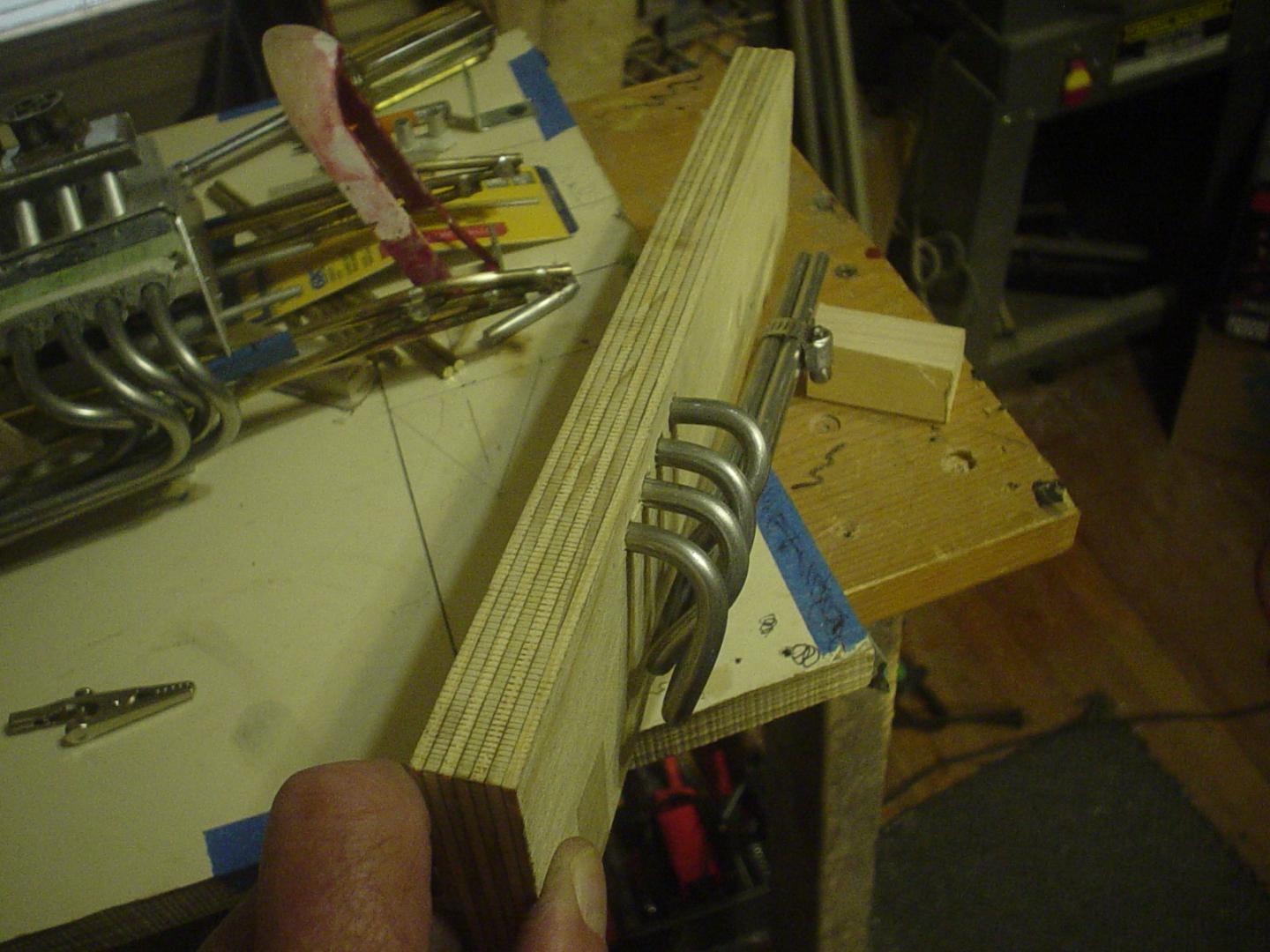

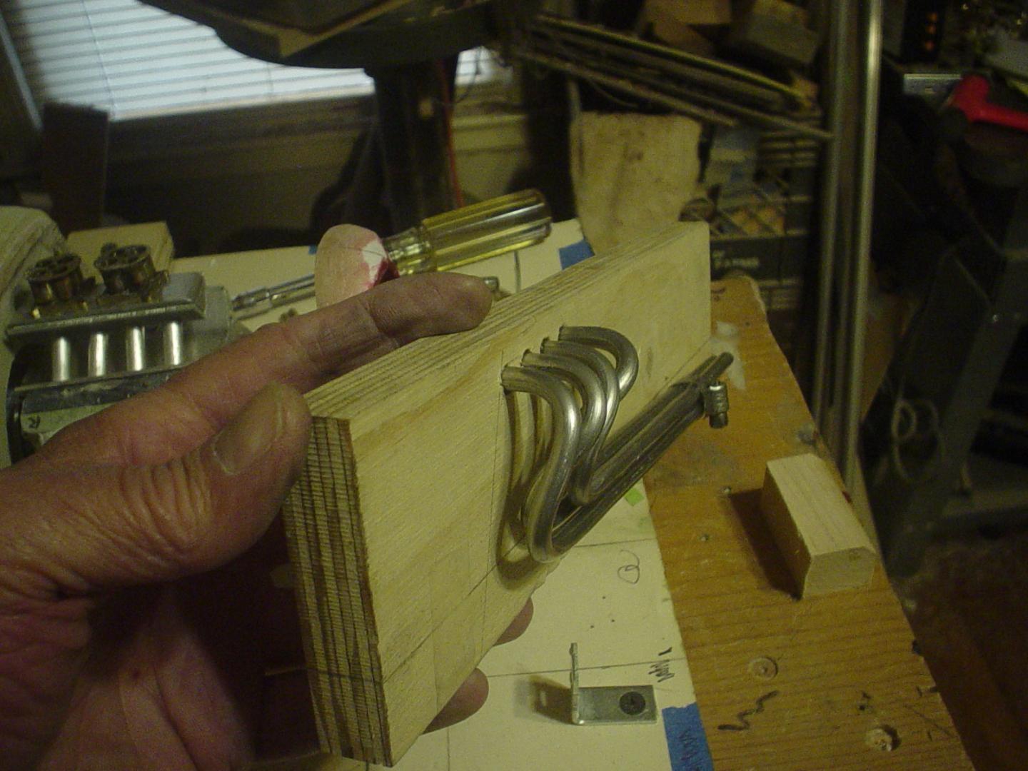

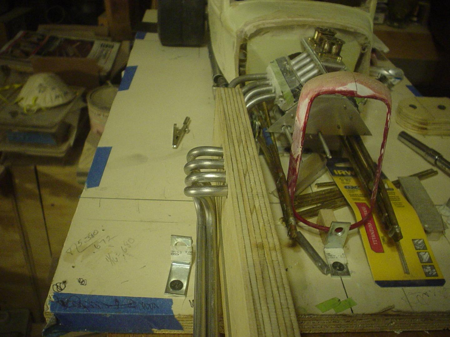

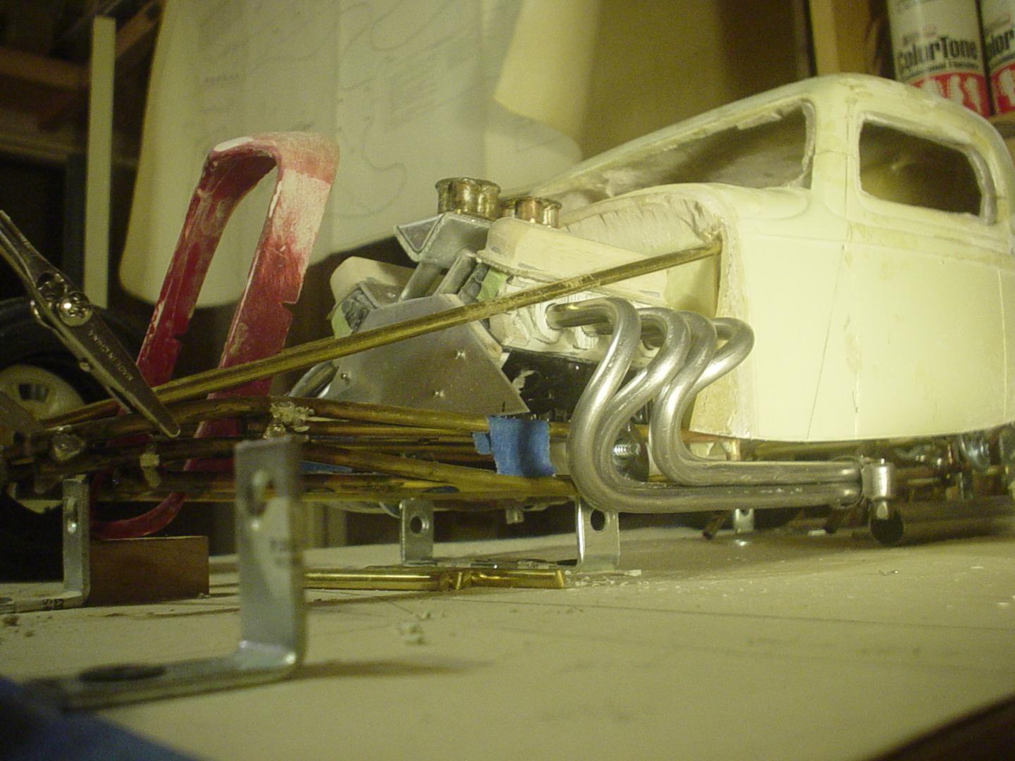

Took a section off of the lower body sides.  Want to see the sides of the frame & still keep overall height to a minimum. Also wanted the body sides above the header package.
Headers on the car.autocrosscoupe392.thumb.JPG.168db6a8105cautocrosscoupe401.thumb.JPG.c5cff709925cautocrosscoupe402.thumb.JPG.76579180851eautocrosscoupe403.thumb.JPG.e5367d0df7a5autocrosscoupe404.thumb.JPG.7a2fa70db5c4

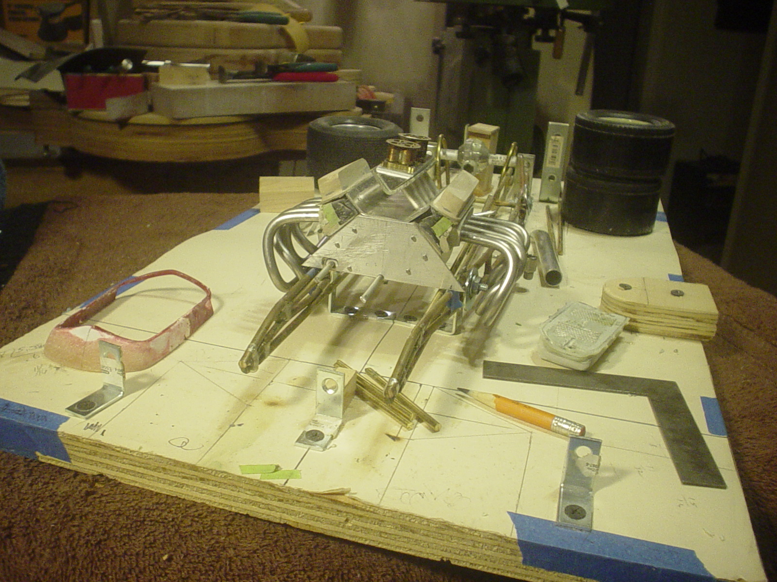

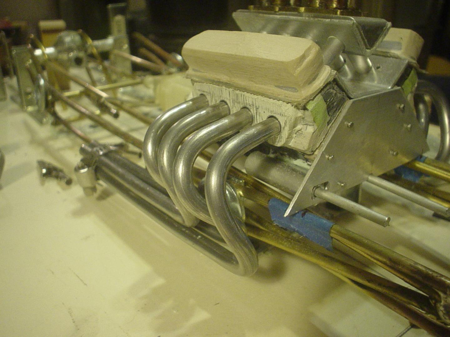

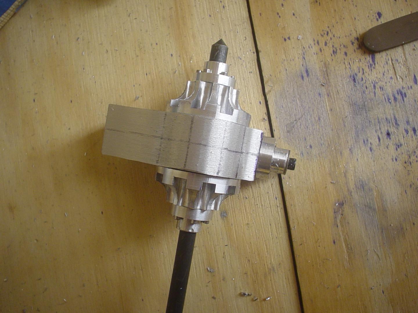

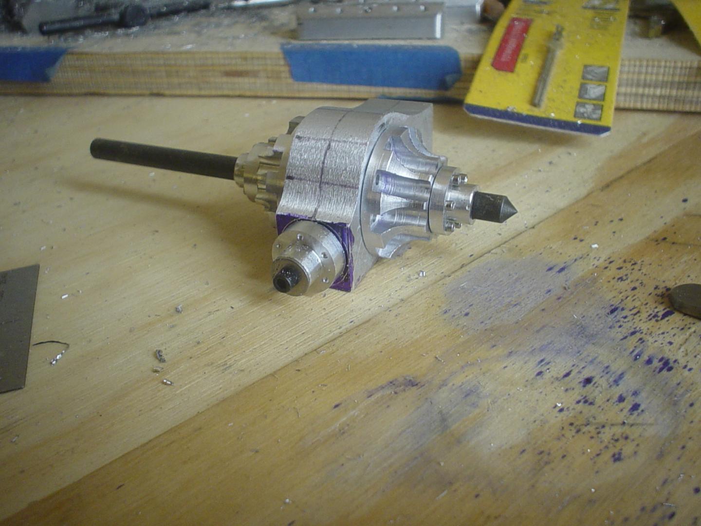

Finished up the lower portion of the block profile.  Start fitting it together.
The crankcase area is way too deep...going to cut the oil pan in it & then separate.
I like the design & vibe of the intake manifold but am not happy with the execution.
machshp130.thumb.JPG.2e38be18f82e2958674machshp131.thumb.JPG.0fd25ca13585a7579dcmachshp132.thumb.JPG.3c7947d4f804b68f2de

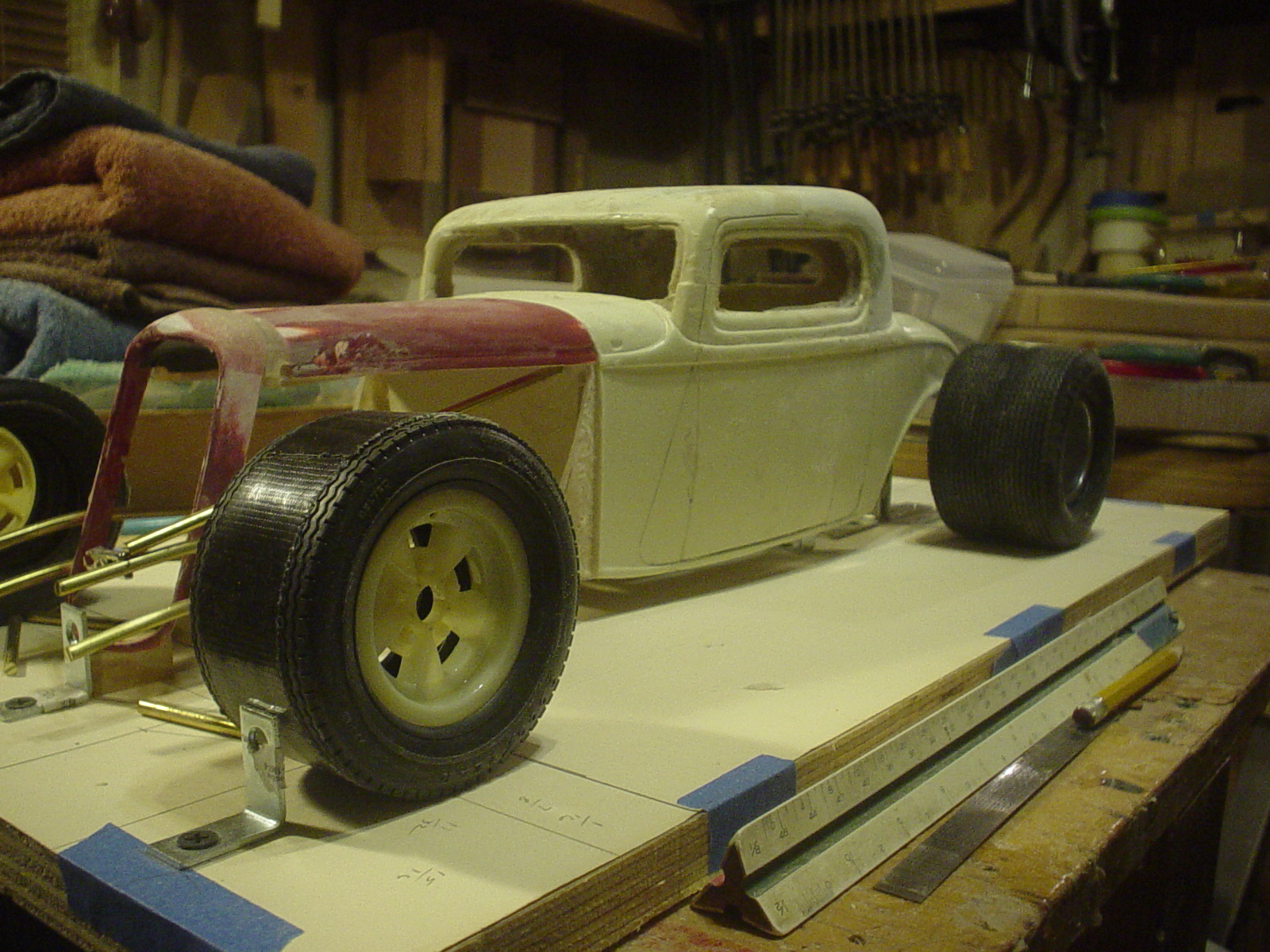

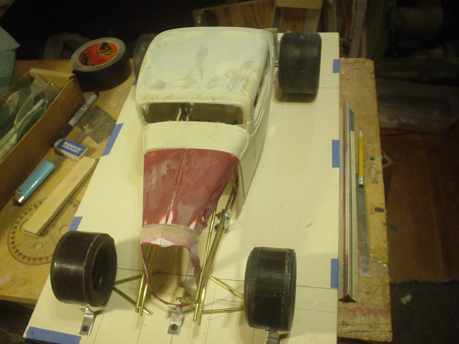

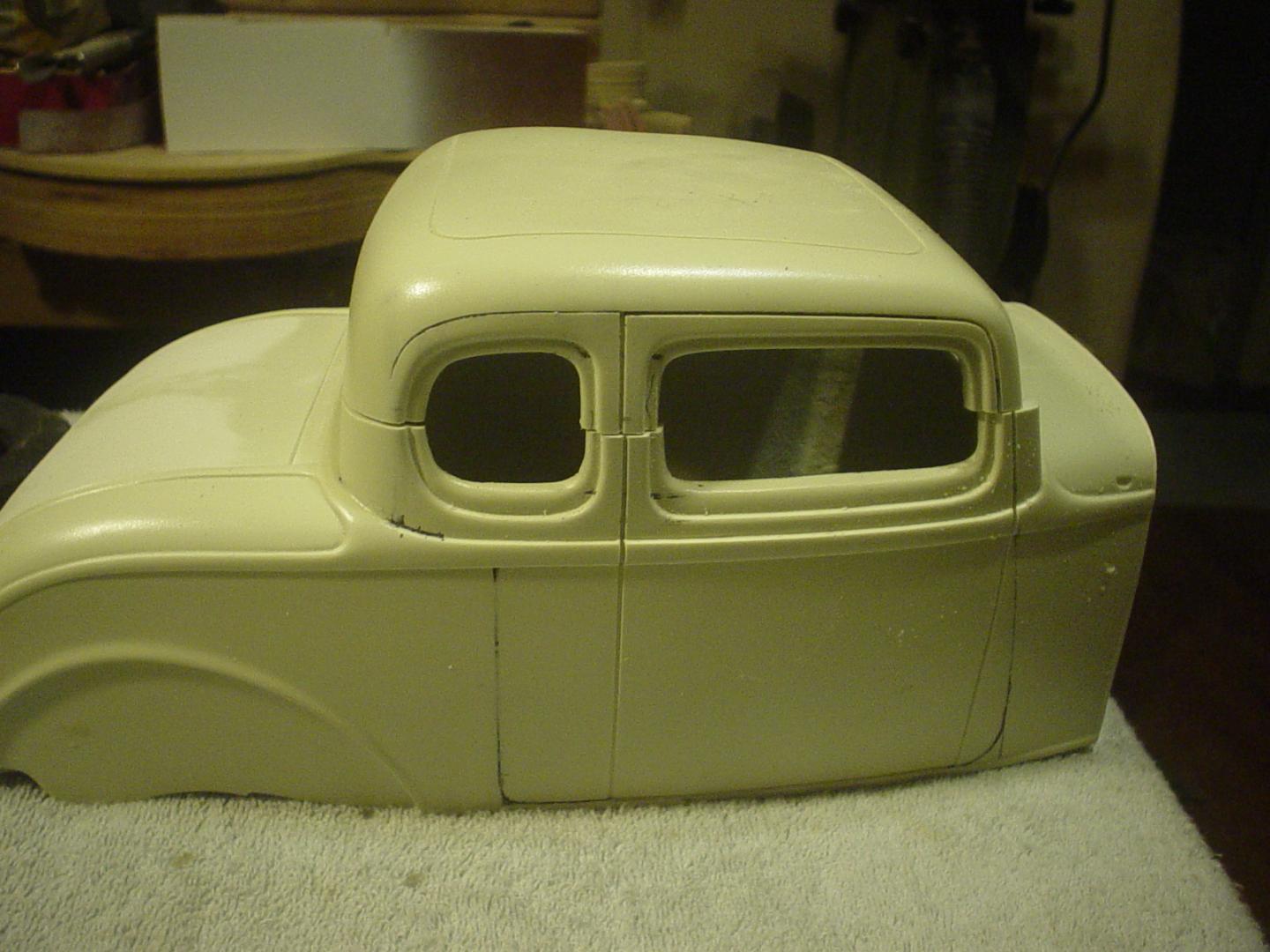

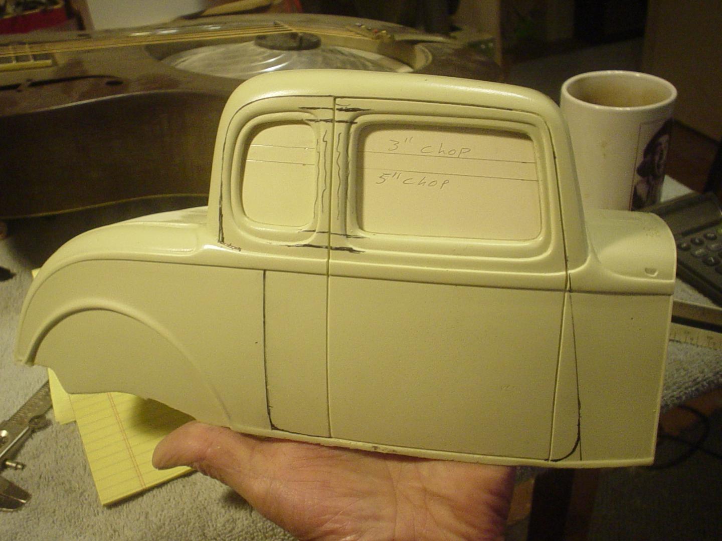

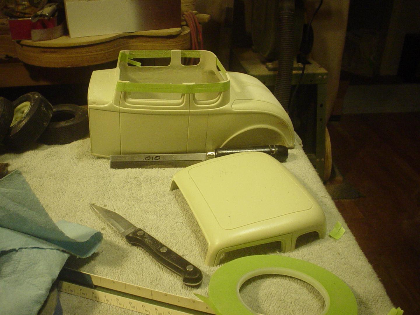

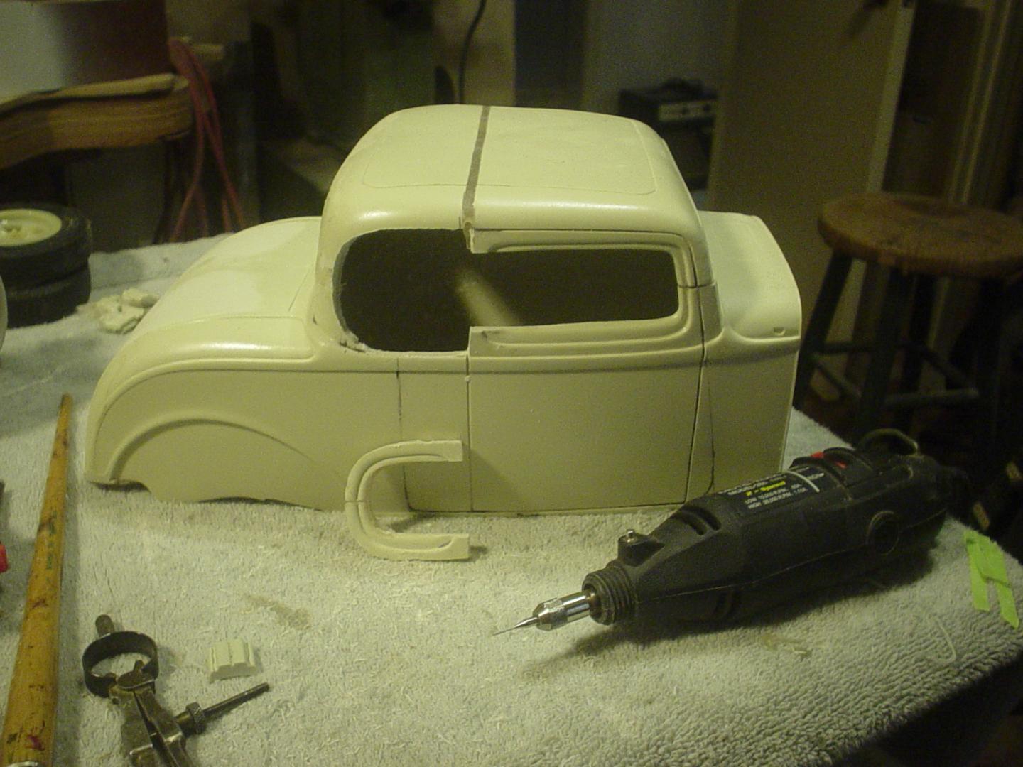

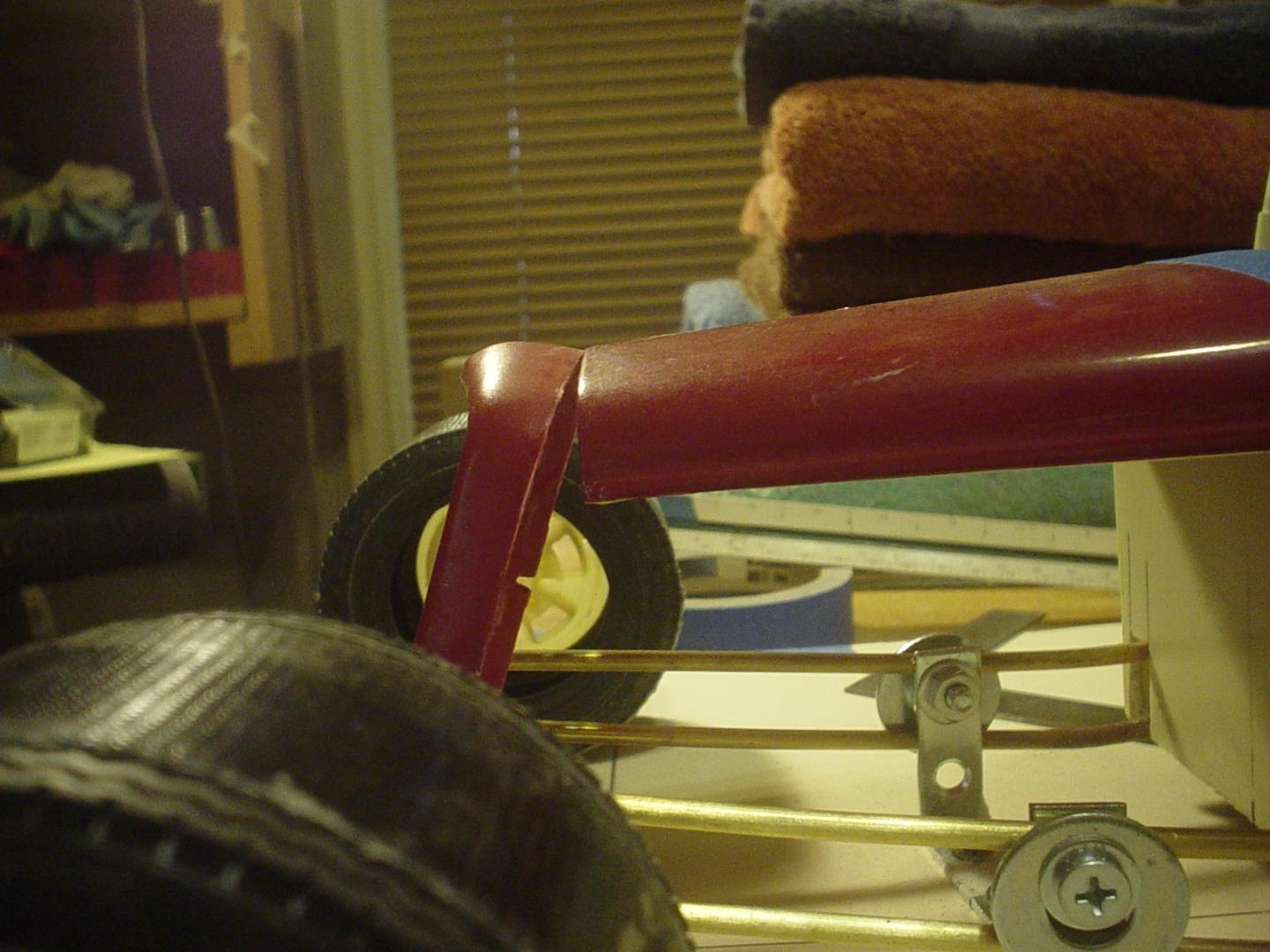

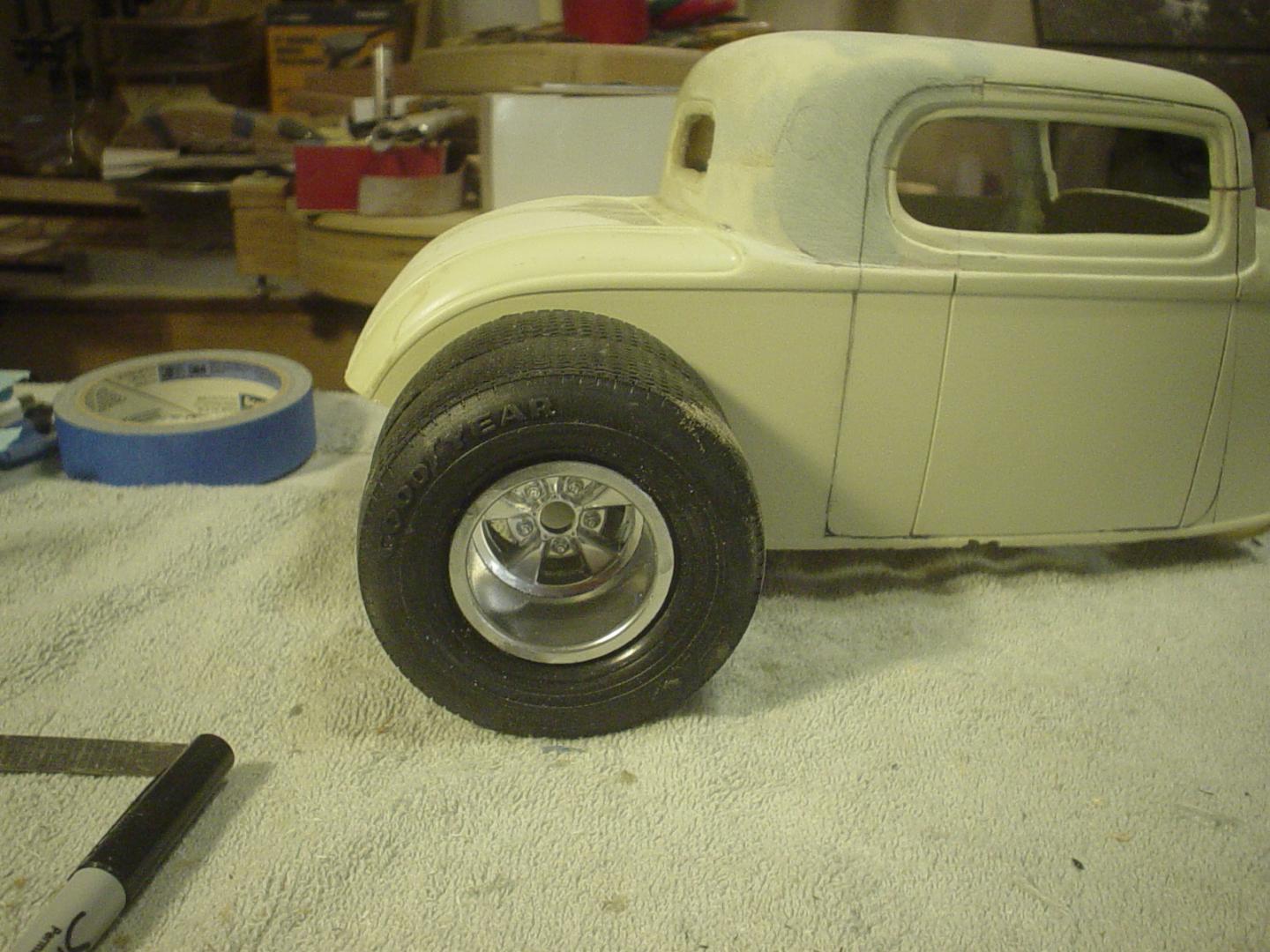

It was originally a 5w but I like 3w bodies better so decided to do the mod & bring the top down as well.
autocrosscoupe26.thumb.JPG.3ea69348bc77a
autocrosscoupe31.thumb.JPG.0489e4c830b11
autocrosscoupe33.thumb.JPG.5f0d2f9daa87e
autocrosscoupe47.thumb.JPG.9fe5331406af8
autocrosscoupe49.thumb.JPG.e414b619c5d63
autocrosscoupe54.thumb.JPG.fb6a88ef41e20

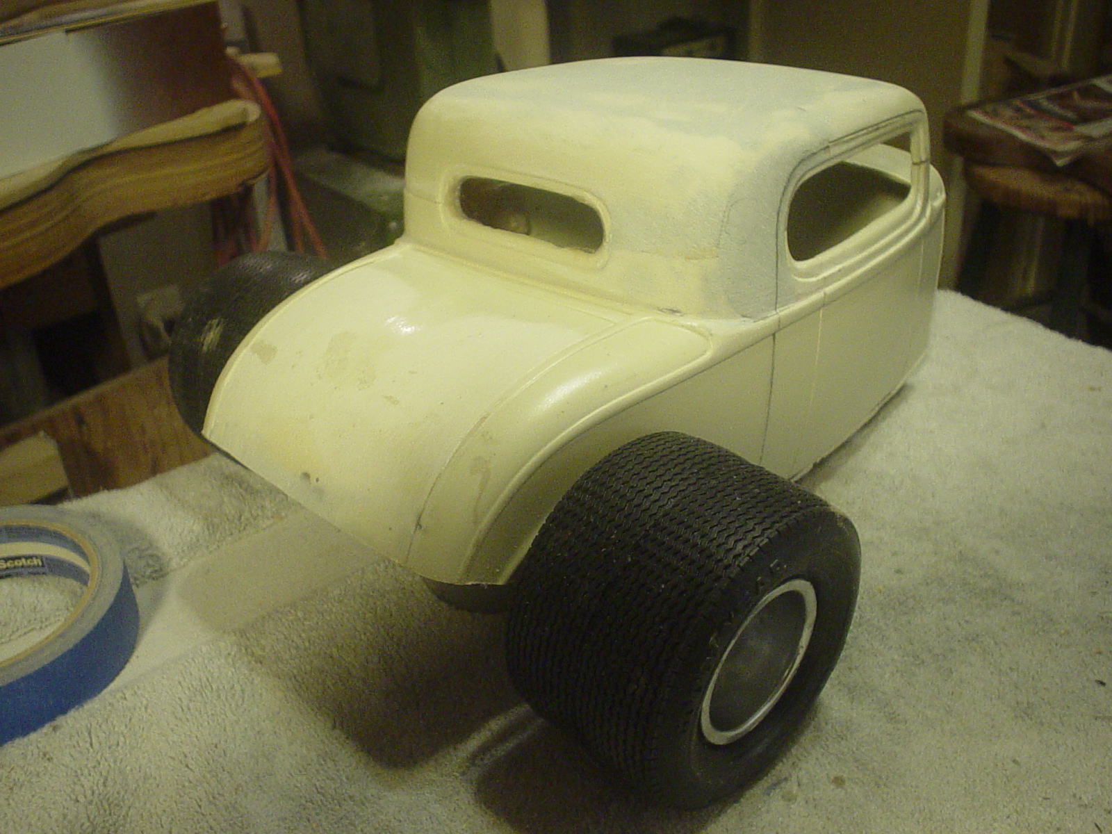

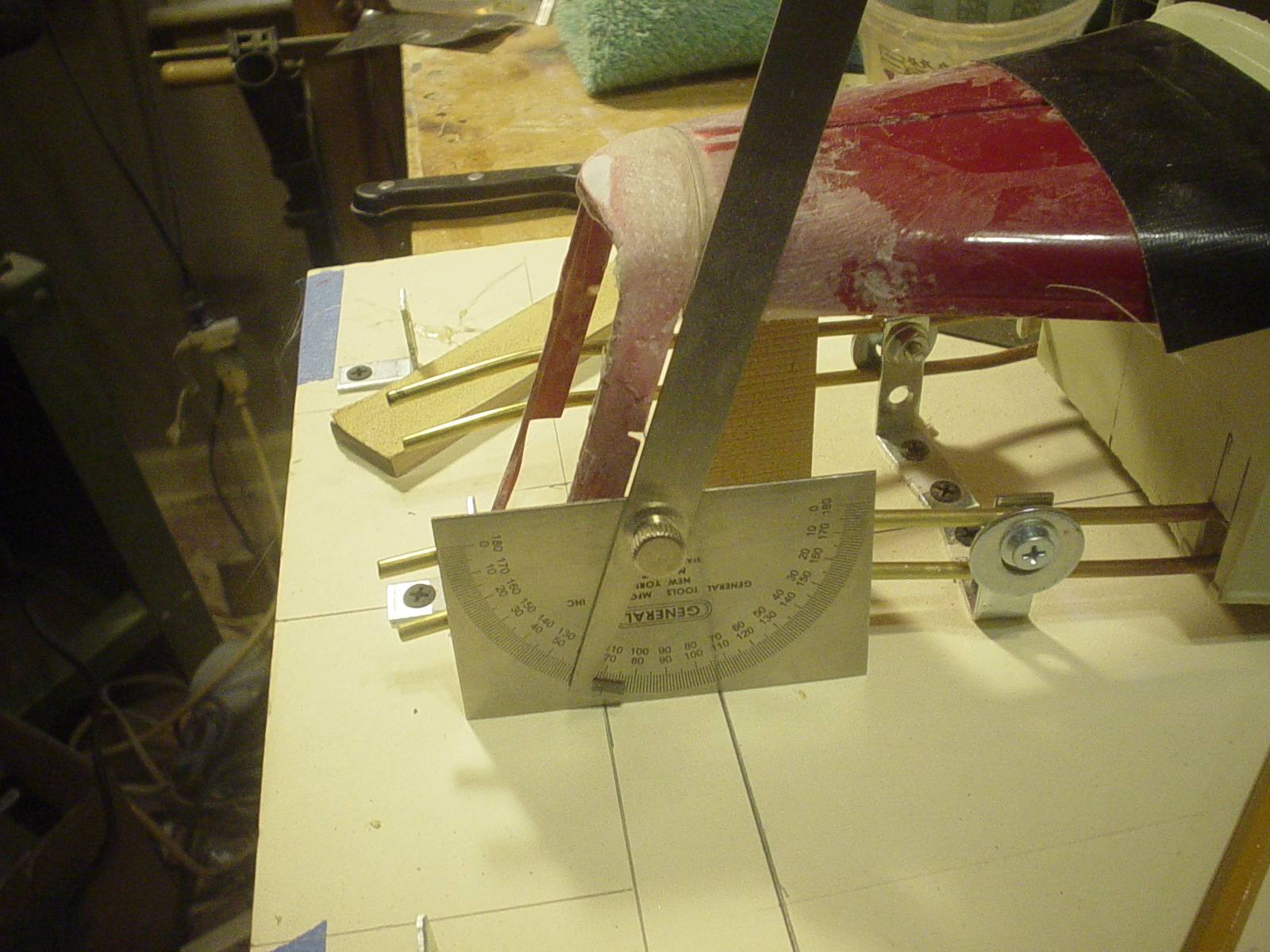

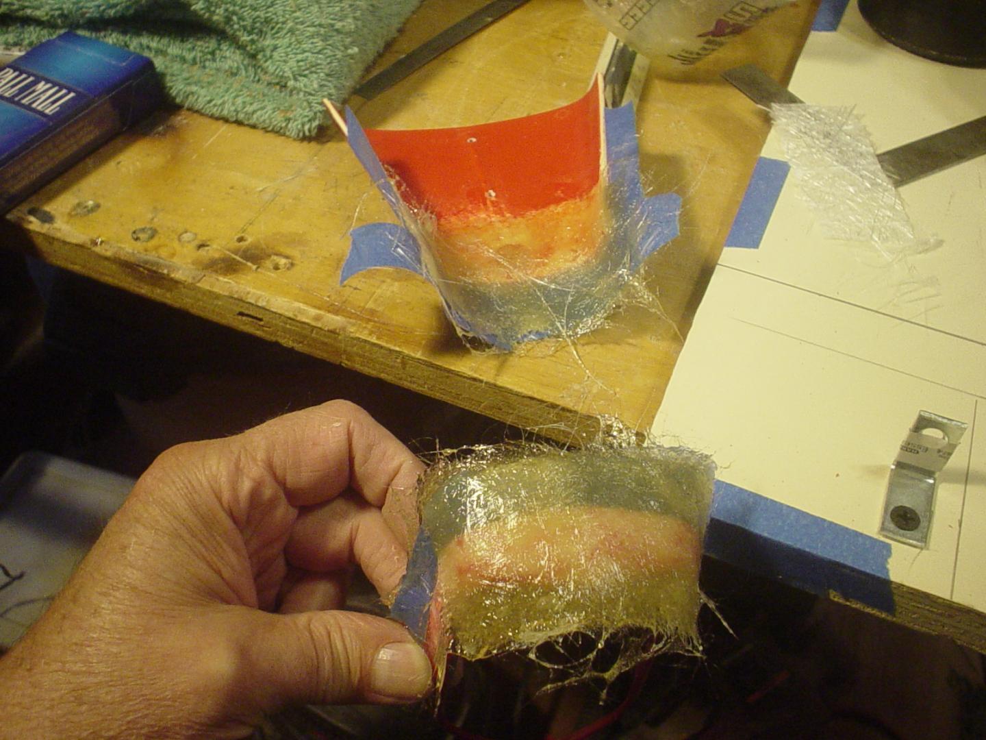

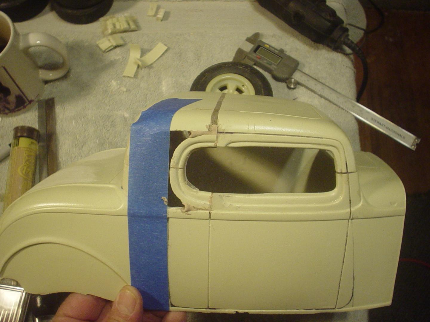

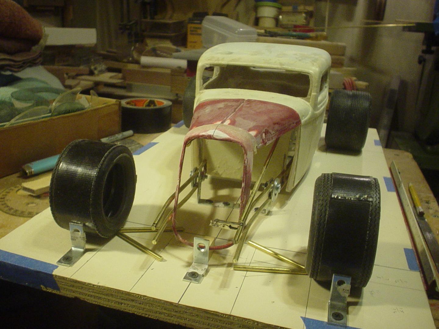

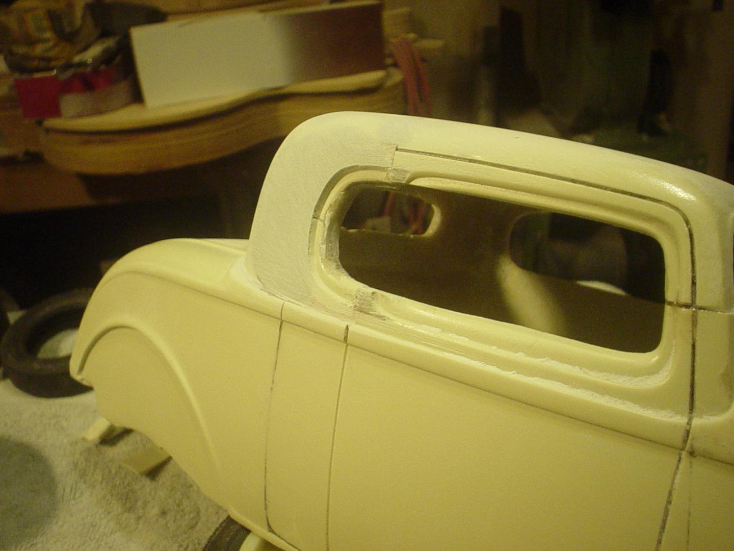

Wanted to lay the grill shell back.  Don't see this much on deuces but I like the way it looks.  Used mat & resin to rework the front of the hood & shell.
autocrosscoupe142.thumb.JPG.ee46ef7e6bbb
autocrosscoupe143.thumb.JPG.105e9bf01049
autocrosscoupe149.thumb.JPG.ec1105af6ecb

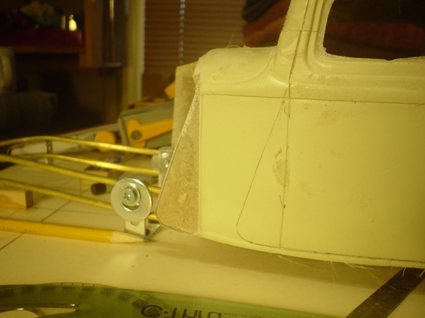

Read the angle & transferred it to the front door line & extended the cowl side to match.

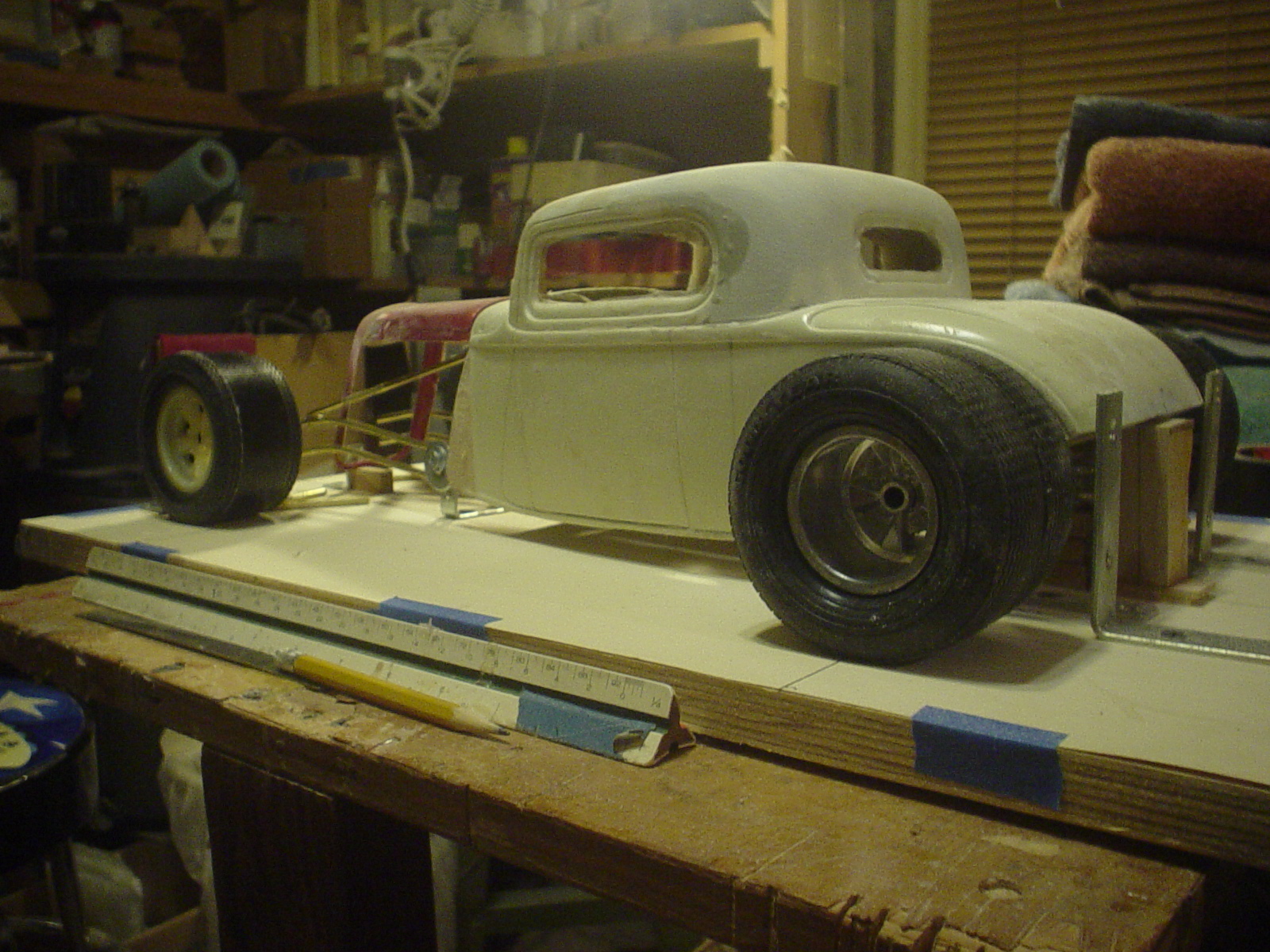

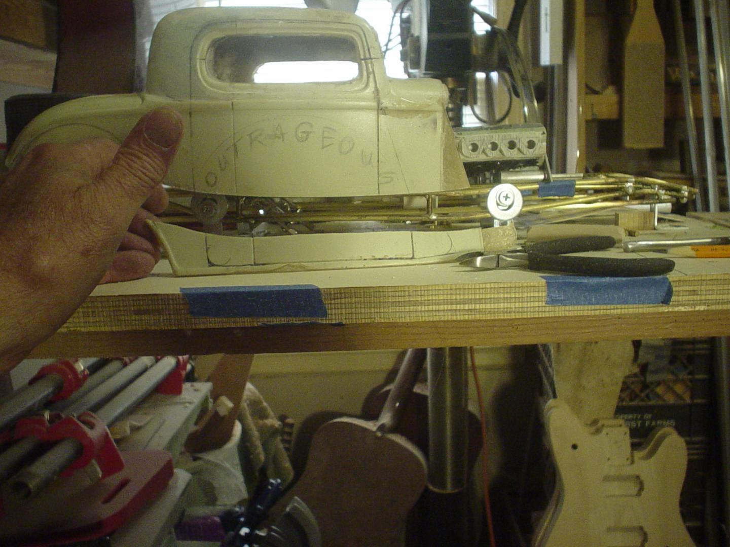

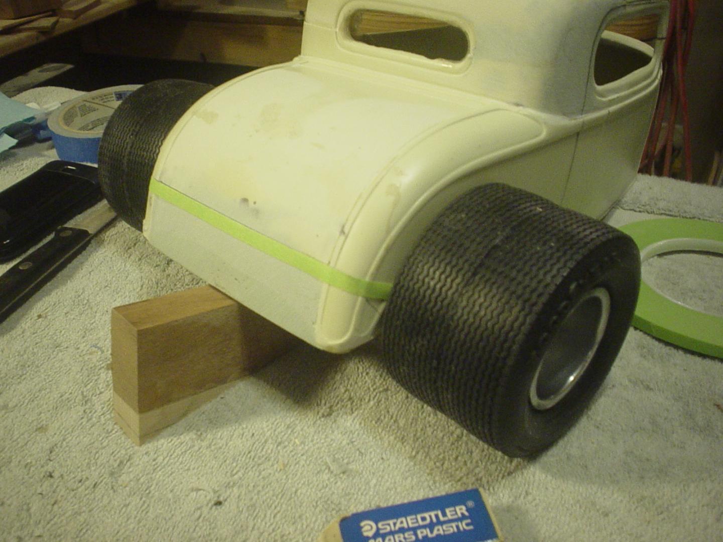

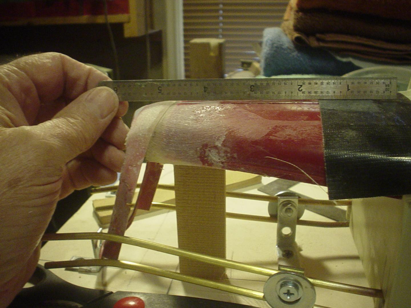

I like a "bobtail" look on an underslung coupe like this.  Makes them look more nimble & quick, to my eye, so trimmed off the line along the bottom of the tape to achieve the look.
autocrosscoupe85.thumb.JPG.1a5649f44fc63
autocrosscoupe86.thumb.JPG.3413dda348432
autocrosscoupe87.thumb.JPG.0c97b27fc567a

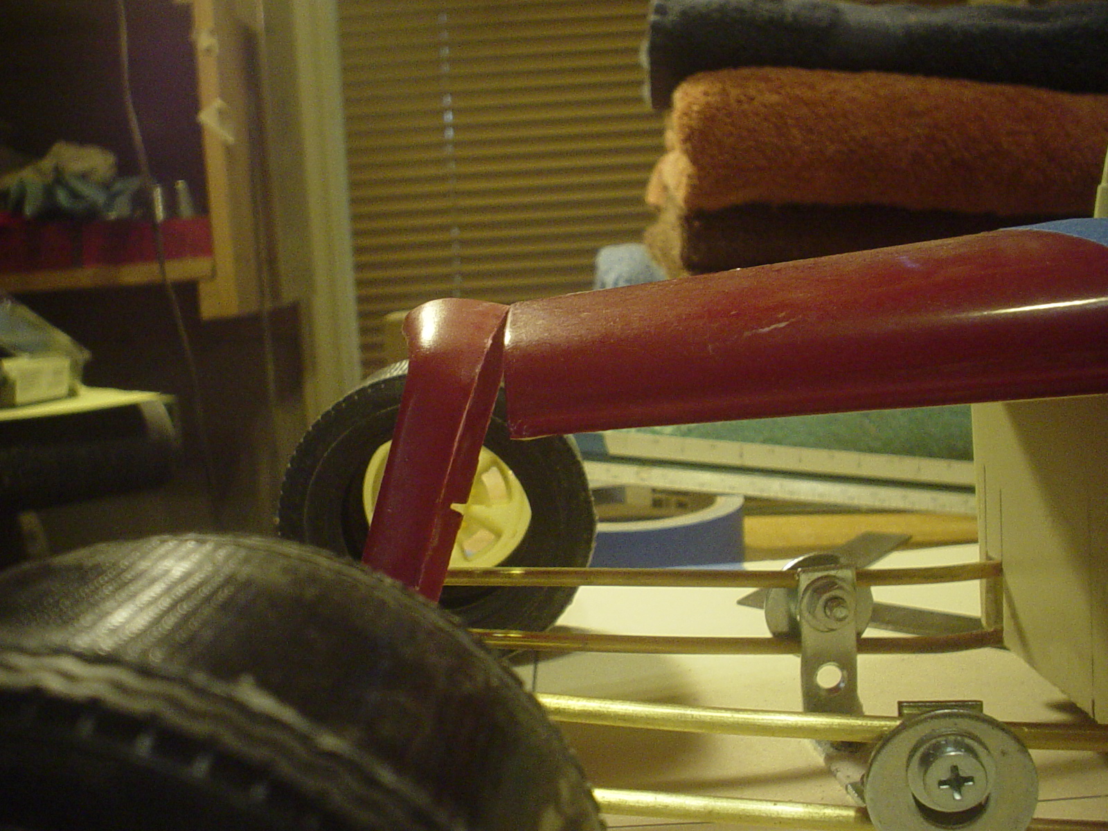

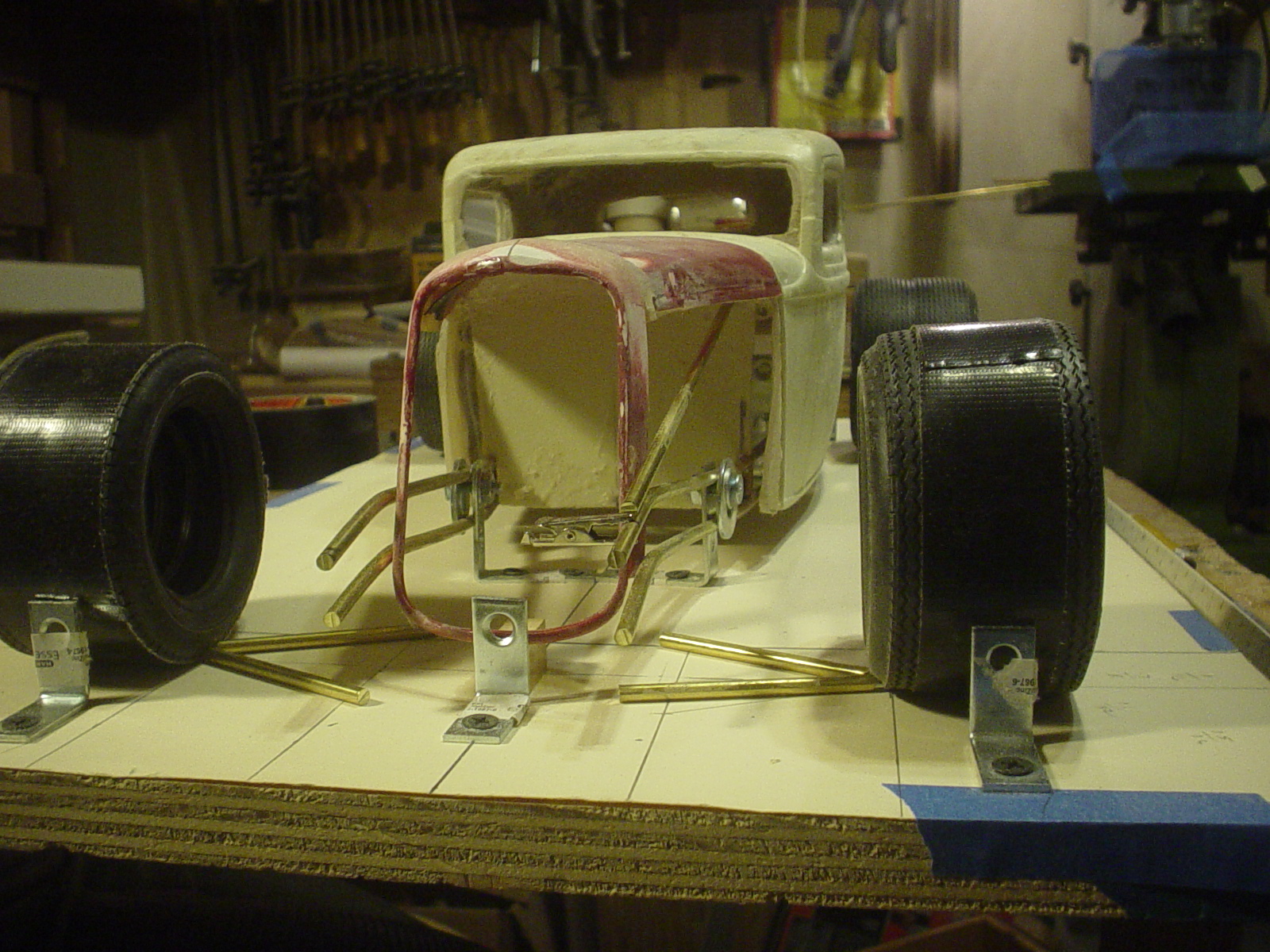

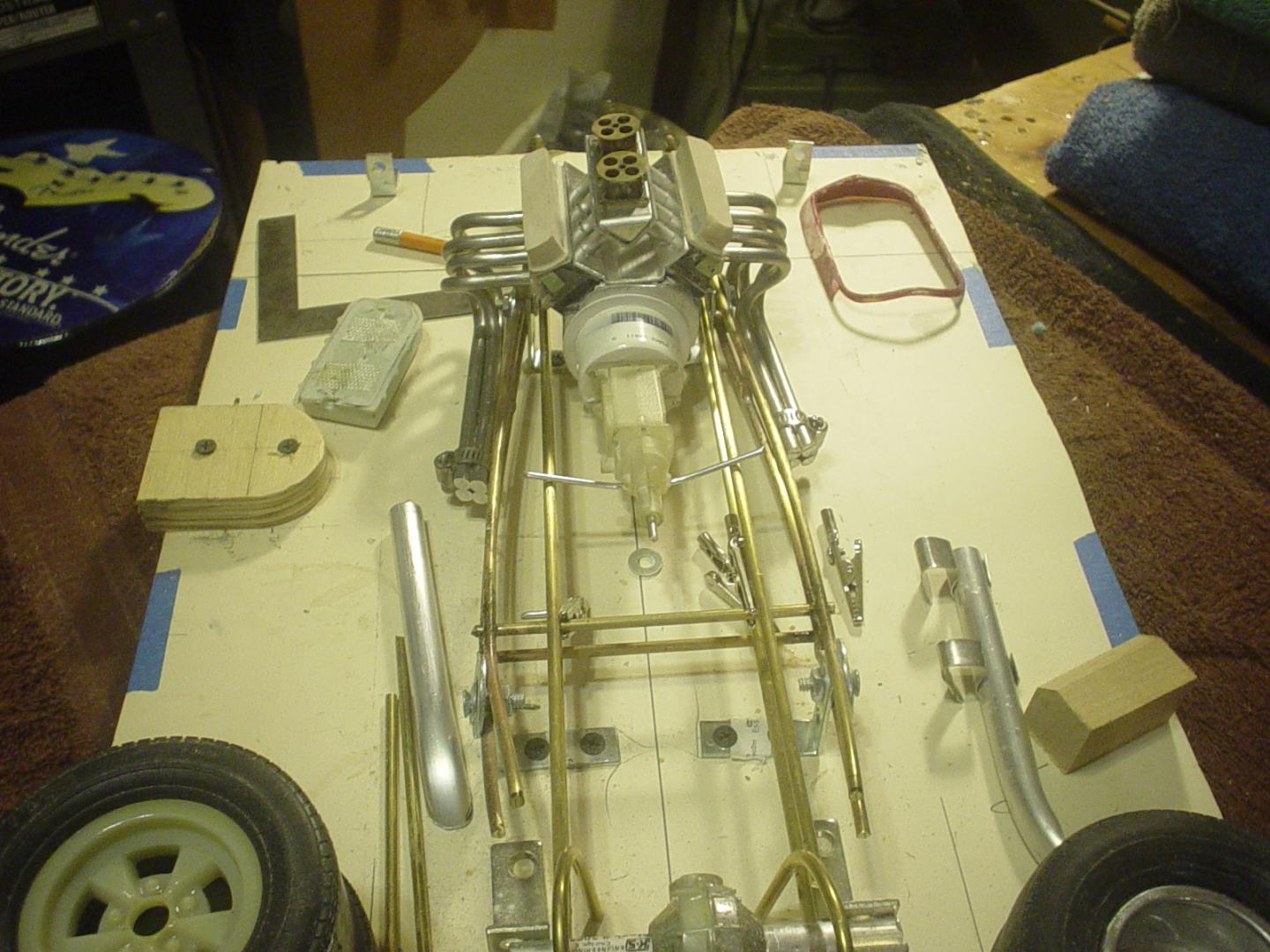

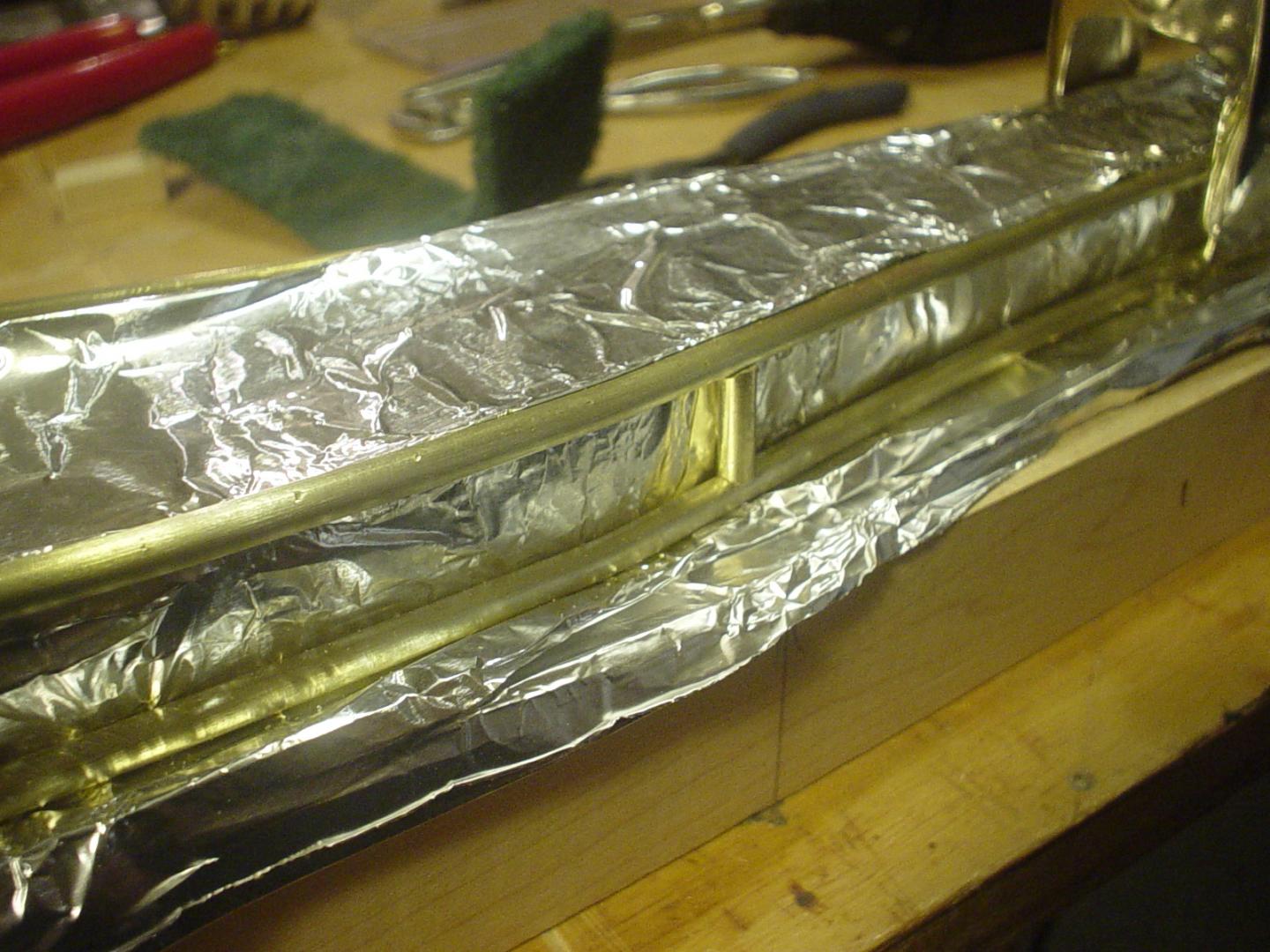

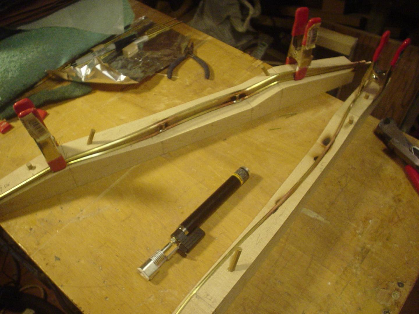

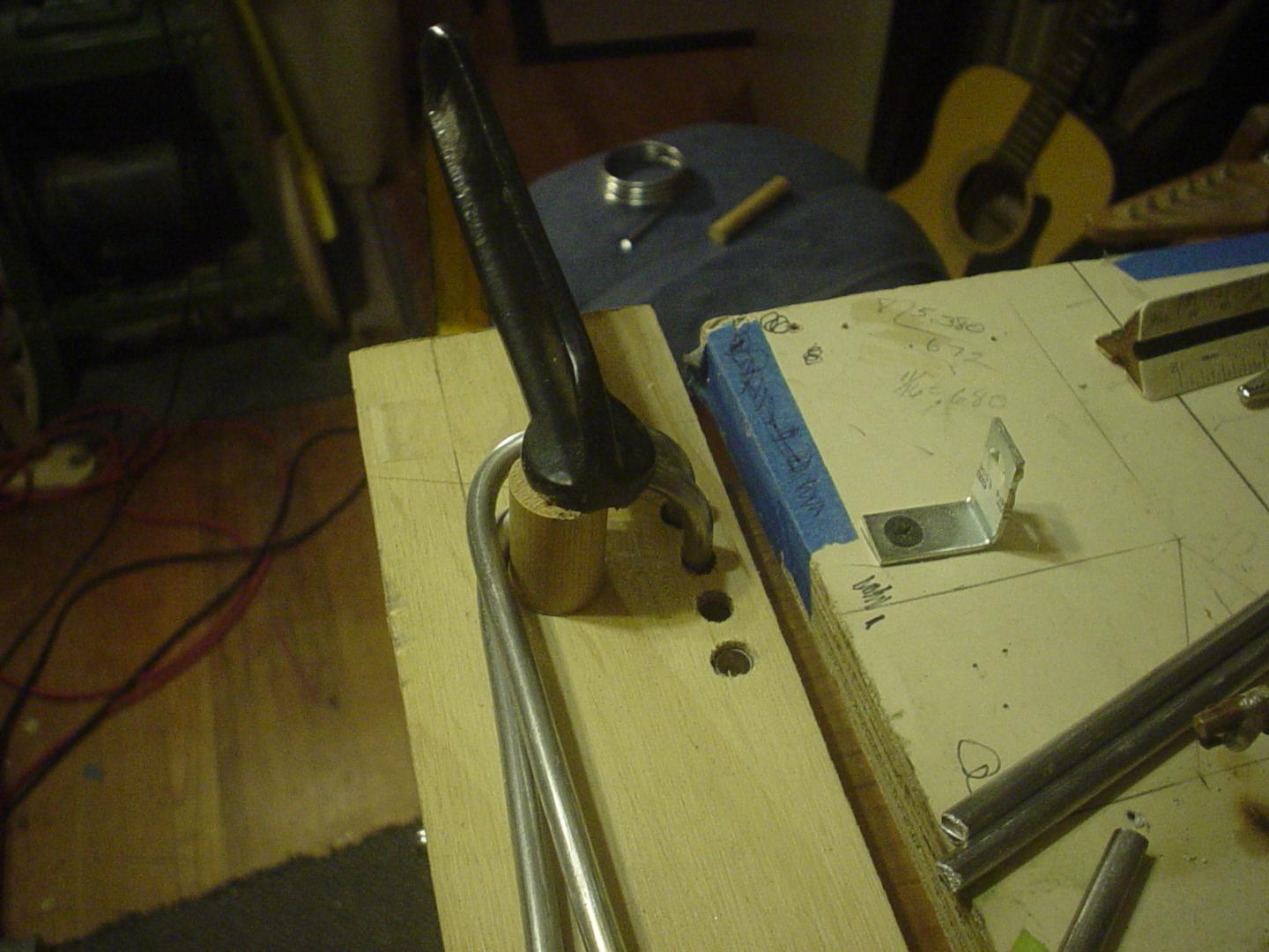

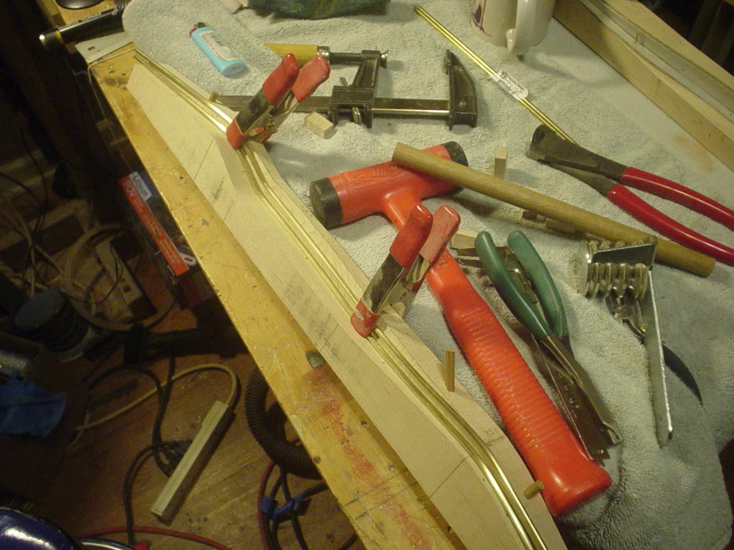

Shaping the frame rods to match the deuce frame profile on the jig I built for it.
autocrosscoupe102.thumb.JPG.8927edf95d06
autocrosscoupe107.thumb.JPG.98b102dc23dc
autocrosscoupe111.thumb.JPG.f29376e1313e

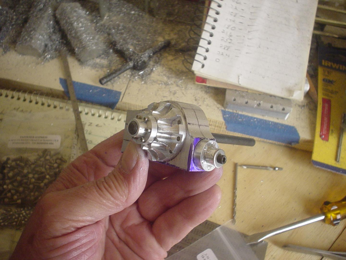

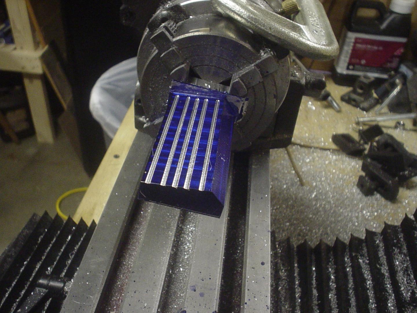

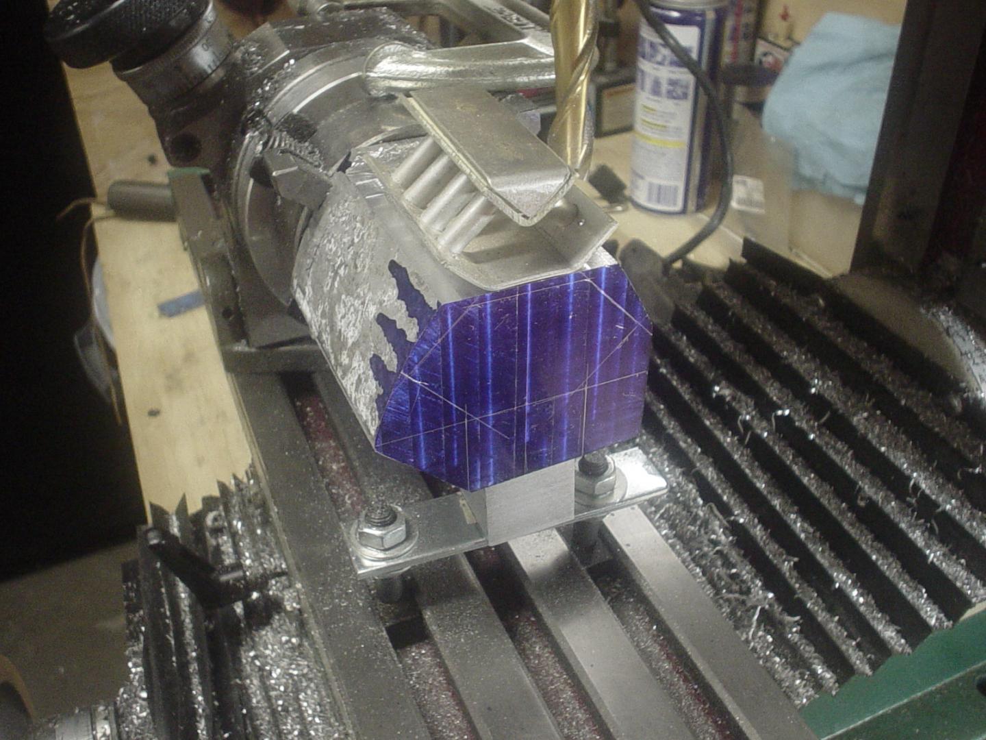

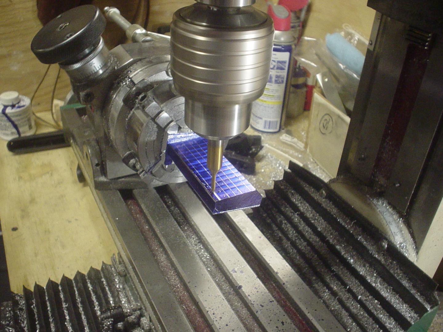

Working on the oil pan today.  Cutting feature lines in the bottom of it.  Camera wobble is a result of turning the feed screw crank with the other hand.  Sorry bout that...hope you enjoy anyway.  :)
A couple of still shots of todays work.
machshp200.thumb.JPG.3bf5ea7e3207e5068bc8f26828f57364.JPGmachshp201.thumb.JPG.6b054682234ddb05c71968c00cb83d7a.JPG
