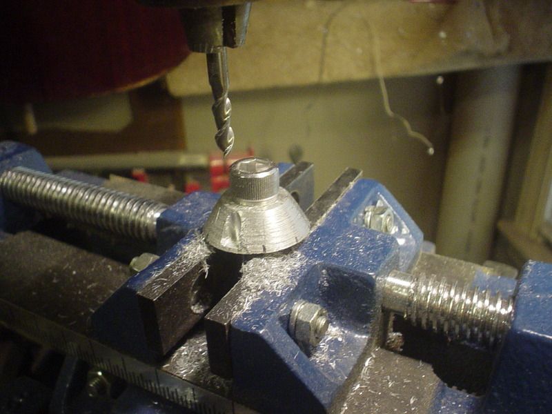

10thumbs Posted October 19, 2015 Share Posted October 19, 2015 Hi Ray, nice cut.You do these cuts from above? Interesting to see this approach. How do you tap the drill/sink point? My setup is such that I get at these cuts from the side with a sliding carriage. Man, would I like to have a look (and a sniff {woodwork} in your shop) and do some model talk. Got any cool beer?Michael Quote Link to comment Share on other sites More sharing options...

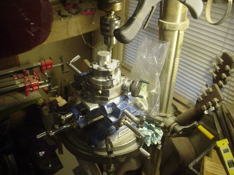

Ognib Posted October 20, 2015 Author Share Posted October 20, 2015 I got cold beer. Any time you're in the neighborhood just let me know & we'll get together! Did the cut from the side. Just raised the bit for pic. The vice platform has X - Y travel. Quote Link to comment Share on other sites More sharing options...

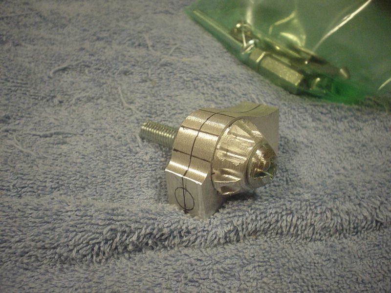

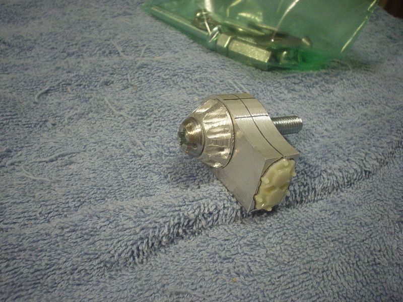

Ognib Posted October 23, 2015 Author Share Posted October 23, 2015 (edited) In keeping with my policy of honest reporting, it is now...quick change side covers, take 2.I abandoned the first one, on the 8th cut of 10, when my clamping slipped, allowing the bit to rotate the workpiece slightly resulting in the cut moving off to the side.Major bummer!!But not totally...I was not happy with the randomness of the spacing between the cuts...a result of eyeball alignment discrepancies.I learned some stuff.Can get an idea, though, where I'm trying to go with this.Bear in mind, that this first cut is only the first of several I have planned for the pieces.This is fun, I'm diggin it! Edited October 23, 2015 by Ognib Quote Link to comment Share on other sites More sharing options...

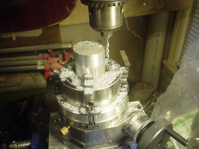

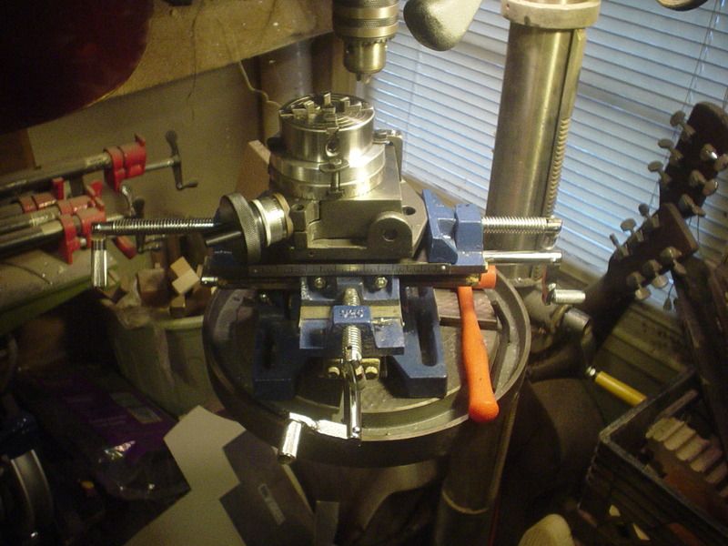

Ognib Posted October 25, 2015 Author Share Posted October 25, 2015 (edited) Thanks for stopping in, Michael, good to see you. Thanks Tim. Sometimes I can live with the "looseness" of free hand work...sometimes not. I've been doing a lot of studying on this in the past few weeks. Found these items at Grizzly.Even with my most careful layout & eyeball execution, I'm seeing small discrepancies in the evenness of the spacing on my cuts as I work around the piece.When I mock it up & set it in with the frame & rest of the build, it's not all that noticeable.....but I know they're there & it bugs the living heck out of me!!I'm committed to doing tighter work than that, for my own artistic edification!With the rotary table, I can finish one cut & crank 36 degrees of rotation on the table & know that I'm cutting precisely in the right location.The roadster seems to be on hold, as I'm being sucked deeper into this current build.So, I'm going to order these items in the next few days.http://grizzly21-px.rtrk.ca/products/4- ... Base/H7578http://grizzly21-px.rtrk.ca/products/3- ... ble/T10053The 4 jaw chuck is not self centering, each jaw is positioned independently, which means it's handy for holding odd shaped items like cylinder heads & water pumps & so on.http://grizzly21-px.rtrk.ca/products/58 ... lot/T25250 Edited October 25, 2015 by Ognib Quote Link to comment Share on other sites More sharing options...
Twokidsnosleep Posted October 25, 2015 Share Posted October 25, 2015 Grizzly to the rescue...been to the one in Wash State. Like a kid in a candy store...expensive candy store mind youThe precision, accuracy and safety that the table will provide is right up your alley. If you do ever purchase a milling machine I am sure this will come in very handy.I am on a tool purchasing strike, so good to see someone else buy something cool!!!! Quote Link to comment Share on other sites More sharing options...
Ognib Posted October 25, 2015 Author Share Posted October 25, 2015 Hey, Scott, good to see you.I'll have to have a mill eventually. I've got too many projects & the drill press is not designed for the side loads of milling so I feed it veeery slowly to minimize those side loads...I have much respect for my equipment.But I'm an old retired guy who's on a very tight budget, so I try to do my purchases in an order that will allow me to limp along while saving my lunch money for the next item. Quote Link to comment Share on other sites More sharing options...
b-body fan Posted October 25, 2015 Share Posted October 25, 2015 Could you adapt a degree wheel like we use in 1:1 engine building? You could mount your piece in the center on something to stand it off a bit. Mark a zero point on the table and make your 36 degree rotation. A lot less than a mill in the meantime. Quote Link to comment Share on other sites More sharing options...
Ognib Posted October 25, 2015 Author Share Posted October 25, 2015 Good Idea, Michael.I may still have mine that I used for setting up my camshafts...sold a bunch of stuff when I retired.Tim, question...what speed do you turn your cutter bits for side cuts like what I've been doing? Quote Link to comment Share on other sites More sharing options...
Codi Posted October 25, 2015 Share Posted October 25, 2015 Hi Ray, Not sure the info will help as the parts I'm turning are significantly smaller, but as an fyi, anywhere from 1800 to 2100 rpm. Where are you right now? The man to ask would be Dave (comp1839) as he fabricates in 1/8th scale AND has tons of experience, so he might be able to make a better recommendation / suggestion for what you're making. Cheers Quote Link to comment Share on other sites More sharing options...
Ognib Posted October 26, 2015 Author Share Posted October 26, 2015 (edited) The formula for converting FPM tp RPM is:Spindle Speed [RPM] = cutting speed (in inches) (pi*tool diameter). / Basically, find the circumference of the tool, divide the cutting speed by the tool circumference and that tells you how many times the tool will need to go around per minute to achieve the proper cutting speed. A larger diameter tool will go slower because it cuts more metal per revolution of the tool. -----------------------------This is one of the better, I think, answers I've found on line.Since my feed rate is slow, I should be able to work with a slower spindle speed.I'm currently experimenting at about 1,000 rpm...with very light, slow feed cuts.Just trying to get a real world feel for what others, who are doing similar work, are using.You've mentioned in your thread some of the long days you've spent producing a particular part... Edited October 26, 2015 by Ognib Quote Link to comment Share on other sites More sharing options...

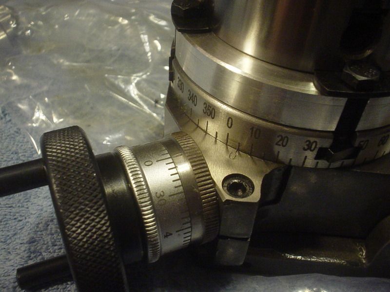

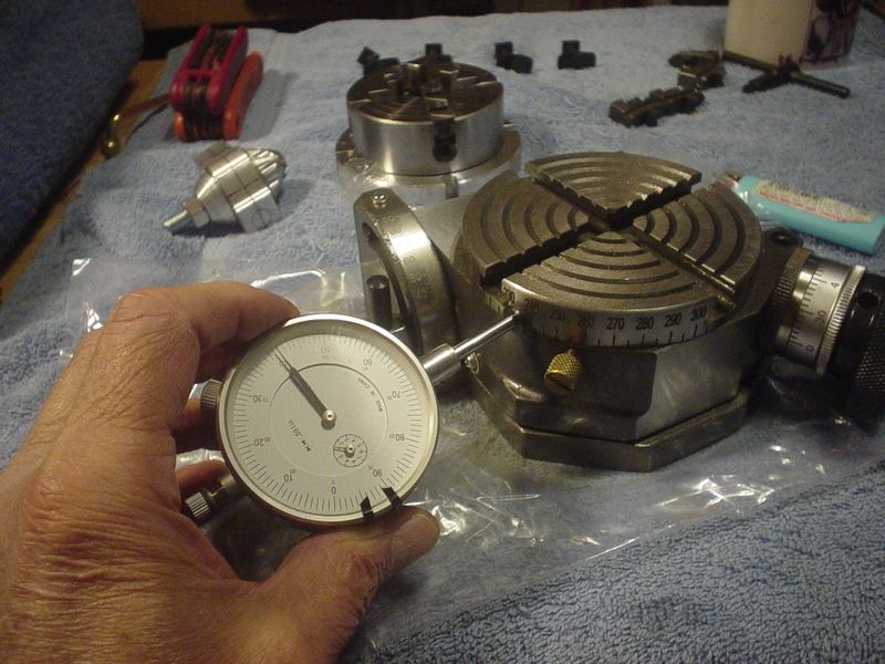

Ognib Posted October 29, 2015 Author Share Posted October 29, 2015 Another learning curve staring me in the face.Going to read the table for run-out as a first item of business.Still have to dig through some more storage & find the magnetic base.Quite impressed, considering the modest cost of these two items.Gear backlash on the table is almost zero & it has a good solid feel when rotated & the quality of the marking of the scales is impressive.Mounted in the vice, it has X, Y axis as well.My weak link now is the fact that I'm working under a drill press instead of a mill.One thing at a time, ya know what I mean, Vern?I can, at least, limp along slowly with what I have now & experience tighter tolerances on my quick change side covers. Quote Link to comment Share on other sites More sharing options...

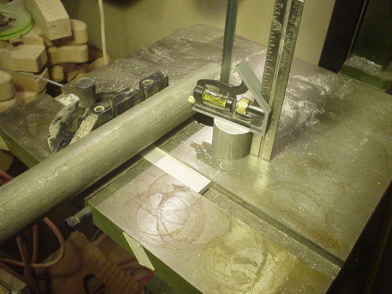

Ognib Posted October 31, 2015 Author Share Posted October 31, 2015 Cut a couple of plugs off of a piece of round barstock from the salvage yard.Bandsaw is giving me good square cuts. Normally turning to spec diameter on a piece of stock is done on a lathe.I need to know how to accomplish that with this.I've got my spindle speed up to 2540 rpm & that smoothed things out a bunch.Looks more wavy than it feels.LOL, now that's a gangley lookin stack a stuff there, idnit??But I'm having fun, so leave me alone with my madness. In the background, a couple of cheap, busted up old acoustics of no value, that I just don't have the heart to pitch them into the dumpster...they're just there to add visual texture to my shop. Quote Link to comment Share on other sites More sharing options...

Ognib Posted November 10, 2015 Author Share Posted November 10, 2015 (edited) Hey Scott. In the photo above your post, you can see a heavy radial ball bearing, at the bottom of the spindle, that absorbs side loads. I checked the side play on the spindle with a dial indicator before I began cutting on that first side cover & then again later & it was staying the same. So I figure it's ok to proceed with caution. Very slow feed rates to keep side loads to a minimum. I've got a deal working on one of my bass rigs...fender jazz with duncan active pickups, carvin 600 w head & an avitar neo speaker cab...lateral transfer of funds to sherline for one of their vertical mills. Tim has one & speaks very highly of it's quality & features. I figure I've done gone stark raving mad over this stuff & I'm really digging the machining process & the mental challenges associated with it, so might as well do it right! Edited November 10, 2015 by Ognib Quote Link to comment Share on other sites More sharing options...

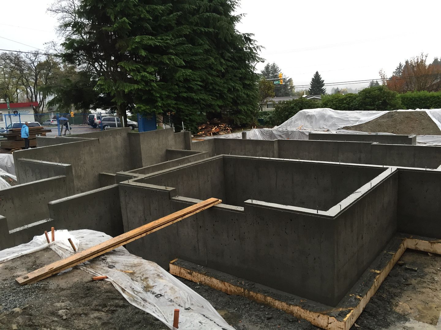

Twokidsnosleep Posted November 10, 2015 Share Posted November 10, 2015 Ok good, you got it covered and are safe Glad it is sounder than my drill press...sounds terrible when that retaining pin lets go Here is my workshop/hobbyspace in the foreground...little rustic at the moment Quote Link to comment Share on other sites More sharing options...
Ognib Posted November 10, 2015 Author Share Posted November 10, 2015 Nice! How many sq ft?Going to have it under roof & tight before snow? Quote Link to comment Share on other sites More sharing options...
Twokidsnosleep Posted November 10, 2015 Share Posted November 10, 2015 My space is 12x16 with a two car garage as well to spill into for woodworking..overall house is about 4700 including garageThey are working hard to get her closed ASAP to avoid the wet weather we get on the West Coast...the snow is smart enough to stay up in the mountains, but boy can it rain here !I will be crying soon not able to afford the tools I want and working lots to pay for all this debt Keep plugging away at the car, watching you work through things and problem solve is very educational Quote Link to comment Share on other sites More sharing options...
