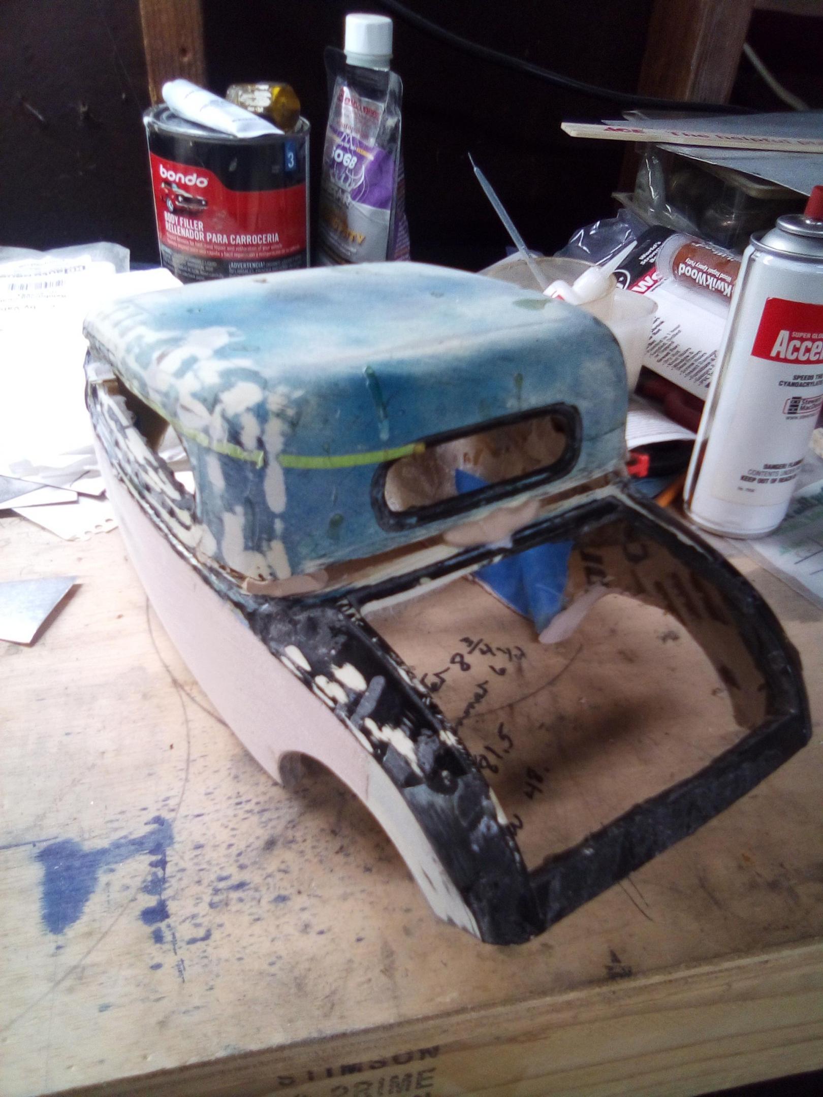

Seating the top in a bed of 2 part epoxy putty. Great adheasion, moldable, holds it's shape well.
It's fitting well, windshield height is even on both sides.

Trim down the short piece of A pillar to fit. Has to lay to this angle to match the front line of the cowl side.

Got the A pillars roughed in on the sides. Drew a few lines...something like this.

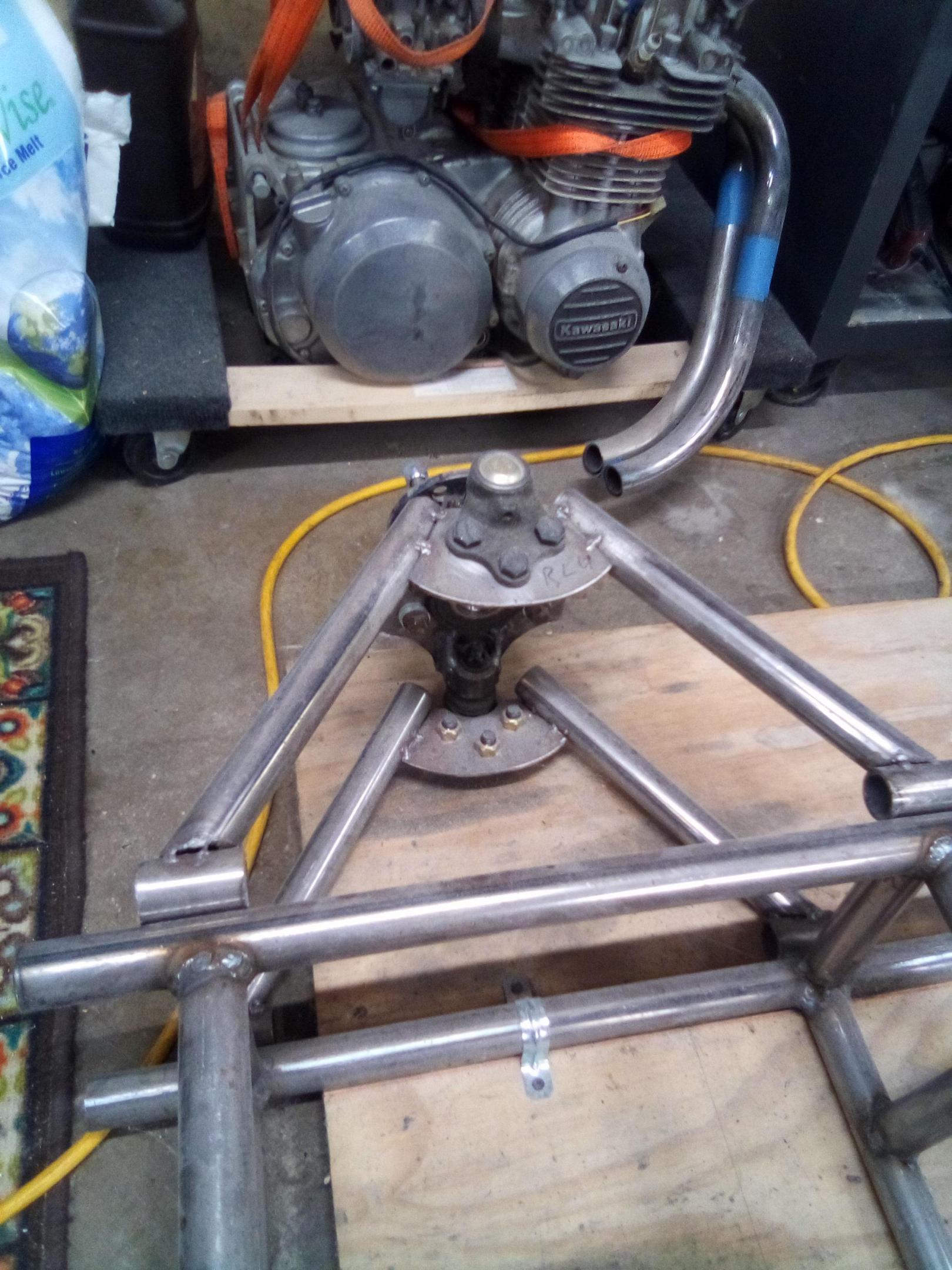

original concept for it was Euro coupe, if you will, 4 wheel independent with F1 inspired suspension with tube links. Lots of photo on first few pages of thread.
but I don't know, the way it's starting to look to my eye...stuck the axle I bent in the other roadster thread under it to see how it looks.

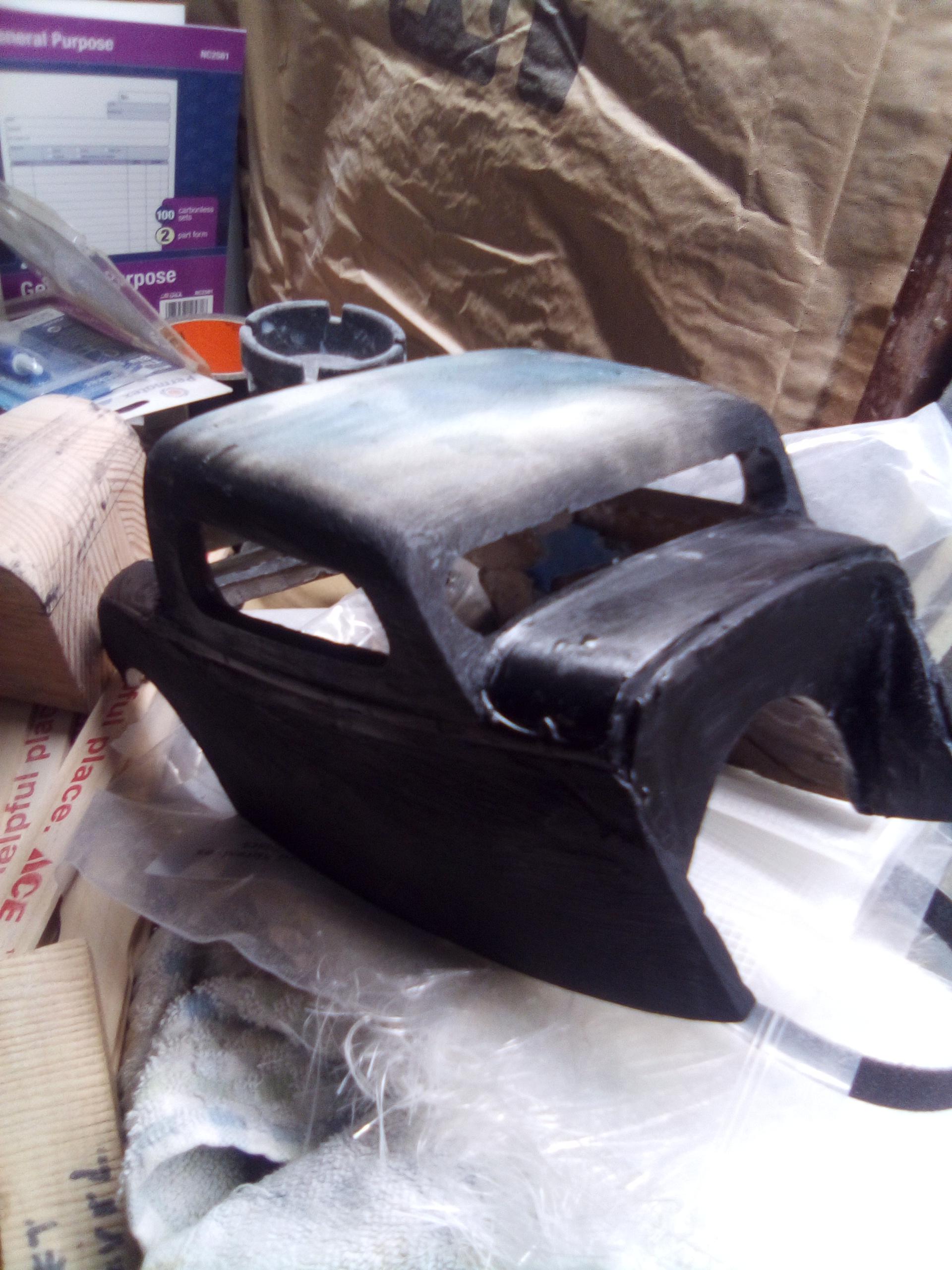

Everythings roughed in at this point. Spritzed a coat of black for guide coat. When I sand on it with a hard block, the black will sand off of the high spots leaving color in the low areas as the block bridges across them. Keep working the highs untill they are worked down to the level of the lows, producing a straight panel.
The A pillar still needs final profile, as well as finalizing the shape and radius of the upper portion of the windshield opening.

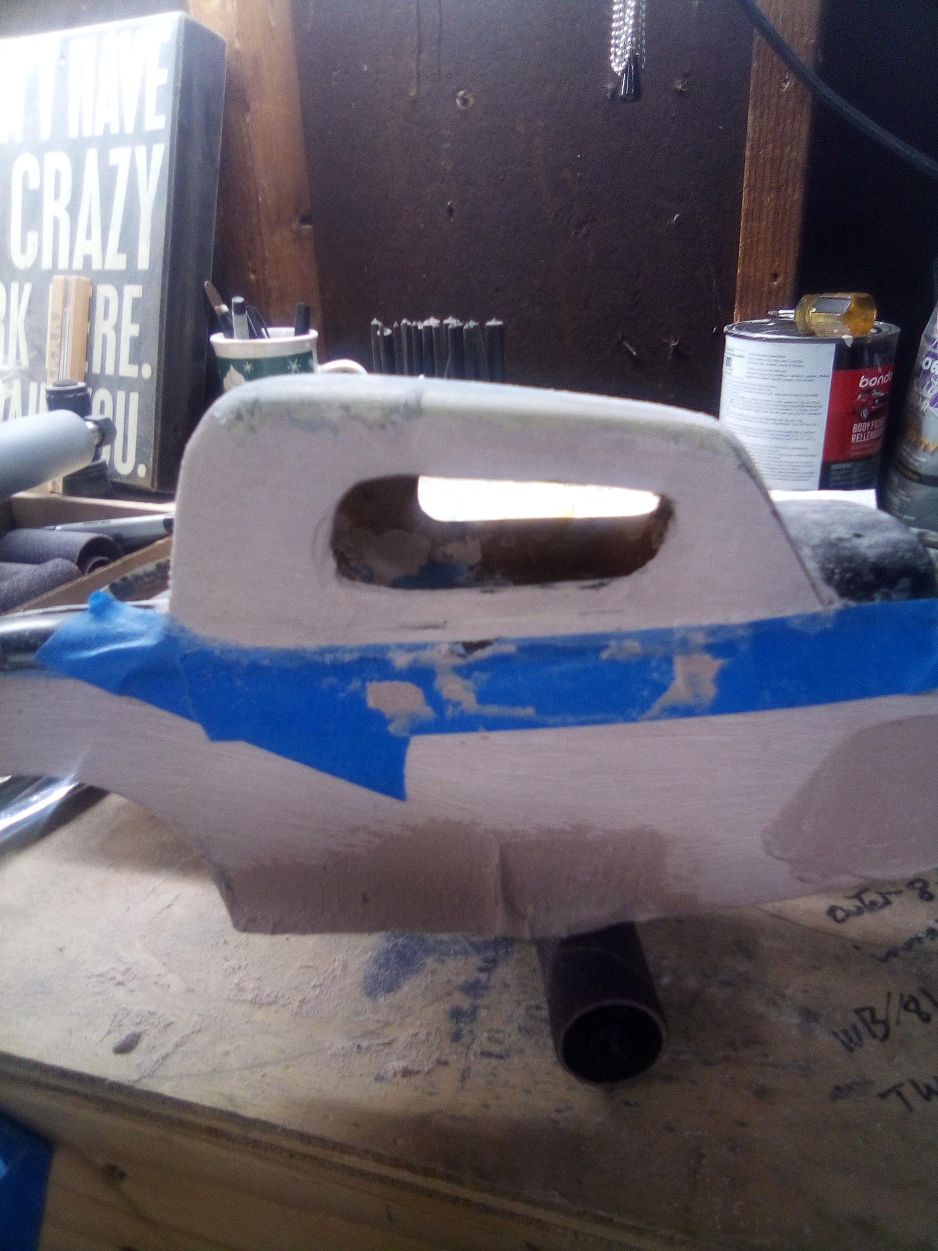

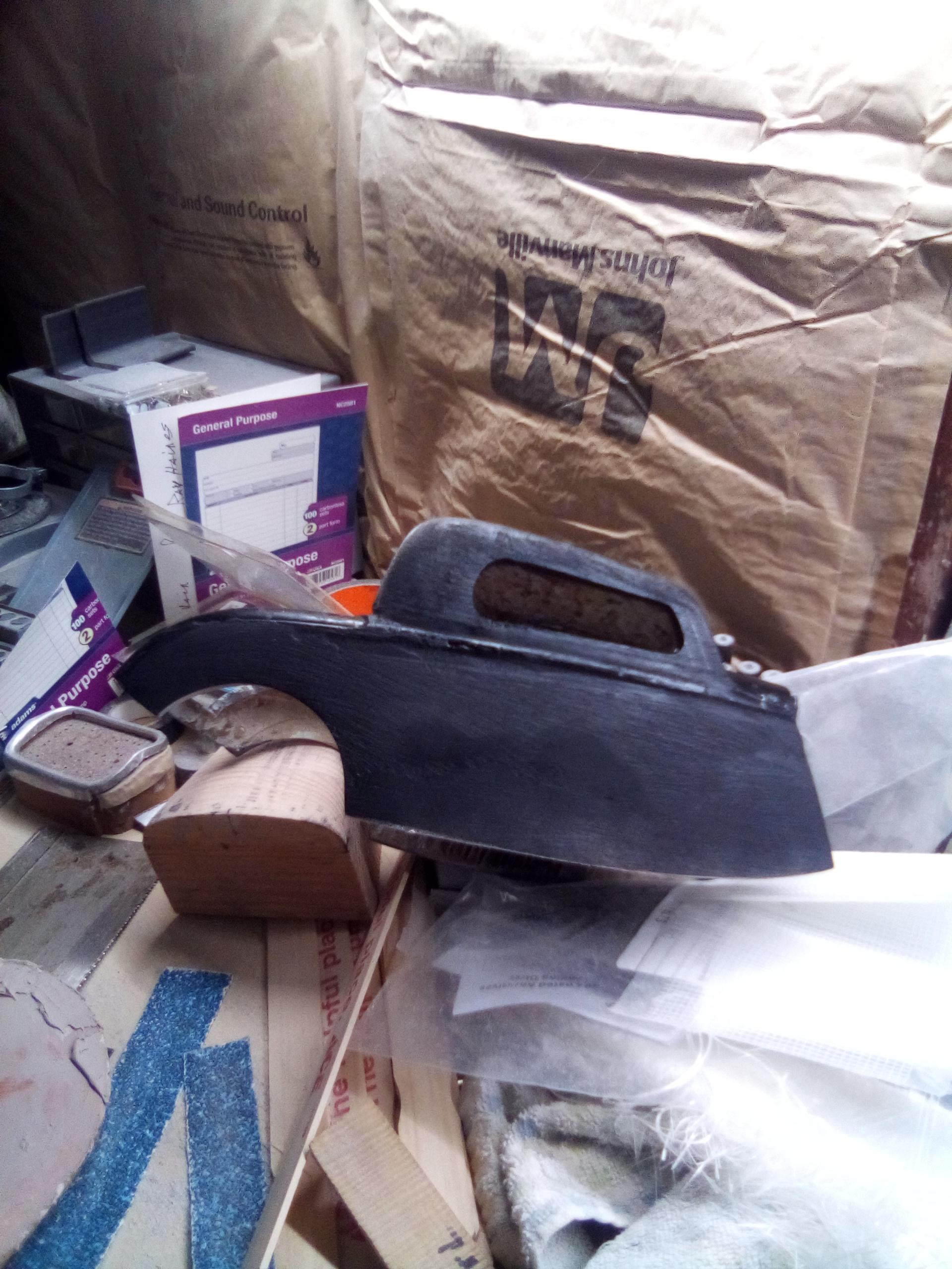

What the panel looks like at the beginning g of a coarse 40 grit block. Can see how the hard block bridges the low areas. Initital rough in was done with a small hand held belt sander.
Second pic shows the other side after a second bockout with 80 grit.
Have a nice transpearant bronze metallic I'm playing with here as well.

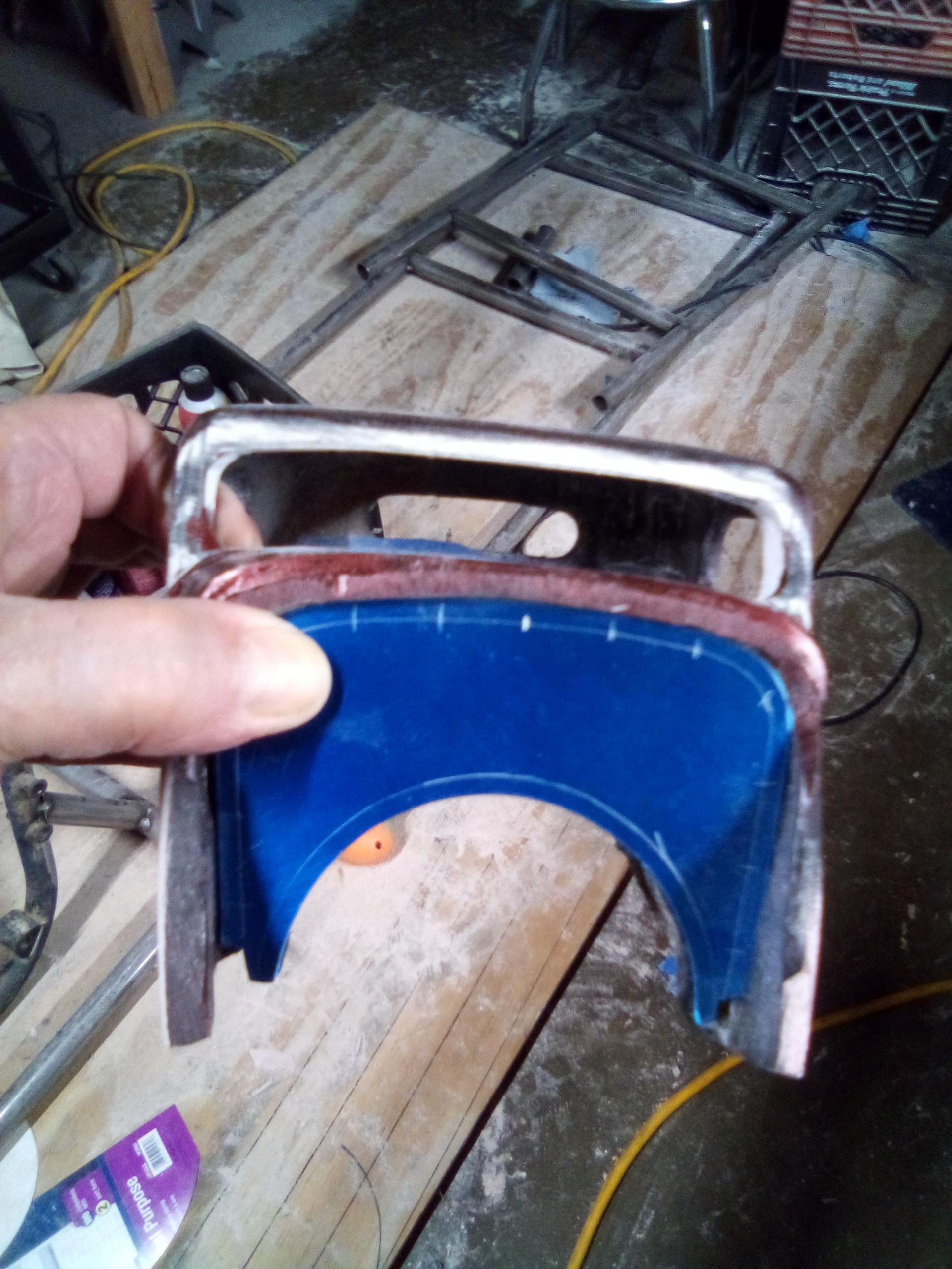

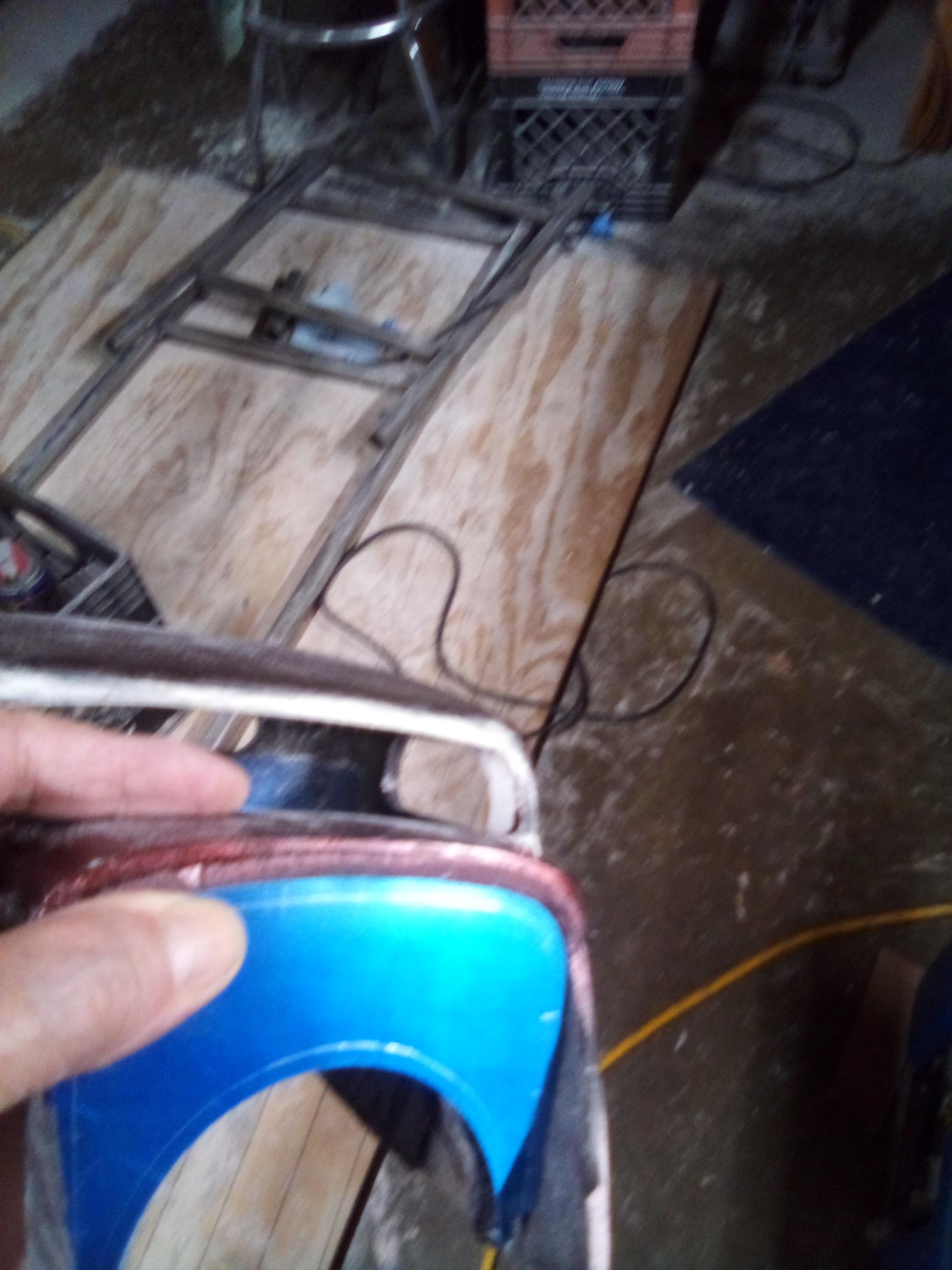

The red on the cowl is the same mix as the red on the side shot, above. It is transparent enough that the base color it's sprayed over influences its final appearance.
I'm close on the shape I want on the driver's side of windshield opening. Still too rounded on other end.
I just stroke it a bit and then set it down and look at it for a while. Make sure I'm getting what I want visually.

The guidecoat let's you draw lines to see how corners and radius panels are intersecting. Shows where every scratch and variation of contour are located.

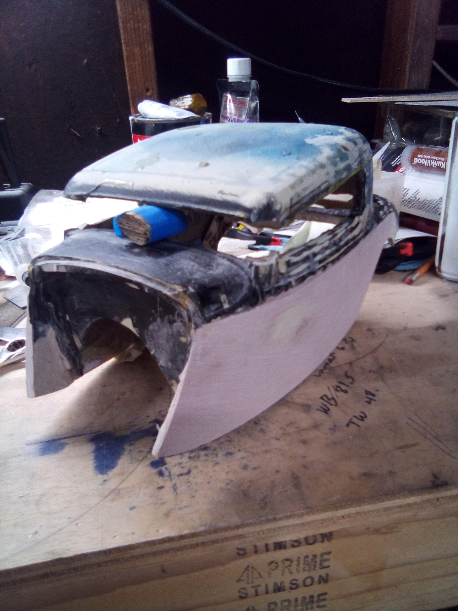

I have 2 main problems with the way the car looks from the side at this point...
The radius where the cab back rolls over into the top is too tight needs to be flatter, larger.  It's too "peaky" if you will.
Upper rear corner of door window opening is too tight, small. Needs to somewhat match the profile of the final radius across the top...ii think...
This is the cool factor in scratch building and modding stuff...trying to build what you see pictured in your head.
If something's not right you know it but can't always identify it Immediately. Sometimes takes multiple redos on a spot before it clicks.
