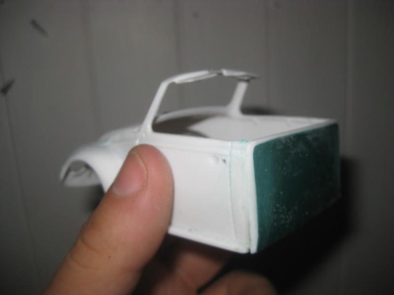

So I thought, why not make something simple, yet fun, out of it? So this one is becoming a roadster pickup.
IMG_6640.thumb.JPG.acce7e8b2639ba398abbc
Since I didn't want it to look so much like a simple hacksaw job, an old Chevyvan body donated its roof for the wall in the back, since it had some slight radius.....

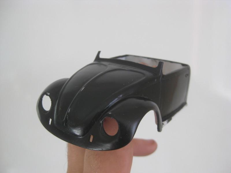

The body really was a terrible casting so I decided that I wanted a more "ratty" paintjob and decided to experiment a little.
First, I brush painted the body flat black, after it had dried for a week I took a 1200 grit paper and removed the worst brush strokes, then I used some fine steel wool and finally a 3000 grit polishing pad. To get some shine back without making it too glossy, I rubbed the body with lineseed oil. I think I achieved about the result I wanted.

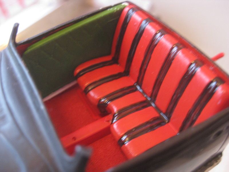

Carpet made of band aids, looks good from some meters away. Ford Courier bench seat (the black piping will get another coat, of course). Door panels cut from some unknown tub in the parts bin (MPC Switchers maybe), nice diamond pattern, will of course be repainted....
