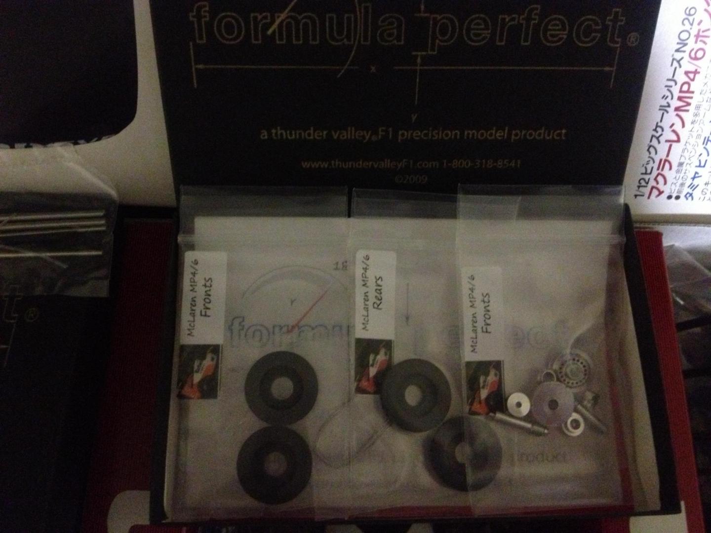

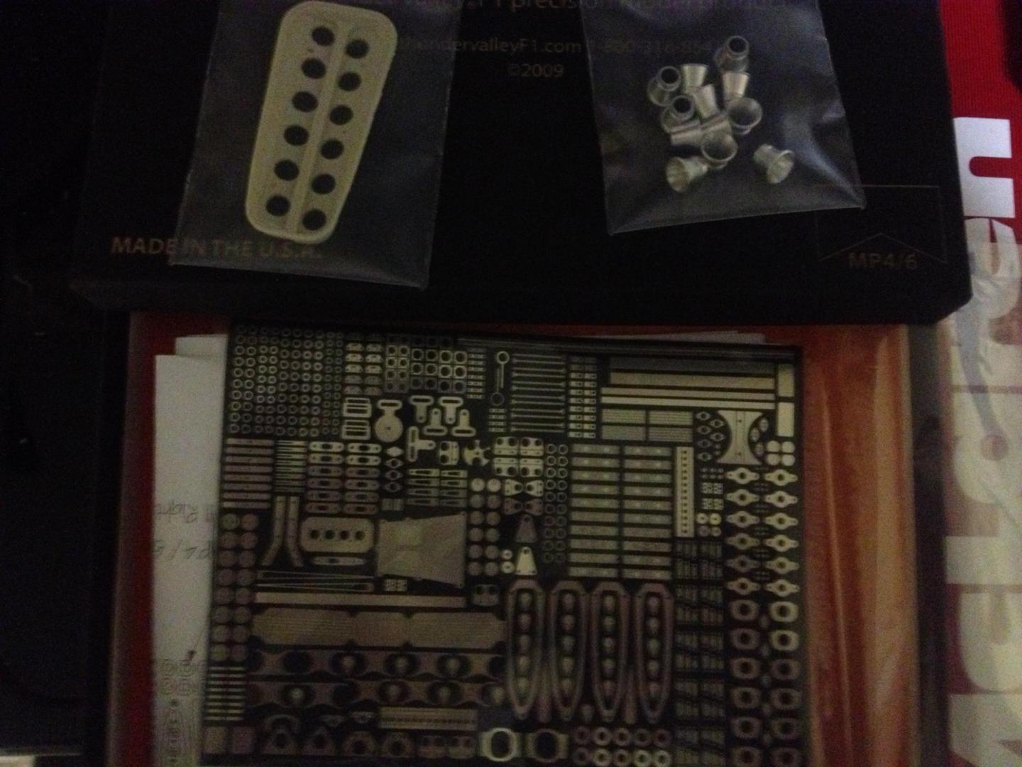

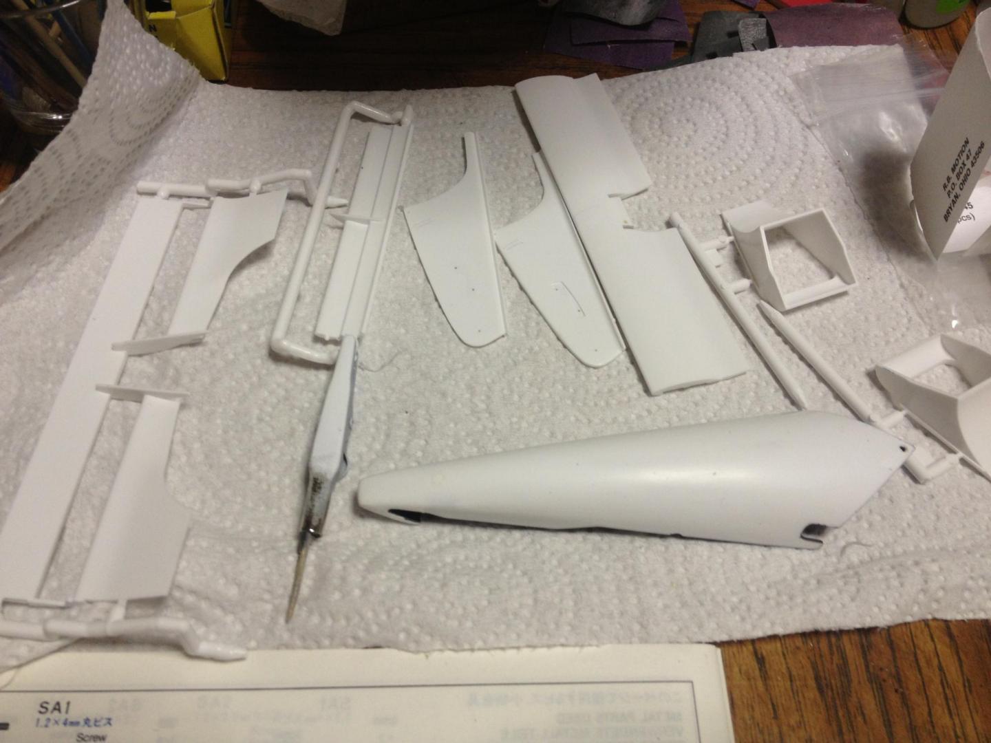

Hi
Just about finished the 1/12 scale FW14B I thought I'd start another F1 build. This time its the McLaren MP4/6. Planning on taking what I learned on the  Williams to try and push this build a little further.I was originally only going to add more of the wires and connectors and hoses along with the Thunder Valley detail set and Super Brake Package but after looking over the model I'm thinking about making a removable nose cone and detailing the brake reservoirs and steering linkage. I've never done any scratch building or major modifications to kits before but I think I'd like to. I'm starting with the body first then the monocoque.
