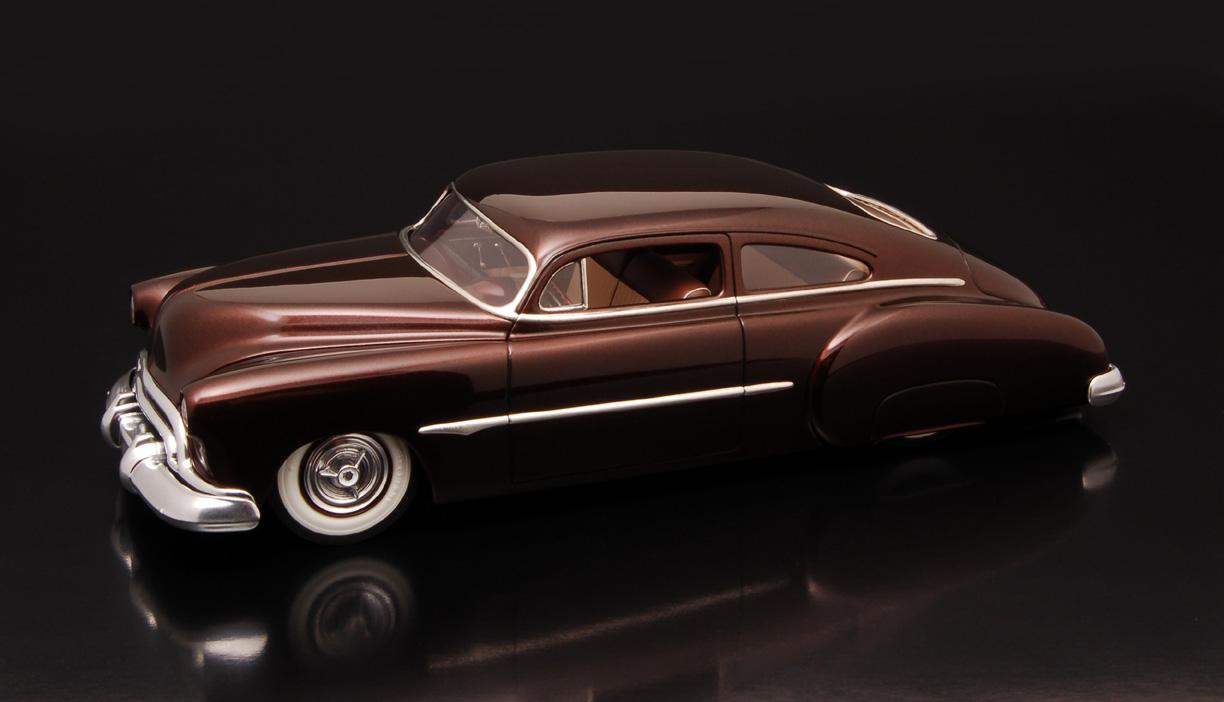

sbk Posted September 16, 2015 Share Posted September 16, 2015 If you're using HOK candies, HOK copper pearl will make a great base coat. I've done some paint tests with candy red over it, & it looks very good. On this one, I shot light coats of copper pearl over a black base, then, topped it with candy root beer. Quote Link to comment Share on other sites More sharing options...

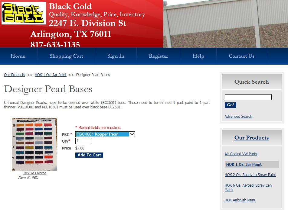

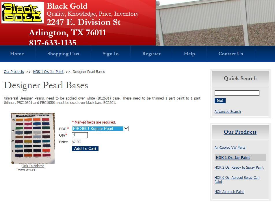

10thumbs Posted September 17, 2015 Share Posted September 17, 2015 Wow! Steve, that looks fantastic!The H of K copper pearl, what is the exact specification? I need to get in touch with my H of K guru, but I'll need the proper number and letter combination. Can you help?Is the copper pearl a base coat?Michael Quote Link to comment Share on other sites More sharing options...
sbk Posted September 17, 2015 Share Posted September 17, 2015 Wow! Steve, that looks fantastic! The H of K copper pearl, what is the exact specification? I need to get in touch with my H of K guru, but I'll need the proper number and letter combination. Can you help? Is the copper pearl a base coat? Michael .Thanks! Yes, a base coat. The text below says to shoot over white, but that is just to match the colors shown on the color chip. I test shoot on many different colored base colors to find out what I want as the final color. http://shop.blackgoldweb.com/product.sc?productId=7&categoryId=2 Quote Link to comment Share on other sites More sharing options...
