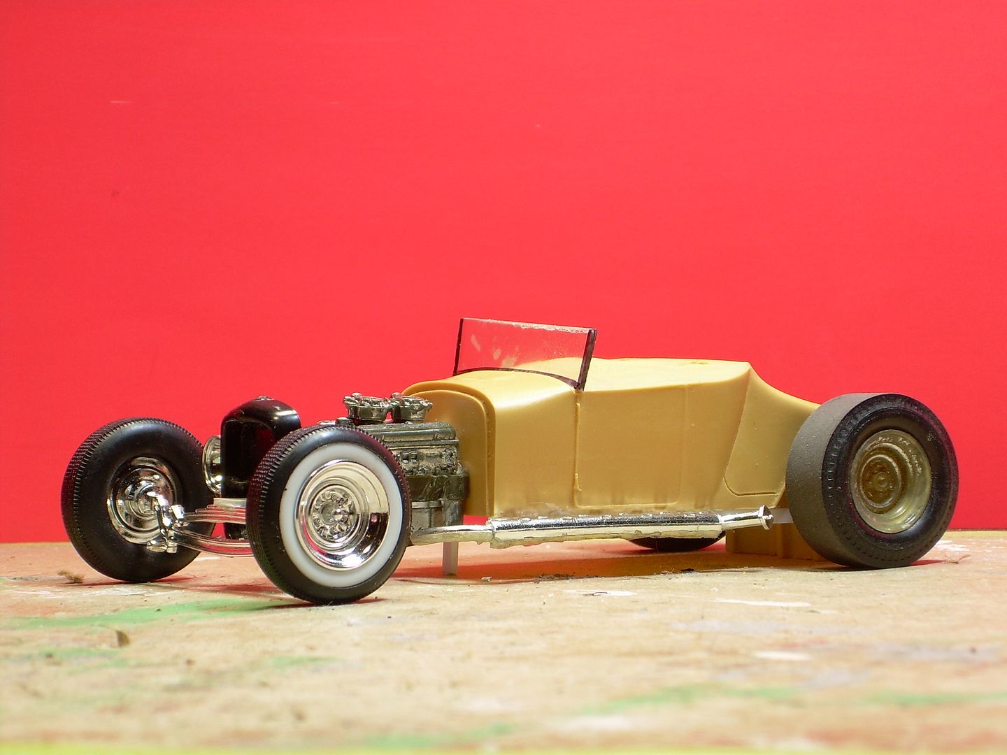

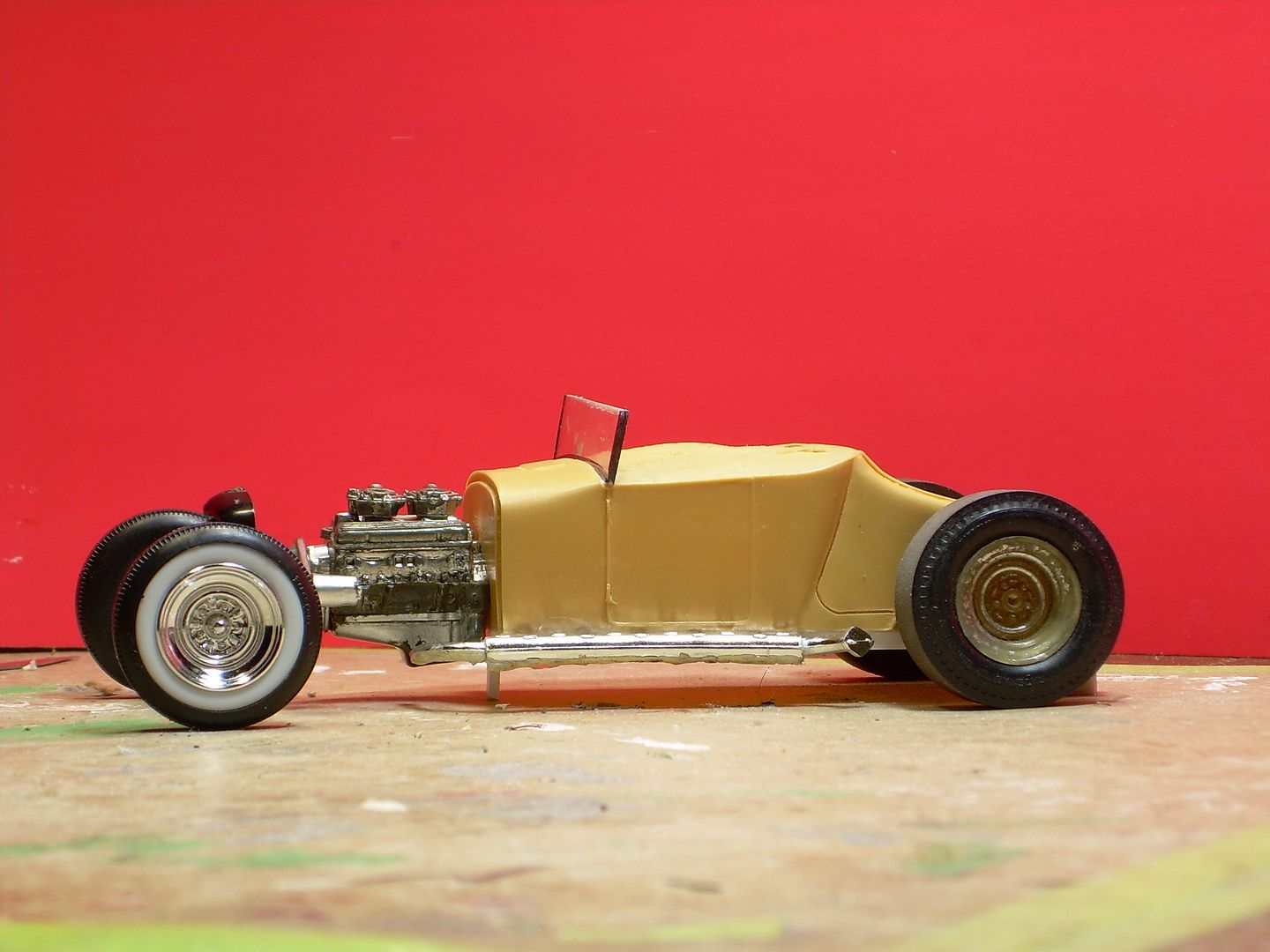

Ace-Garageguy Posted September 15, 2015 Author Share Posted September 15, 2015 (edited) Found a pair of wide-whites that are a scale 1.5" shorter diameter that the first ones. With some fiddling, I was able to drop the grille somewhat relative to the tire tops, and because the diameter of the tires is smaller, the front end came own a pretty good bit. The allowed me to drop the tail to where the rear tire tops are well above the turtledeck, and to drop the cowl to get a little more rake as well. The line between the cowl and the radiator shell is still good (with the top of rad shell lower than the cowl line) and I'm thinking I can come down on the cowl just a tick more. Ground clearance is also still acceptable for a real-world useful vehicle. The difference between this mockup and the last one may not look like much to many observers, and to others the changes will be significant in getting a lower, more aggressive and balanced look. A decision is yet to be made concerning the final front-axle placement and wheelbase...depending on whether the car is to represent a fairly current build with an electric fan, or an earlier period-build with a belt-driven fan on the water pump. Edited September 16, 2015 by Ace-Garageguy Quote Link to comment Share on other sites More sharing options...
afx Posted September 16, 2015 Share Posted September 16, 2015 (edited) IMHO I would stay in period and go with the belt drive fan. I like old school. Edited September 16, 2015 by afx Quote Link to comment Share on other sites More sharing options...
Dennis Lacy Posted September 16, 2015 Share Posted September 16, 2015 An electric fan would look like poop on this car. Quote Link to comment Share on other sites More sharing options...
slusher Posted September 16, 2015 Share Posted September 16, 2015 Period correct fan or electric would still be ok... Quote Link to comment Share on other sites More sharing options...
Draggon Posted September 16, 2015 Share Posted September 16, 2015 Nice mockup Bill. The new front tires make a big difference. I'm quite surprised that I like the idea of sidepipes Quote Link to comment Share on other sites More sharing options...
Ace-Garageguy Posted September 17, 2015 Author Share Posted September 17, 2015 Thanks for all the interest and kind comments, one and all. I'm still on the fence about the fan. I agree with Dennis that an electric has the potential to look like doo, but then again, a deeply-shrouded unit that didn't scream 'catalog street rod' could look OK, would make the car quieter and get a little power freed up off the line too...not to mention probably cooling better in the bargain. Since I build these things as if I were building the real one for myself...we'll see. Quote Link to comment Share on other sites More sharing options...
Dennis Lacy Posted September 18, 2015 Share Posted September 18, 2015 I agree with Dennis that an electric has the potential to look like doo, but then again, a deeply-shrouded unit that didn't scream 'catalog street rod' could look OK... You mean instead of a $50 dollar Hayden fan off the shelf from Pepboys with those awesome through-ties rammed through the radiator core to hold it on? Quote Link to comment Share on other sites More sharing options...
