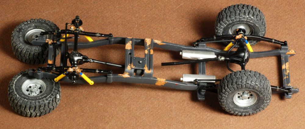

Foxer Posted September 10, 2015 Share Posted September 10, 2015 (edited) This was the best photo of a build I have going that used Krylon Satin Black and shows the sheen it has. All suspension components and the drive shafts are satin Black. The frame is Floquil Grimy Black for reference. Edited September 10, 2015 by Foxer Quote Link to comment Share on other sites More sharing options...
