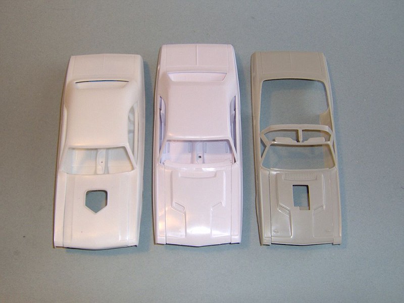

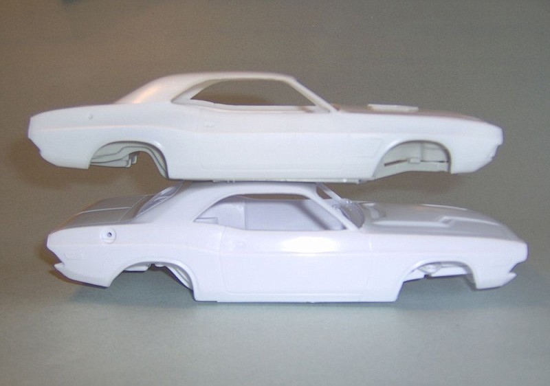

SteveG Posted September 10, 2015 Share Posted September 10, 2015 I just saw where someone posted a pic of what AMT is now calling the Vanishing Point Challenger and I wondered if it was just the old Yankee Challenge kit. Am I correct in thinking it had a poorly crafted roof? The other 1/25 Challenger is Revell's Street Burner version, which, IIRC, has a wire axle up front. I'm curious how these two compare in these areas: 1) Body accuracy 2) Drivetrain/chassis accuracy Does either kit have any major flaws? If you could only buy one, which would you buy, and why? I have, if you want an accurate 70 Hardtop neither one is great. The AMT kit is the Yankee Challenger with a new hood, IIRC. The Revell kit has some decent detail if you can get past the terrible body proportions. I couldn't and traded it away after I took these photos. Take a look ..... That's the Revell 70 Challenger in the center, Lindberg's 71 HT is on the left and the AMT ragtop is on the right. Clearly the Revell body is bigger then 1/25th scale. The Revell kit overall shape almost makes the Palmer based Lindberg 71 Challenger look good. The Revell kit is on the bottom here ... To my knowledge there's no out of the box way to build an accurate and detailed 1/25th 70 Challenger HT from a single kit. -Steve Quote Link to comment Share on other sites More sharing options...

CapSat 6 Posted September 10, 2015 Share Posted September 10, 2015 ...Maybe, on second thought, if you can live with the looks of the Revell kit- considering the separate roof problem in the AMT kit, you might just want to go with the Revell kit. Just keep in mind that the Revell kit is somewhere between 1/25 and 1/24 scale, as shown in the pics above. I've owned and/or been around a few E-Bodies in my time, so when they don't look good in scale, they really irk me. Quote Link to comment Share on other sites More sharing options...
MGL Posted September 14, 2015 Share Posted September 14, 2015 I'm just finishing a Vanishing Point Challenger based off the Revell 2n1 kit. There are no screws in the Revell kit. The body is not quite right, in addition to the issues mentioned above the rear window shape as viewed from the side profile bulges outward instead of being flat. I sanded and filled as needed to bring it closer to correct but short on major reworking it will never be right. As Bill mentiones above, the chassis pan does not want to set under the body, the bottom of the interior pan is too thick and the rear sides of the chassis are too wide. I ground about 1/16 off the bottom of the interior and almost as much at points of contact with the chassis and got it right. The axle does run through the block but that could be fixed easily enoughby filling the hole and either cutting the axle and gluing it in the spindles or using sprue. The engine can be detailed to make a presentable big block but you would have to find a small block if you want to make the T/A version. The Revell kit can be made presentable if you are willing to do some fiddling but it will never be correct. If you are willing to overlook the problems with scale and the inaccuracies of the body and the axle running through the block, and if you have a 340 (if thats what you want) to put in it, you can make a reasonably nice model if not a perfect replica. It is better than the old Monagram 1/24 T/A that I built by the dozen back in the 80's. Quote Link to comment Share on other sites More sharing options...
