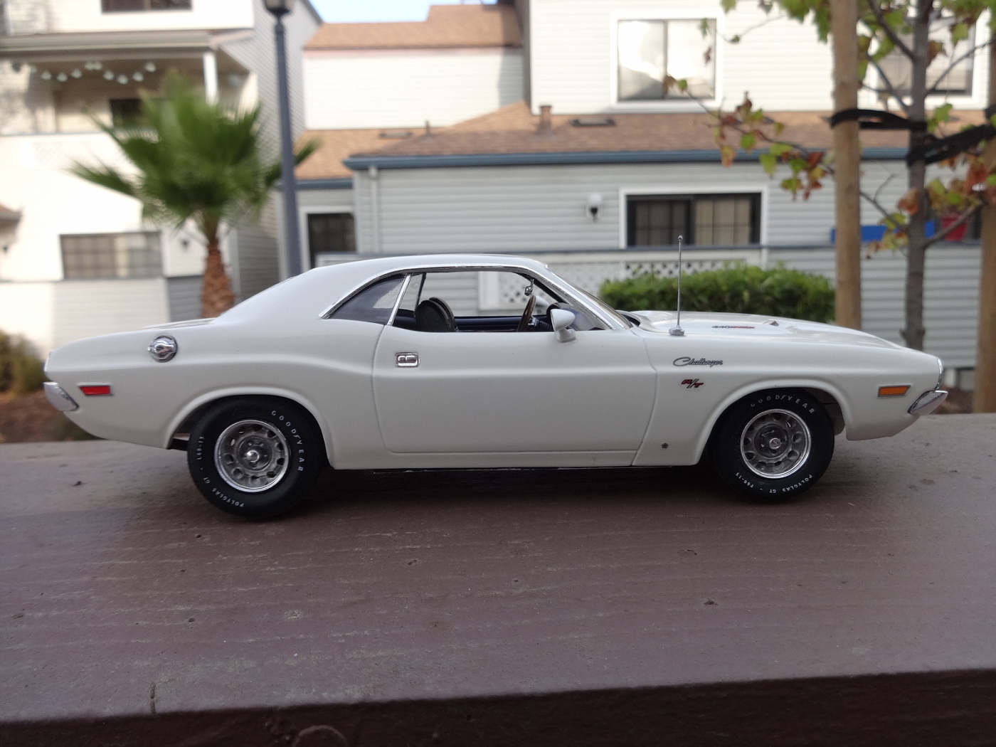

This is the Revell 2n1 kit. Despite the shortcomings of the kit it built up just fine in my opinion, I'm happy the way it turned out. I added flocking, BMF, homemade decals, Morgan Automotive Details distributor, Detail Master wire looms, and parts pack tires. The pvc hose, and fuel line are small and smaller paper clips, the heater hose is the wire that one of my kids toys was welded to the plastic package in, and the antenna is guitar string. The paint is Duplicolor over Krylon primer with duplicolor clear. I elected not to go crazy with the clear or to polish it to try to keep that 70's factory finish rather than a super slippery show car shine. I also printed out a copy of one of the movie posters for the display case.
DSC02355DSC02356DSC02357DSC02358DSC02359DSC02360DSC02361DSC02362DSC02349DSC02350DSC02351DSC02353DSC02352DSC02354DSC02347DSC02348
Of course I just noticed while posting this that I forgot to paint the running lights amber. Here's the WIP,http://www.modelcarsmag.com/forums/topic/105420-vanishing-point-challenger-update-9142015/ . Thanks for looking and as always let me know what you think.
