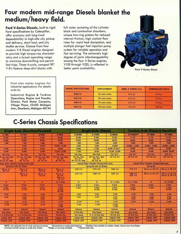

Chu Posted September 20, 2015 Share Posted September 20, 2015 (edited) Finally I started to build something!!! I'm looking to built like this one pretty much outside the box just with a few changes. I'm going to change the rims and tires of this truck with aftermarket five holes rims and amt tractor truck tires. The trailer it will be a coca cola with a  amt suspension is from amt dry van  and a 5 spoke flatbed rims ans the tire from this kit. I open a topic and ask about the engine and Guitarsam suggested to me  to swap the F c 900 to a ford Louisville.  I'm not a fan of automatic transmission so I'm going to use the ford Louisville and swap the automatic transmission for a Detroit transmission. For sure is not going to be accurate but I will give it a try. Here is a little progress and a mock.   Edited January 13, 2016 by Chu Quote Link to comment Share on other sites More sharing options...

DRIPTROIT 71 Posted September 20, 2015 Share Posted September 20, 2015 It may be more accurate than you think. The 10 speed trans was offered with the diesel. Looking good so far!!! Quote Link to comment Share on other sites More sharing options...

Chu Posted September 20, 2015 Author Share Posted September 20, 2015 It may be more accurate than you think. The 10 speed trans was offered with the diesel. Looking good so far!!! Thanks Brian that's  helpful I will use this for the engine thanks once again. Quote Link to comment Share on other sites More sharing options...
