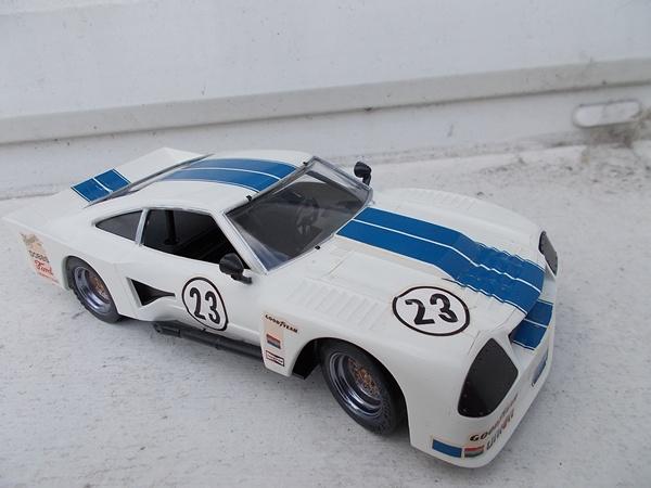

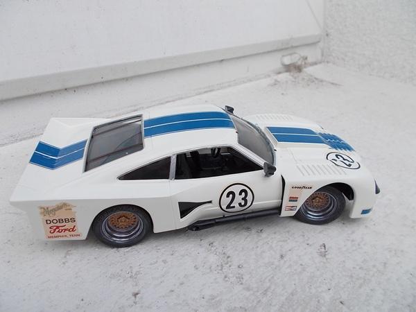

dublin boy Posted October 6, 2015 Share Posted October 6, 2015 (edited) Here's some of the original Kosutte ginsan powder over metallic blue on the rims. Please ignore the yellow'd out decals, it was an old kit. Edited October 6, 2015 by dublin boy Quote Link to comment Share on other sites More sharing options...
