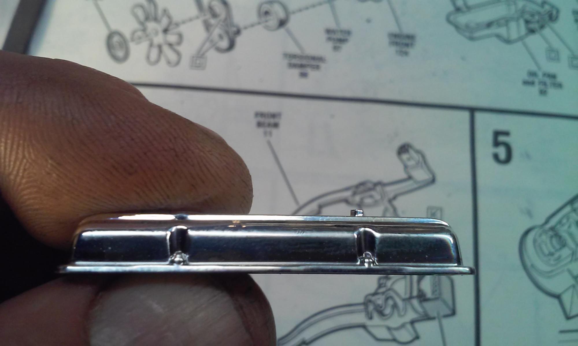

I thought this came out pretty good and wanted to share it. I'm sure it's been done but I thought it was worth mentioning. This is the valve cover from a 1/12 Camaro. the sprues were attached at 2 points along this side at the bottom. It was cast in orange. Sorry I didn't take before pics. Anyway.. I touched the spots with gloss black, left them dry, and then brush touched them with alclad ll chrome. Here's the results.

I buy the Alclad spray can.  I touch things up with it too. I spray a little in a cup. I find that it's better if I dab it on, leaving a  raised drop of Alclad inside the depression. It shrinks down as it dries and doesn't leave a brush mark.  I was doing that on my '29 Ford Roadster last evening.  Although Revell went to decent lengths to put the attachment points in unseen places, there's still a few that need a touchup.

I took a WHOLE engine and chromed it with Alclad paint.....
A Dodge "Red Ram" Hemi going into a Dodge Deora pick-up that I'm further customizing. From box stock (I wanted the kit for the Slant 6 engine), to start with BUT got to lookin' at it and thought a little "Baby Hemi" supercharged be a perfect fit.......
Granted, this whole engine was brush painted gloss black from Testors, and then when dry, I dipped a cleaned brush into the Alclad chrome and basically, "blotted" the Alclad over the black. I found brushing it, the swipe of the bristles doesn't go over well, blotting however well, you can see! -I think it looks pretty good! BE SURE when you use Alclad tho, that the gloss black is ENAMEL, nothing else, it won't stick, OR "shine".... -Flat black base will make the chrome look "Aluminum".

I've been trying this on the BMW 635CSi that I'm working on right now.  Some of the chrome pieces needed a touch up after sanding off the attachment points, so I polished the black plastic out and just brushed the AllClad on.  Can't see the repairs now.  :)  I've also done one piece with primer/gloss black, and it's CHROME.  Works really well brushed on.

Awesome tip, thanks! I've been using Silver Chrome Trim colored paint from Model Masters and haven't been overly pleased with the results...it looks better than leaving it untouched, but certainly doesn't hold up to scrutiny. I can't even tell where the valve cover was attached to the tree in your picture. I'll have to look for some Alclad.
