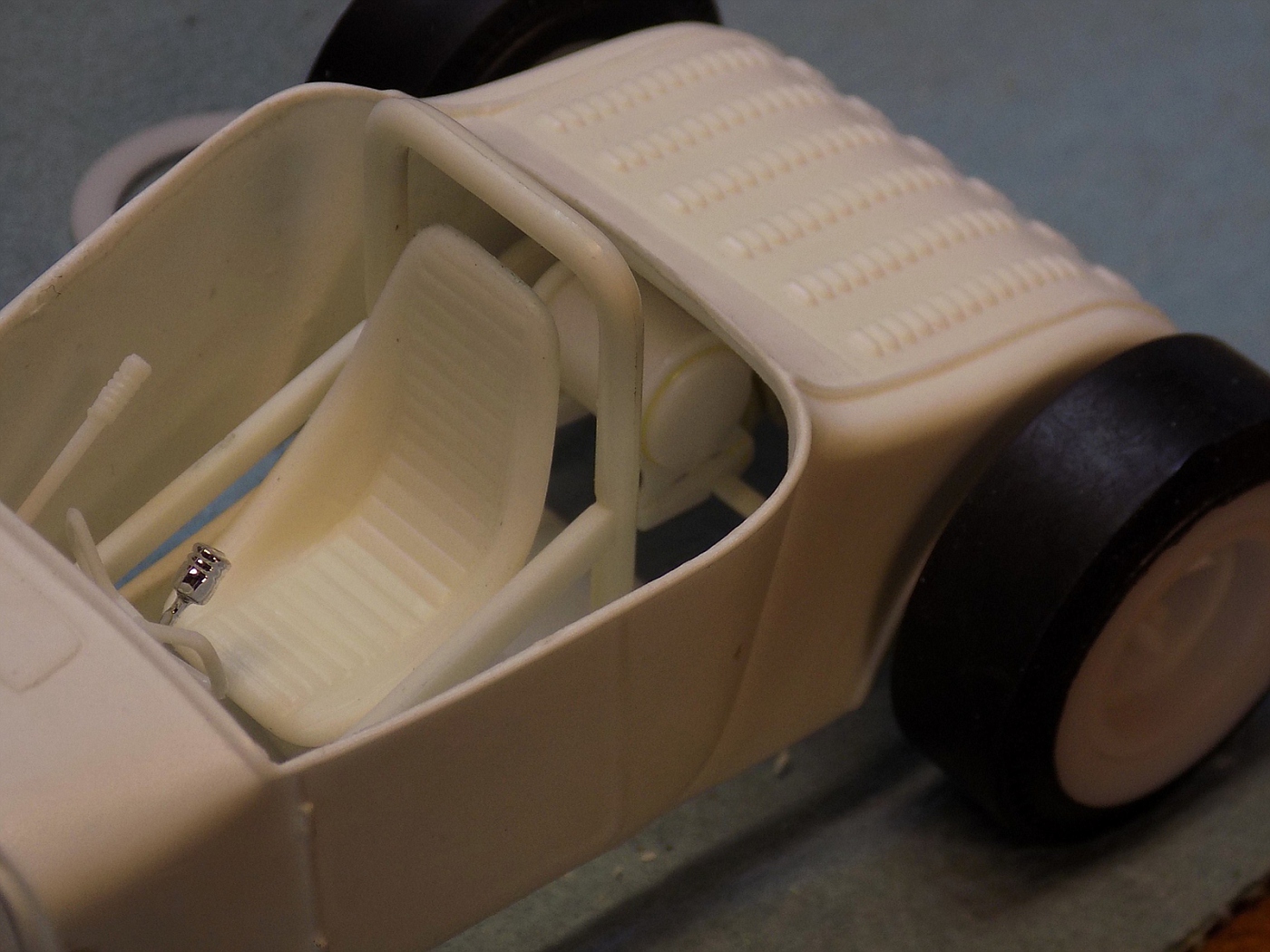

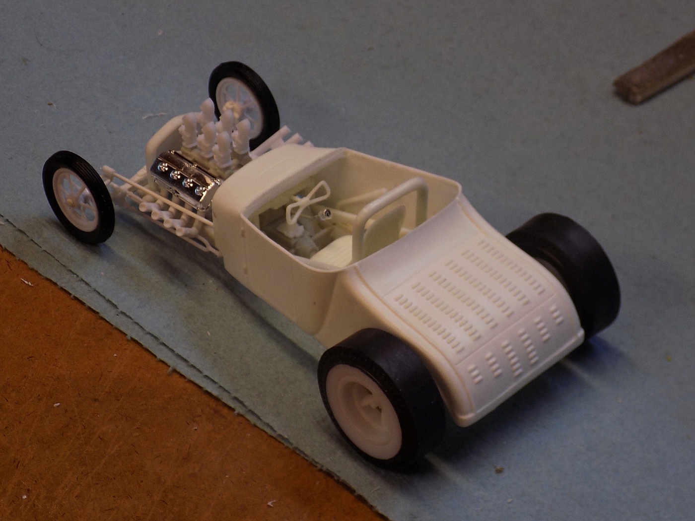

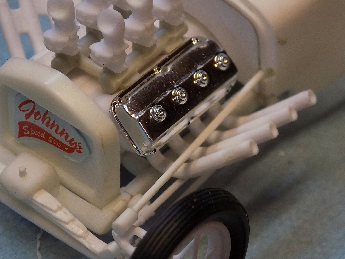

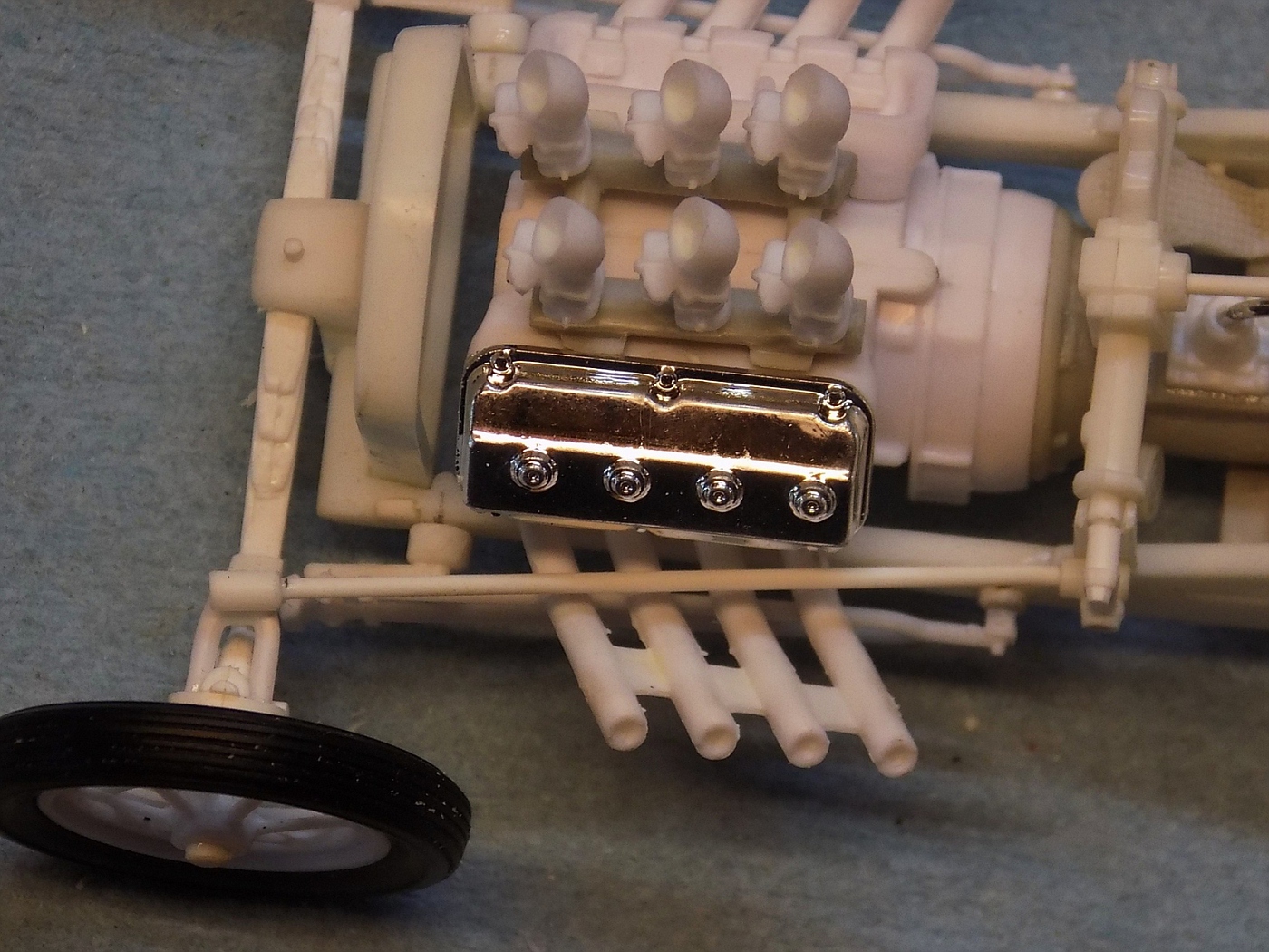

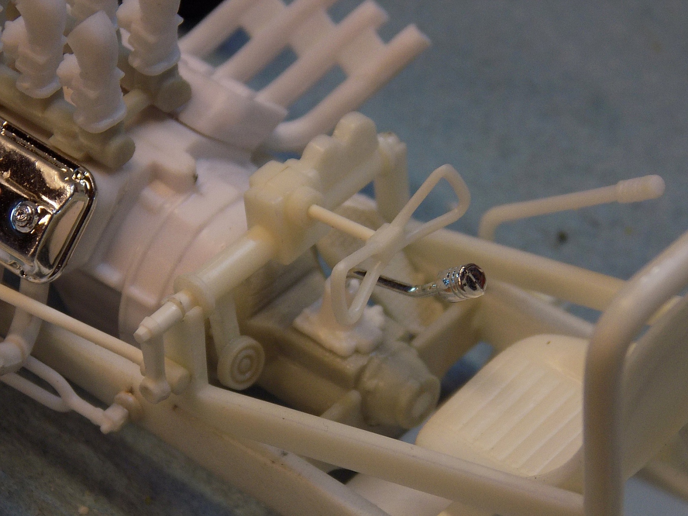

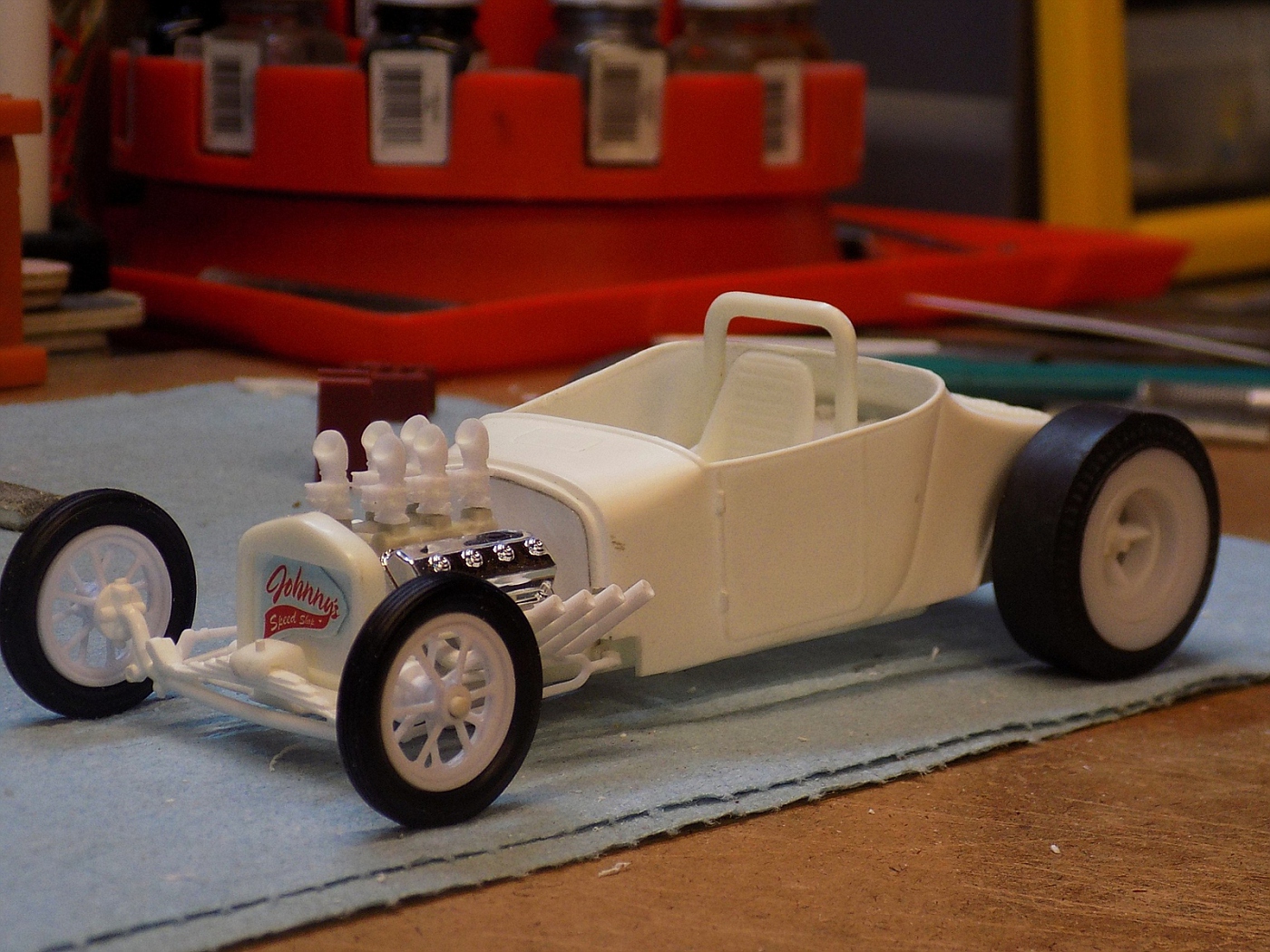

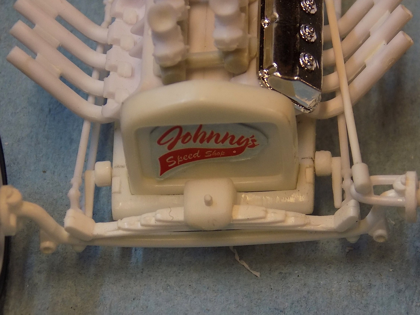

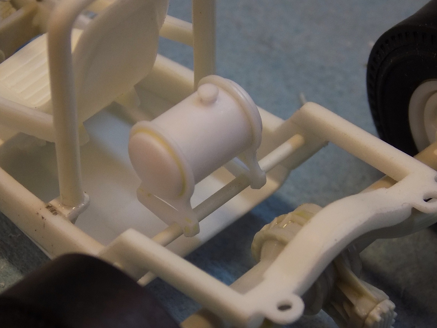

Dennis Lacy Posted November 2, 2015 Author Share Posted November 2, 2015 (edited) UPDATE Spent some quality time at my workbench today and now have the chassis fabrication nearly finished. Just a few odds & ends left like making a drive shaft and creating some rear body mounts. Hosted on Fotki Hosted on Fotki The steering system is complete. I used the pitman arm from a Revell '32 Ford kit, cut the linkage away and drilled both ends for pins. A drag link end was created to attach to the bottom of the pitman arm, between it and the steering mount upright. The drag link is left as a slip fit into the end of it. I also made a steering wheel shaft and attached the butterfly wheel from the AMT '23 Roadster parts pack. Hosted on Fotki I built a drag link that passes through the dip in the headers and attaches to the hoop steering arm that I previously added to the front axle spindle area. Hosted on Fotki The steering pitman arm and drag link end just barely fit inside the small T cowl. Hosted on Fotki The reason I left the drag link as a slip fit into the inner tie rod end is because it has to pass through the edge of the firewall. I was originally going to mount the pitman arm on the side of the cowl but the shape of the headers dictated this arrangement. I think it's pretty neat and a little more interesting than the typical cowl mounted steering. Hosted on Fotki I mounted a pair of lever shocks to the front which are cut down versions of those found in Revell's '29/'31 Model A kits. Hosted on Fotki I also installed a simple .060" rod cross bar and mounted the nicely rendered Moon fuel tank from Revell's '32 5-Window. Hosted on Fotki Edited November 2, 2015 by Dennis Lacy Quote Link to comment Share on other sites More sharing options...

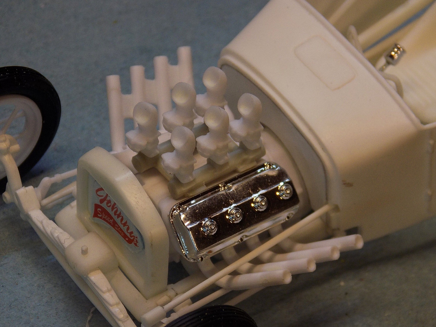

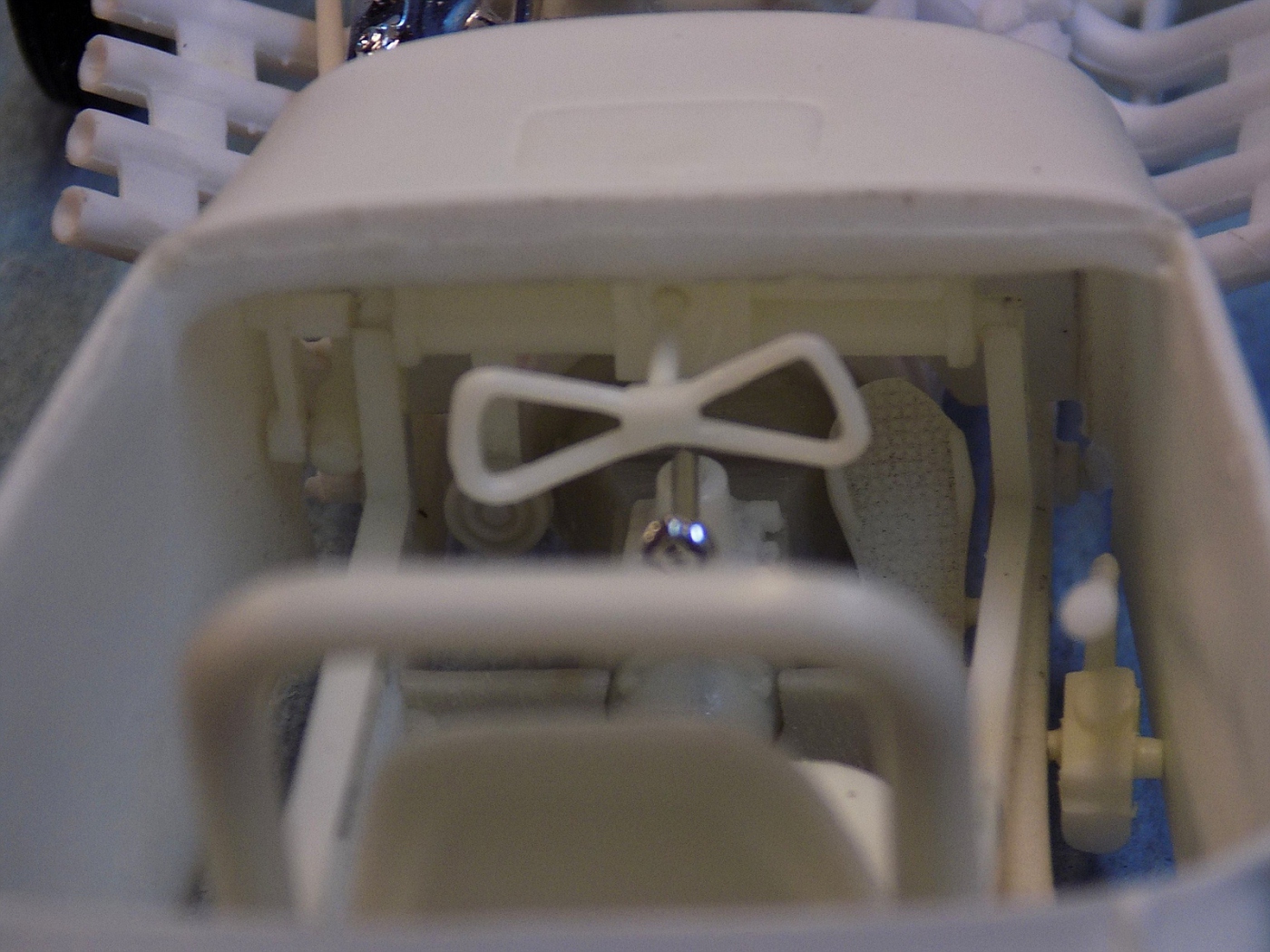

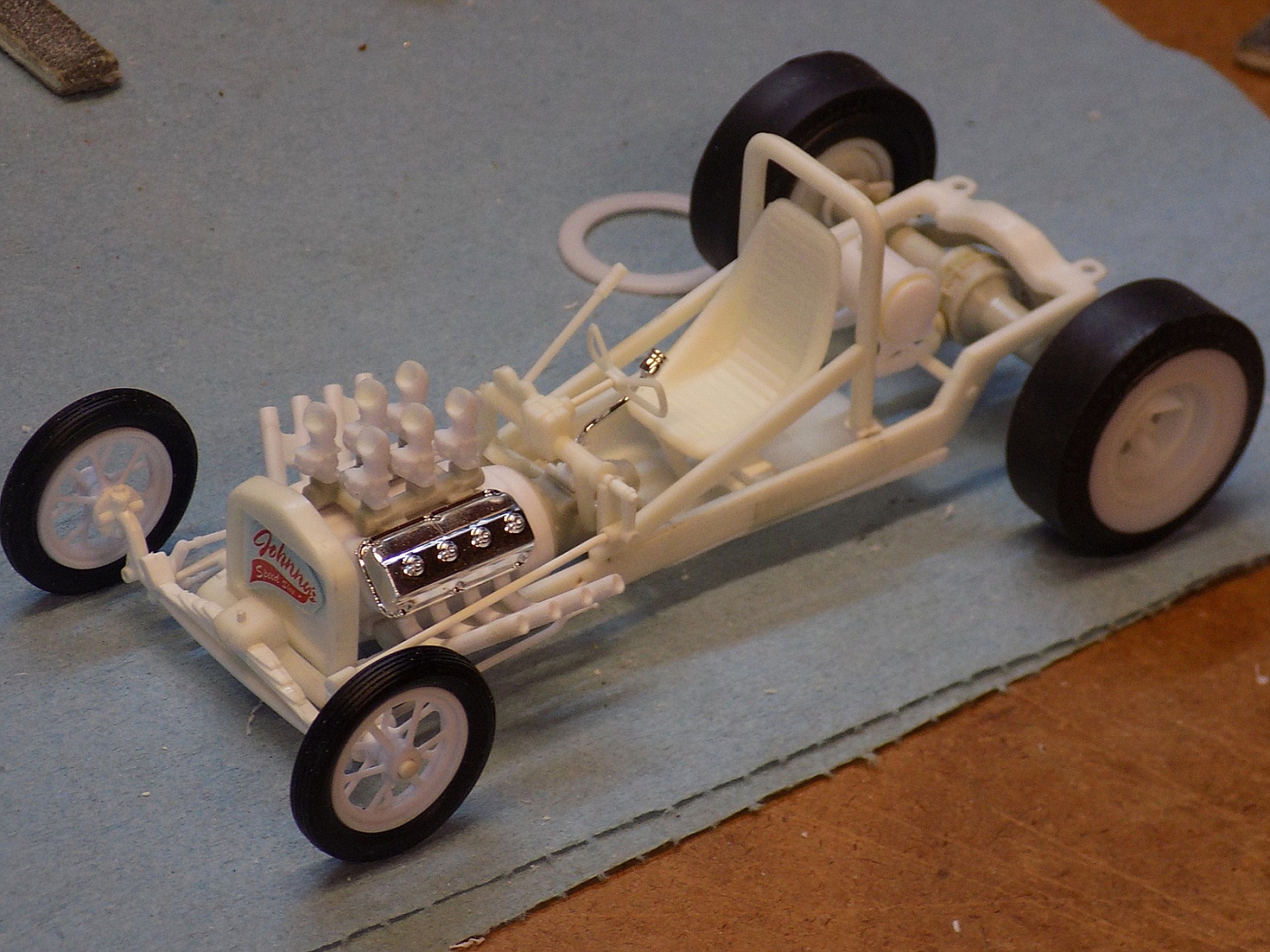

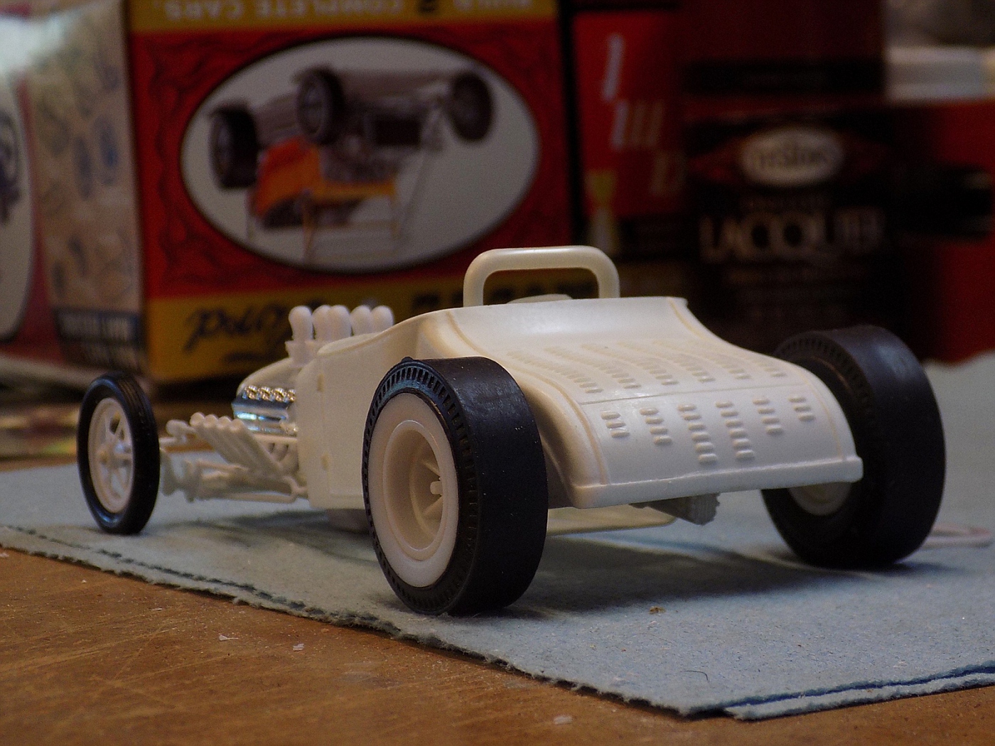

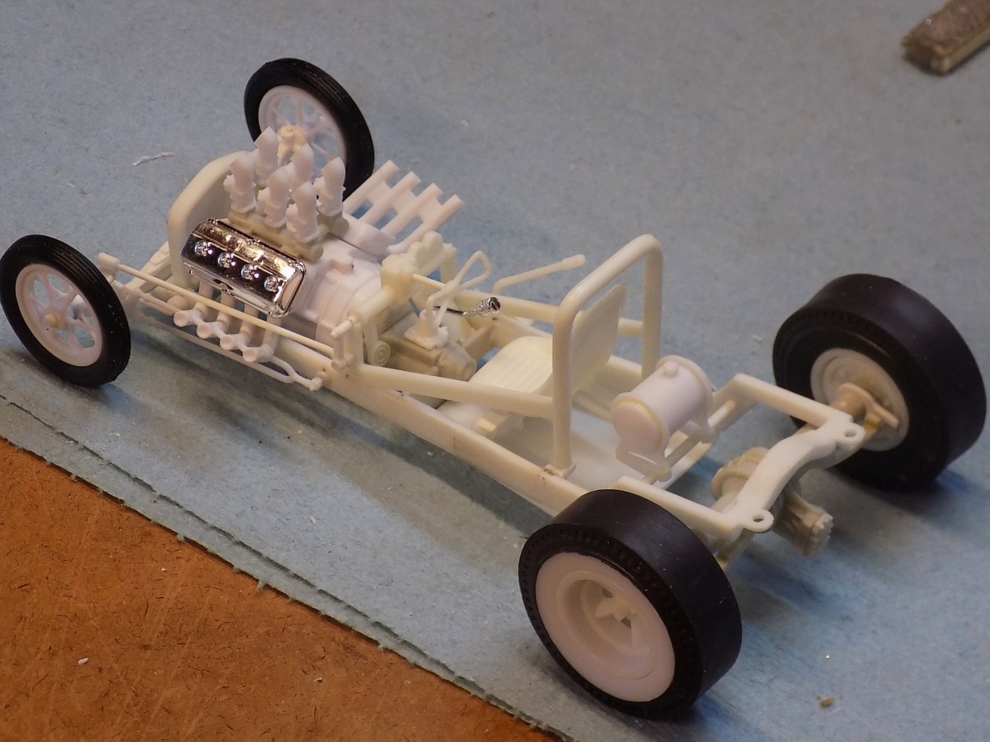

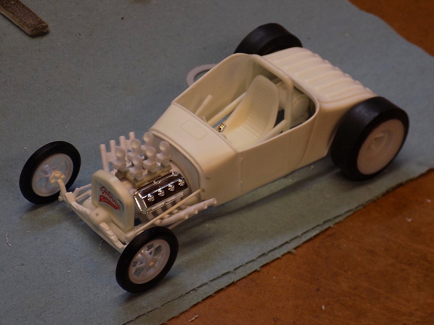

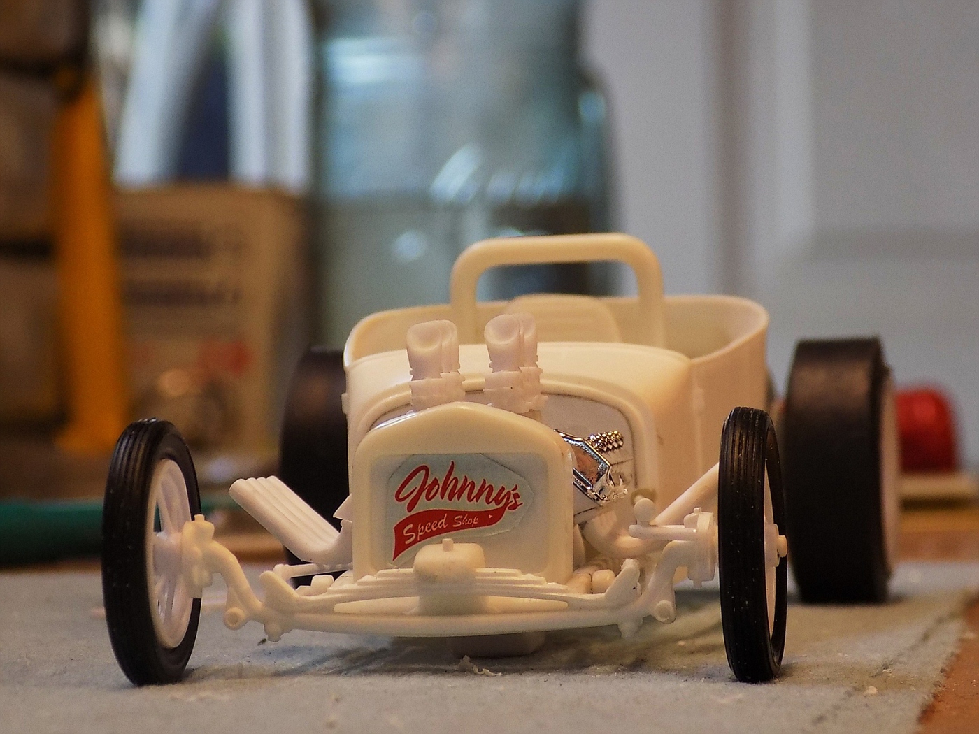

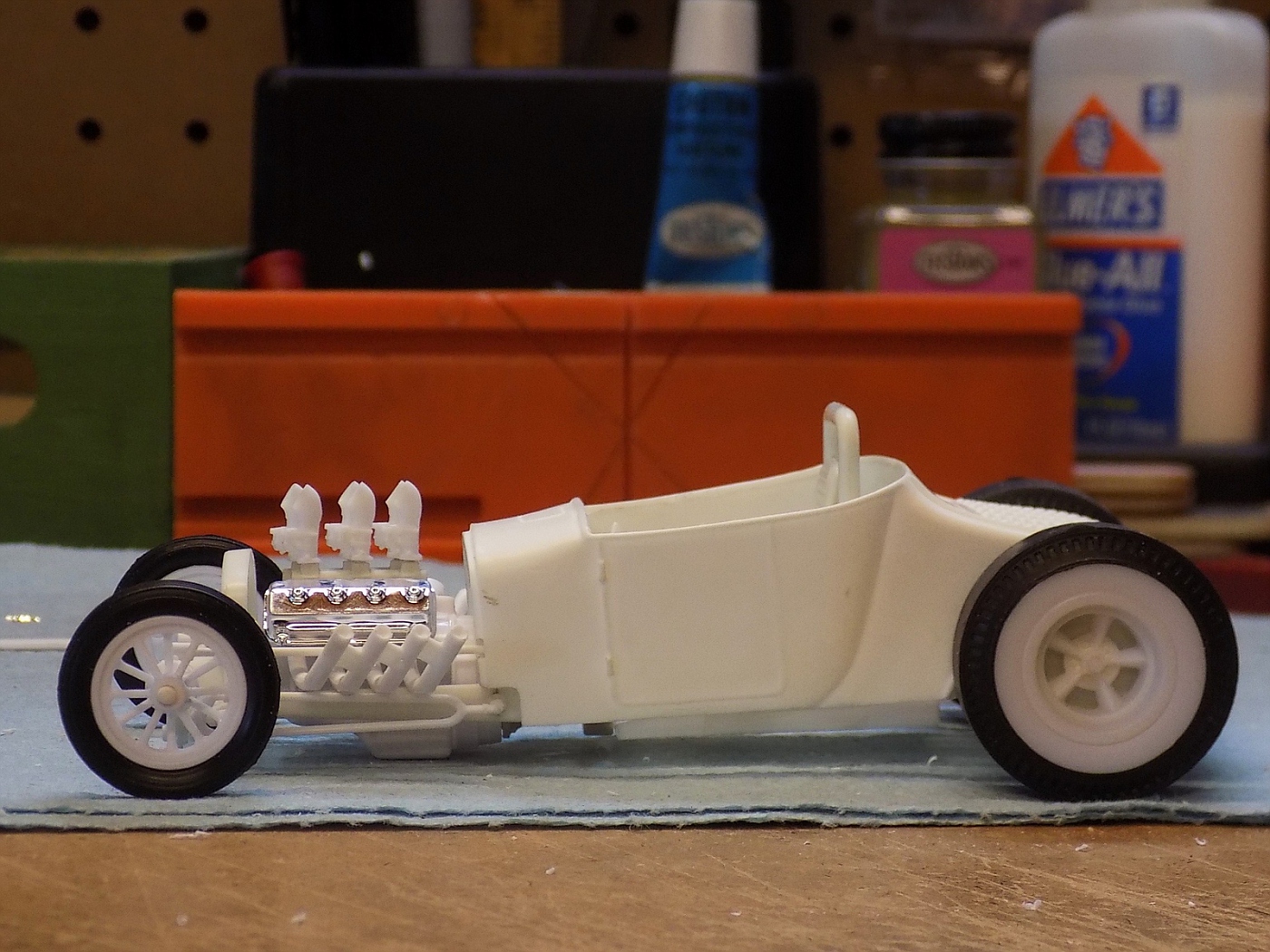

Dennis Lacy Posted November 2, 2015 Author Share Posted November 2, 2015 Here are some mock ups with all of the latest additions. I decided to forego the track nose and make a filler panel for the T shell that I'll put a shop decal on. Hosted on Fotki Hosted on Fotki Hosted on Fotki Hosted on Fotki Hosted on Fotki Hosted on Fotki I installed mounting pins in the log intake and drilled corresponding holes in the bases of the carburetors. I also modified the headers from Revell's Slingster dragster by shortening the engine side of the tubes 1/4" to suck the headers up closer to the engine and clear of the frame and suspension. Hosted on Fotki The Moon fuel tank is visible in the empty cavity behind the seat. Hosted on Fotki At this point most of the fabrication work is done other than the drive shaft and body mounts I mentioned in the chassis pictures above. Once I complete those the model can be prepped for paint which means lots of clean up work. I'll get everything ready but I'm not so sure when I'll get to actually painting it because I do all of my painting at work and right now all of my spare time at work is dedicated to a real 1932 Pickup that I'm building for myself. Quote Link to comment Share on other sites More sharing options...
afx Posted November 2, 2015 Share Posted November 2, 2015 (edited) I really like this Dennis, excellent work. I think it looks better without the track nose. Edited November 2, 2015 by afx Quote Link to comment Share on other sites More sharing options...
tim boyd Posted November 2, 2015 Share Posted November 2, 2015 The really big payoff is those last pictures showing the mocked up result. Everything is "just right". I also like your decision to go with the blanked radiator shell. Most excellent! TIM Quote Link to comment Share on other sites More sharing options...
