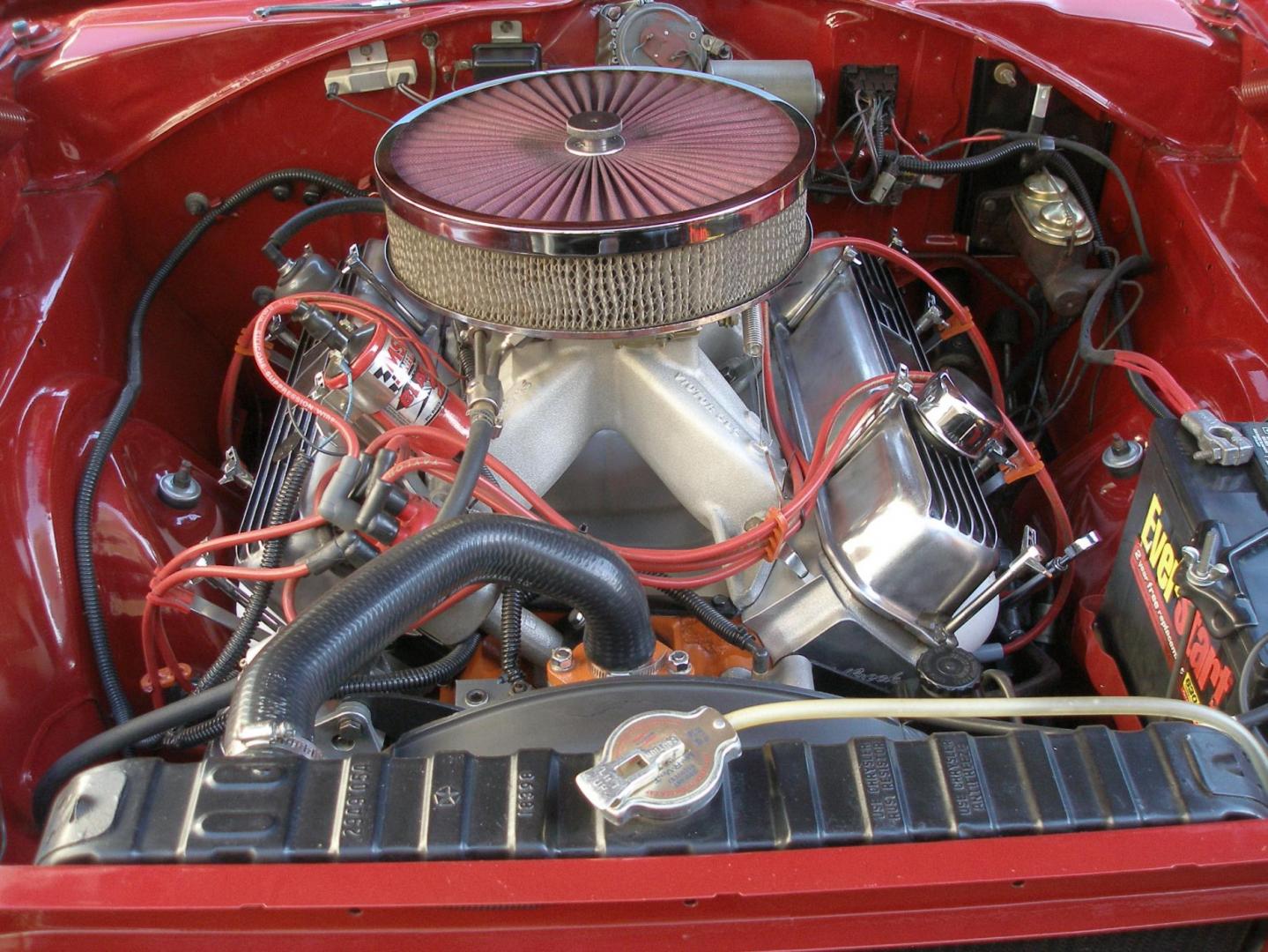

426-Hemi Posted October 29, 2015 Author Share Posted October 29, 2015 (edited) So with the engine in place........I had my work cut out for me, the whole engine has A LOT of wires going to and from it. Alternator wires, to the coil, and onto the surrounding places. I also got the windshield wiper "sprayer" tank, in place, painted one color as I had to go back and paint the cap. Then the little hose from it to the wipers themself in place with there rightful "mounts". I had decided to run the alternator wire (blue one) to the coil and then onto the firewall. The other wire from the alternator runs onto the inner fender well to the core support and across to the battery side and through it again. This then goes to the battery terminal. (NOT in place yet)Master cylinder in place, and has its brake lines in place running to the valve manifold below (seen in other posts of the build) and yes........ they ARE connected!Not that it should be here from the factory, BUT I couldn't get much more to go across the firewall with the way my hands are, so here is the battery wire from the alternator going through the radiator core support to run across it, to the other side, near the battery and through it again. -Left "loose" as it needs to go to the battery once in place, and then a second wire off that same battery terminal to the firewall electrical details.More of a shot of that side of the engine compartment.Battery painted, and in place, the wires spoken about in place on it as well.Wiper sprayer tank with "cap" painted! A few other small details seen here too!Alternator wire (black) seen with the horn wire (blue) running to the battery side of the car, to then go to there rightful places, (horn wire directly into the firewall)Something to note here, the Alternator! It was a chrome part that I dipped into Dullcote to get that look, and once dry, applied "copper" color paint to the openings that a real one would have to show the copper wire "windings" in side seen through those openings, which are meant for cooling of it when running.Engine compartment is now Complete, (I may go back and have a look at a detailing part thats just not quite right, BUT will see what I can do about it. Thanks guys! Edited August 31, 2016 by 426-Hemi New Link Update Quote Link to comment Share on other sites More sharing options...
DeeCee Posted October 29, 2015 Share Posted October 29, 2015 HOLYCR@P John, that is just stunning, the amount of detail you can cram into an engine bay mate, just WOW!!! Quote Link to comment Share on other sites More sharing options...
426-Hemi Posted October 29, 2015 Author Share Posted October 29, 2015 LOL Thanks Dale...... I tell ya, you think this ones "full" wait!!!!! I got a 2007 Dodge Charger Super Bee, that its gonna be even worse! Think about it, new car, 6.1L Hemi, ALL the wires, and hoses to and from, and all that extra BLAH_BLAH_BLAH_BLAH they put on 'em now for electronics and controls........ AND I'm gonna CHANGE the engine! (The one with the kit, DOES NOT fit my liking to an engine bay......) -Ought to prove a FULL engine compartment! Sadly, Dale, I got more to add to this one! Air cleaner is missing, (Detail revamp on the wiper motor) And possibly a hood prop....to hold the hood up when opened, and to operate, be "down" out of the way, when the hoods closed, and remain on the model! -'Runners didn't have them, BUT, its nice to have a hood prop built right into the model for displaying purposes! Quote Link to comment Share on other sites More sharing options...

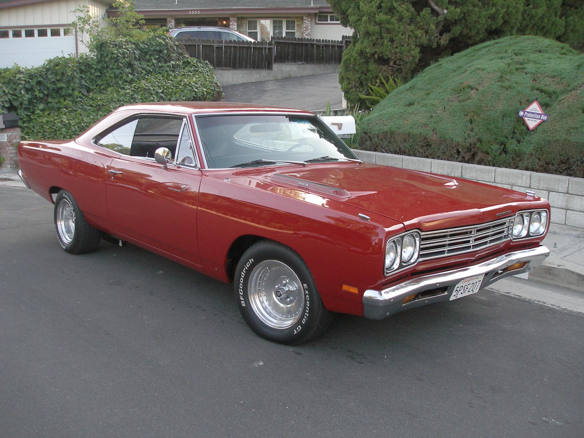

Greg K Posted October 29, 2015 Share Posted October 29, 2015 really nice build John. i have a 1:1 69 Roadrunner bench seat car and looks like the same color yours is. mine is coded r4 red. you did your homework on that engine! in 69 they changed the color of the engines to "Hemi Orange". if you need any pics, let me know. p.s. my interior isn't quite done yet Quote Link to comment Share on other sites More sharing options...
426-Hemi Posted October 30, 2015 Author Share Posted October 30, 2015 Thanks gentlemen! Much appreciated!Greg, your real Roadrunner, has the same "look" or color? I did the best I could, to get the interior to look as tho it was real. -Wasn't easy, but wasn't to difficult either. Took more thinking on how I was gonna do it (what colors and what sheens Flat, Matte, Semi-Gloss, or Gloss to get the look you see.As for the engine, the Roadrunner 383 well...... in '68 early '69 was a special motor! The one you mentioned being Mopar Performance Orange (NOT Hemi Orange), 2 different colors was a HI-PO version, had even more differences. The heads, the piston type (higher compression) The 2 types of 383s, was a bit interesting. (I have a real 383 of my own actually) NOT in a Roadrunner but, I own one! The part of the Roadrunner 383 to the standard 383 to the HIPO 383 was head type and cam, as well as intake type, they were ALL DIFFERENT! Cam profile on the standard 383 was really mild, heads were well, had not real good flow rates, as well as having smaller valves. THEN the HIPO 383 shared the same heads as the 440, BUT the intake was vastly different. 2 barrel and 4 barrel, there were 2 known types of 4 barrel intakes for the 383, one for the Roadrunner and one for the HIPO version. (I own one of them, in a '67 pick up)The paint a lot of times, dictated what one it was at a quick glance, Mopar Turquoise was either the standard, OR thew Roadrunner (early years '68 early '69) Late '69 to the end of the Roadrunner design of car, with the said 383 in Mopar High Performance Orange, was done till the 383 was no longer in use in the Roadrunner as the 400 had replaced it. (Mopar 400 was Mopar engine blue) The Mopar High Performance Orange, was shared between the HIPO 383 and the 440, Seen mostly on the 440 6 pack or 440 six barrel! I've build my share of real ones both the 383 400 and 440, I've gotten my hands on 1 413, and 3 426 Wedge motors as well, as 2 426 Hemi's and countless OLD Hemi's from the 241, up to including the 392 from pre '57. AND to really get yer eye brow raised, I've done a few of the Poly head engines too! 318 to the 326!!!!!Thanks tho! What color is your 'runner's exterior? Quote Link to comment Share on other sites More sharing options...
Greg K Posted October 30, 2015 Share Posted October 30, 2015 hey John, thanks for all that info. the exterior color is r4 red. the 383 was built by Dick Landy some time ago, and has about 3000 miles on it (don't drive it much) Quote Link to comment Share on other sites More sharing options...
426-Hemi Posted October 30, 2015 Author Share Posted October 30, 2015 Greg, NIICE car man! The R4 Red was that called Matador Red by Plymouth? As I was looking more towards the PP-1 I think it is! -Went to my Mopar forum site I am a staff member of and found this: R4 "red" isn't even called "red" its "Barracuda Orange! -WELL isn't that confusing! The Dick Landy 383 looks more like a 440.... LOL NOT saying it isn't a 383 but DANG man, that thing is SWEET! I wish my '67 Power Wagon "383" 4 barrel looked half that good! -I gotta ask tho, what for heads is on that thing? They're aluminum, That engine looks mean!!!!! Quote Link to comment Share on other sites More sharing options...

Nick Winter Posted November 15, 2015 Share Posted November 15, 2015 This is a 3 speed wiper motor which was an option on B bodies...... This is the standard 2 speed wiper motor for B Bodies, both were available through all years...... Just thought I would correct some info for you........Also Mopars didn't use return lines until much later, just a single 5/16th supply line. Your build is looking very nice so far. Nick Quote Link to comment Share on other sites More sharing options...
426-Hemi Posted November 15, 2015 Author Share Posted November 15, 2015 Supply lines to?? Fuel? (I believe your speaking of) In order to have a restored car, they at Mopar or elsewhere offer anything but..... SO in that regard, a "new" update for the car, I thought was appropriate. Quote Link to comment Share on other sites More sharing options...
