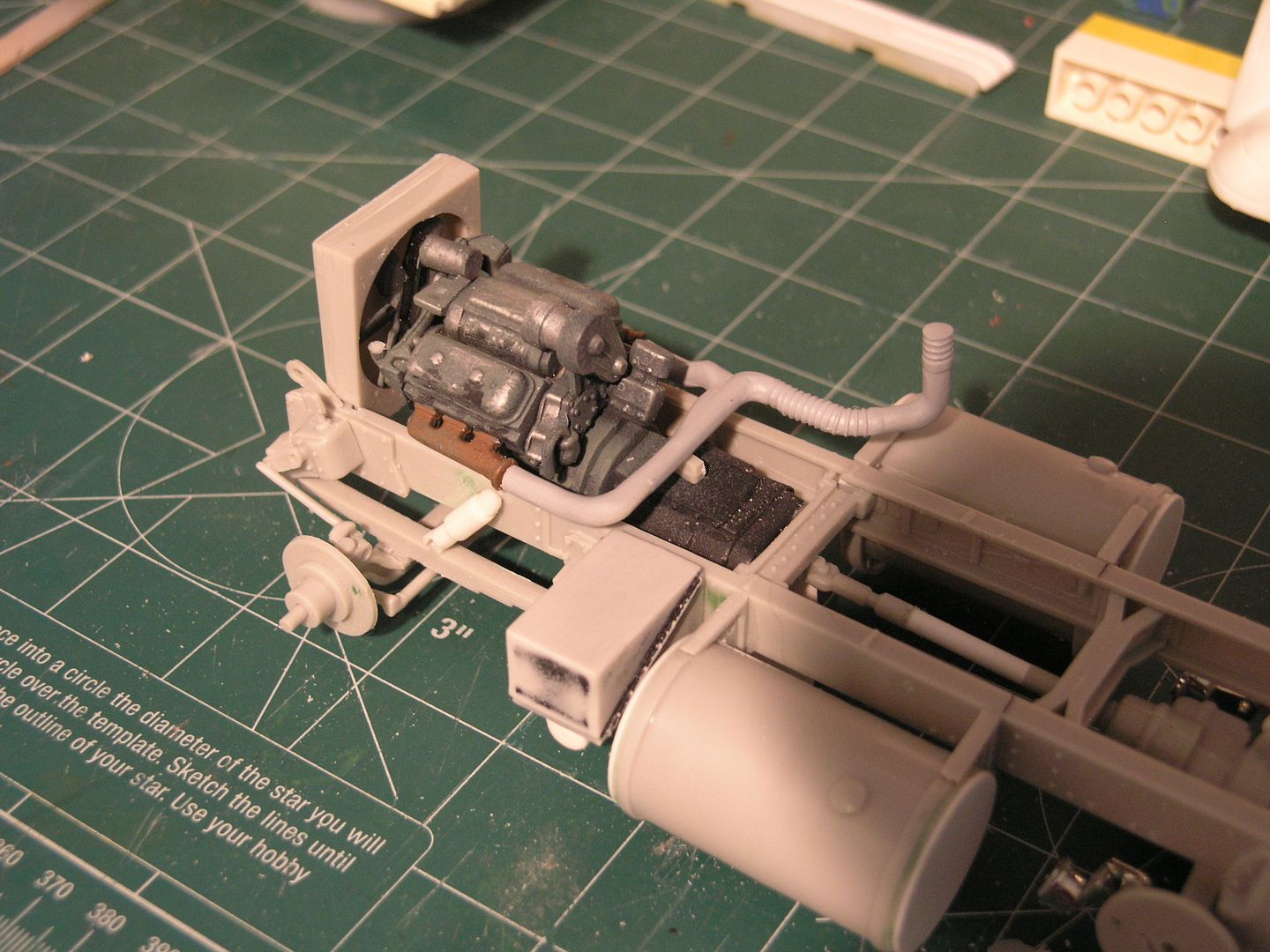

Old Buckaroo Posted November 26, 2015 Author Share Posted November 26, 2015 Gator - thanks for stopping in Another small update but a huge obstacle out of the way - Exhaust piping. That has to be my most unfavorite part about building truck models. Perhaps if I would just build one out of the box. It does not look like much but I can assure you there are over a dozen segments that make up this piece of piping. Anyway I am happy to have it done. Quote Link to comment Share on other sites More sharing options...
gino Posted November 26, 2015 Share Posted November 26, 2015 nice work ! great job on the exhaust, I like this build Quote Link to comment Share on other sites More sharing options...

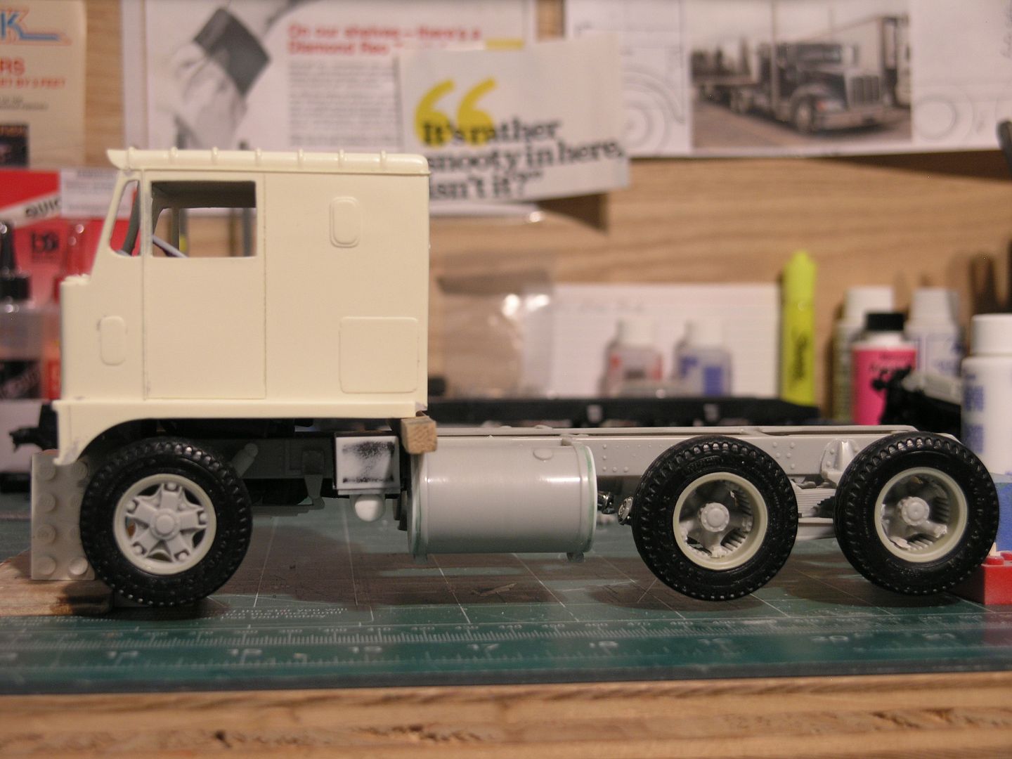

Old Buckaroo Posted November 27, 2015 Author Share Posted November 27, 2015 I dont know how other modelers attach their conversion cabs. I needed something to where I could place the cab, be able to make other things and remove the cab for ease of assembly. This is my method - Aluminum tubing that has an inside diameter that is a perfect fit with mechanics wire. I used a piece of tubing between the tilt horns for stability and two pieces mounted to the cab with styrene backing . I am happy with the results although there was still a lot of trial and error to get the cab mounts to where I wanted them. The nice thing with the styrene back was I could use tape to hold it in place while checking alignment and measurements. Quote Link to comment Share on other sites More sharing options...

Rigzndiesel Posted November 27, 2015 Share Posted November 27, 2015 Sean,You make the exhaust look so easy to do! Of course we only see the finished product and not the time spent designing/measuring/assembling and routing. Looks really good! I like your choice of cabover, interesting to see it progress. Jeff Quote Link to comment Share on other sites More sharing options...
gino Posted November 28, 2015 Share Posted November 28, 2015 great idea on the cab mounts sean ! I too use the same method to be able to remove the cab for assembly so this will come in handy for me . thanks ! Quote Link to comment Share on other sites More sharing options...
Old Buckaroo Posted November 29, 2015 Author Share Posted November 29, 2015 Using the picture Jacobus supplied I worked on the air intake and filter. I am starting to see light at the end of the tunnel and getting closer to paint on the frame. Jeff - I ended up sectioning in another piece of .030" to alter the exhaust piping. It is a never ending challenge. Quote Link to comment Share on other sites More sharing options...

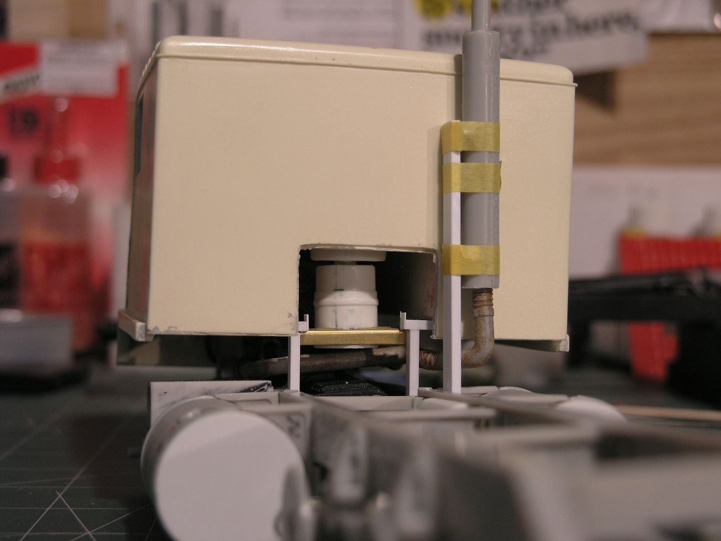

Old Buckaroo Posted November 29, 2015 Author Share Posted November 29, 2015 (edited) From the pictures I have seen of the real trucks they were pretty plain. I needed a plain exhaust so that was today's project. I stole a pen from my Wife - " Call before you Dig" sure hope she does not need that one - but I have never seen her with a shovel in her hand before Just to tempt my sanity I also made a rain cap which does not show in the picture very well due to background washout. I think this is pretty much it for modifications to the chassis. Thanks for looking in Edited November 29, 2015 by Old Buckaroo Quote Link to comment Share on other sites More sharing options...

LineDigger87 Posted November 30, 2015 Share Posted November 30, 2015 What did you use to make the rain cap on the stack Quote Link to comment Share on other sites More sharing options...
Old Buckaroo Posted November 30, 2015 Author Share Posted November 30, 2015 What did you use to make the rain cap on the stack .015" styrene - Used a punch to make the cap , trimmed a piece of scrap for the rest. Tamiya tape sliced to 1mm makes the bracket around the stack. Quote Link to comment Share on other sites More sharing options...
