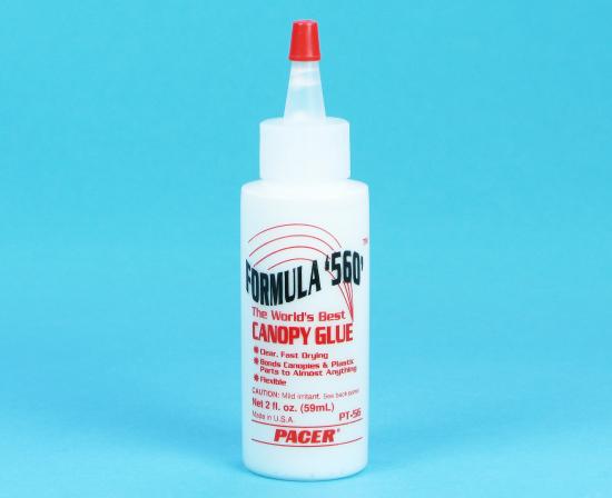

This glue seems a little stronger than other PVA glues. It can be cleaned up with a damp Q-Tip and will not attack anything. I use it for allot final asembly work.
