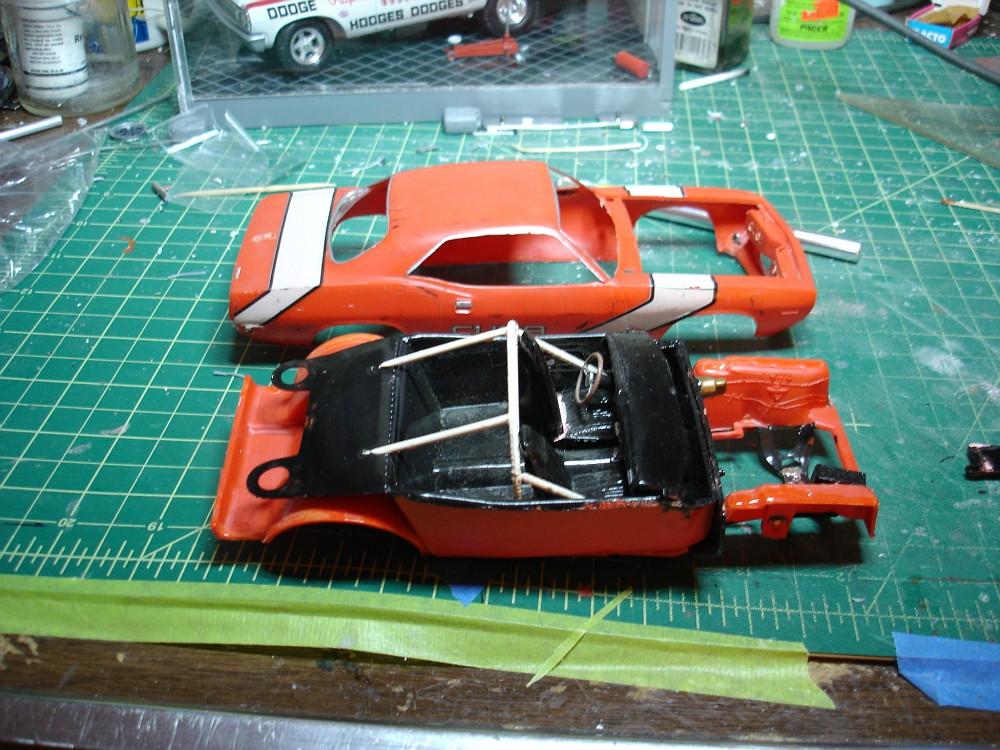

Here is what I am starting with! An MPC Pro Stock 'cuda that needs a lot of work.DSC02152-vi.thumb.jpg.5cb7abea162cc4d791
I start by removing the '72 MPC nose and tail light panel and transfer them to an unknown body. Thought it was a Johan but probably not.DSC02951-vi.thumb.jpg.b908f43a41e4c59956

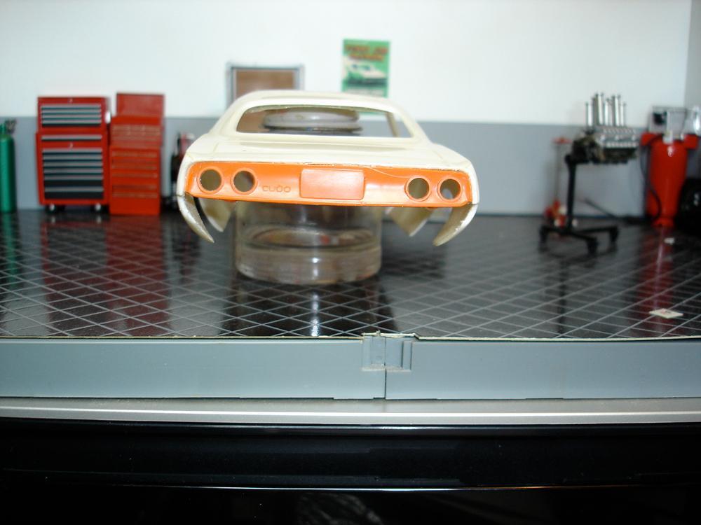

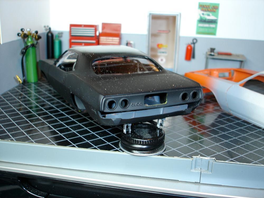

DSC02964-vi.thumb.jpg.e0c1bf94b66ef34356
The rear panel fits perfectly. I also cut out the license plate pad so that I could recess that area as it would appear on a 1:1 'cuda.

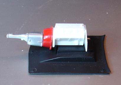

The engine is going to be a focal point so I want it to be as correct as possible. A Hot Rod magazine article was very helpful.
This engine is actually complete but I want to show the progress pics.
Notice the aluminum rod that is used to line up the engine, bellhousing, and motor plate as none of these pieces are from a common kit.
Many parts for this car are from the "stash"
Motor plate was cut from ".030 sheet plastic.
DSC02984-vi.thumb.jpg.51b5a53ba29f058f1eDSC02983.thumb.JPG.288aecd1920529b8e9ec6
Race cars almost always require a scattershield of safety bell housing. Many builders omit these. This one is a resin piece that I bought at a show.

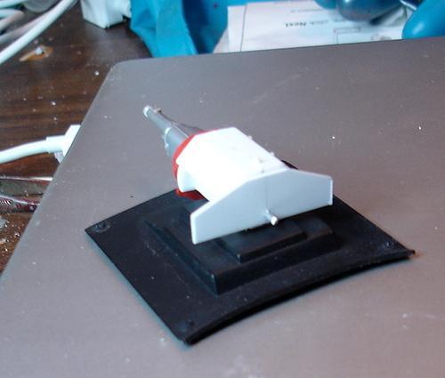

Gotta make one of these:
Dualdizzy12-th.thumb.jpg.79b939c4d0a2bc2
MotownMissileEngine-vi.thumb.jpg.328e463
Not the same as the distributor drive in the  Johan Sox & Martin, but you could use that.

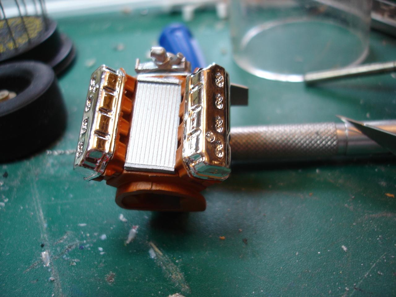

DSC03000.thumb.JPG.ffcc8283a013f2c8fcf91
Valley cover is made from Evergreen sheet and painted aluminum. Easy, but will it be seen with the intake on? Who cares, it looks cool now.

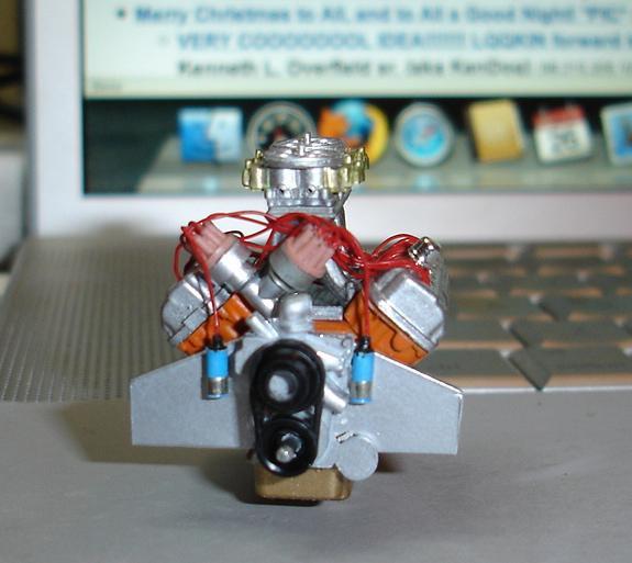

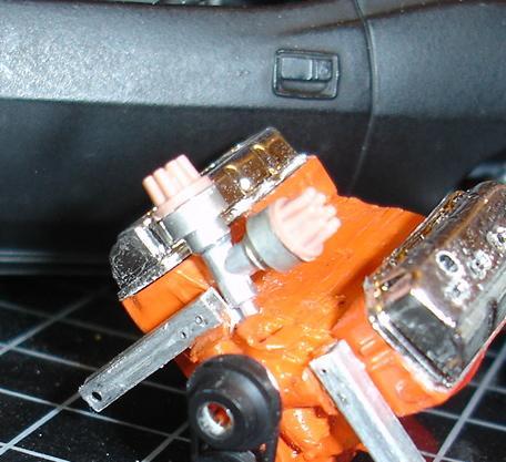

My post for today.
The angled dual distributor drive was relatively easy. I used a "t" section of sprue and whittled it in to shape, painted it aluminum, and topped it off with pre-wired distributor caps.DSC03023_2.thumb.JPG.4823f5f1d26b85f41de

Another (better) pic of the distributor drive:
DSC02965-vi.thumb.jpg.5689eab78aa5c0ca79
I tried to make engine mounts from aluminum box tubing but they would not cooperate so I went with the motor plate.

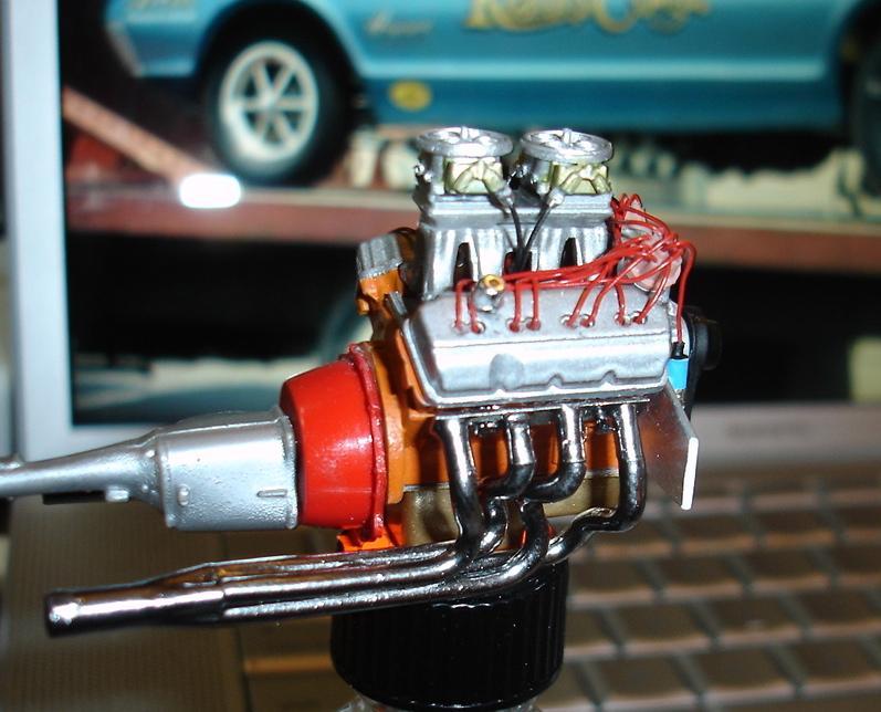

The Hemi is ready:
The Hemi is ready!DSC03024-vi.thumb.jpg.ad8bcc20b0071e8b34DSC03029-vi.thumb.jpg.b0ddd34d91fe4c2a05
Wiring 2 distributors in the correct firing order is an exercise in patience!
Headers are from Johan Sox & Martin kit. Sprayed with Alclad ll.

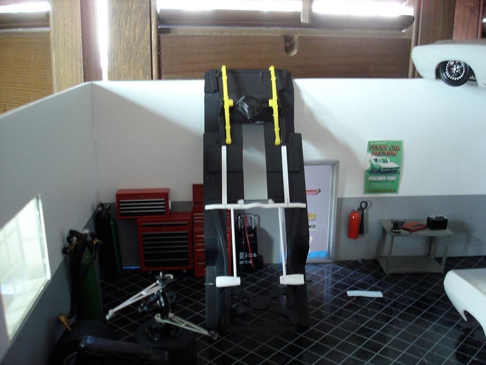

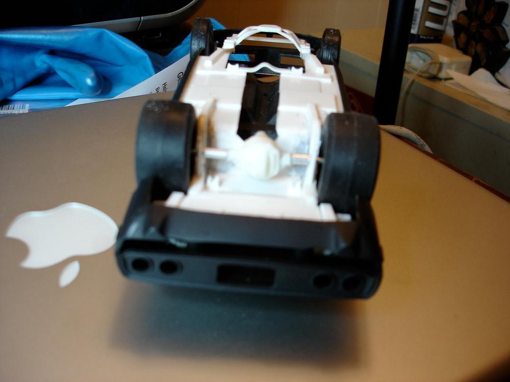

Early Pro Stock chassis were simple and down right primitive compared to todays cars.
I'm using a Johan chassis pan with a resin Dana 60 and Johan S&M torsion bars, leaf springs, and control arms. The frame connectors are square Evergreen stock.
DSC02985-vi.thumb.jpg.bd425ecde52e561d1fDSC02987-vi.thumb.jpg.8e8f7cd8092dd162e3DSC02988-vi.thumb.jpg.be974c7af57de89786

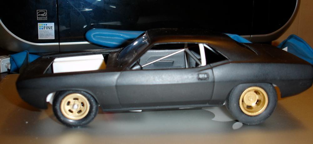

Body and interior mock up:DSC02980-vi.thumb.jpg.8b161d261fa8d9da53

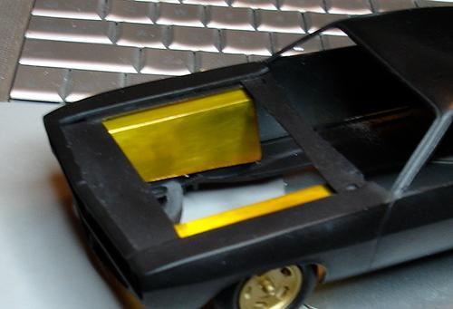

I wanted replicate the gold anodized inner fenders that the real Missile had so I figured "why not use real aluminum?" I cut up a soda can, cleaned it with steel wool and formed the inner fenders. The anodized effect was achieved using Tamiya Clear Orange from the can.
DSC02991-vi.thumb.jpg.bc317e99028640480e
