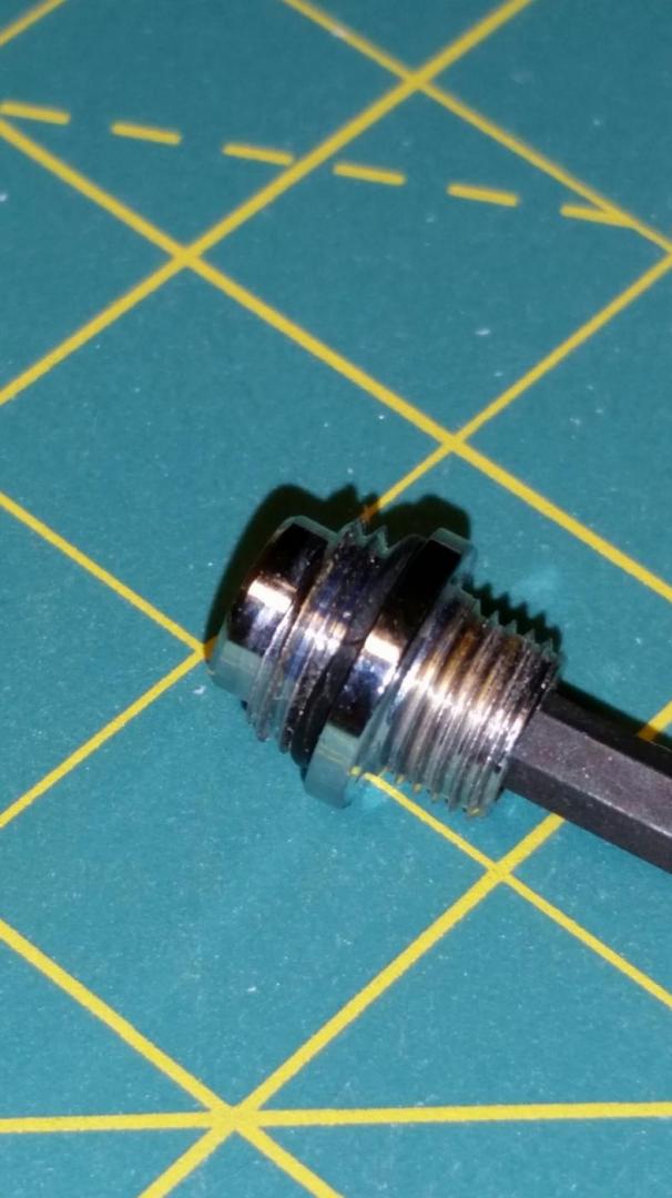

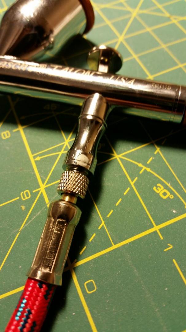

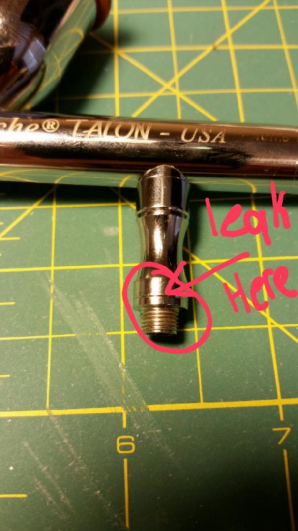

Alright guys..got home from work and it was bugging me so I hooked my talon back up to air and put some soapy water to it in small areas to find the leak.
Found it. It isn't the hose. It's the o ring at the base of the air valve assembly. Anyone know where that can be obtained?
Looks as if whoever assembled it over tightened the air valve assembly and crushed the o ring. Kinda bums me out to be new to this and it  being a brand new airbrush. I put it back together and it isn't leaking as bad now. Still able to be used, just the fact of the matter.
Where could I find this o ring?

I bought a big bag of assorted O rings at my local advance auto parts when I needed to replace the O ring on the tip of my old gun. Harbor Freight also has vo ring assortments but I don't know if any are small enough. For the time being you could cut a gasket out of a piece of gasket sheet or heavy card stock to get you by.

Try coast air brush. They carry lots of parts for almost every brand of airbrush.
Share this post
Link to post
The air valve assembly is for $6.75
Thanks guys. I did Check Advance Auto for the assorted O rings, the smallest in the pack was too big for the one needing to be replaced.
I did however call Paasche yesterday and told them what was going on, and they are going to send out a couple of o rings for no charge to me. Great customer service!
