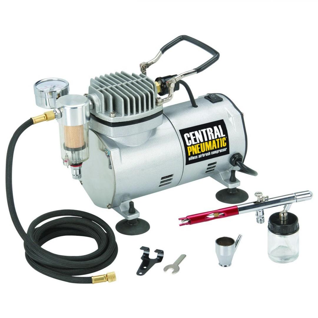

I am new to airbrushing completely! So heres the skinny, I bought a harbor freight air brush compressor and airbrush kit. (God, why did I do this?) I have watched COUNTLESS youtube vids on this subject.. but its not working properly. I had to buy a regulator, because this one didnt come with one. I installed it but its not perpendicular to the compressor like it should be, it wont tighten any further and I am afraid it will strip. So the regulator is off to an angle, not straight up and down. Then on top of that the thing cycles like every two seconds on then off, even when in use. I set the reg at 25-30 PSI which is normal and recommended for thinned down paints. But that leads me to my next question... the double action syphon feed airbrush provided with the compressor looks the part but I think it SUCKS! It doesnt seem to wanna spray continuously. It spits. Plus I cant seem to thin down vallejo accrylic..I used Testors Aztec Multi use acrylic thinner and it doesnt seem to work..I NEED HELP BADLY! I bought the compressor a while back and so I cant return it..I dont want to be at a lost, but I will buy something better if I can get some proper recommendations. I also am thinking of purchasing a gravity fed Paasche Talon. IT seems everyone is using Gravity feeds. Any help would be DEEPLY appreciated. Thank you. Happy Modeling!
P.S. Here is what I boughtcompressor.thumb.jpg.33c58aba8a24211a125

The compressor should be fine, it will cycle quite often due to the small tank, but will be more than ample.  I know nothing about the AB you have, but i have had the same Paasche airbrush
for over 25 years, and only replaced an o'ring and a hose recently, so i will highly recommend Paasche.
As for spitting, it sounds like your paint could be too thick maybe, or if your using the jar, try the cup, i find the jars are a bit temperamental.
Can't help with the paints either, i only use auto acrylics. You could try a different thinner though.

A few tips:
- without a tank your compressor will cycle continuously
- a siphon feed airbrush needs more pressure than a gravity feed to get the same result
- when adjusting your pressure,  try with the trigger depressed and adjust while air is flowing. Your gauge will show a higher pressure when no air is flowing.
- also, I don't not think you can get more than 10-15 psi continuously without a tank from those small compressors
- Vallejo paints tend to clog the airbrush quickly and need constant cleaning/flushing when spray degrades
- are you using Model Air or thier Game Color (or similar). Any vallejo  with air in the name is ready to go, thier others are very thick and need to be reduced quite alot.
- practice with different air pressures and paint viscosities  (thinner/thicker) until you find the sweet spot for your setup

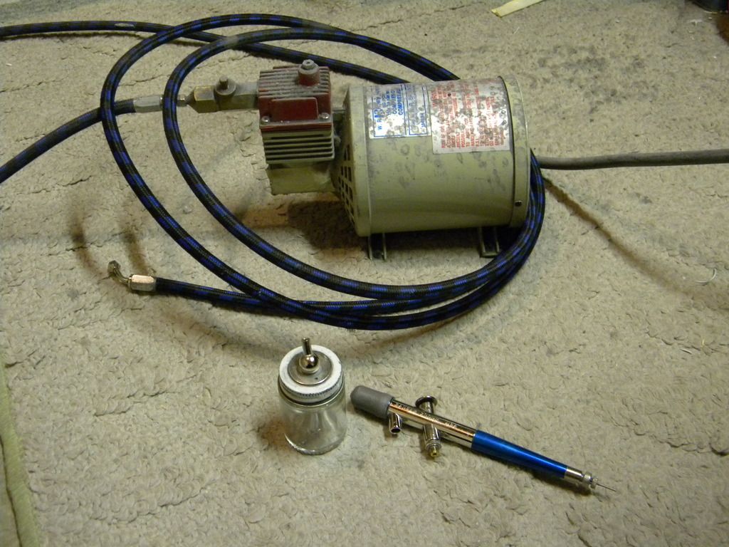

Sometimes I think we have a bit of a tendency to over complicate air brushing.
This is my set up.
Has been for over 25 years.
No tanks, no traps, no regulators.
Just a simple compressor with an inexpensive Badger siphon feed single action brush.
Has worked just fine for me for a quarter century.
I've thought about all the goodies over the years & the only thing that I can come up with that I may like to add would be a simple gravity feed brush for small jobs so I don't have to mix as much color & clean jars.
Other than that, this is all I really need.
I get perfectly good results with it.
Steve

Just want to add a few things about the airbrush and compressor ,  I use that compressor, have been for three years now, while its not perfect, it does work and as long as you keep the psi in the range that it can handle, there is no pulsing , yes, it stays on constant, but its not very loud, in fact, my paintbooth fan is louder then the compressor.   Anyways,  I am ready to replace it now , as it starting to reach its EOL, and I will move on to one that has a tank.
As for the Air Brush, I used that very same A/B for a few years, and its a work horse,  I never had one problem with it, or parts breaking on it,  and in fact,  I bought a Passche VL to move up in the world, and I had nothing but problems with the POS VL, in less then six months, I had parts breaking on it,  the hose also broke,  it was a frustrating experience with the VL.  I have since move on to Iwata.
My point is this,  while that set up may be cheap, it will work good for you, and is a good entry level air brush system.

There's nothing wrong with the HF setup, other than perhaps the lack of a tank for the compressor. I use them myself without any problems, usually spraying enamels and lacquers.
Even without a tank, it still works just fine,  as long as you keep the PSI in 15-25 range, you dont really need a tank.
