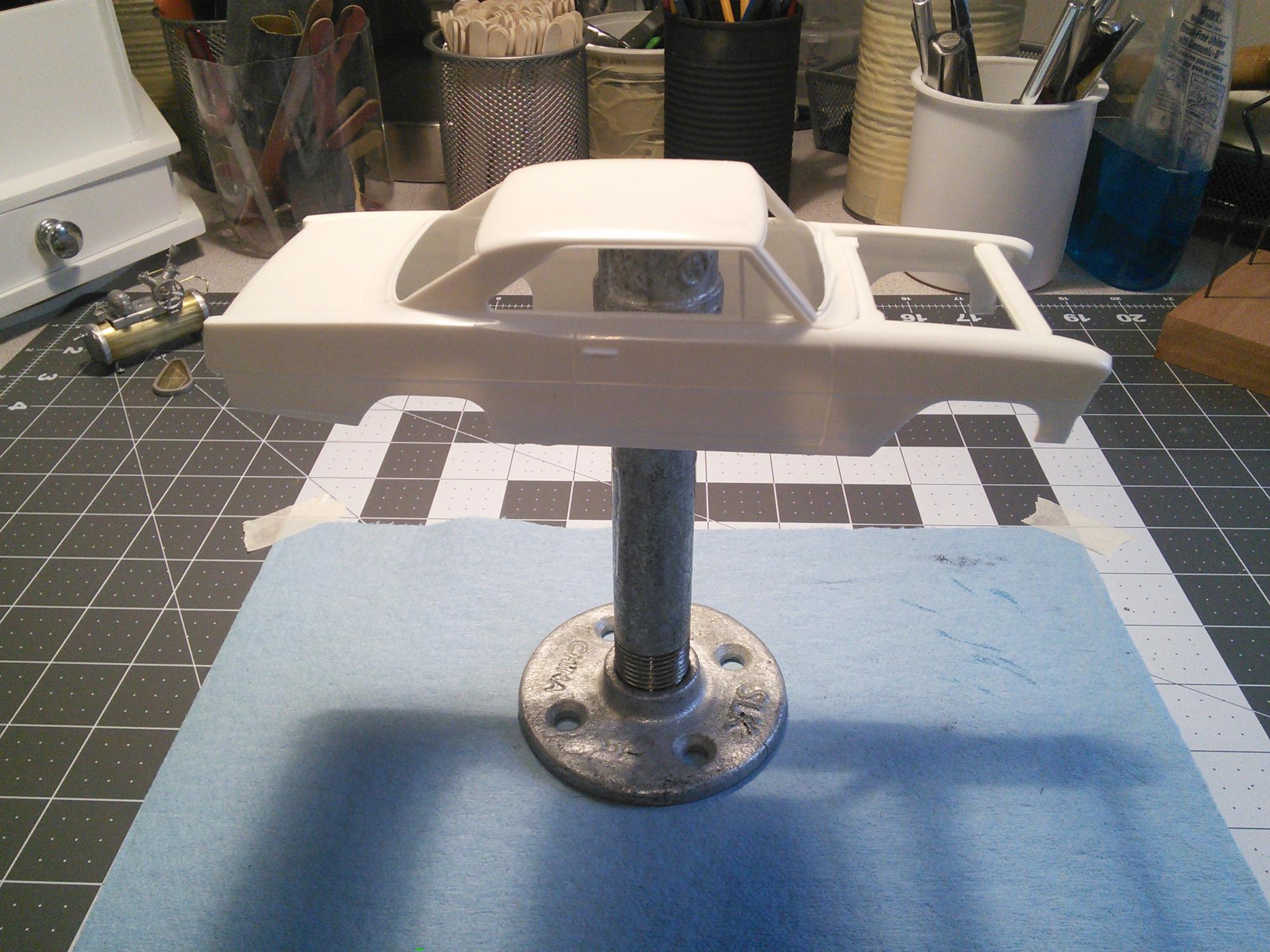

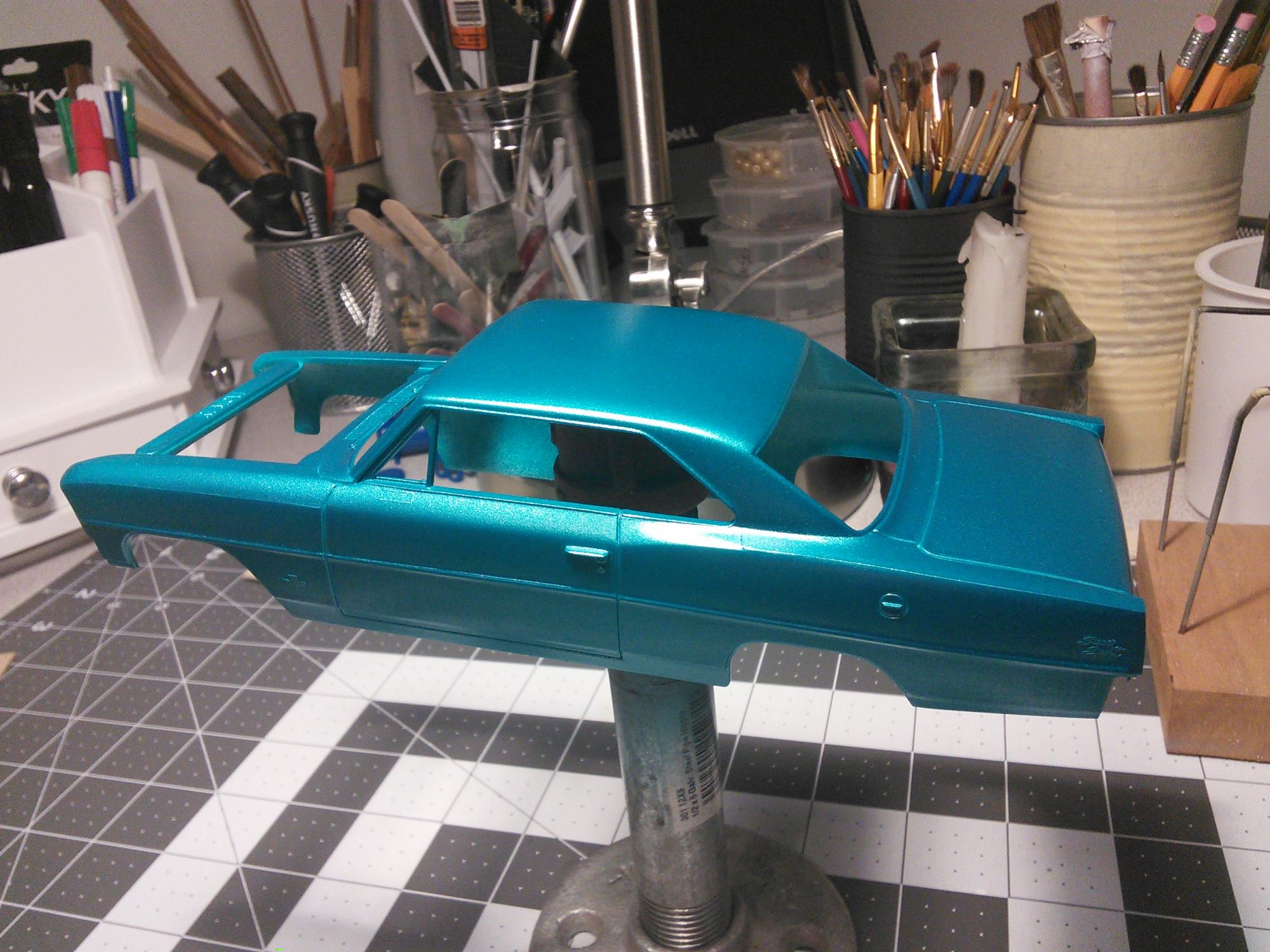

This is metallic blue craft paint from Walmart sprayed straight onto clean white plastic and it hasn't been clear coated yet. The paint was mixed 50/50 with Pledge floor finish.
Spraying craft paint is like the perfect storm. To get great result's everything has to be right. A properly working air brush, proper air pressure, proper spray distance and proper paint mixture. Not all craft paints are the same so mixture ratio may vary. I test spray each new batch I mix on a white plastic spoon to check for color, coverage and flow ability.
Craft paint also sprays better where the air is humid because the paint tends to dry fast humid air gives it a little more flow time.

Wow. I'm impressed. It's impossible to discount as-sprayed results that look like that. Interesting. Very interesting.
What clears can be used over something like that??

I usually mist a few coats of straight Pledge to get a glassy gloss. Then I might buff it with a used dryer sheet after its cured a few days. If I'm building armor or an old barn find car I'll use Micro-Scale flat clear in my air brush.

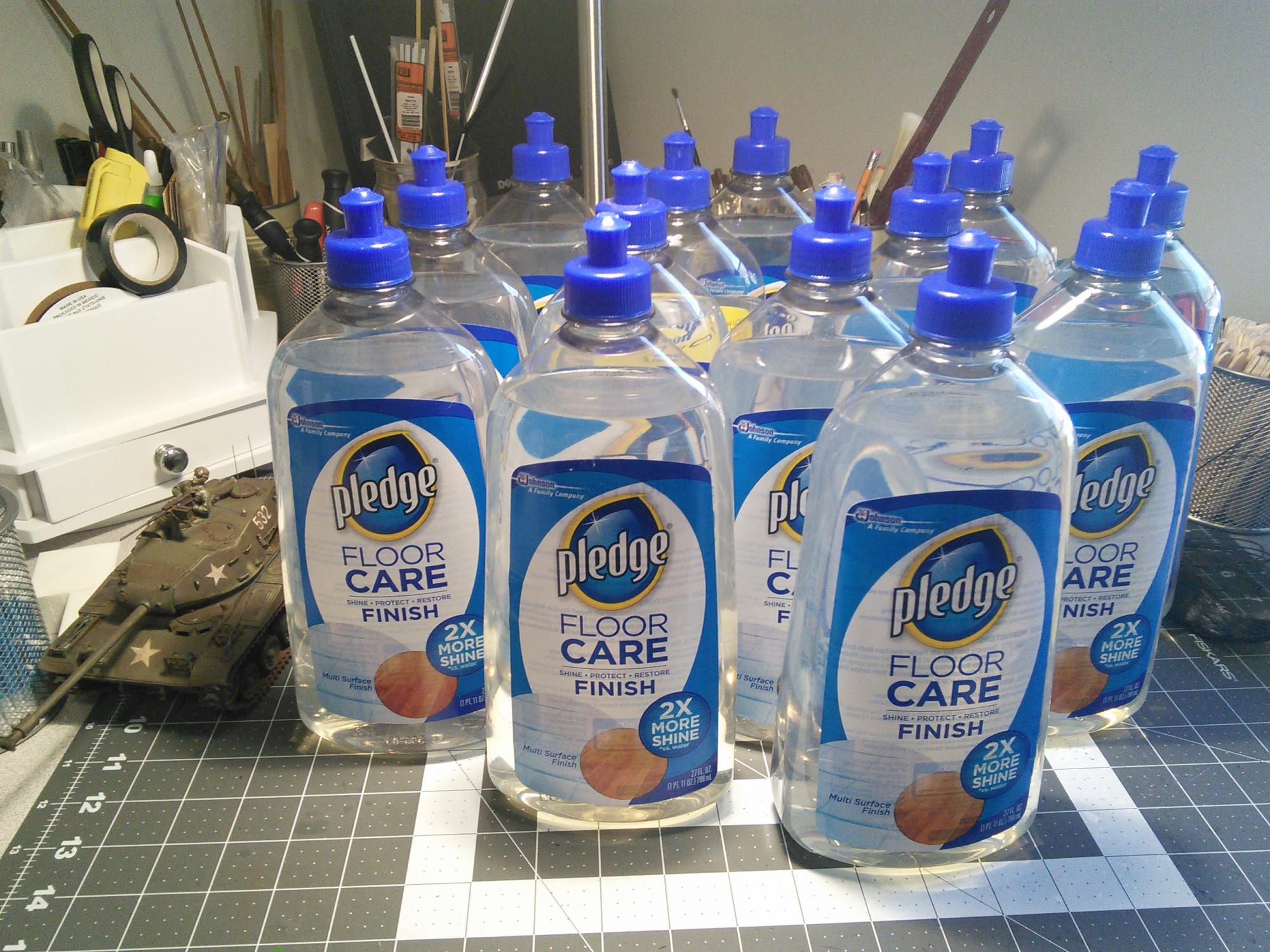

The pledge thins it down to get the flow you need to spray smooth then once sprayed on the surface the Pledge helps the paint to self level and blend smooth across the surface uniformly.
THANKS TOM, COULD YOU POST A PIC OF THE EXACT PLEDGE PRODUCT SO I GET THE RIGHT ONE?
Share this post
Link to post

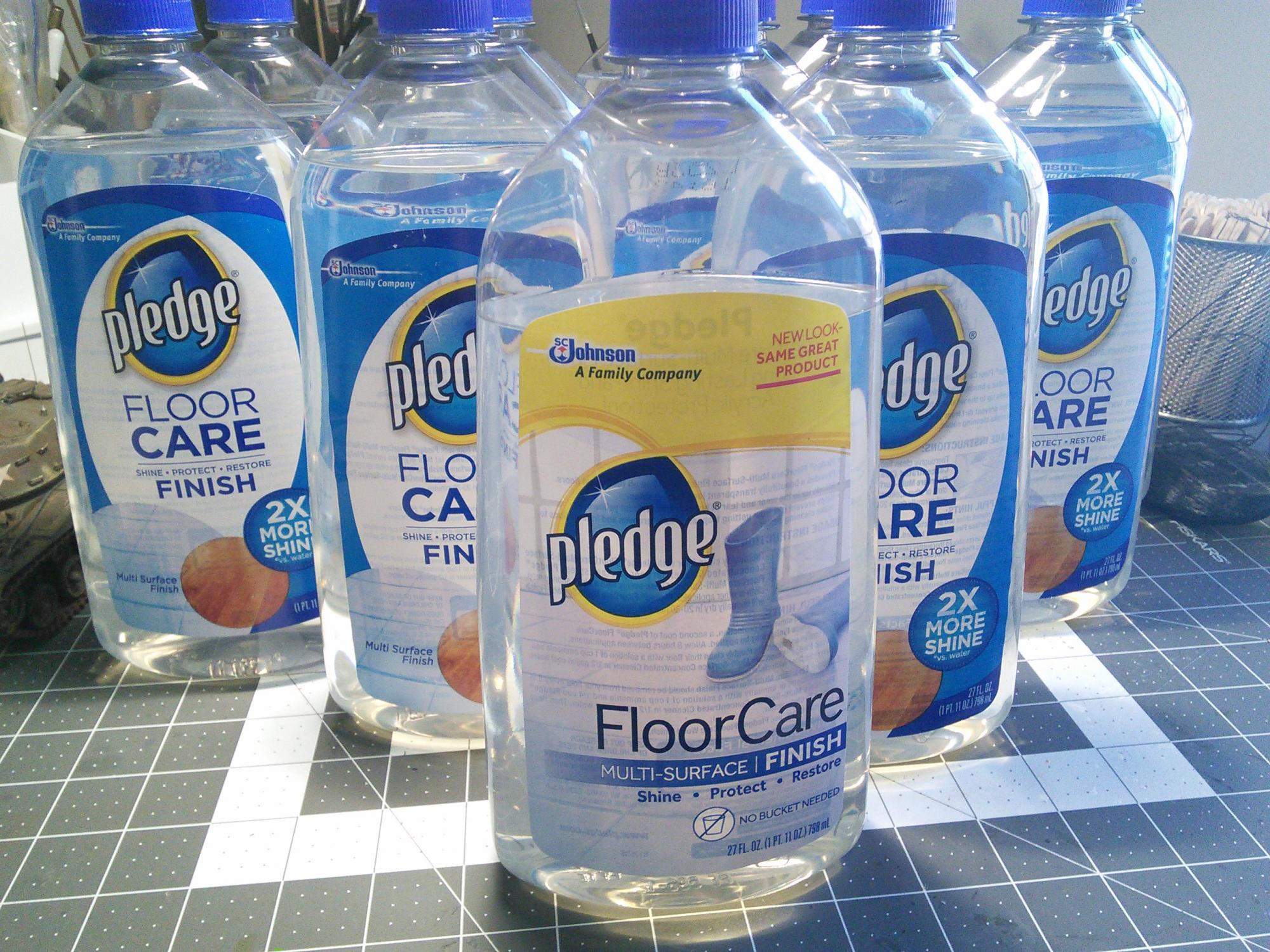

Here's the one I use that's currently on the shelves "if" you can find it. This stuff is getting super hard to find in stores. If your lucky you can stumble onto a bottle or two at Walmart, Walgreen's or Kmart. Ive had my wife on Pledge alert for months so when she's shopping if she sees it she just buys them out because I use so much of the stuff. Second pic shows the old label with the boots on front. They're both the same stuff. If you can find it in stores its $6.00 I saw home depot is advertising it online now for $42.00 a bottle so somethings up.
