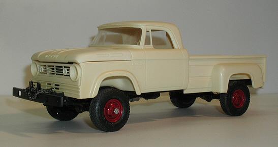

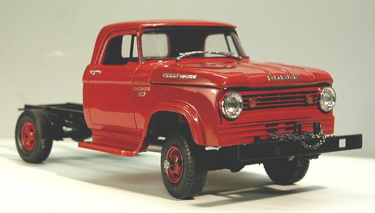

I'm the guy who first did the 1966 W300 and 1968 W500 single cabs.  There is a template from which you can make the windshield out of simple clear sheet plastic.  When I did mine I used the plastic that used to come with new shirts around the collar!:rolleyes::rolleyes:  If you clean the edges of the interior of where the windshield goes it will just pop in with no glue.  All you have to do is warm the plastic and put a slight curve in each end so that it snaps in place.  Here are the two originals as models.

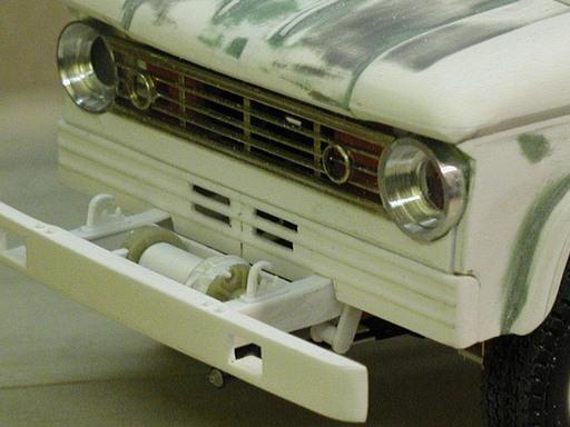

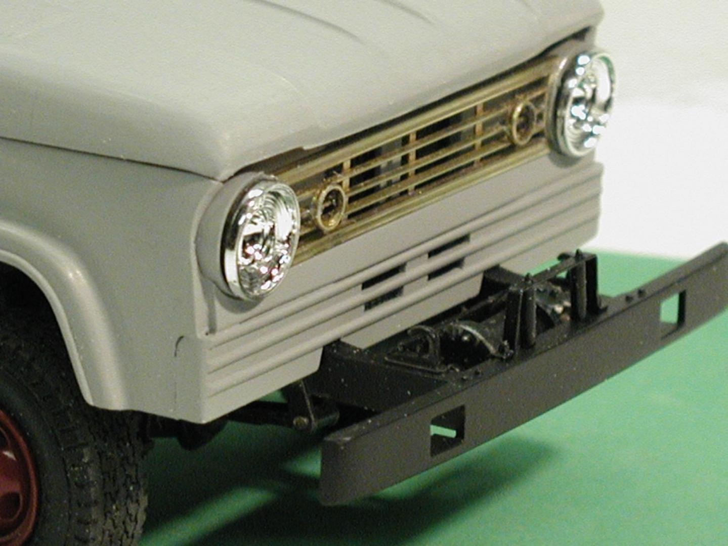

Hi, Tom.  You would have to change the front clip slightly to have the 68 grill fit the 66 cab because of the difference in the headlights.  If you notice the bezels for the lights on the 66, they are the same as on the L-700.  The part behind the chrome ring would have to be ground out (not a big job particularly) and the hood is slightly different in that the 66 hood has a small area above the headlights that is cut out.  The 68 hood is straight across.  Notice also that under the 66 headlight bezels the flat area has been cut out slightly.  Again, not a big deal that couldn't be fixed with a small piece of strip stock.

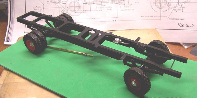

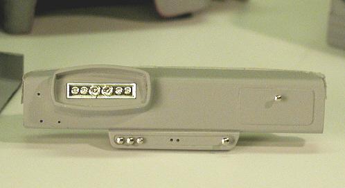

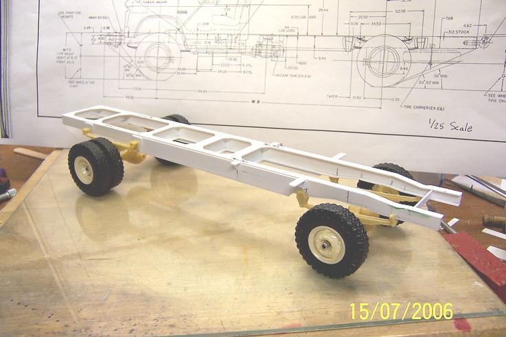

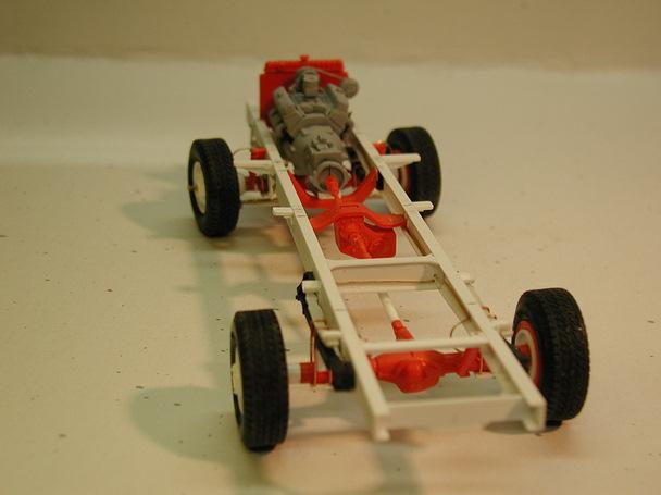

Tom:  Here are some in progress photos that I still have of each build.003.thumb.JPG.a045028056c532364c8ad3c330010.thumb.jpg.308b53c28520224fe7fb489085016.thumb.JPG.677f7d72b97e3b5f1bbc38b15dW500_07.thumb.jpg.ef94d656d628da0db41f0dW500_18.thumb.jpg.a9b2045417ee7a88520c83W500_25.thumb.JPG.64ce7f493bd51e24236451
The first three are of the W300 (66) and the last three are of the 68 W500.

THANKS CHARLIE,
DID YOU MAKE YOUR OWN FRAMES FOR BOTH TRUCKS?
ALSO, WHAT WOULD BE THE MAIN DIFFERENCE BETWEEN THE W300 & W500?  THE FENDER FLARES LOOK A BIT WIDER & LONGER, IS THE PANEL BELOW THE GRILL WIDER AS WELL?
Share this post
Link to post
I made both frames.  I was fortunate enough to obtain a Dodge body builder's book and they have line drawings of the frames for both the D series and the W series in each of the different classes.  The fender flairs on the W500 are indeed wider but the panel below the grill is the same for both.  The W500 also has a large rear window.

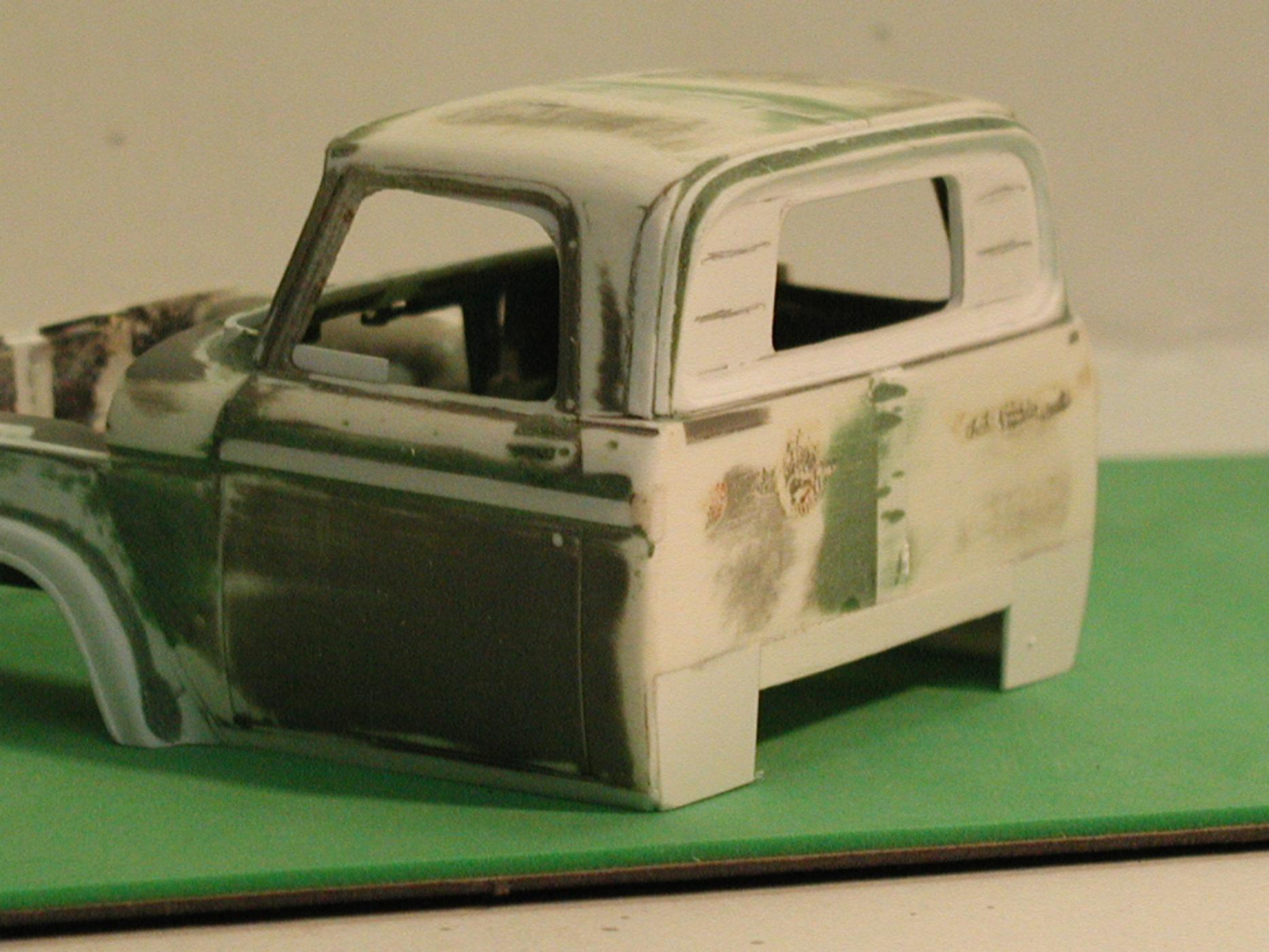

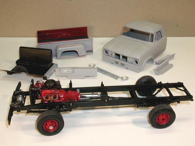

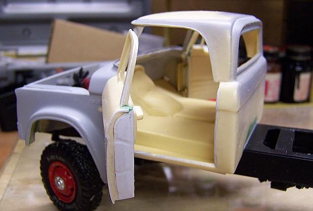

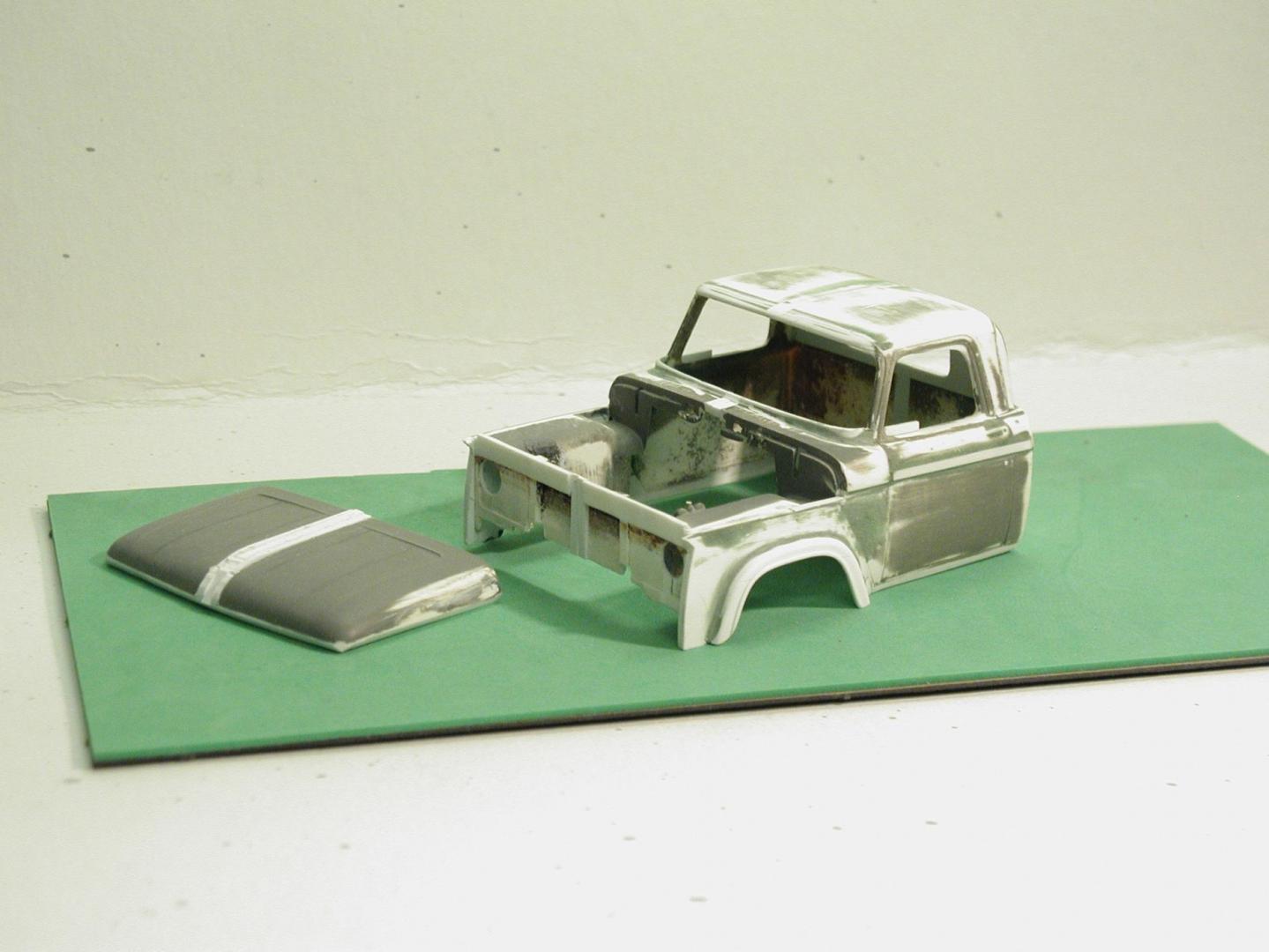

Here are some additional in progress photos of the W300.  011.thumb.jpg.137d5c898eb40022010e32d95d019.thumb.JPG.0ba9726cc4f193d3623c2a5245022.thumb.jpg.678846ecfeefe97581d25df018  This photo is of the first resin pop that Tom Coolidge did back around 2004.  It is sitting on the frame that is in the photos above.
023.thumb.jpg.26c8d223ff522e6b0c23d5f4a2001.thumb.JPG.765361eb1ea84a0fa931fe2f76002.thumb.JPG.e53ba65f8b4cb96337bbb381d7
These last two photos are of the FORD that I started with to build the Dodge.  The top of the cab and windshield lines had not been finished when the photos were taken.  A 1/4" wide plastic strip was run down through the middle to make the entire cab wider.

THANKS FOR THE PICS & INFO CHARLIE, I WOULD NEVER HAVE GUESSED THIS STARTED OUT AS A FORD CAB.
WOULD YOU SAY THE W SERIES CABS ARE WIDER THAN THE D SERIES CAB? OR IS ALL THE DODGE CABS JUST THAT MUCH WIDER THAN THE FORD CAB?
Share this post
Link to post
I think they are just that much wider.  The body builders book shows the plan view of the cab so you can get the right width.
