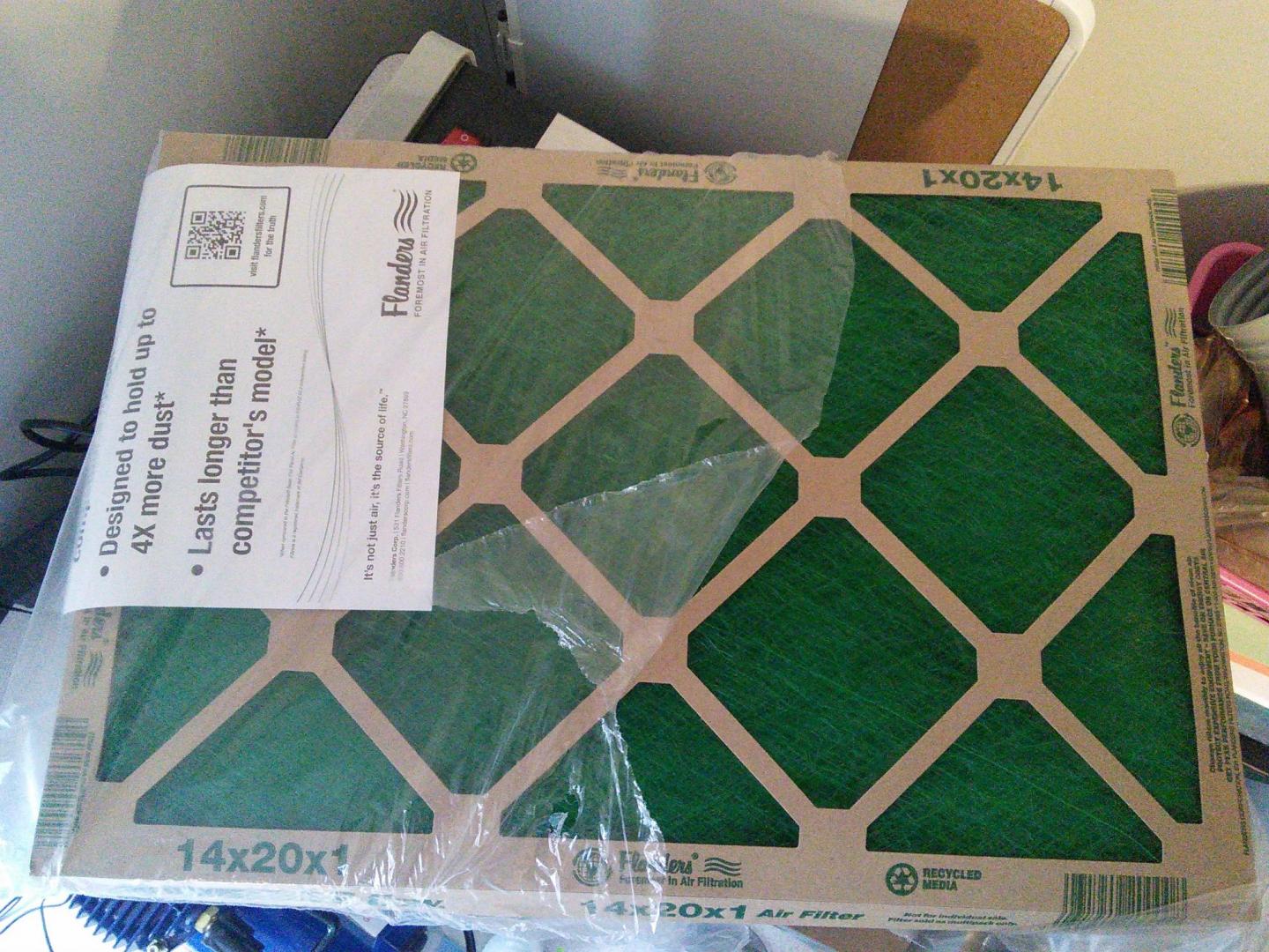

Decent filters should catch enough of it for whatever remains to be negligible. Dry particulate matter and atomized paint (lacquer droplets will be dry by the time they reach the filtering medium, and enamels will be sticky enough to stick to it nicely) are really pretty easy to control. Even a furnace filter should catch 99% of it.
I used stacked (2) furnace filters on the output-air from a booth where I shot gelcoat in a composite shop. Never a drop of white gelcoat on my dark-blue XJ-6 parked right behind it.

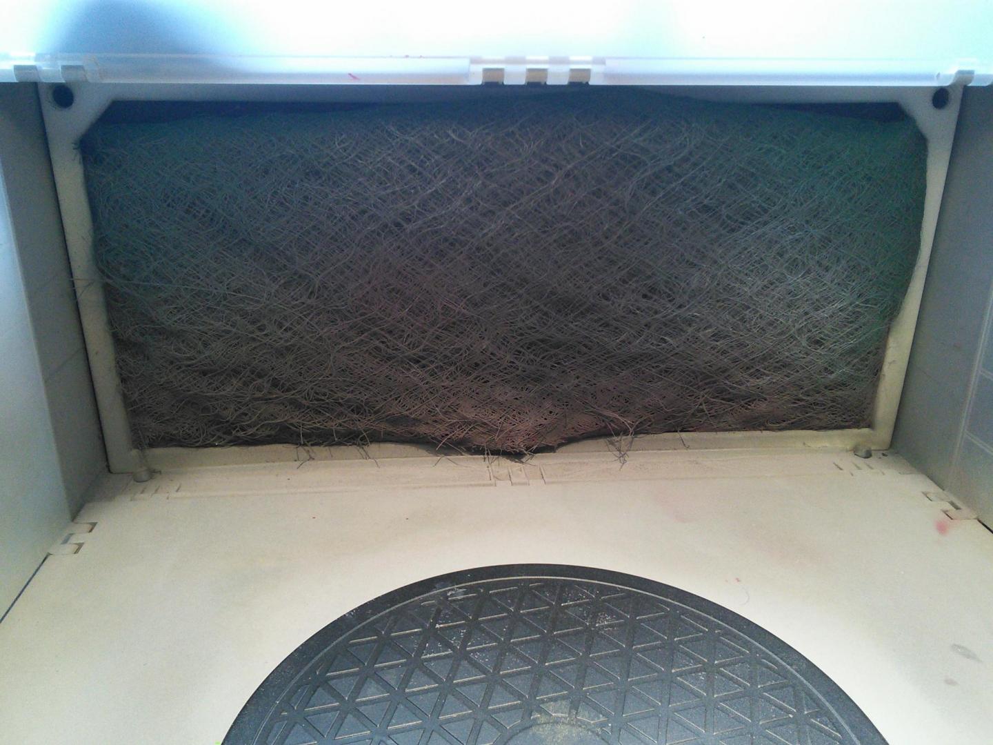

Mario, The paint booth filter should catch 99% of the fumes and over spray. The filter needs to be changed pretty often if its doing its job. I replace my filter often with cheap furnace filters from home depot. If I spray rattle can paint I usually leave the piece in the booth and let the fan keep running a while until the paint fumes work off.
