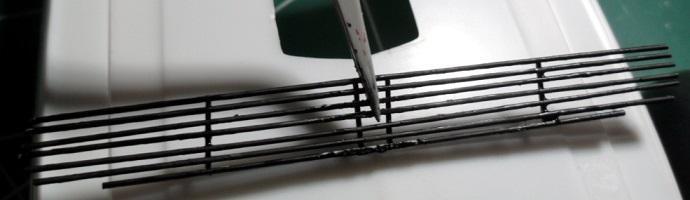

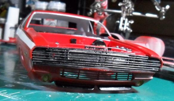

Before the end of 2015 I picked three of the Revell Streetburner 70 Challenger kits for less than 10 bucks each. The first was built to match the box art. This one I'm thinking of taking a bit farther, and the first part of that will be a grill cover. The grill work was done using .20 rod approximately 3" (75 mm) long, since I wanted light to pass through, and for the chrome and headlamps to still be visible behind it, the spacing is about .20 as well.

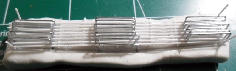

Step 1. Building the jig.
SAM_0422.thumb.JPG.58f82fbe62897e7164d7c

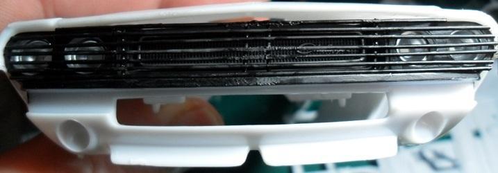

Starting with a base of tacky putty, I pressed the grill from the clip in far enough to provide the outline. Saved a lot of measuring, and gave me the points to set my corners. Placing each horizontal piece, I then alternated with standard size staples for uniform spacing. I then applied liquid glue to the verticals and placed them on. The mockup above does show the verticals under the horizontals. That was a first run through, and it made more sense to apply the verticals from the top rather than try and cement them underneath.
2. Placement
SAM_0434.thumb.JPG.b0f9ff20c14bcc76d5014

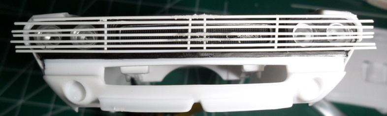

Once the glue had set, I eased out of the jig with #10 blade, since I may want to use the jig again.  Her's a shot of the grill laid over the front of the car. I used a marker to mark the ends of the horizontals for trimming to fit inside the setback over the headlamps and grill. That bit of rough texture visible in the picture is some of the tacky stuff that still needed to be removed.

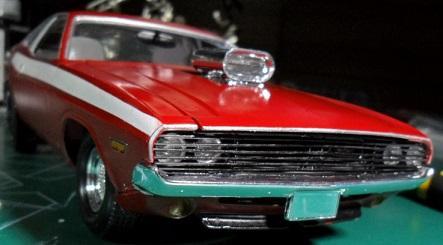

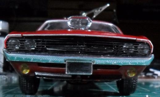

SAM_0438.thumb.JPG.2225086cbafaaac9f61eb and here's a shot after trimming to fit. The top vertical was cut to fit the width of the hood opening.

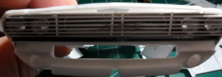

SAM_0441.thumb.JPG.14029af6fe09ddb7f8dcc  Cleaning and painting. I'm going black on this one.
SAM_0443.thumb.JPG.8ec6b3b45340a6ac1e85e  And here's another fitting after painting. Also thinking of carrying the same grill to the lower opening, but haven't decided on black or body color.

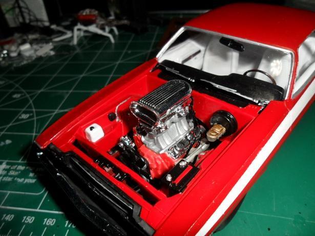

Small update

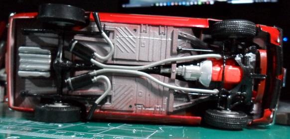

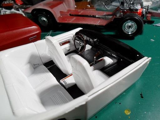

 .SAM_0462.thumb.JPG.8ba7d8afb41655a86ff17 Most of the body is complete, working on final detailing and getting the bumpers on.
SAM_0456.thumb.JPG.049f8e4622d9bc0f42567  Interior is progressing as is the chassis in the background, getting the engine wired and plumbed.

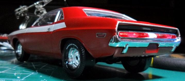

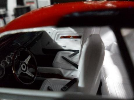

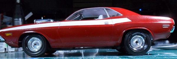

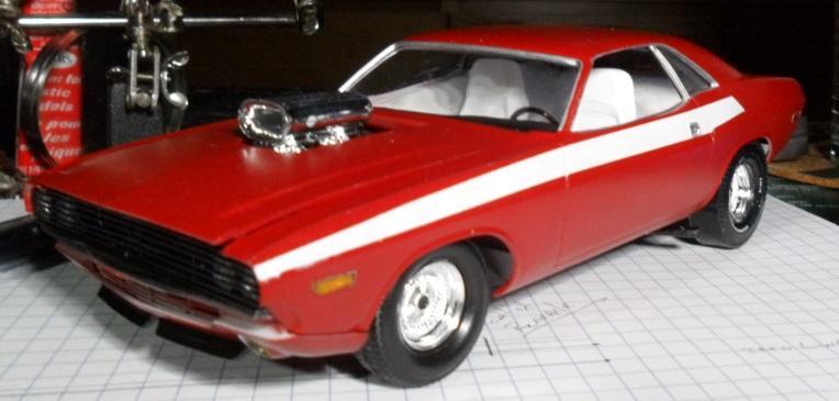

Last dry fit before final detailing. Didn't fix the front valance body lines, and still need to add the exterior chrome and side mirrors. Clean up a couple of paint errors, and clear coat. The rims are from the parts box and still need a wash to bring out the detail.
SAM_0463.thumb.JPG.ca66bd597f50f4d8f02aaSAM_0464.thumb.JPG.130b5c7bd233ee5bb6c04
Raised the back end slightly and replaced the rear tires with a pair of Racemaster slicks from the parts box. Got the side and rear glass tinted using a mix of Pledge Floor Care (Future) and Testors water-based black paint. Came out a nice smoky tint.

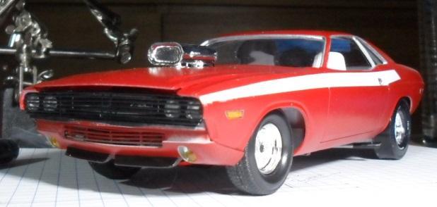

Down to a few decals, one or three bits under the hood, and the side mirrors. Then it's under glass for this second of three Challenger kits.

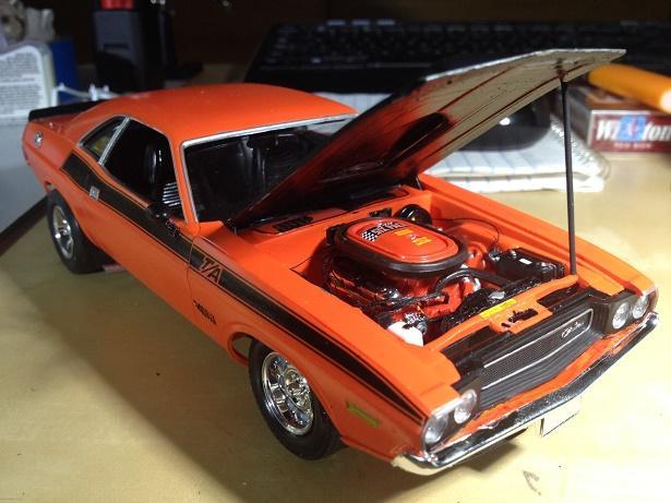

Here's a shot of the first.
SAM_0475.thumb.jpg.6e95be17be12a989f4aea
And here are the last few of the current project.
SAM_0467.thumb.JPG.0c05aebf1b41cbab418b5SAM_0468.thumb.JPG.8cd73390551253d447a52SAM_0469.thumb.JPG.2888d96a90922d731dcebSAM_0470.thumb.JPG.594b7d92c0893761e7109SAM_0471.thumb.JPG.8a6f75be772202c494cefSAM_0472.thumb.JPG.ed53e127195126441b974SAM_0473.thumb.JPG.060ce63e0c13ef53379b2
