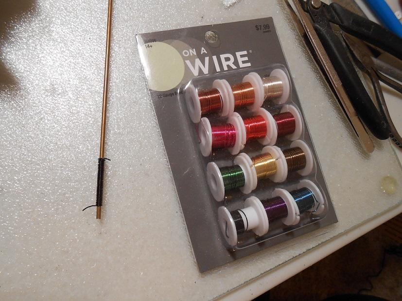

Hey Guys, I found these spools of 22 gauge wire at Hobby lobby, and it comes in many flavors:lol: I'm using it for a project I'm working on now.
Cheers,
Lance

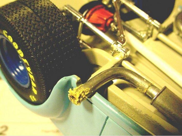

Don't use Rosin Core. I found out the hard way.
Cheers,
Lance
You can also get this wire at WalMart in the craft section

Are you sure that this is rosin core and not acid core?  Rosin is usually amber color and inert. That looks like acid residue.  If it is rosin, it can easily be cleaned off with some 91% rubbing (isopropyl) alcohol.   If it is acid, then you are probably SOL.
Share this post
Link to post
Pete, you are correct, I suspect. Probably acid core. Thanks for the heads up.
