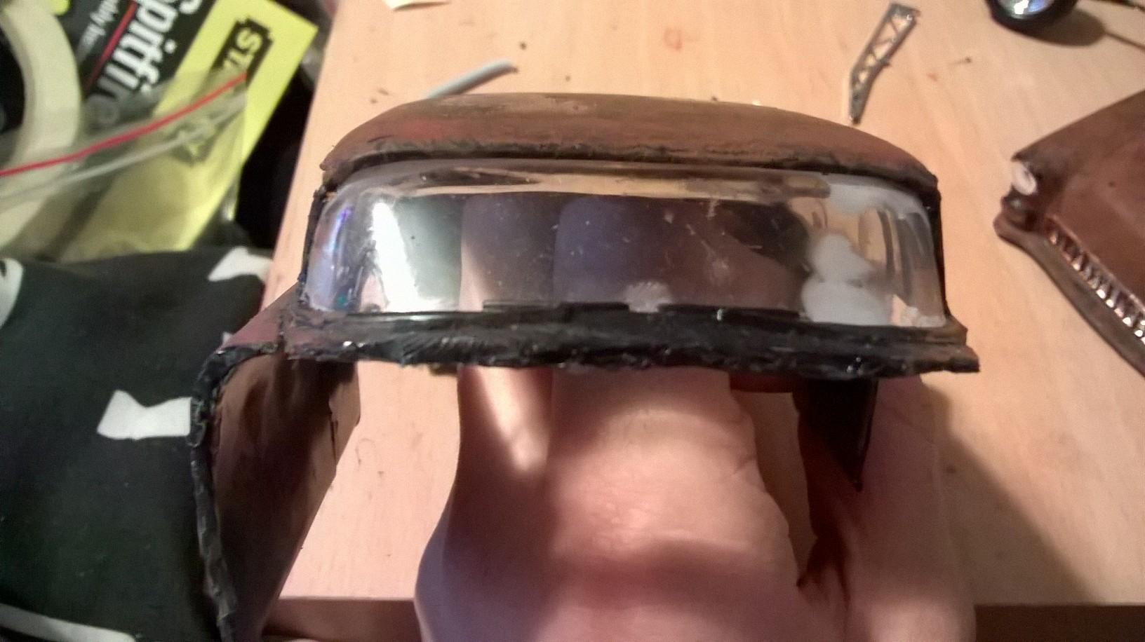

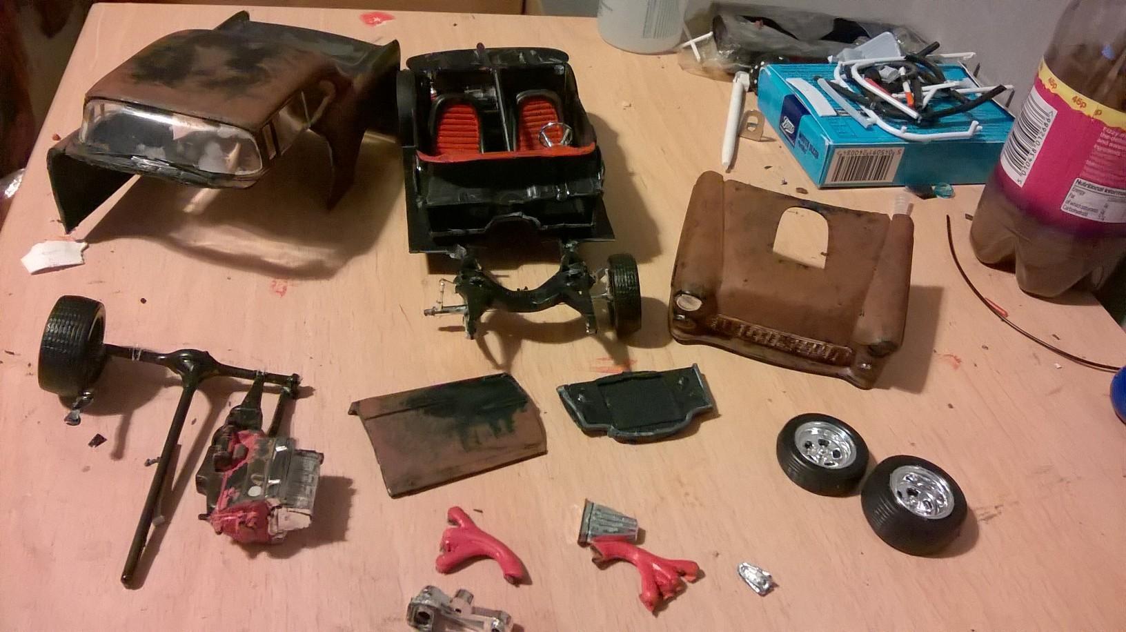

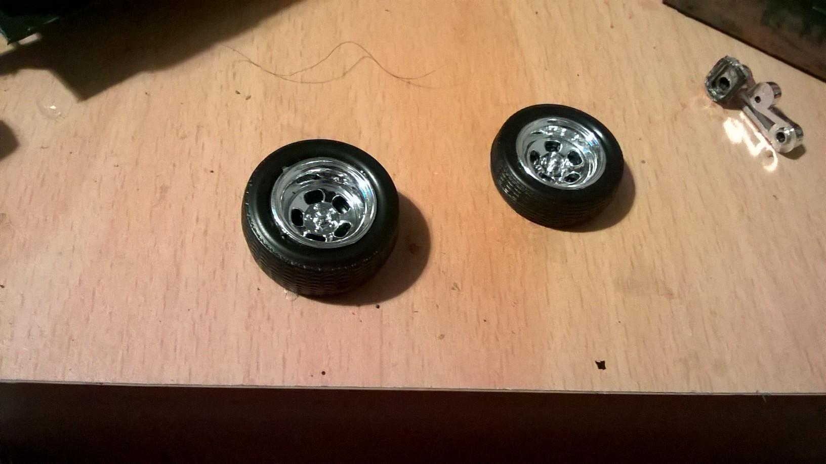

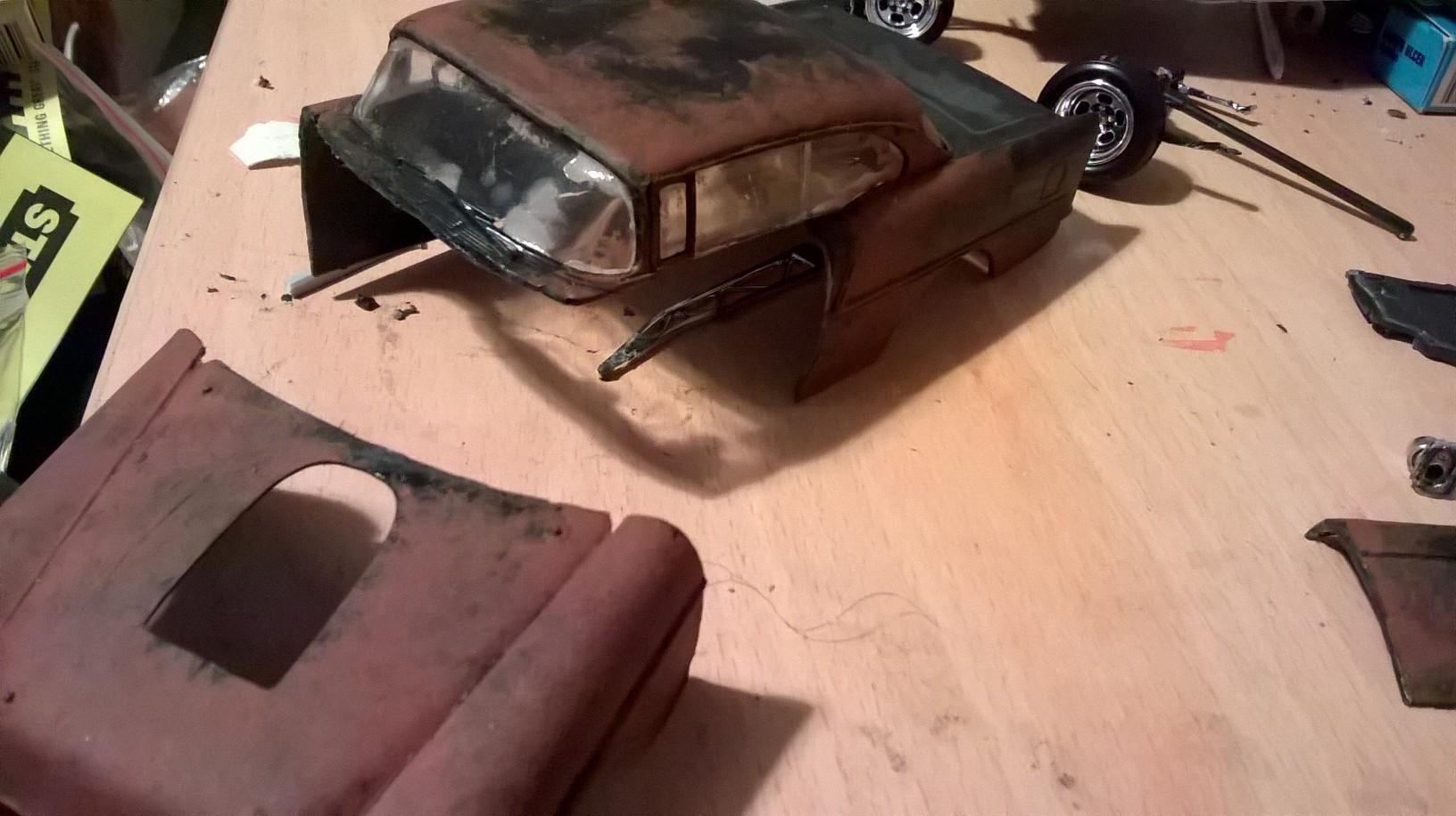

So this weekend my little cousin gave me this model of his, it was fairly complete but its the first model he ever made and its in such a state. Below are all the parts i got with it, he tried to make some rusty 2 lane black top style chevy, but it really hasnt turned out well. (the pictures arent great, the rust is darker than that and doesnt look too bad, for some reason the camera has made the pictures a lot lighter than they should be.)

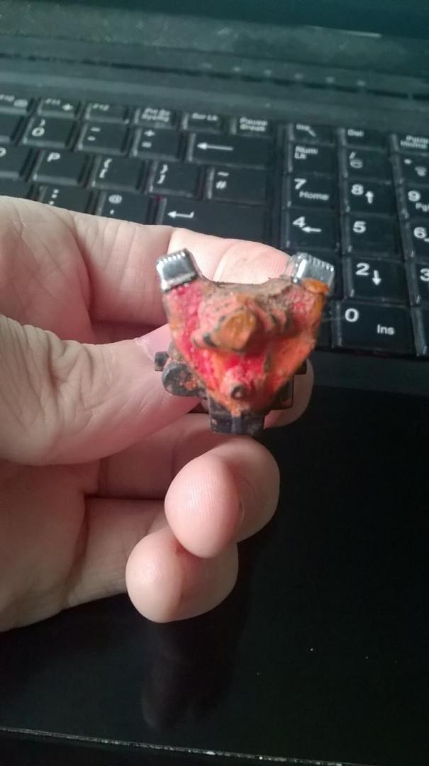

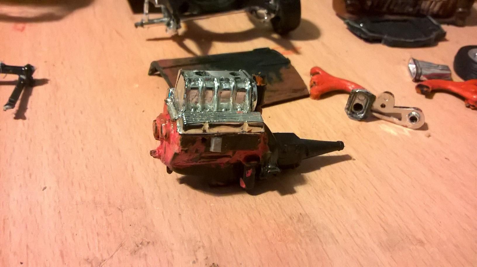

Im not really sure where to start on the car tbh, there was some big holes on the engine which i managed to fill with some scraps of plastic i had and im in the process of getting the paint off.WP_20160216_22_04_59_Pro.thumb.jpg.23a5eWP_20160216_22_04_49_Pro.thumb.jpg.b2d6cWP_20160216_22_05_39_Pro.thumb.jpg.72d44WP_20160216_22_05_13_Pro.thumb.jpg.945d3

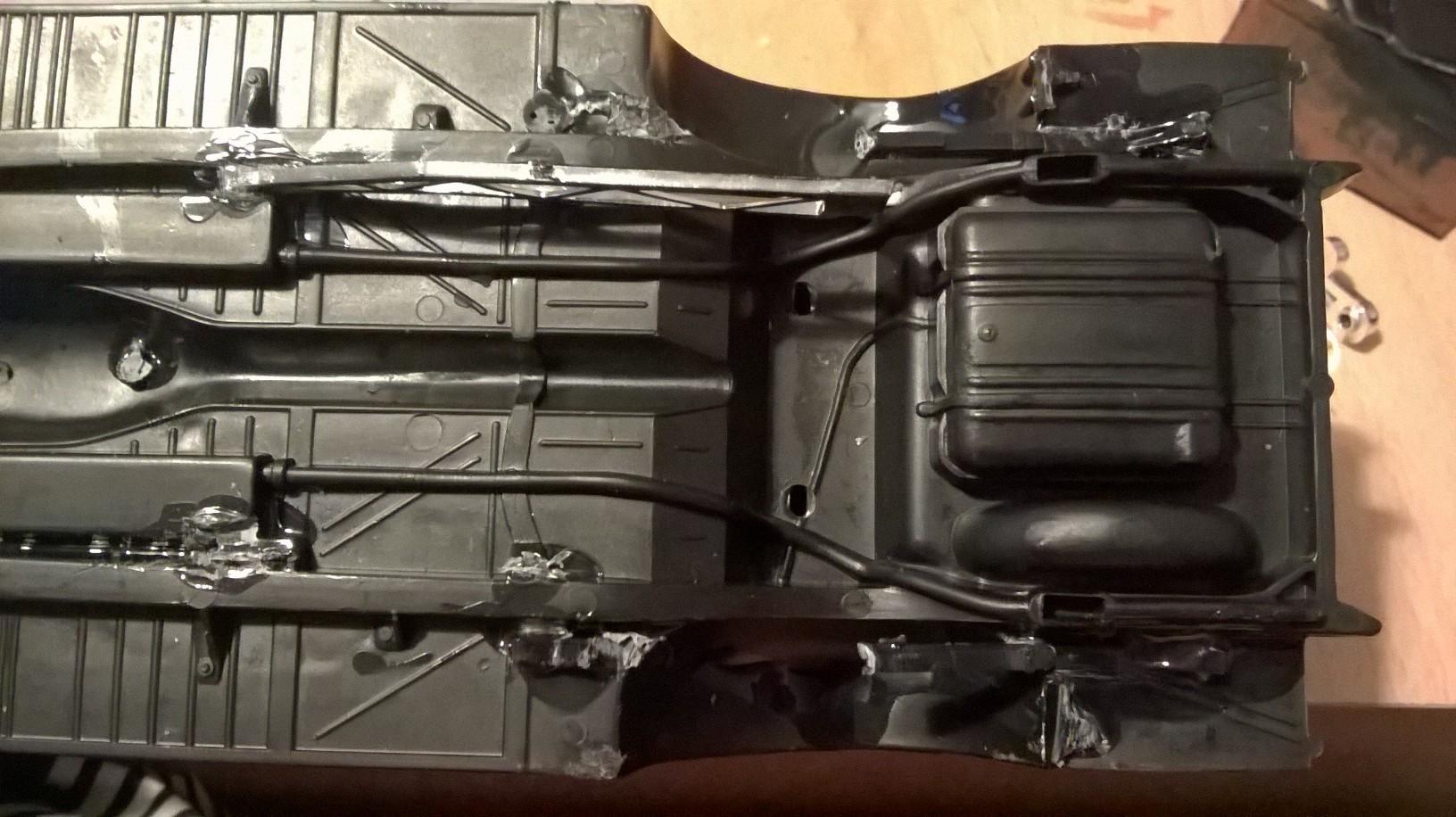

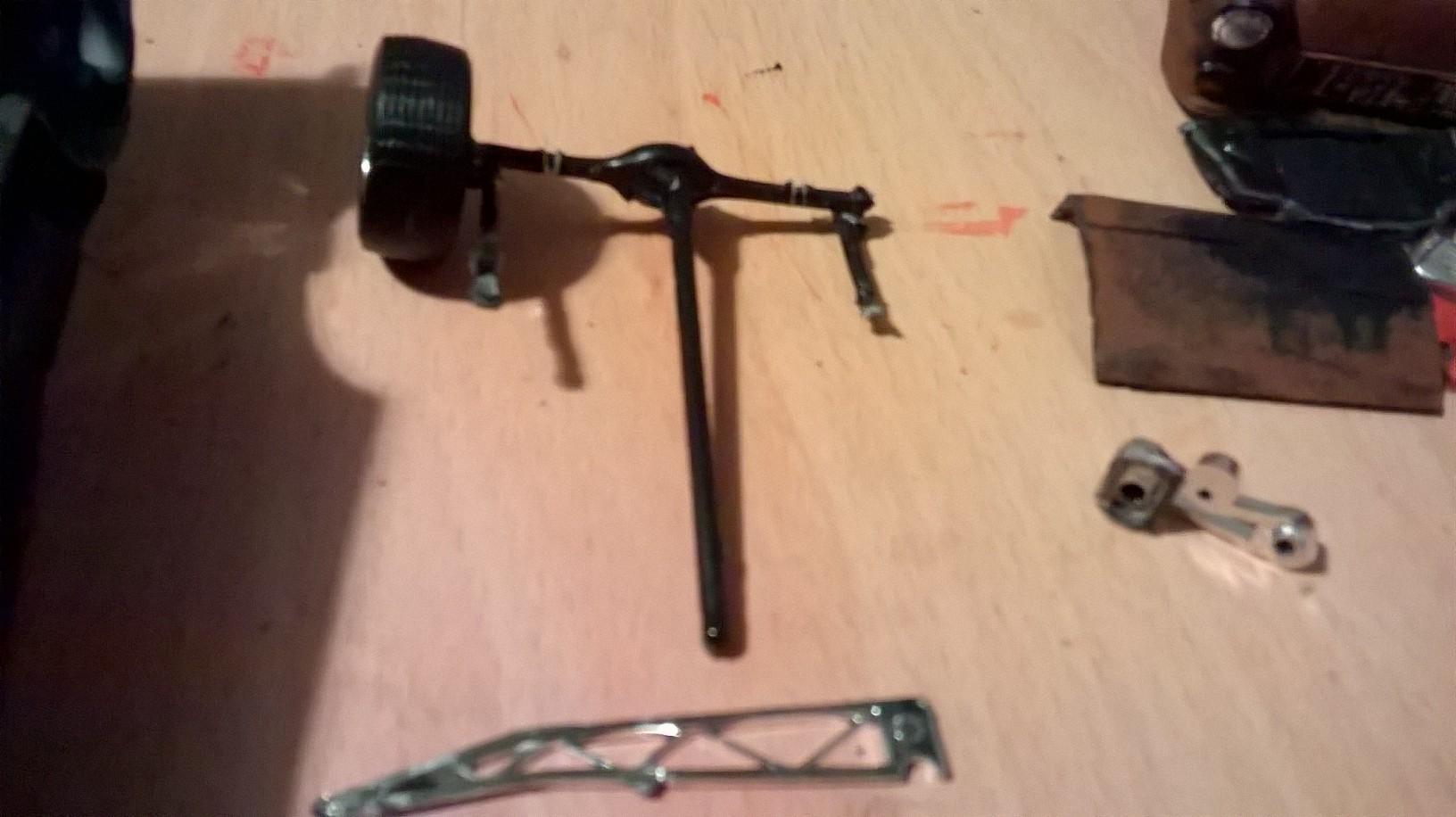

I think i will have to re-make the rear leaf springs as they have split in the middle and are covered in glue and one of the wheels has snapped of the rear axle so i dunno what to do about that.WP_20160216_22_06_40_Pro.thumb.jpg.eedd6WP_20160216_22_06_21_Pro.thumb.jpg.a07e5

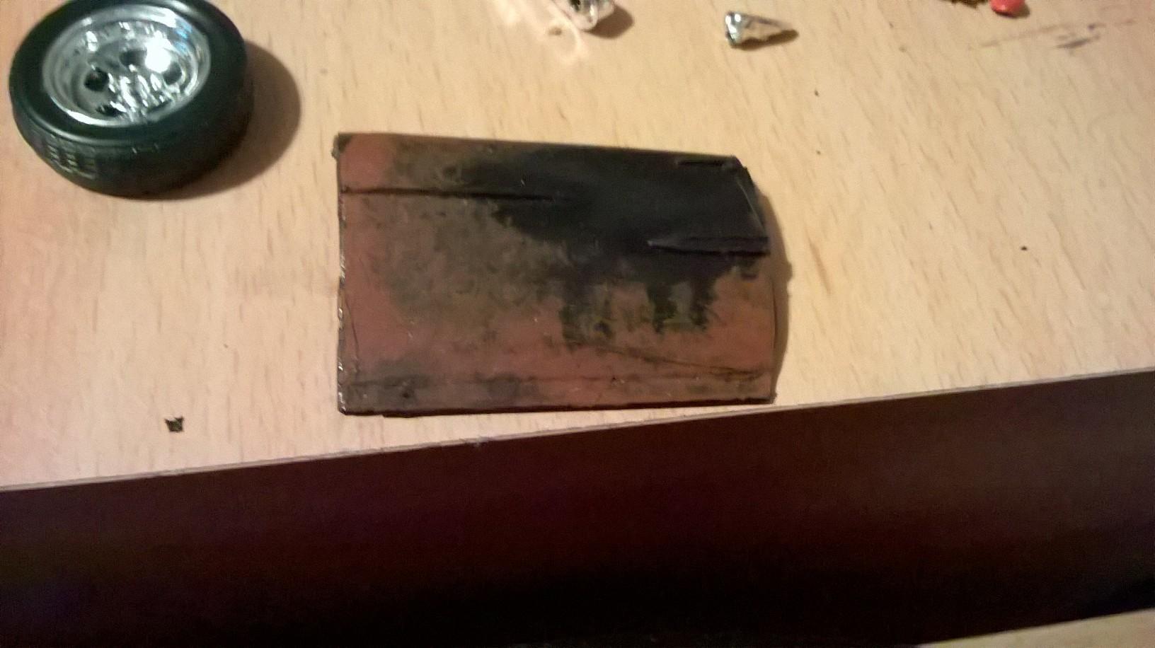

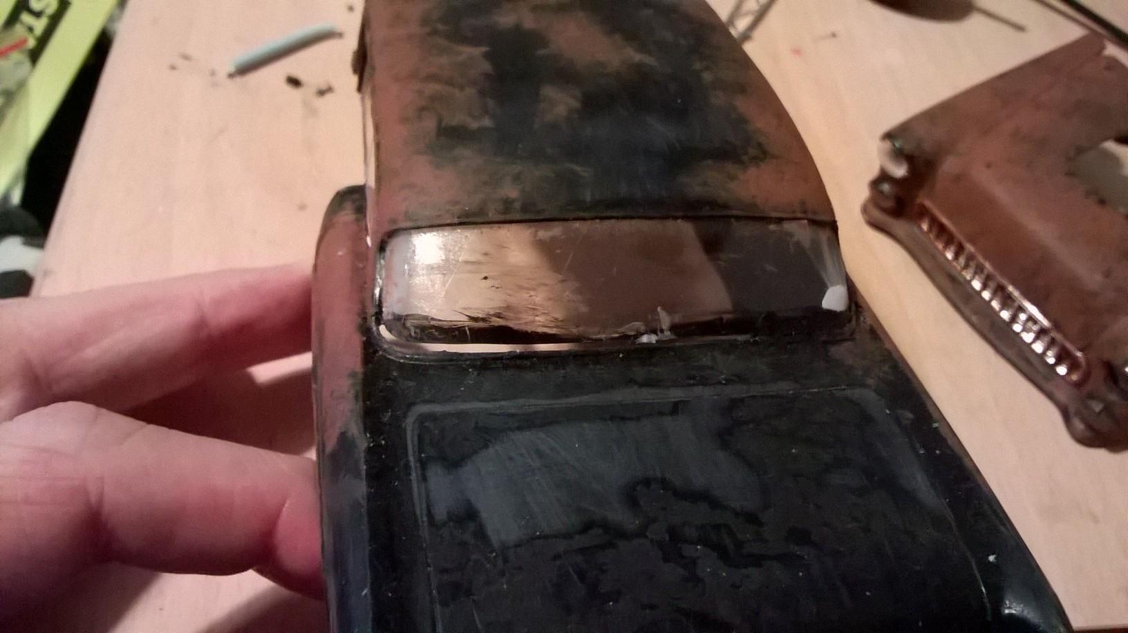

i also dont know what to do about the firewall that he, for some reason, cut out and the terribly cut out door. There is also a lot of glue on the front and rear window and im not sure how to get it off.WP_20160216_22_07_08_Pro.thumb.jpg.d4ffaWP_20160216_22_07_35_Pro.thumb.jpg.47959WP_20160216_22_07_51_Pro.thumb.jpg.b9fc1WP_20160216_22_08_04_Pro.thumb.jpg.ca53e

you can repair that axle by drilling the broken ends and putting a short metal rod inside it; the firewall, IIRC, was mostly flat with sides curved to follow the body sides, so, it could be easily rebuilt from plastic card. the cut out door can be simply cemented back in place with plastic card as backer. now, for the heavily glued "glass"... progressively finer grades of sandpaper is one method... ending with fine polishing compound. that said, that's a LOT of effort to rescue glued glass... perhaps a fellow builder can provide a set from a junker for you? Getting the glass out without damaging the glass further or damaging the body will be difficult but not impossible.

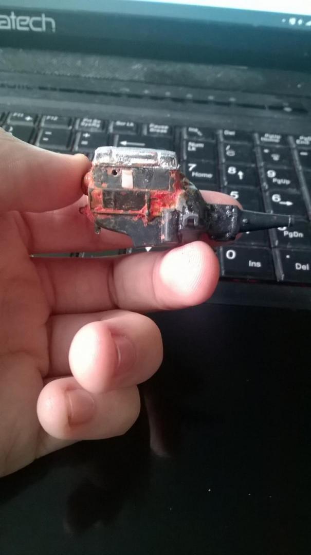

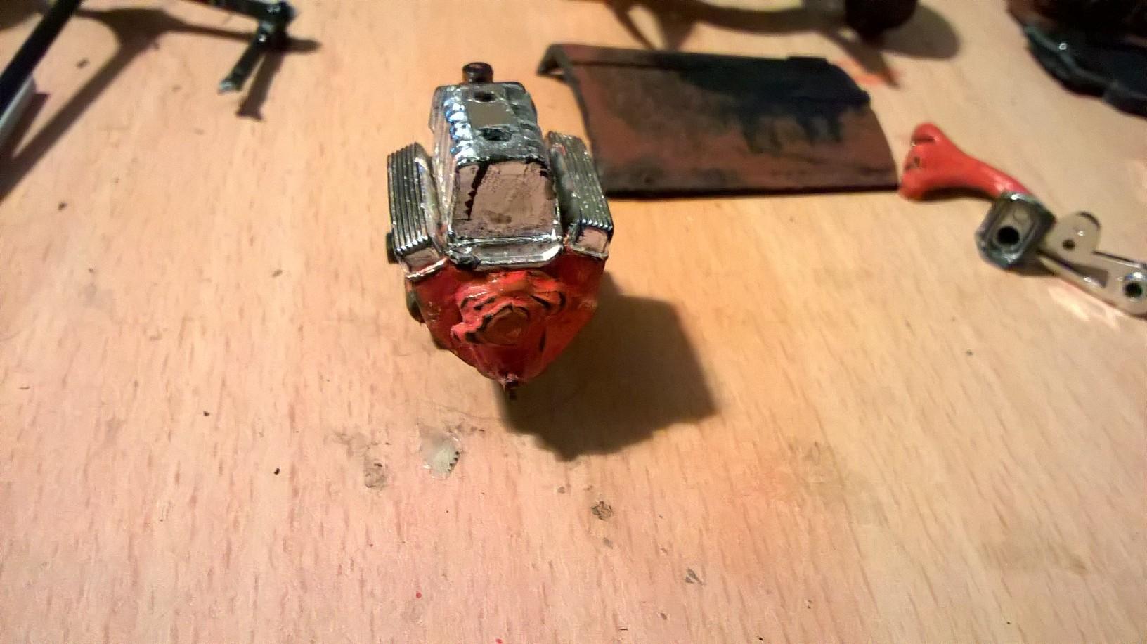

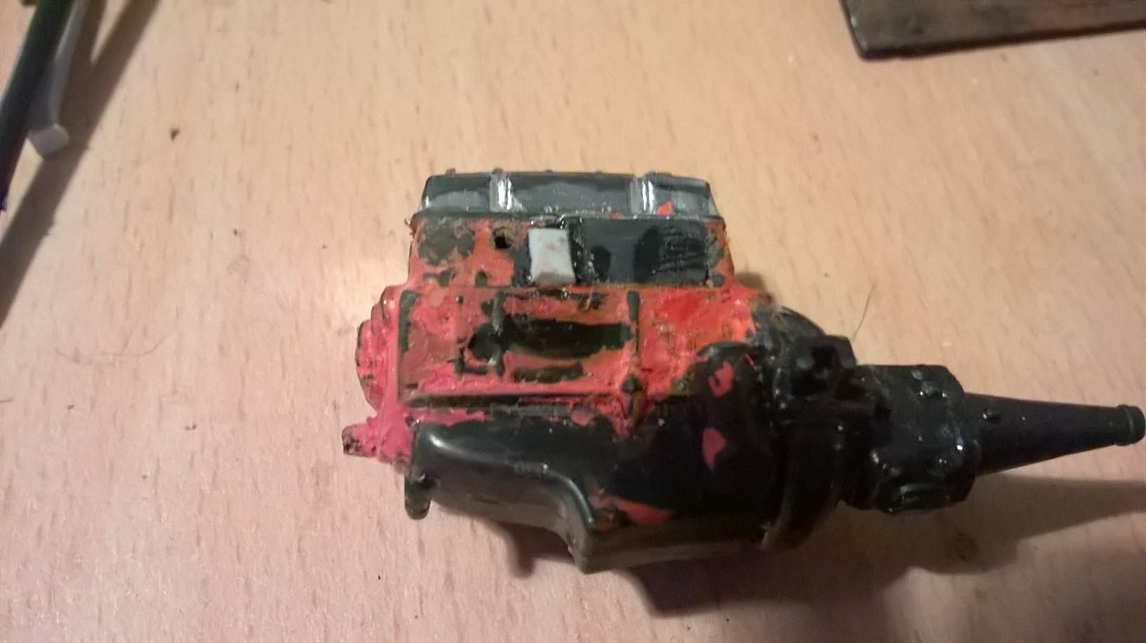

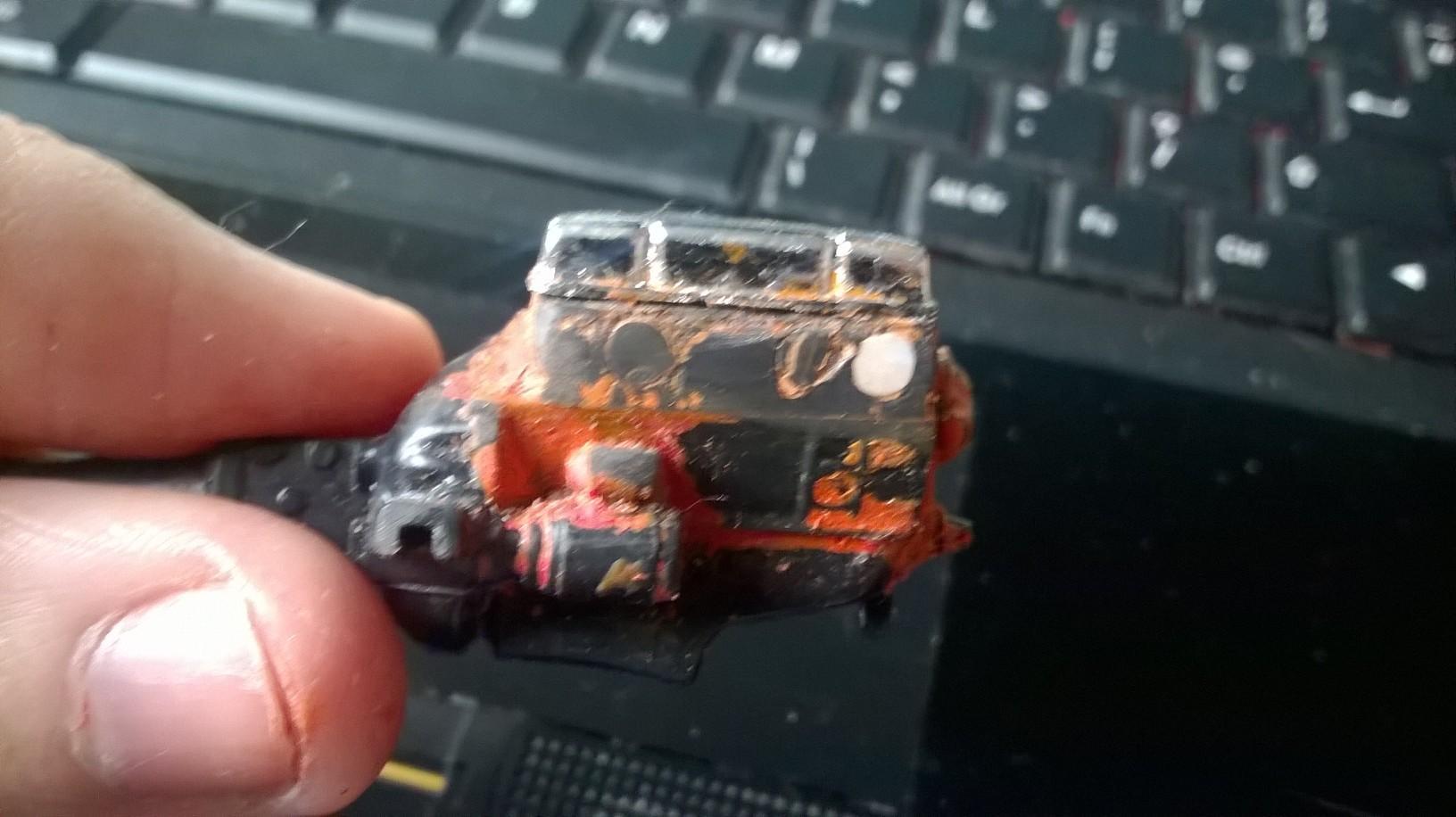

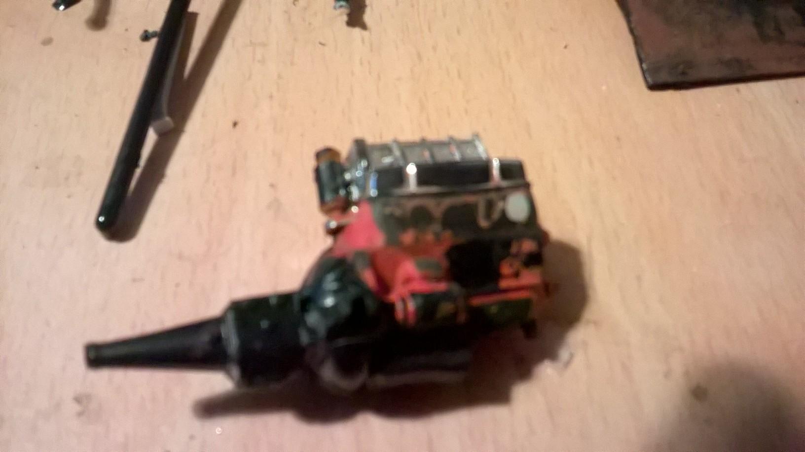

i have stripped the engine down to the basic block now, i think today will be an engine day, but does anyone know how to strip paint off, i tried IPA in a q tip but i cant get in the cracks and it doesnt work too great.

Kai get yourself down to Wilko's and get yourself some Fairy power spray (green bottle) put the engine in a sealable bag without the Chrome parts spray and seal bag . I should remove the paint without to much trouble. It will also remove chrome.
Also if you want to remove the glass from the body shell  . Put the body in the freezer for a few hours then remove and the glass should come out with a little help

Right, thanks for that, i will see if we have some in the house, if not, we be be going out to grimsby tomorow so i can get some then. Or see if i have anything similar in the house, i want to strip the chrome too, if i make a carb, i will have to spray it metallic silver so i may aswell re spray the chrome the same colour so it matches.

Also, for most enamel paints, oven cleaner should strip the paint really well, and won't harm the plastic. Removes most chrome too.
