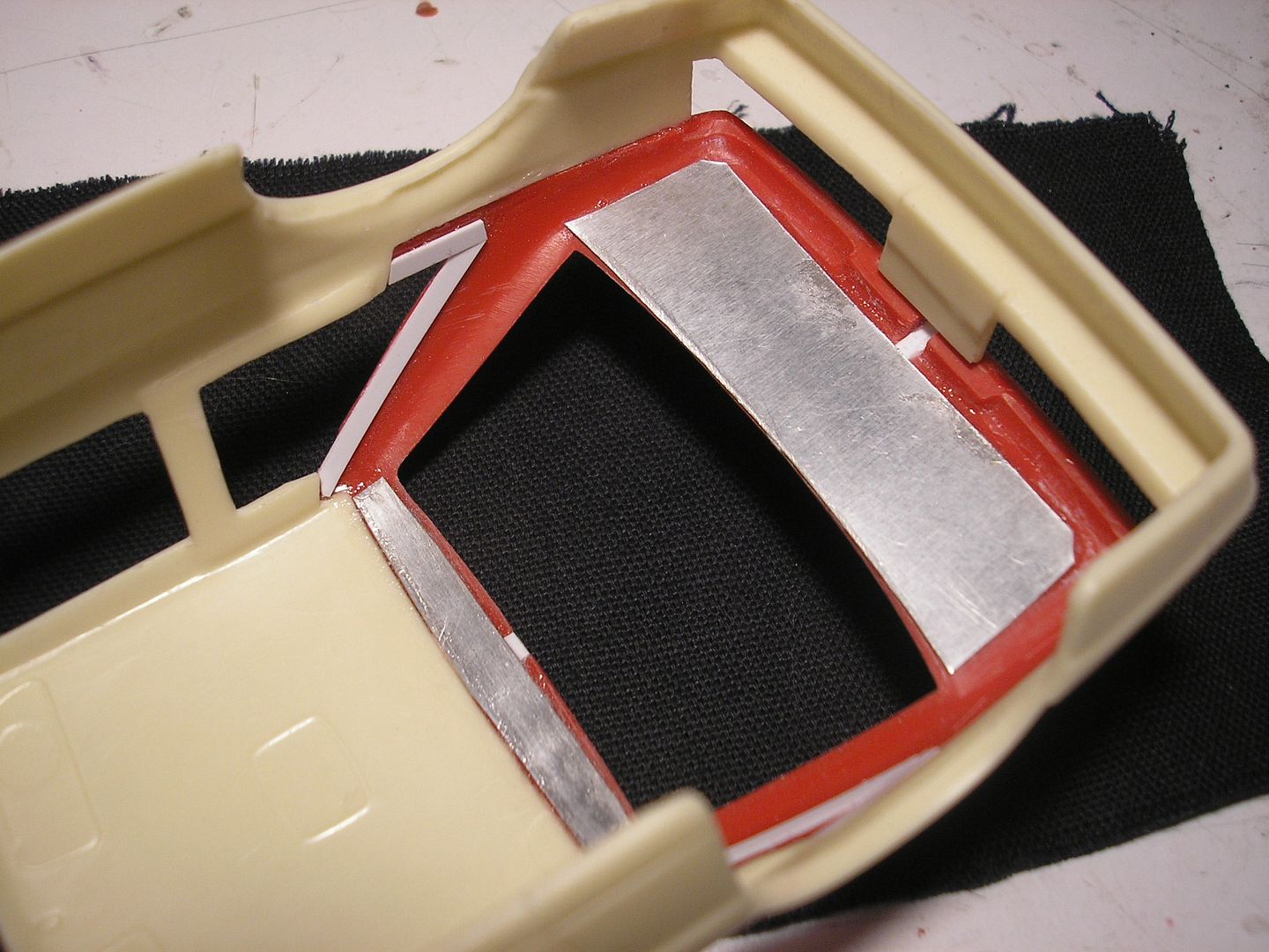

Right on, Dwayne, that's already a big improvement in proportioning. The molding process is a little stressful, mainly in pulling the inner mold out of the body after it is pulled from the outer because it flexes the sides out slightly. But there are tricks to make it hold together: I use thin (maybe .010") sheet aluminum garden flashing and super glue a piece over any joint; plastic to plastic, and especially plastic to resin, as with this Mustang body.
Narrow pieces were added behind all spliced pillars, then worked in with red spot putty to smooth the inside of the body surfaces - also important to make de-molding the master and copies as easy on them as possible.

M. Pace:  Yes, Greg did describe that metal stress point procedure to me.  I'm thinking about it and may incorporate a version of it.  Say maybe rods, or strips as you've shown there, if they can be buried in the body itself.  Sort of battling with the thin thing right now.
in trying to keep it as much like a production kit I've purposely kept all body walls and roofs/hoods as thin as possible on such a kit.  I've had resin kits with REALLY thick bodies in those places.  Shouldn't matter, you can't see it, but it bugs me a bit.  It may have to be a bit thicker to incorporate those strengtheners.  Plus I'll have the foreknowledge to work such things into future masters.  Thanks!

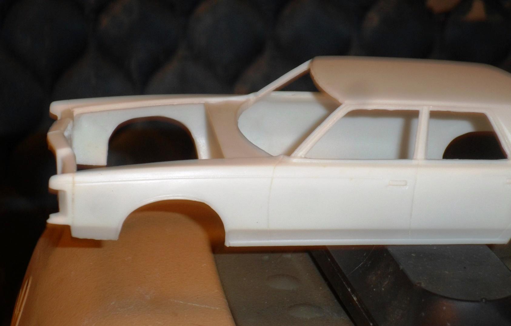

Well, I've been asked by message and assured all that the 91, while in ICU is allright, I feel compelled to show proof of progress.
Taking the roof off one is (for me) a rough thing to do because it rarely goes back on perfectly.  This one was no exception I'm afraid.  Add to that styrene that has been welded and pushed almost to it's limits and I had issues where it no longer wanted to 'melt' when I tried to join sections.  That calls for stronger contact glues,cyanoacrylates or other means. All that plus the added time to allow it to fully harden is taking more time than I care for.  I am sorry it is so.  I did need the feedback to find what I needed to address, I never meant to tease and not come through.  Anyway, here is a couple of pics, just remember the final fine detail work is yet to be done.  I've had symmetry problems I've finally resolved.  Thanks again to all

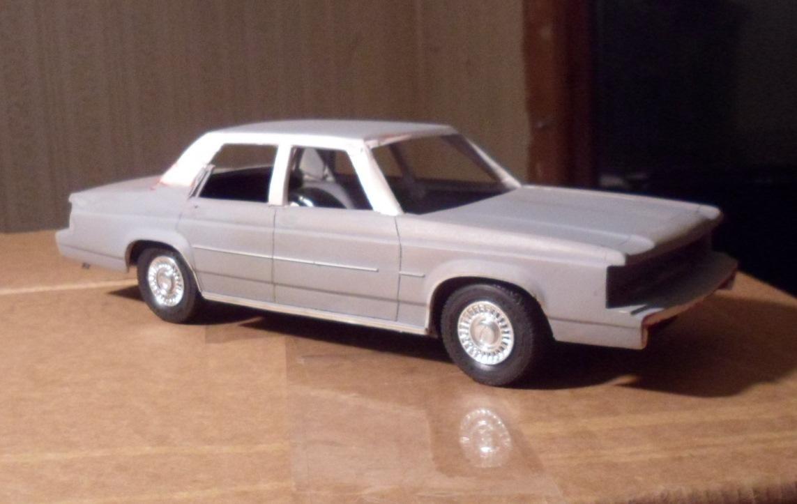

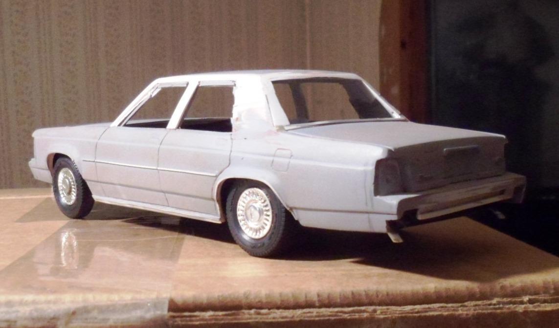

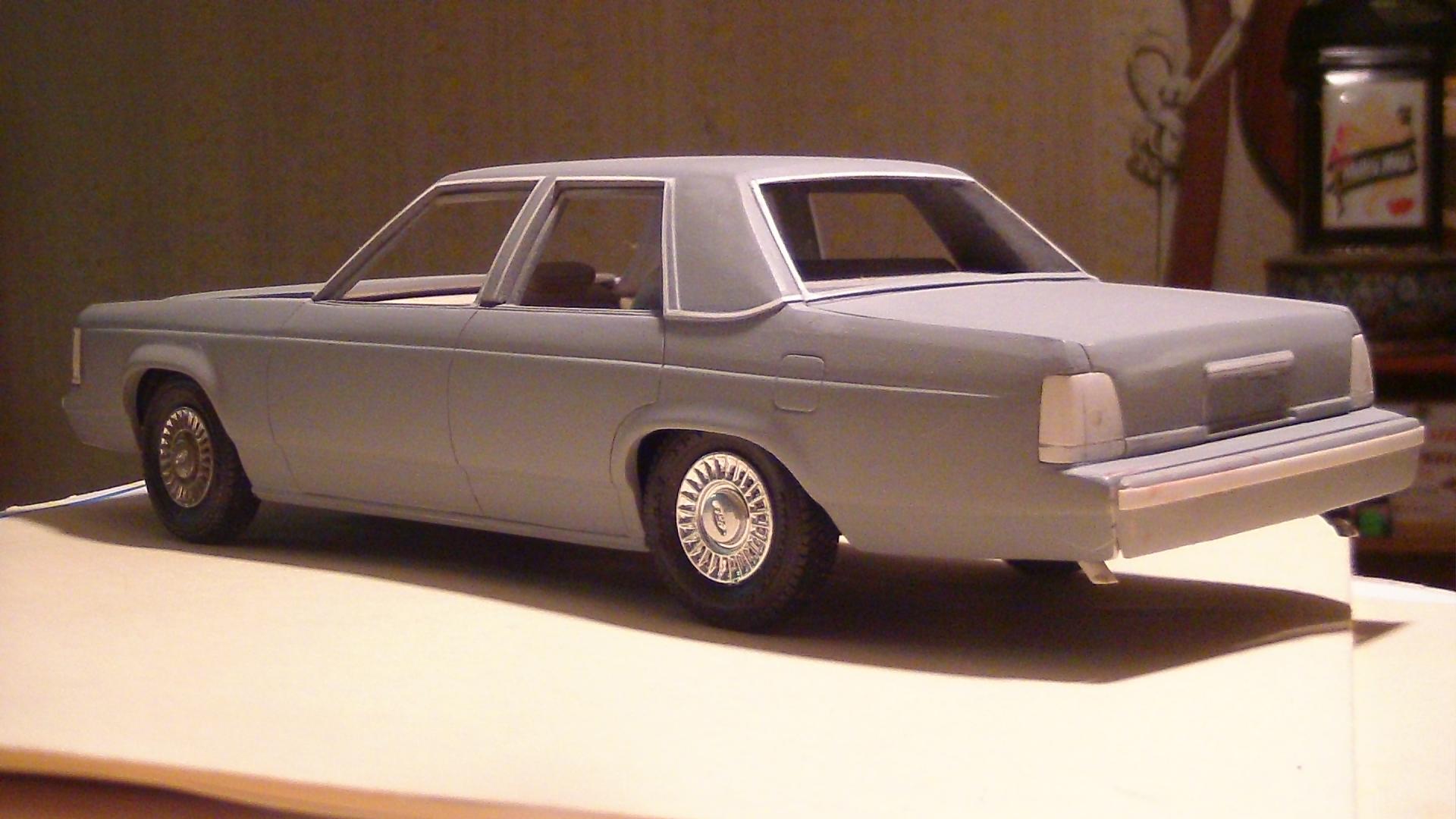

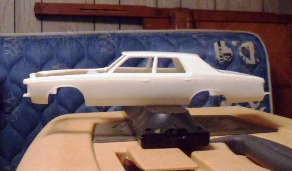

Below is an example of what I meant.  Perhaps some or most all did come out straight.  All I know is that the ONE copy I have is a bit bowed.  I saw another pic online where someone had converted it into a LTD Landau with a vinyl roof and everything and I saw it in that one too, but I couldn't save he pic.  The pics below are some I took last night just to try and illustrate what I alone think I see.  The built up is the one copy I received from AAM in 98 or 99.  The unbuilt is the ML version I received in 2010 or 11.
Not trying to start a peeing contest, just have a look and see if you see what I see.. or anything or nothing at all .  (I'm no good at a'' with photoshop or Paint but I tried to put some lines on the pics to show what I see. Like I said, maybe the one i have got warped afterwards or something)

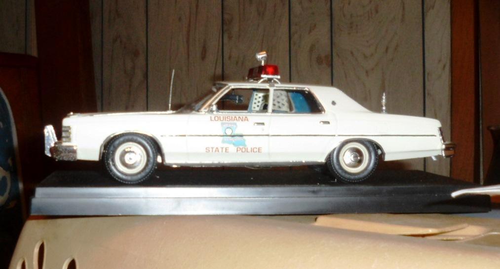

Me again, Margaret.

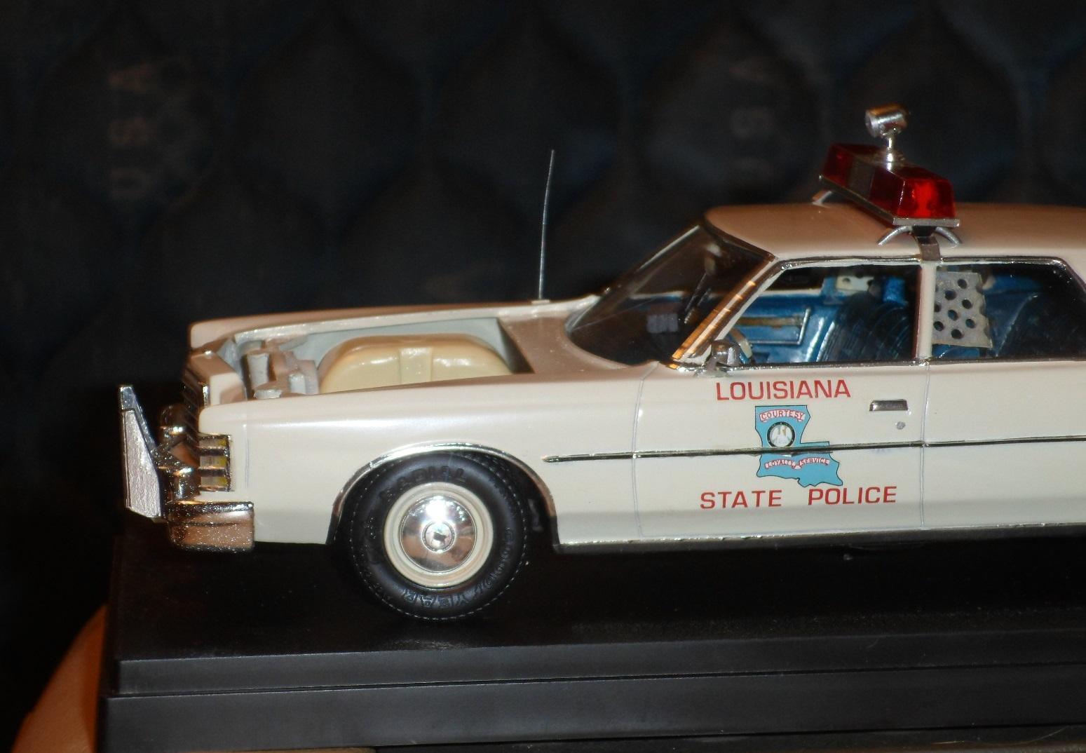

Just to let you good folks know I really am still working on the 1991, and it's still job 1, but I just had to finish another that had been around too long. So over the Labor day weekend I took a breather and finished a 1982 Diplomat of the Louisiana State Police.  If anyone cares to have a look it is over on the worrkbench forum or can be found below.  It has many sigular police parts built just for it.

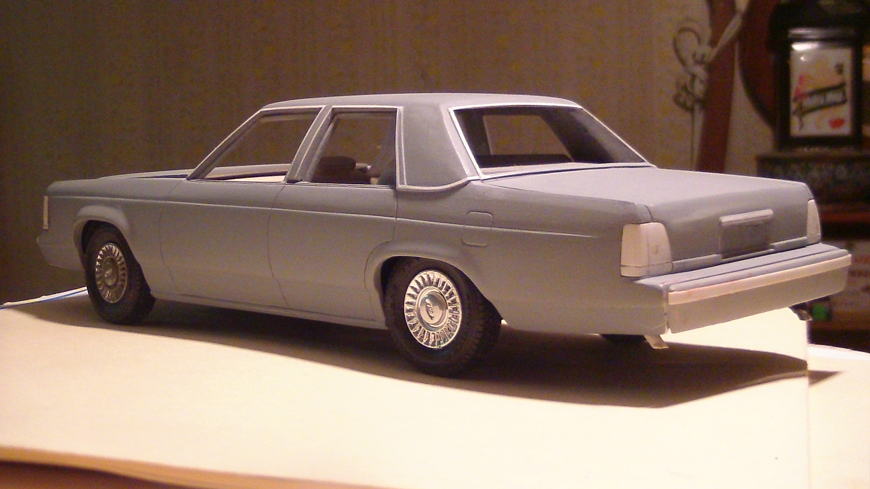

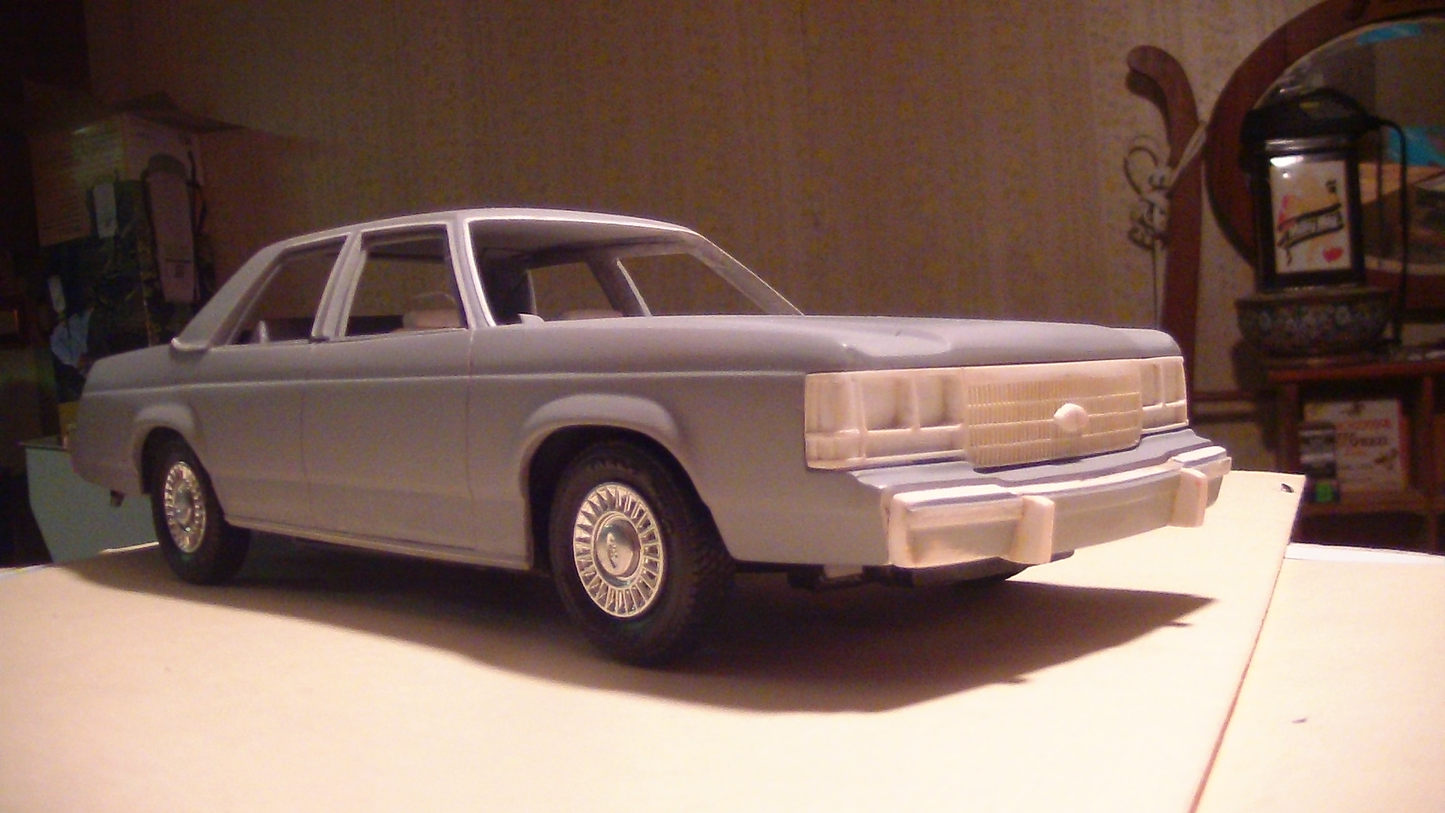

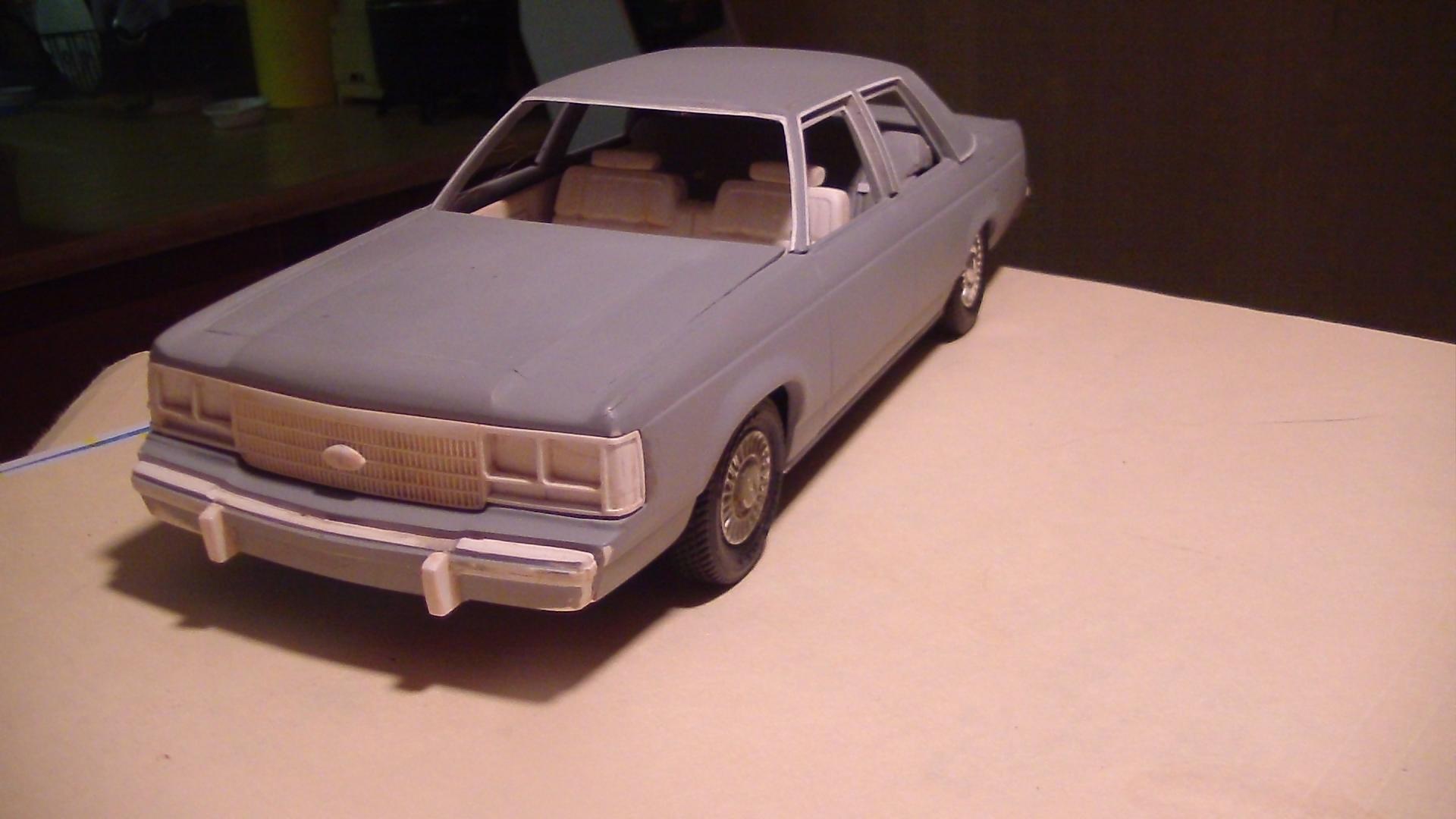

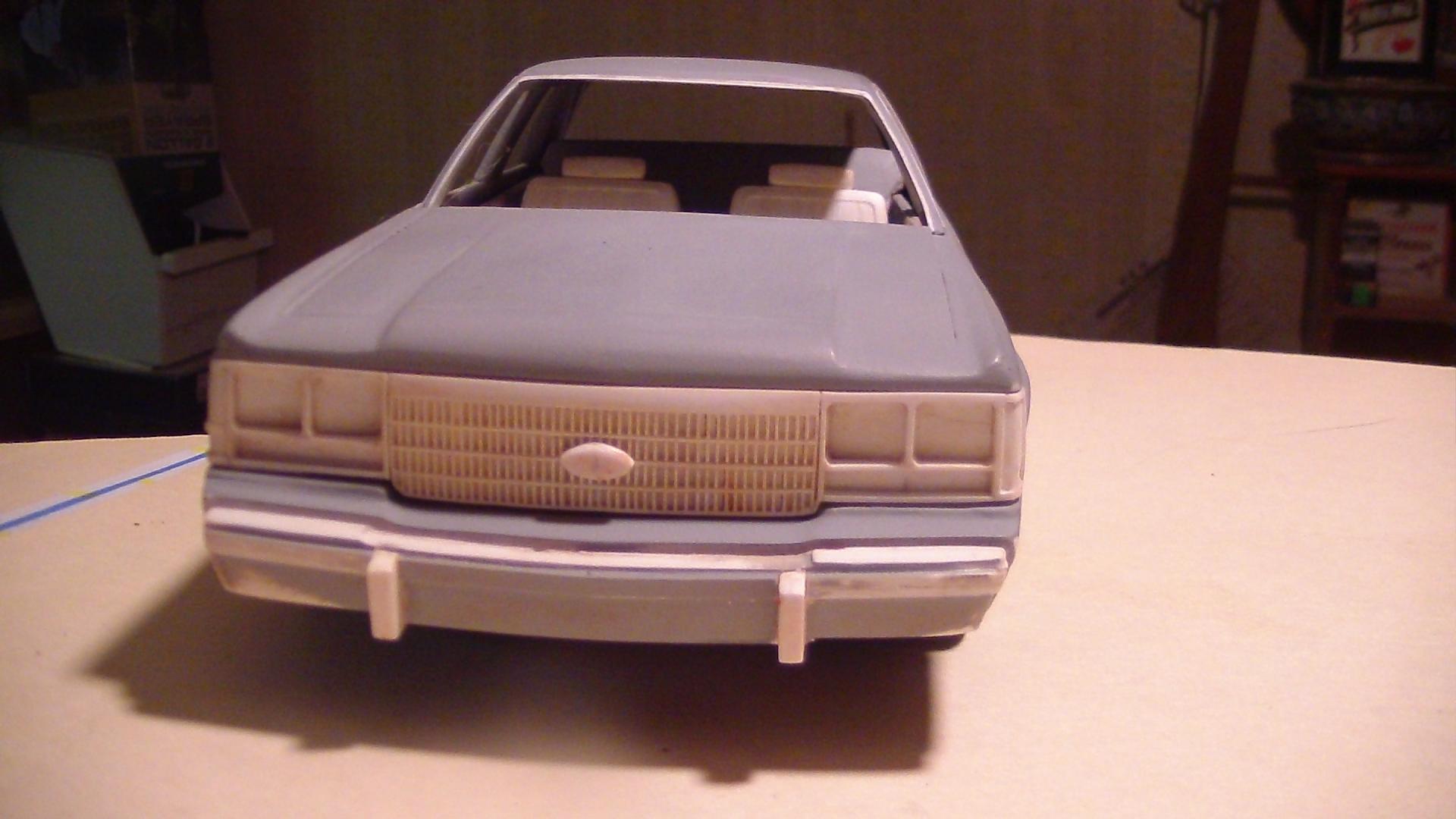

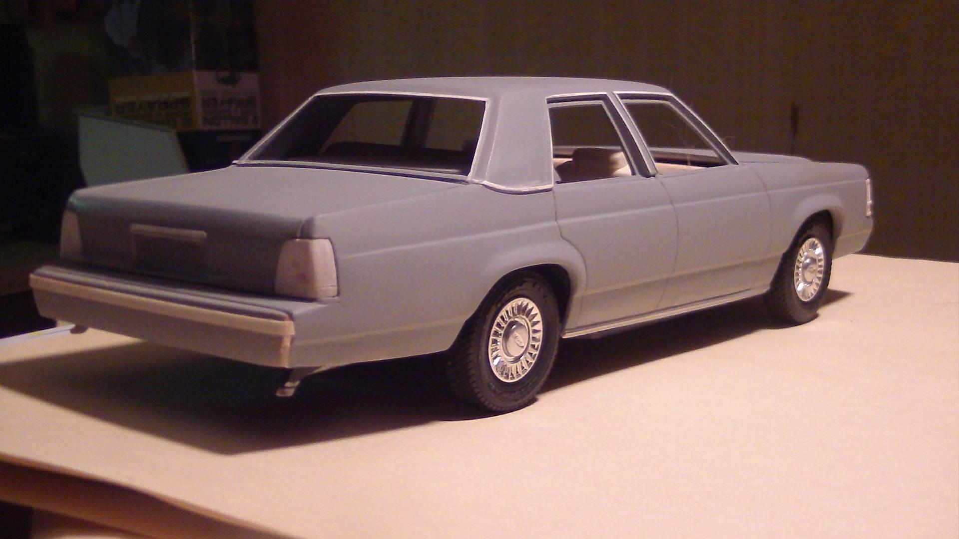

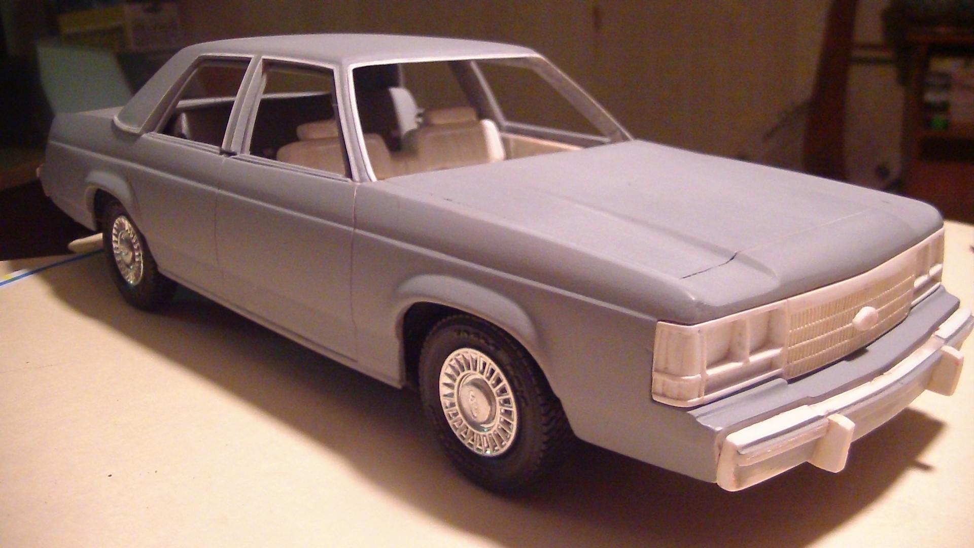

Well, here's a couple of pics of where I am at.  The majority is done.  Though I admit I keep seeing.. stuff. to do.  I got intricate on some of the other details, raised the roofline, thinned out the A pillars, corrected C pillar angle, and a couple of other tiny details.
Screech if you see something off.

Hi Dwayne,
  This is looking really good.  I have been wondering about you.

It looks dead on nuts accurate from where I sit! You WILL be busy with orders for this once you get this out on the streets! ;)
In a former life, I was a cab driver and these were all over the roads in the late '80's/early '90's. Now I can't remember the last time I've seen one.
Excellent work!!
Share this post
Link to post
It looks great, just like you promised! I will definitely be one of your customers for this.
Share this post
Link to post
I want one of these! Any plans for a Mercury conversion?
Yes!
As well as each of the other incarnations of the 79-91 box body Panther platform in due time. I HOPE to do at least one of each of the big 3's four door police offerings from 71-91.  Hope hope hope.  Some are already in the pipeline. Baked in the cake. frigged in the pudding (?!) not sure on that last one, but I'm sure they used it on one of the current news shows.
