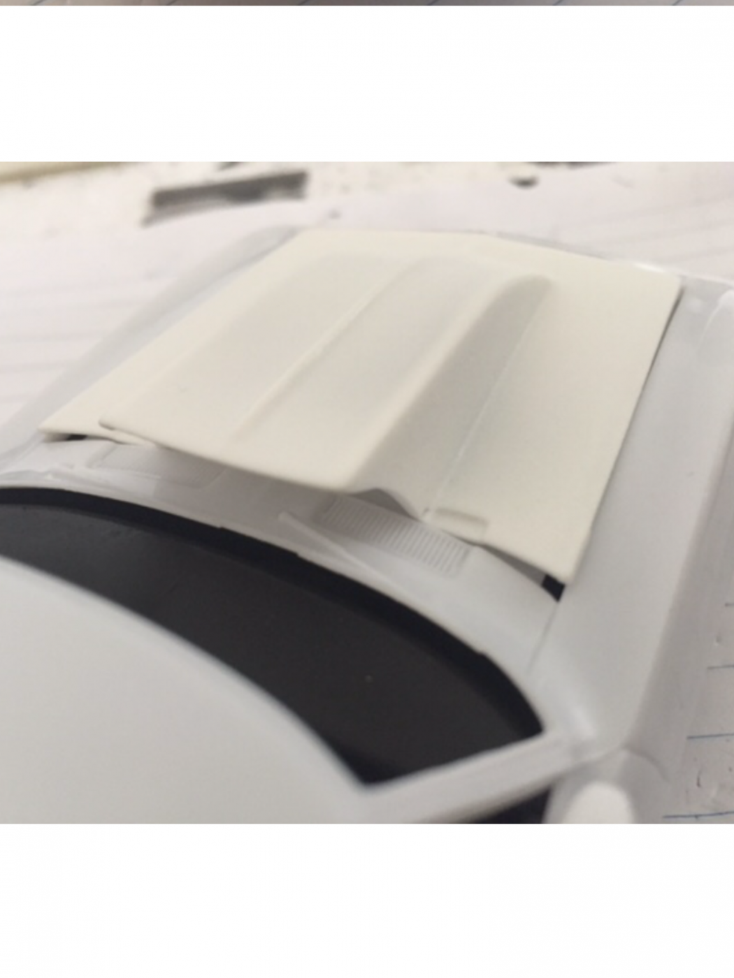

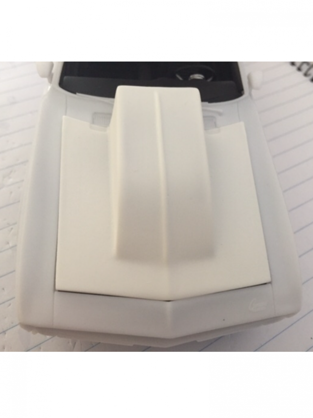

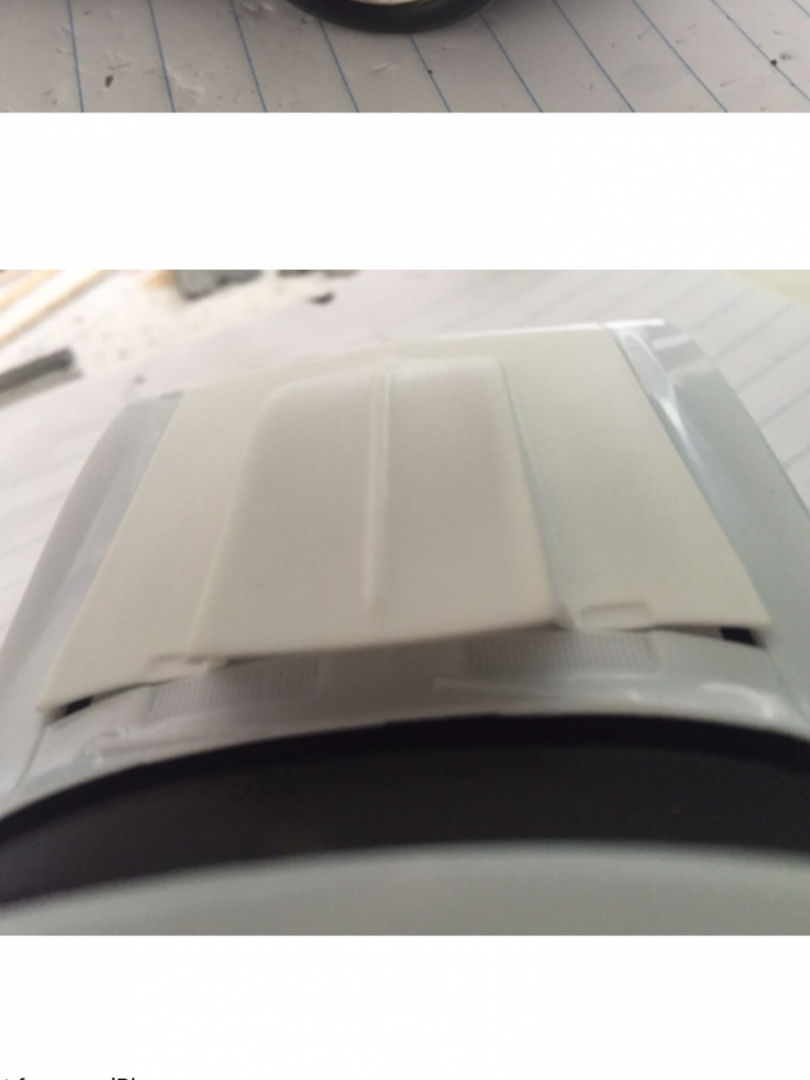

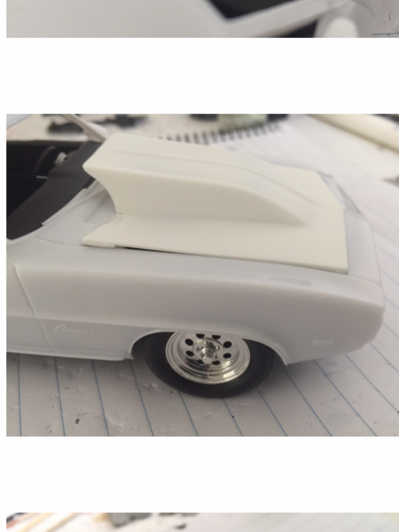

Immortal Chips Posted March 28, 2016 Share Posted March 28, 2016 Hi all, just after some advice. I've used these hoods in the past and also just received a new lot for future builds but the resin hoods never fit well. I've tried reshaping them by trying to heat them and set them back into place but its very difficult to get them perfect. Ive ordered them from Competition Resins and their stuff is good but the hoods also seem to be an issue. Does anyone else have any advice or tips on how to get the hoods to fit properly? I've supplied some pics for reference. Thank you for your help. Quote Link to comment Share on other sites More sharing options...
MrObsessive Posted March 28, 2016 Share Posted March 28, 2016 I'm no expert as resin, but I can tell you that my experience has been that when you heat up resin (hot water, hair dryer, etc.), it's best to immediately lock the shape into place by putting it in cold water. Also contrary to popular belief, resin does have a memory, so it's also a good idea when you're washing the parts, to NOT use hot water again as guess what??.............the resin will go back to the shape that it originally wanted to be ie: slightly warped. I'd use very lukewarm or cold water to wash things up.I would also paint both sides of the hood so that the solvents won't pull one side away from the other-------not doing so can lead to the same type of warp you're seeing. Hope this helps as that can be frustrating........others may have different methods to help out. Quote Link to comment Share on other sites More sharing options...

Lunajammer Posted March 30, 2016 Share Posted March 30, 2016 This might be salvagable if you have some time. Looks to me like it might have been cast okay, but stored poorly. Resin will warp if pressure is placed on it over time. Even being in a tight bag might do this. Looks like it flattened out. Sounds like you know to try sticking it in hot water to soften it up, counter-warp it by hand, stick it into place in your model, tape it down and leave it there a long time... like a month or two. It may find it's way back. Some white resins remain pliable for weeks if not mixed perfectly. If it was bagged while still pliable, then set that way, you may be out of luck. Either way, the caster should make good. Your photos pretty much tell the tale. Quote Link to comment Share on other sites More sharing options...
Mark Posted March 30, 2016 Share Posted March 30, 2016 The shape of the hood (the cross-section) combined with the (infinitely minor) shrinkage of the resin are probably the cause. I've got two copies of a particular hood, made years apart by two different casters. Both have this same problem.With my hoods, the part is thinner at the edges, heavier in the middle (scoop area). This hood is of relatively consistent thickness, but the scoop is at the center and it uses quite a bit of material compared to the relatively straight outer portions. The resin doesn't shrink very much, but when it does shrink it is doing so across the entire length/width of the part. The scoop area, whether thick as on my hoods, or thin and relatively large as on this hood, is shrinking more than the outer portion because it has more material. That appears to be what is pulling up the corners of the hood. I've forgotten a fair amount, but have cast enough different part shapes to figure out which shapes are likely to be problematic. Had the hood been cast as two pieces (hood with hole, and separate scoop) or maybe three pieces (center section with scoop/forward portion of hood ahead of the scoop, and two outer pieces) there would still be the same amount of shrinkage (which isn't even measurable, really). The separate pieces would fit together and the assembled hood wouldn't have that curling problem at the corners.Is the center/top of the scoop sinking in too? The rear edge of the scoop appears to be straight, as does the forward part where the scoop transitions down to the level of the hood. That makes sense to me as the rear edge has the two sides to shore it up, while the curvature at the front lends strength to that area. The closest comparison to this would be casting a four-sided piece (like a box but missing the top and bottom surfaces). The sides will all pull in towards the center because, towards the corners, each side has the corner to strengthen that area. In the middle, there's nothing to shore up the side, so it will pull in a bit. Quote Link to comment Share on other sites More sharing options...
