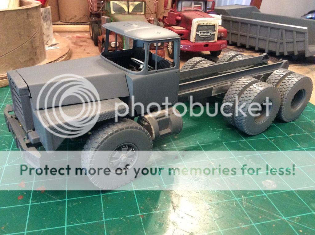

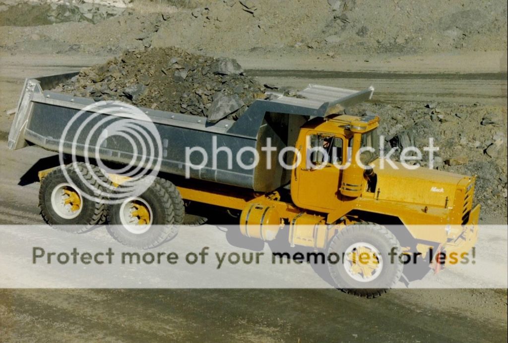

Hey guys. Heres a project that I first showed in my "in progress" thread. The inspiration is a Mack R800 model that was built for Australia. Its basically a DM800 with a centered cab because of the right hand drive. It would have been ridiculous to be sitting in the middle of the truck. Zero side visibilty! Anywho, leter in the RD800 was built in America but has a taller hood, lower flatter fenders, and square headlights. To me, the Aussie truck is the coolest one. So Im building a "what if". Im building an American version of the Australian Mack, or a R800rsx with left hand drive. I just really have never been a fan of the offset cab, but I like the long squared front of the DM800. Heres some of the 1:1

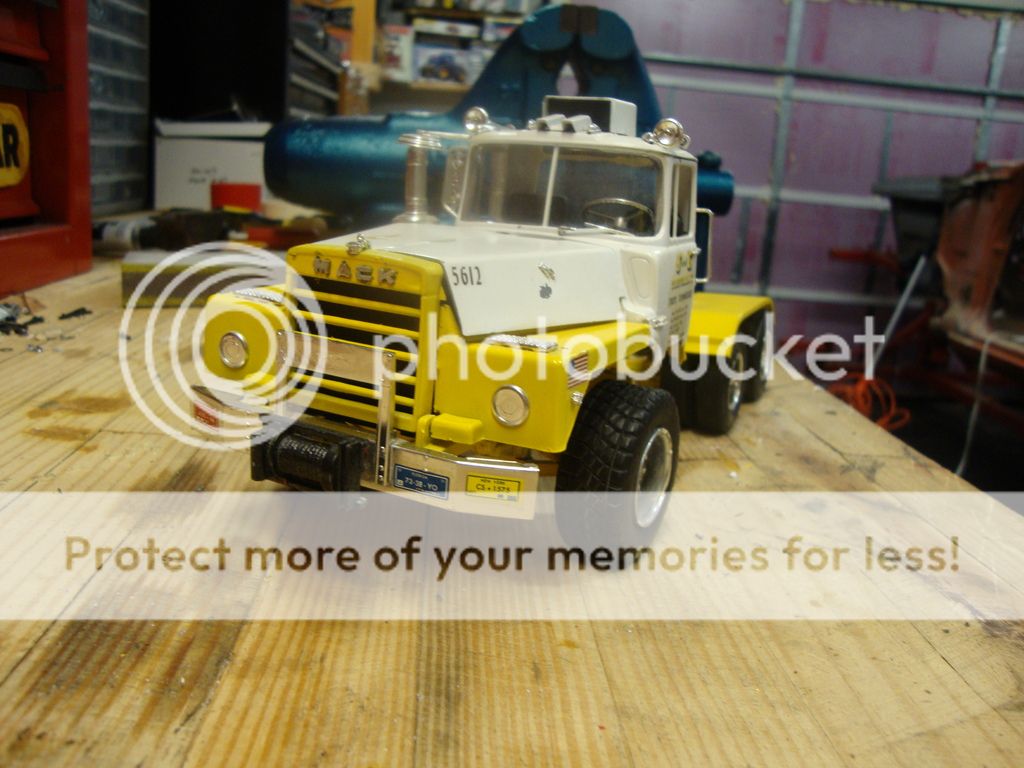

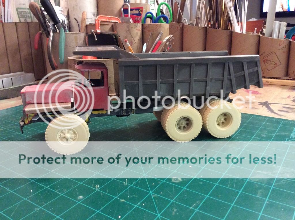

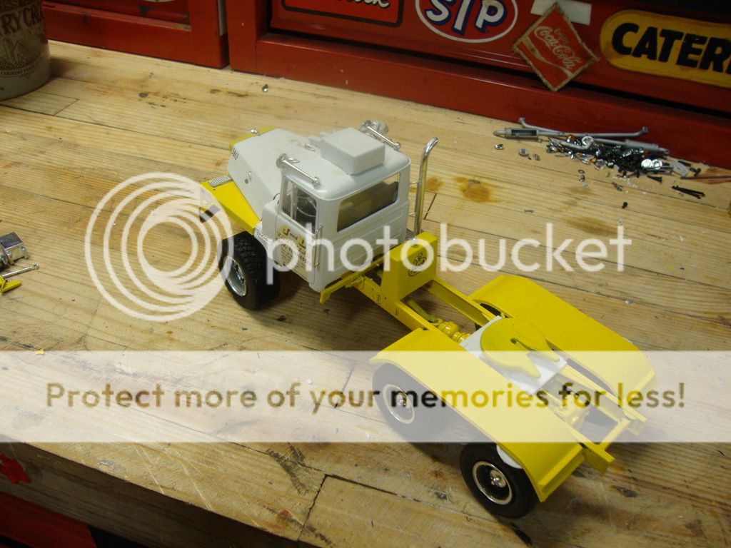

The base for this build was a DM800 I built as a kid. This is how it looked in 2009 when I pulled it out to start a rebuild.

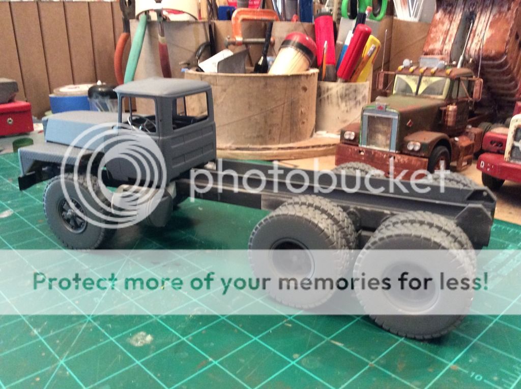

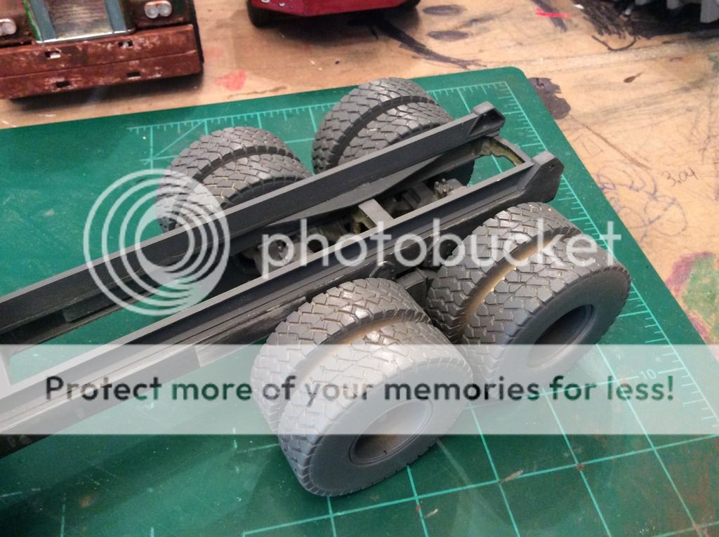

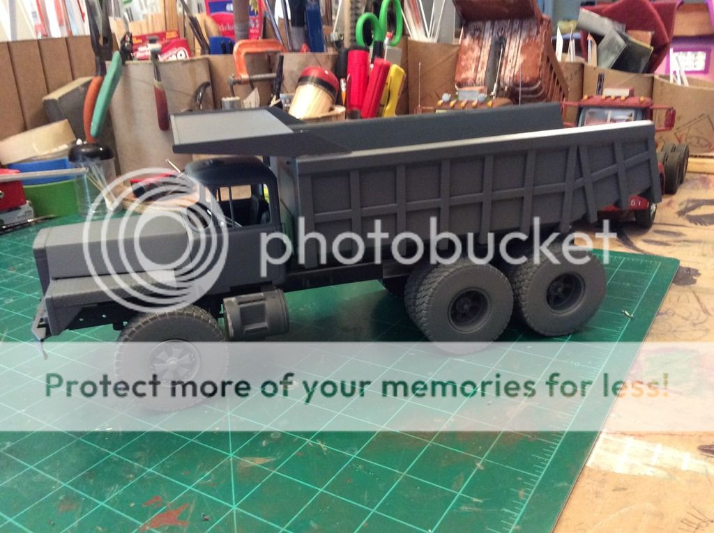

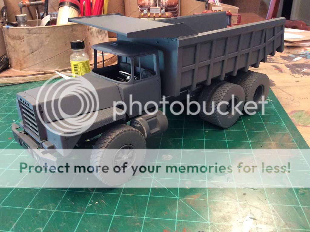

After beefing up the frame and stretching it about 1-1/4, filing and sanding the tires, added some round tanks from an AMT R model, re-inforced the front axle, and throwing some primer on the whole thing heres where I am.
047CBE5F-B47D-4319-B5B0-0B6F8ECF12B6_zps
B5573A0A-EB0A-401E-9699-3BFBE4E7F476_zps
31D787D8-EC1D-432E-8C20-C8DB87B2FD7E_zps
52F4B632-57CC-4464-90CF-3D9A8E50DFC1_zps
CCB92875-C3BD-4CD1-8623-FCC82AB3E07D_zps
E458DCE2-3A3A-477D-AC01-0E23DBD88023_zps
FAAF6C40-8150-42A9-B7EB-1323FAF1B39C_zps

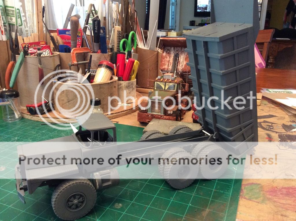

wheels are AITM, dump body is Italeri. I notice that I will need to move the fuel tanks back!

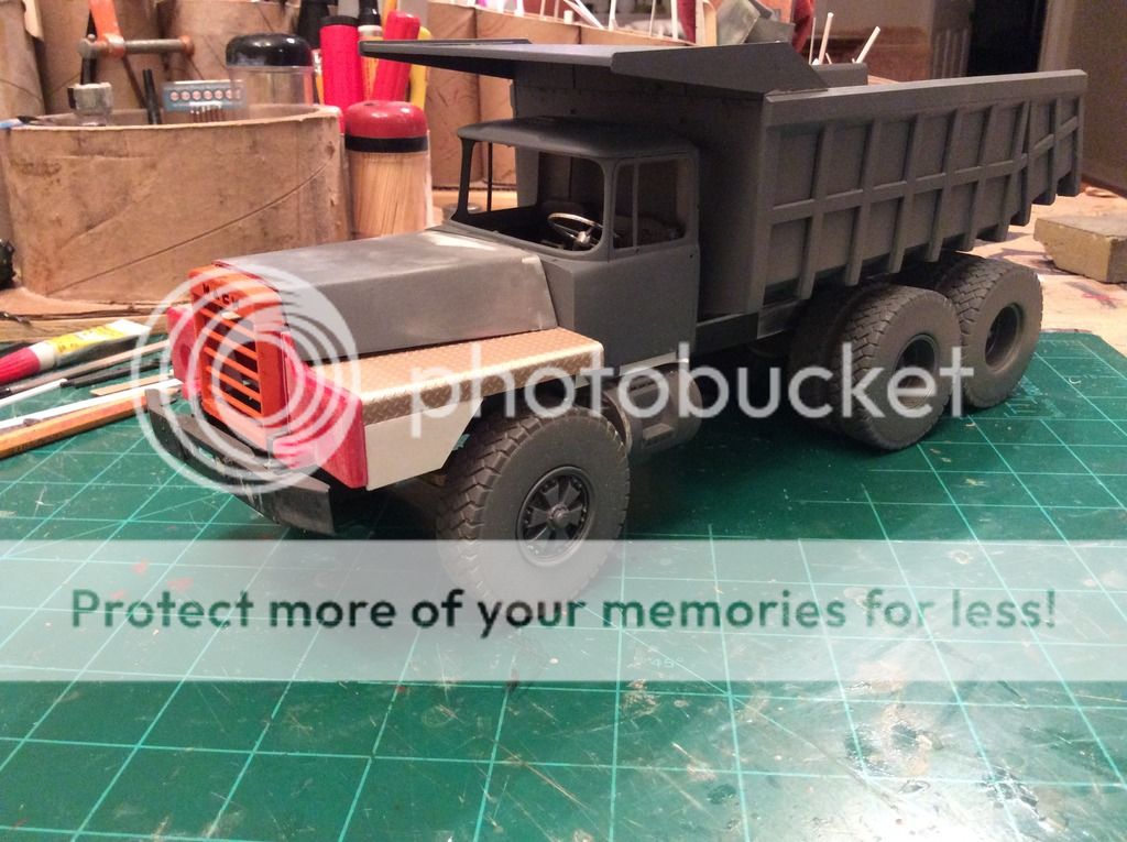

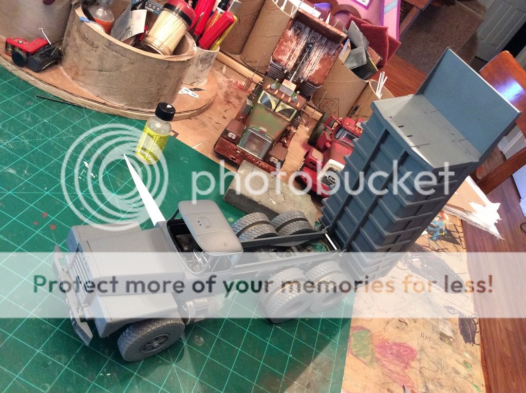

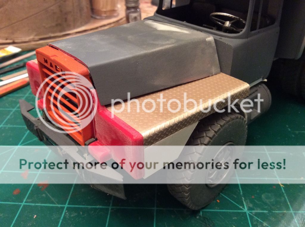

Update for today, I built a new set of front fenders. I pulled a new grill and fenders out of the junkbox and started cutting. I cut the fenders off about .125 behind the headlights, and rebuilt fenders covered in diamond plate. I also added the extended fender that is present only on this Australian model. Im satisfied with the progress. Im pretty sure this is the biggest truck that Ive built, mainly because of the wheels.

It will definitely be a Dumper.

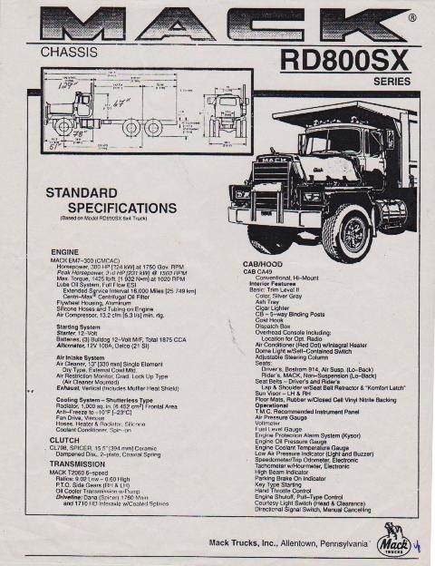

Here are a few photos and measurements of the positioning of the front axle.

Thank you Alain, but thats a different truck than what Im building. The Australian R800 and the American RD800 are very different. The DM800 was inconvenient to make right hand drive because of the offset cab, so these were built. They were using left hand drive DM800s in Australia prior to these being built. If you notice the 1:1 photos in the first post you will see the difference.

Yes I notice but the dimensions of the front axle must be the same...
