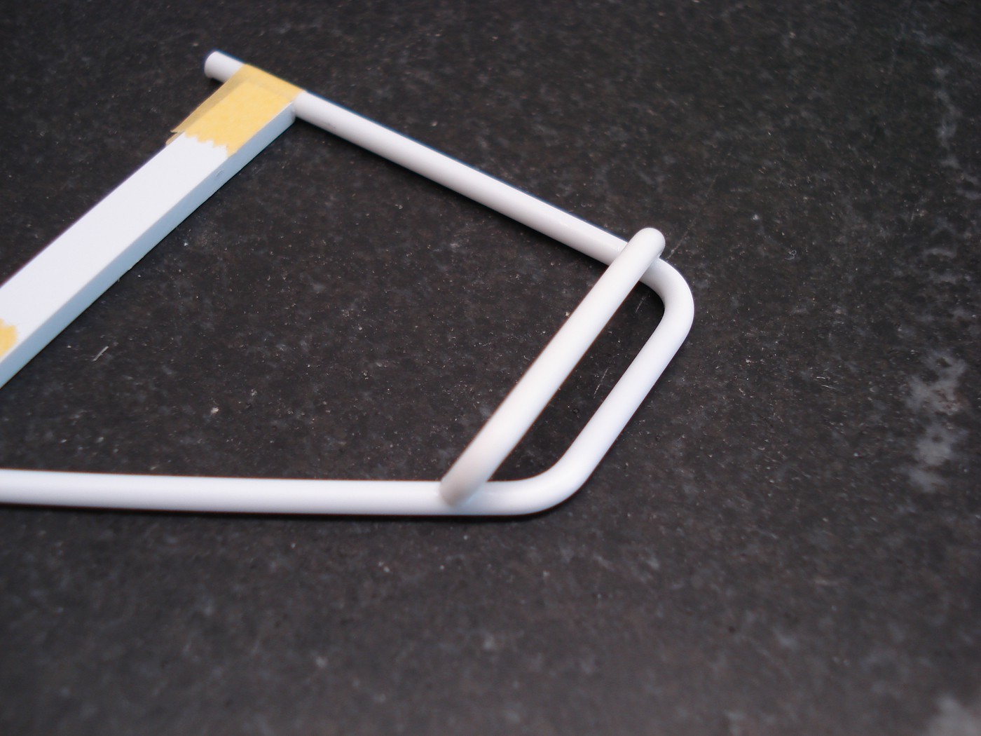

STYRENE-SURFER Posted August 2, 2019 Author Share Posted August 2, 2019 (edited) More work on the roll-cage, (for those of you who know, the Microwave Experiment was kinda a bust. LOL) Made some holes (recesses) into the tub for the roll-cage to mount into. The Right side bars have to center over the frame-rails below. Left side are nearer the door opening. Made a fixture for locating the holes over the right side frame-rails ,left side corners, and a simple depth guide so I didn't punch through too far. ( 0.040 thick Evergreen sheet and a length of 0.125 tubing to set the depth) Here are all the location holes (cage mounting points are offset to the left on this car). Added this bar to the Hoop, attached to it will be a headrest and harnesses. Does anyone Know what year rules added forward roll-cage bars? I mean ahead of the roll hoop. ( I'm guessing '68) Reason I ask is the photos I've collected for this car show at least five different evolutions, most not dated. Edited August 2, 2019 by STYRENE-SURFER Spelin Quote Link to comment Share on other sites More sharing options...
