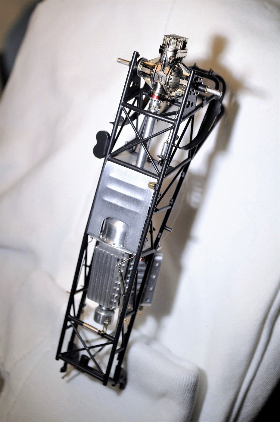

Thanks fellas for all the sentiments you've shared.  Art I think captured how I felt about that step....setting the gem in the ring.  Good one Art.  Well, that got me really going so after letting the glue set I flipped it over and attached the floor and oil pan.  There won't be many pics of the bottom end at this point so I thought I'd share these couple of pics.  Cheers & Thank you once more!  Tim

Eegads, that's gorgeous. What did you use for the metal, if I may ask?

Hi Brad, I used the printer plate you sent me........thanks again, that stuff is fantastic.
