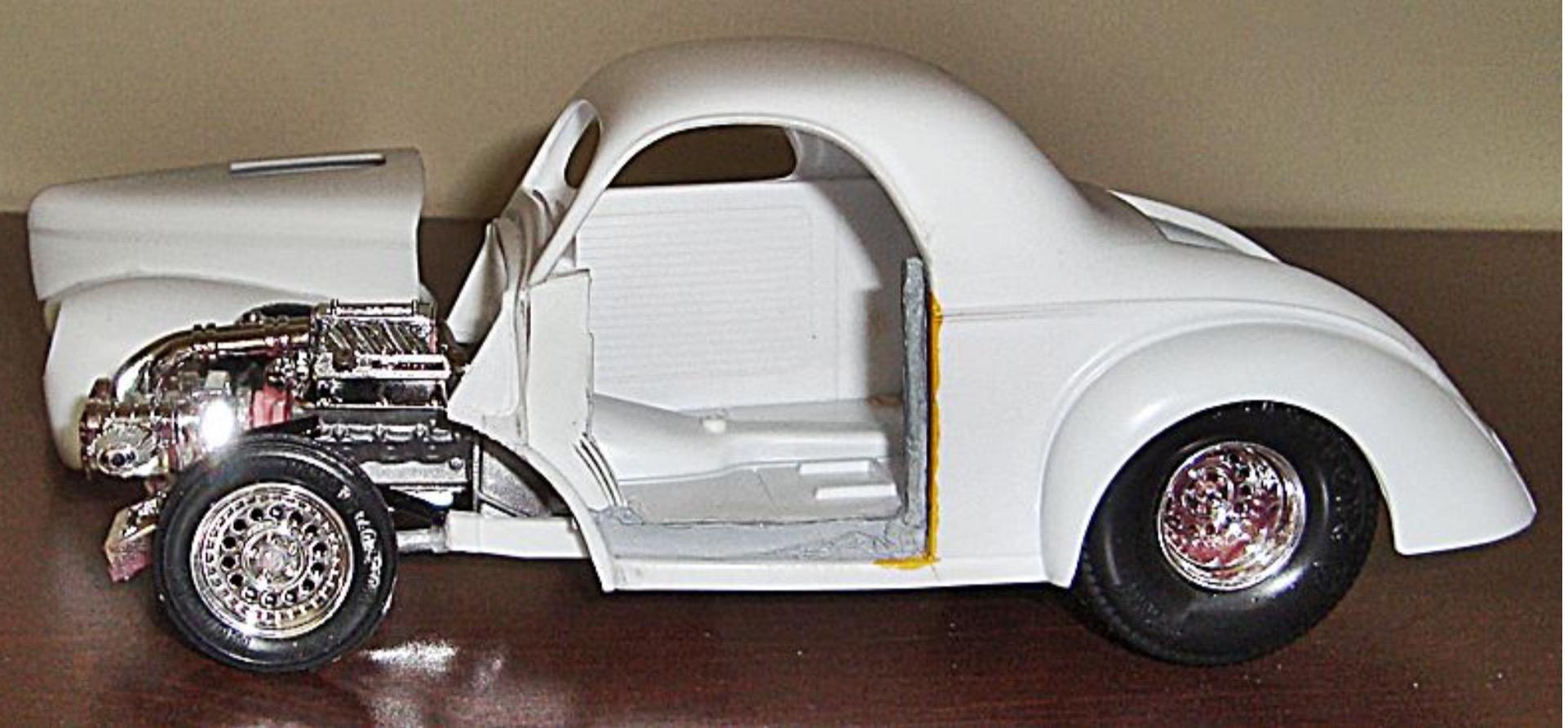

This was started 7-8yrs ago. I had heavy modified the chassis, I had used the engine set up from the Matt and Debbie Hays Thunder Bird. Over the years I revisited it a couple of times, I ended up getting too picky on what and how I was going about the mods, somewhere along the build I lost my way. Upon my final attempt to finish it I decided it was going to take WAY too much work to get it where I wanted it.
So out came the motor and tranny.
The body will need lots of filling and sanding before the painting imagination starts to take hold.
This is how it started life. The last pic is the paint colours that will be used, still working out the layout. I will be using some type of fabric media as a stencil pattern.

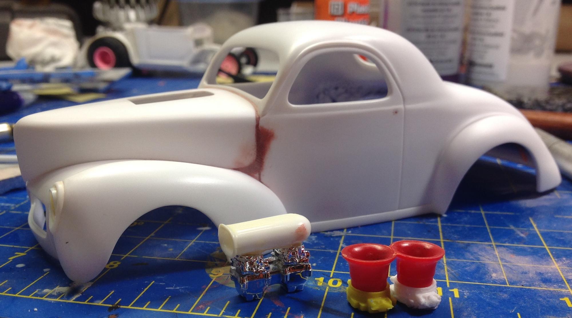

I have decided the body needs WAY too much work. So it's been boxed, I pulled another shell from the stash. In order to move this build along velocity stacks and carb detail will be added to the hood opening. I really didn't want to do any real filling and sanding on this project, I just want to get on with the painting. A mold will be made from the carb found in the parts box and a second carb cast.

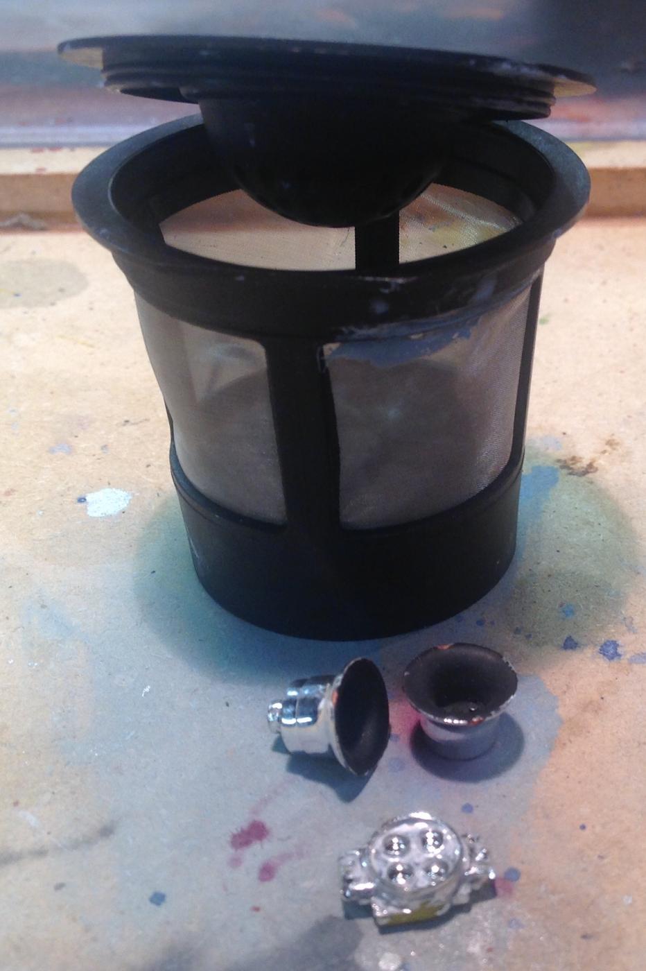

I use reusable coffee cups when putting small parts in stripper. It just makes life easier.

Anyway quick update.

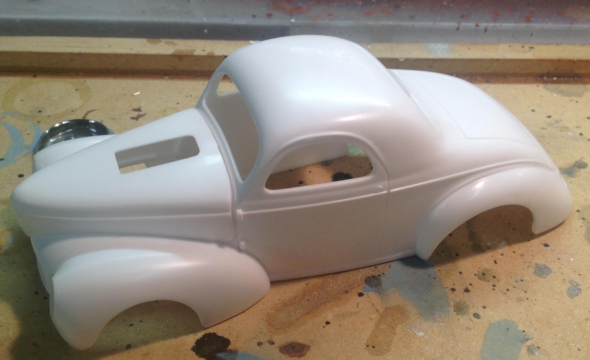

Still at the shell clean up stage, it is going in for the white base coat this morning.
The breather and carbs have been sorted out. Change of plans on the carbs and velocity stacks, the dominators were just too big, plus the stacks just look wrong.  The white dominator is the
one I cast.
The traditional scoop and Carter AFB 650cfm carbs on a tunnel ram are my final choice.
As for paint, my head is swimming with the paint lay up steps and ideas.
My original lay up had me at about 25 steps if you include the light wet sanding between the 5 different colour coats and all the masking.
If I go with what I have come with this morning adds a few more steps that are mostly tedious cutting and laying of the masking tape. Then of course all the normal final clear coat steps. What ever I end up doing will be colourful, and definately OTT in appearance.

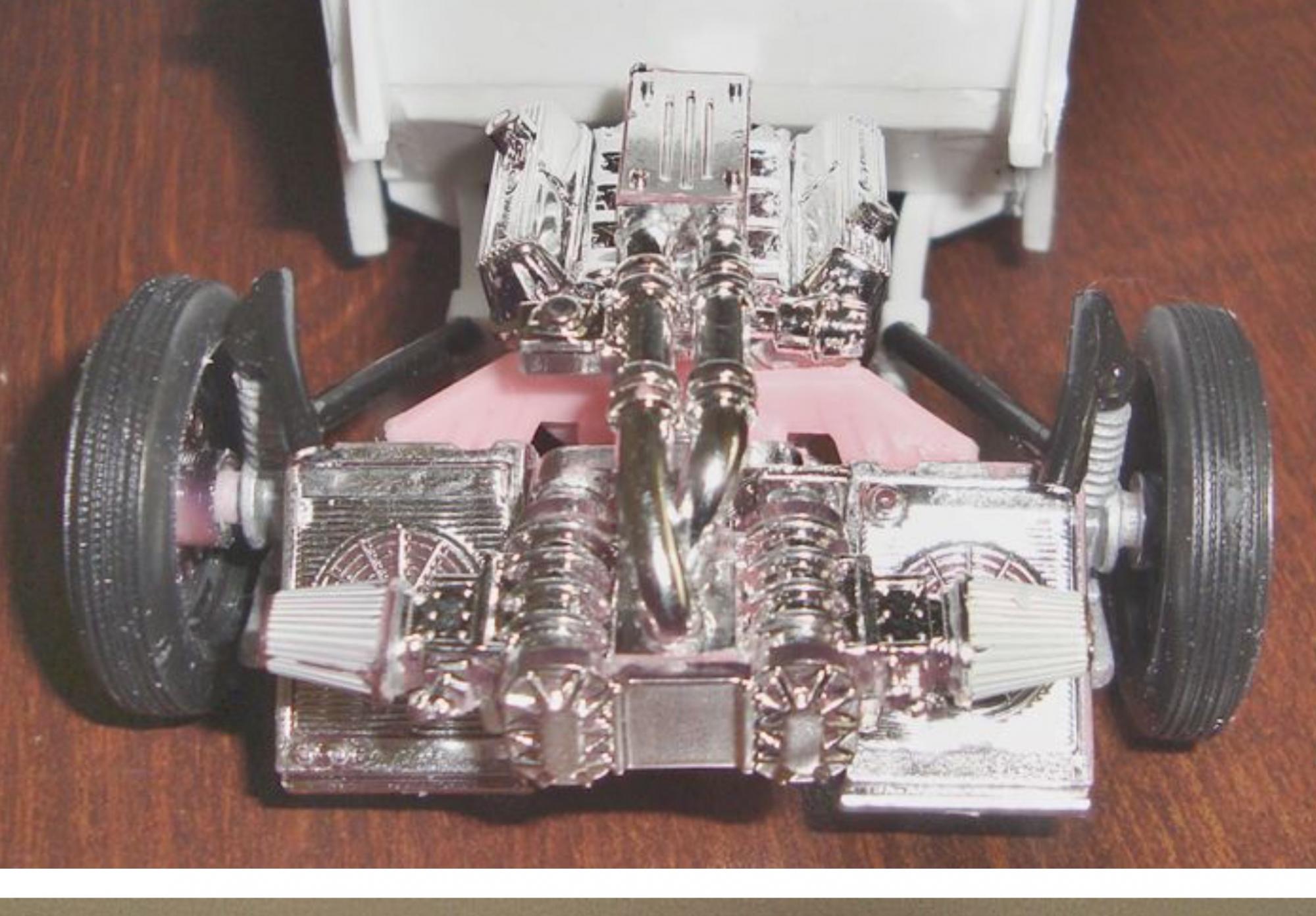

On the pic that shows the turbo setup, where did that come from? Nice way to mount a twin setup.
Share this post
Link to post
Thanks but I can't take credit. It is basically from the Matt and Debbie Hays pro street Thunder Bird. I changed it a bit, and those are a couple of small blowers, not turbos.
Share this post
Link to post

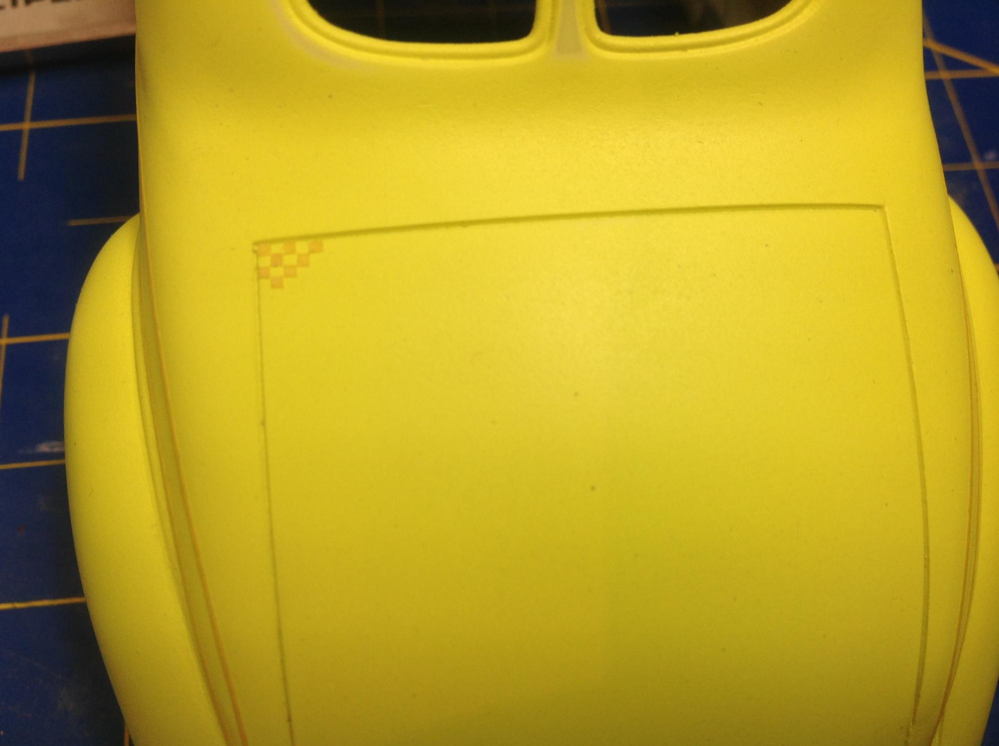

The first colour has been laid. Dollar store Neon yellow nail polish, thinned with Acetone.
Some more practice shots.
A little more consistent, should be much better with a straight needle, and the right thinning, and PSI, for now I have the MAC valve about half closed, and the comp at about 20PSI.
The difficult part is the paint will surge a bit once I clear the tip. I clear it off on the masking template then move the brush into position as I depress the trigger.
The new needle will allow a much smaller line, much closer to a pencile line, which is what I need.
There is definately a technique to this small shading, keeping the tip and needle clean seem to be key. I have found I have to wipe the needle and tip after every row.

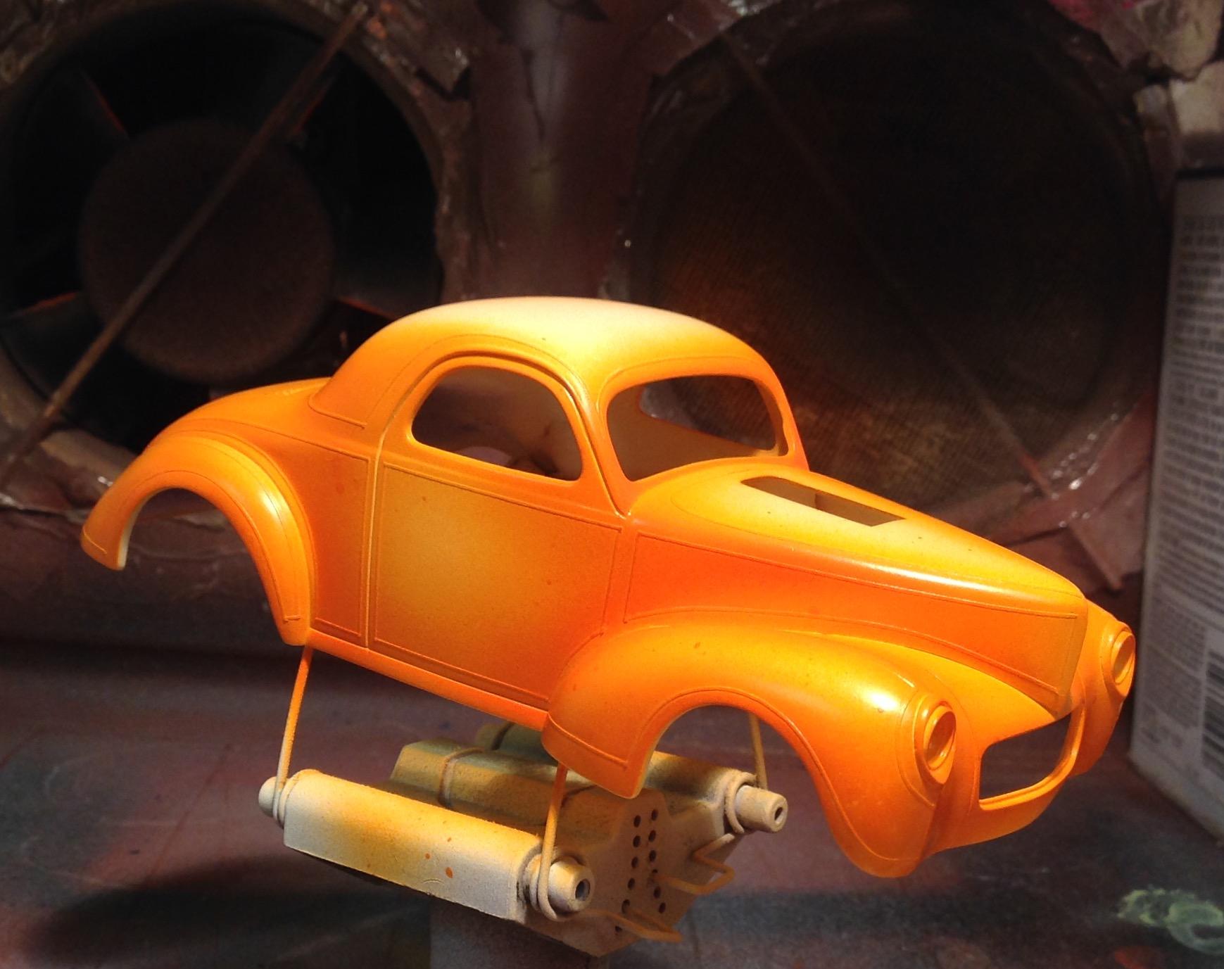

 First few coats of orange. I was going to go with florescent orange Zero paint but a test shot revealed it is crazy translucent and I don't want to put that many coats down. So I went with Jagermister orange Zero paint. This isn't a fade paint job, I am just laying the orange down all over outside the panels so as not to handcuff myself with future options if things happen to change. Thanks for following along.

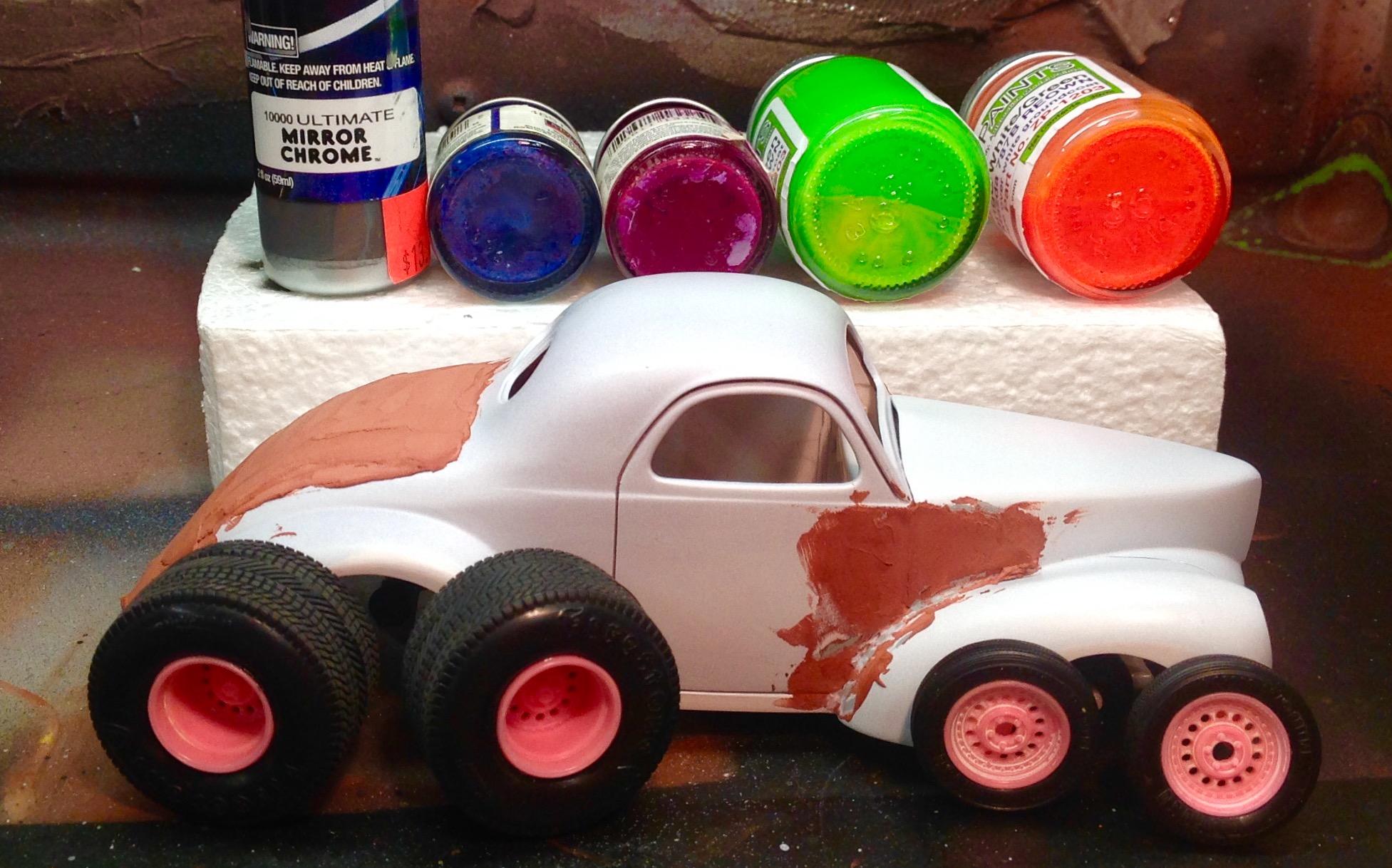

Rider, on your spoon tests, what is the blue that is 5th from the left side? I like that color for a Z-28 I want to do

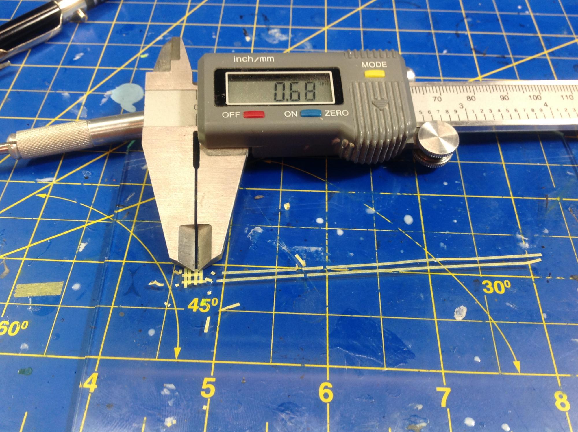

I fashioned myself a double bladed knife to make some more checkers out of Tamiya tape. Wanted to see if it might behave better then the AIZU micro tape I used previous.
It works the same, the tape will squirm around after it has been placed then positioned. The key it to place a corner exactly where it needs to be then press the rest of the "checker" onto the surface. Crazy hard to do.
The checkers I laid previous were .7mm, today's checkers I am laying on the A-pilar are .4mm. One day I will come up with a better method of cutting far more consistent looking "squares". These were cut using the double blade then I just eyeballed the "squares".
Currently working on the other A-pilar.
I also fashioned some .24mm pinstripping. Just taking it on a test run on a spoon, hoping to incorporate it into this somewhere too.

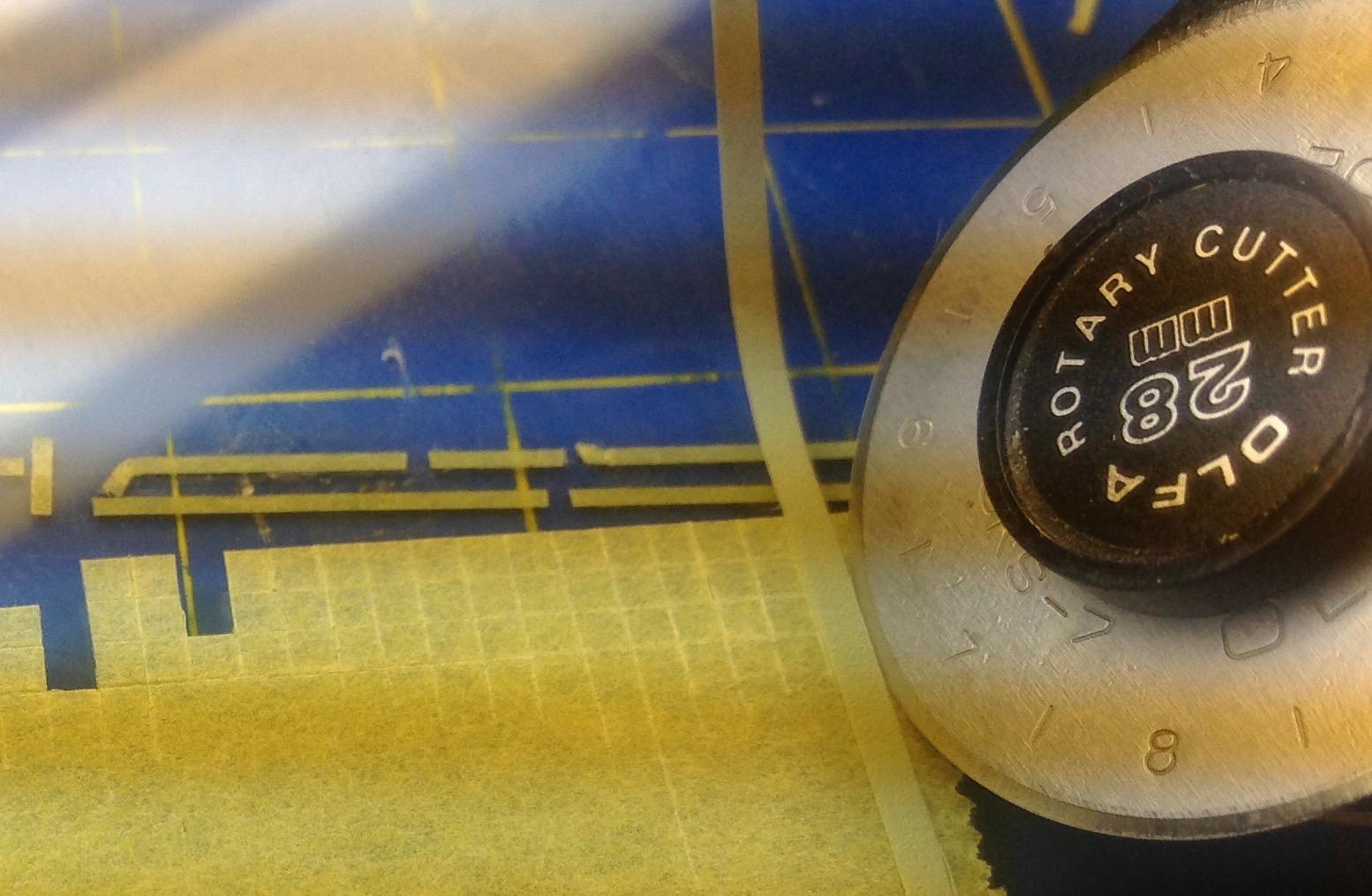

A-pilar roof junction checkers down, I wanted them t look like they are starting to come apart, unfortunately they look a little too ragged. This is the adhesive causing some of this, I can straighten them some what then they just squirm back. Working with them is kind of like bending spring metal, you have to bend it past the settling point. I am sure they will look fine in the end.
Been working on the front, trying different methods of cutting 1.5mm checkers. Finally settled on a method that works.
Share this post
Link to post
How I am cutting the checkers for the front end.
