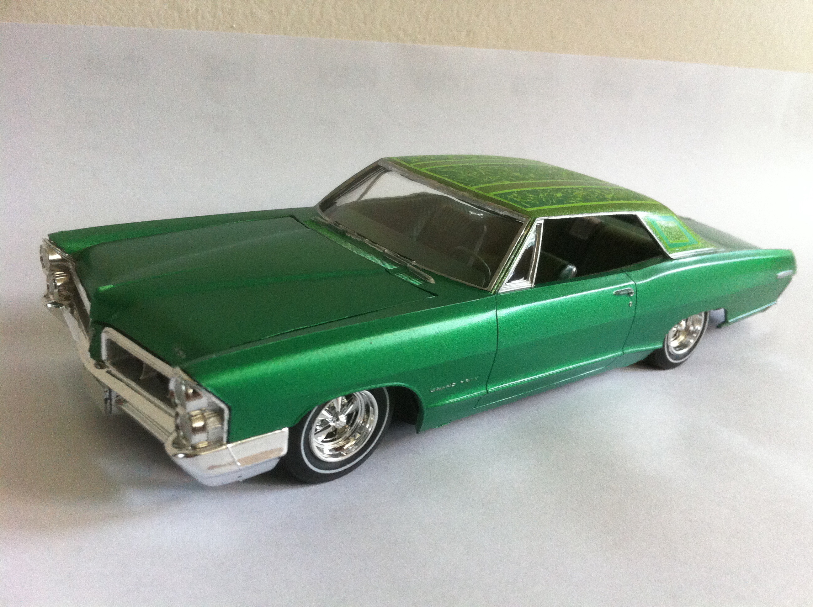

1970 cuda
Now that's a great color! Wht paint did you use?
And those wheels, are they Smoothster wheels?
Nice car!!!

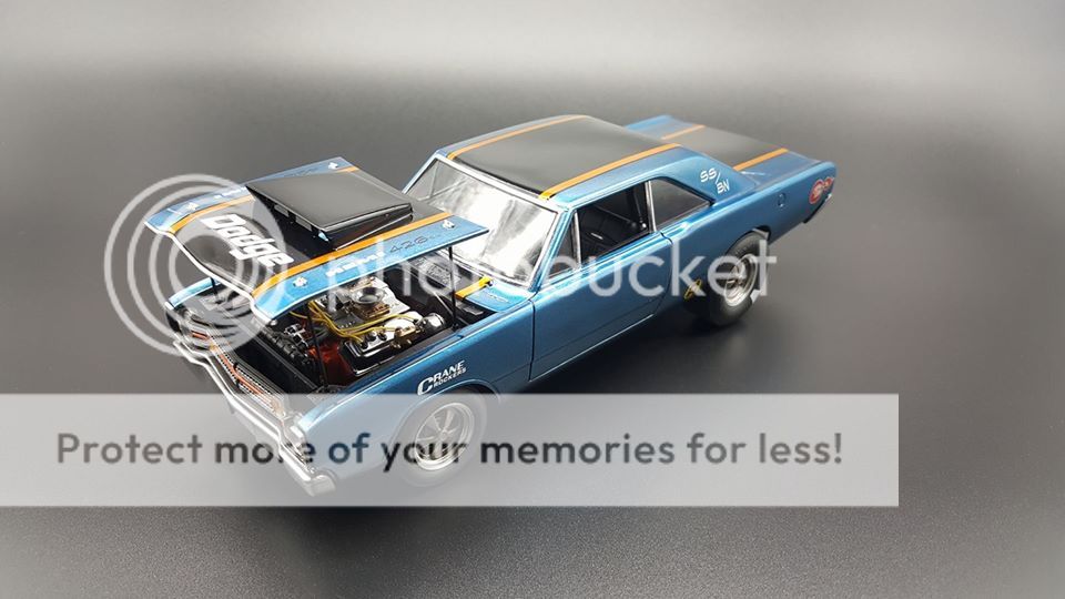

Brewster Green.
Madeira Maroon.

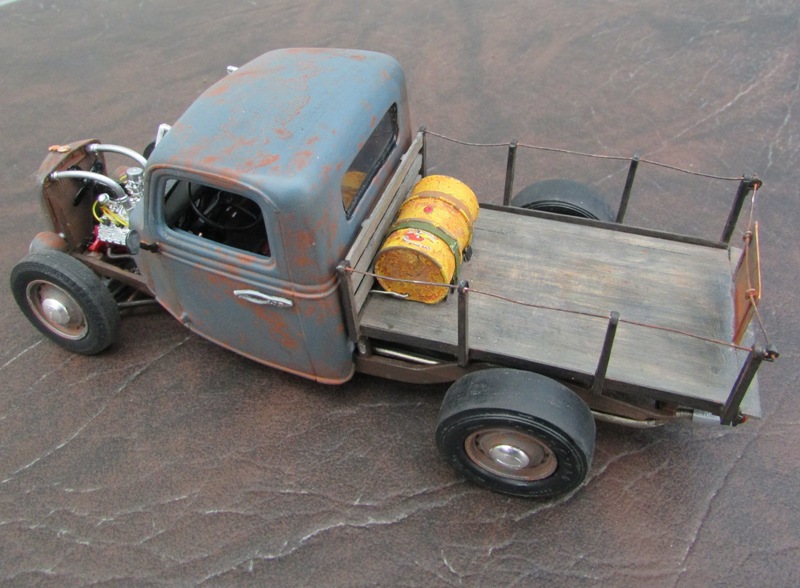

My 1937 Ford Rat  rod, my first try with weathered model! I use the salt method!

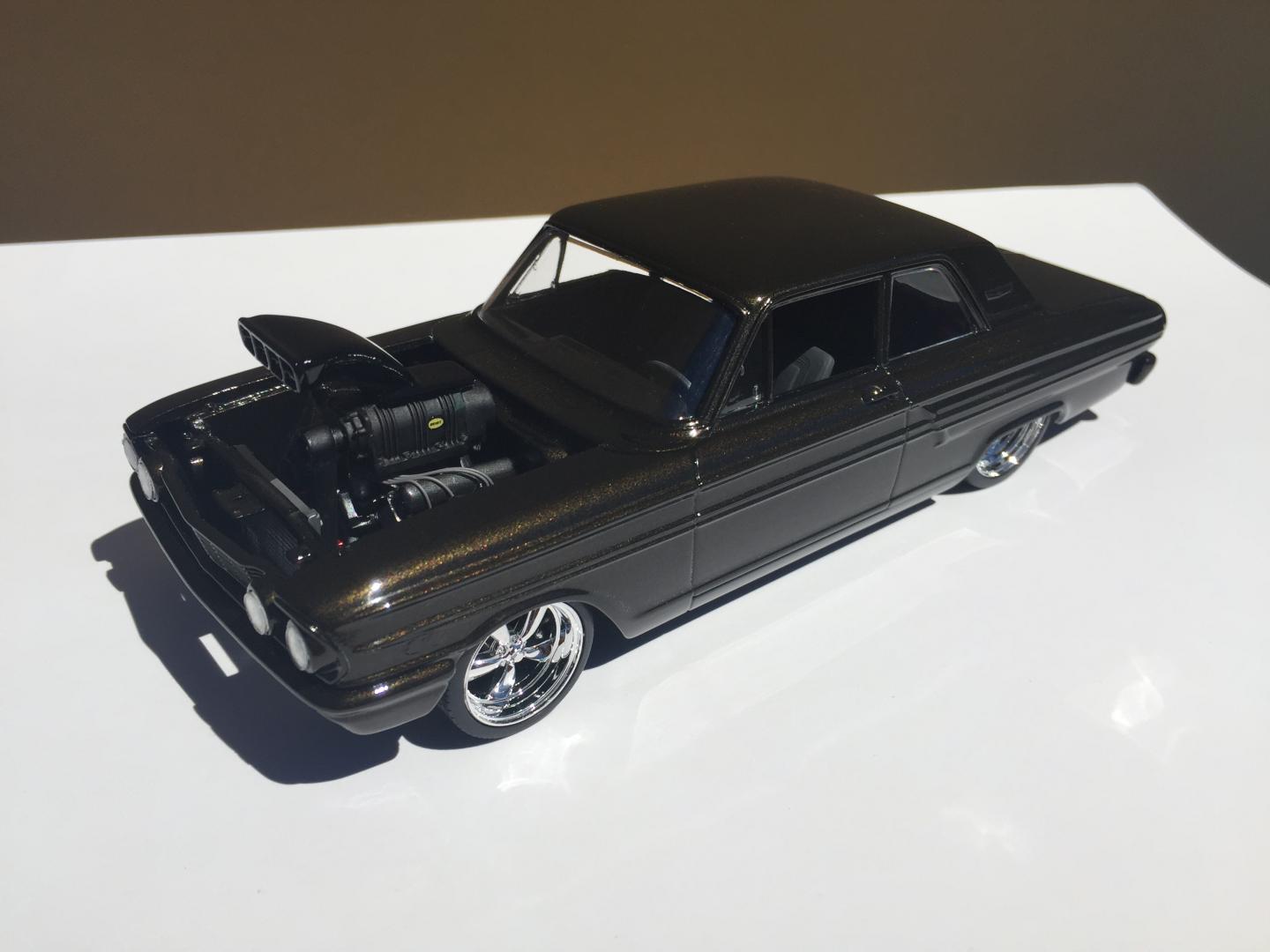

Well Black is a challenge at the best of times, but I think I got these two right :)
very nice black beauties

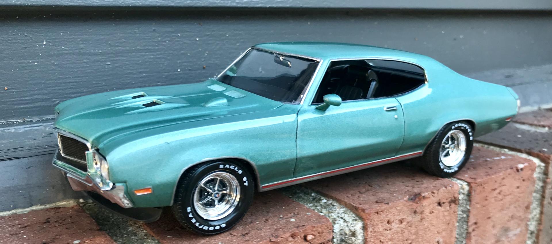

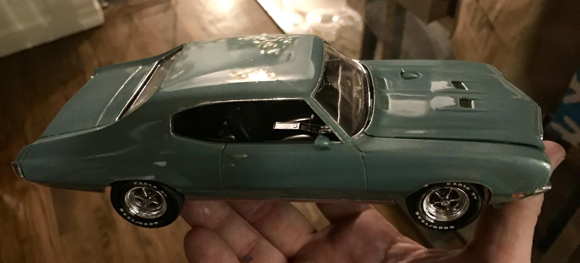

OK, I’ve already submitted a couple, but this needed to be included in this thread.  My 70 Buick GS Stage 1.  This was unique for me as the color I wanted was an enamel, which I generally avoid. I don’t have an airbrush, so I’m using rattle can
But, I laid two coats on, let them dry for two weeks, and compound was all I needed to get the finish smooth and set for clear.  Three coats of Mr Hobby clear and somebwax... pretty happy!!

Awesome, what color is that?
Share this post
Link to post
It’s Testors Model Master 2945 Turquoise Metallic.

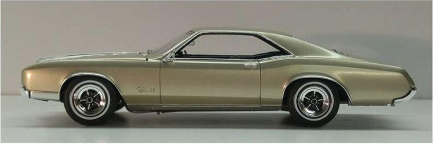

I don't think I've posted any of mine yet, so here are a few of my best attempts.
