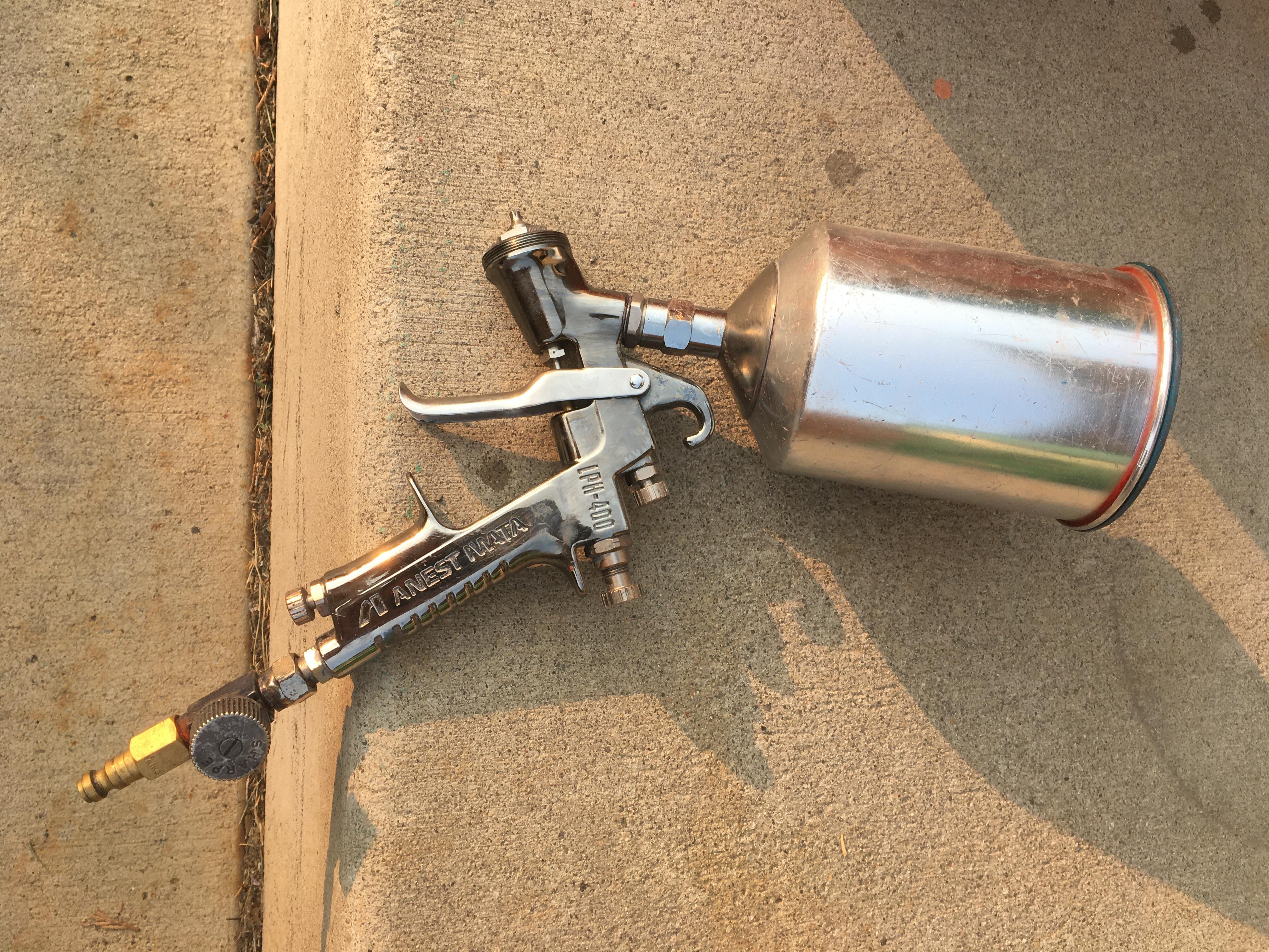

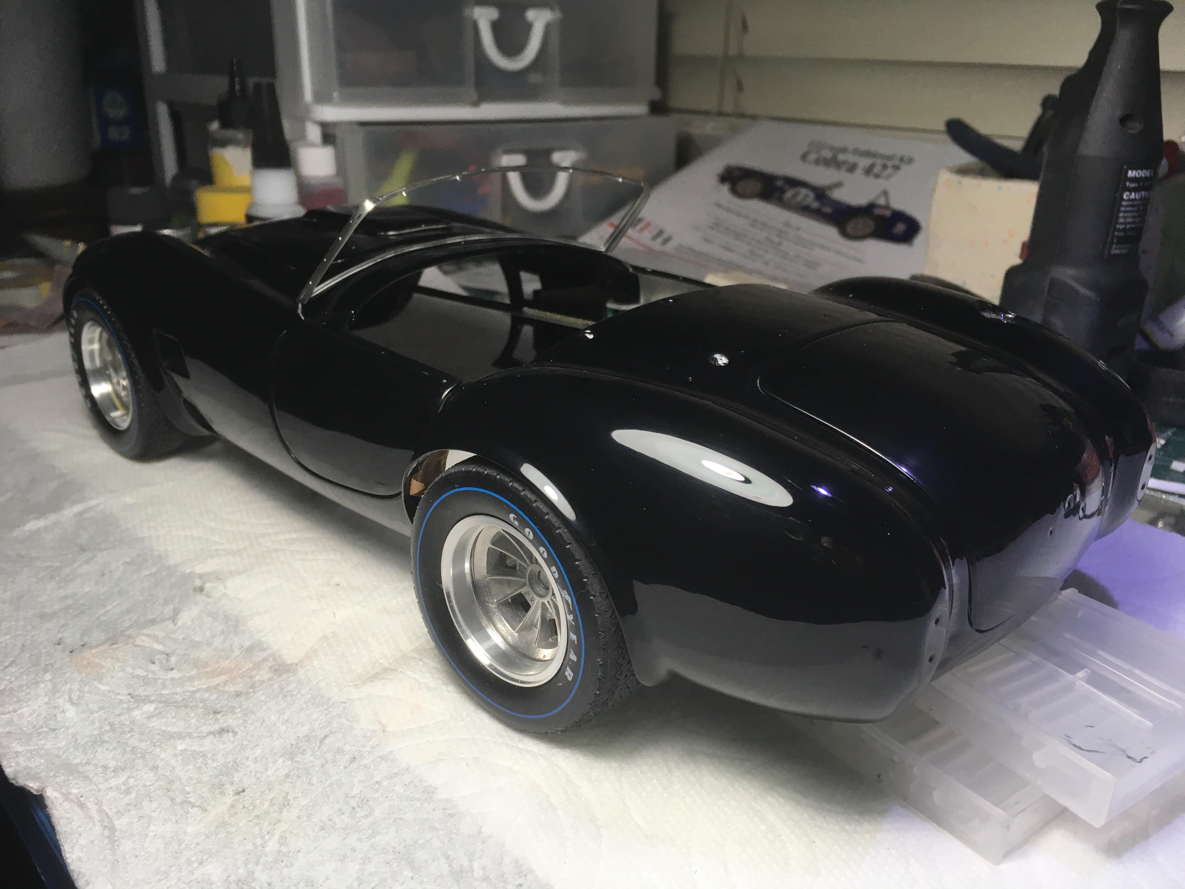

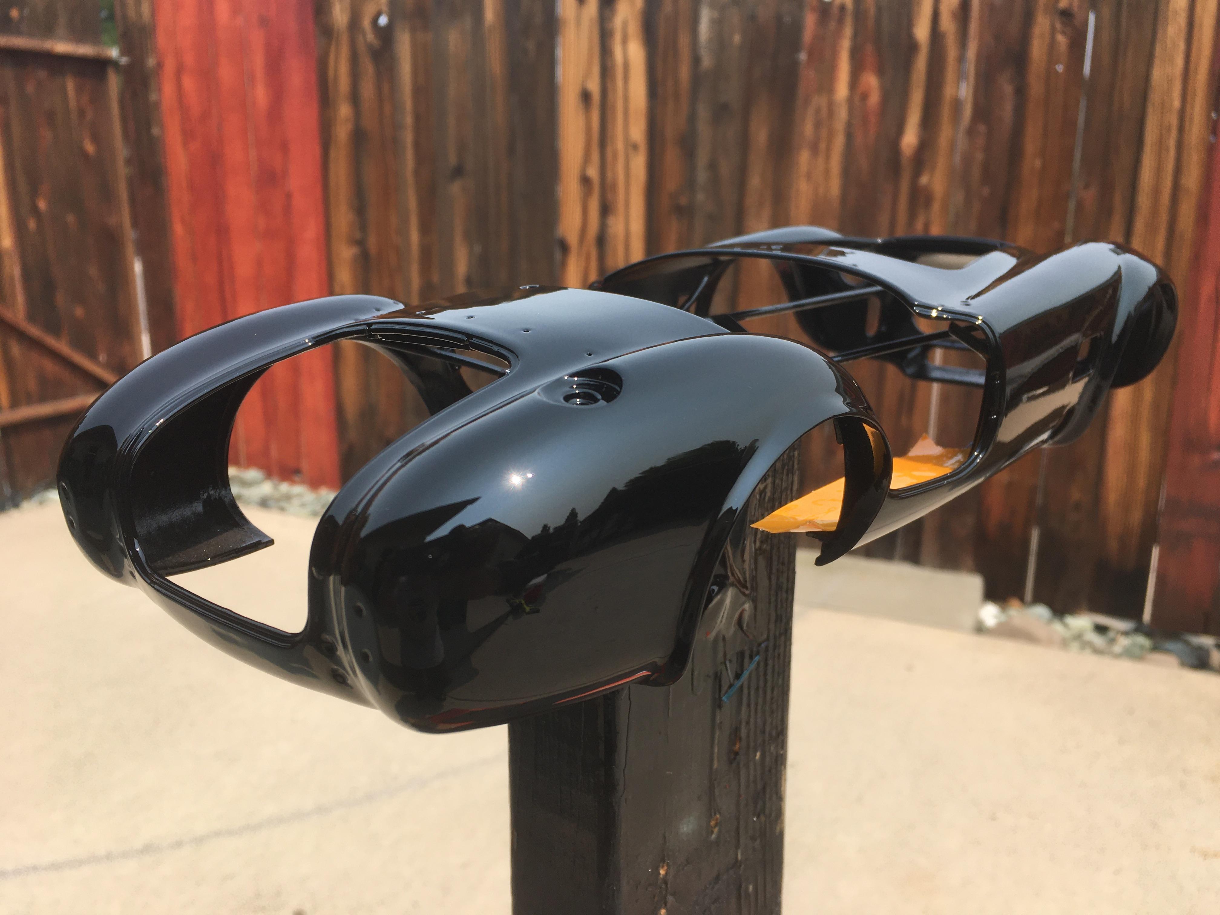

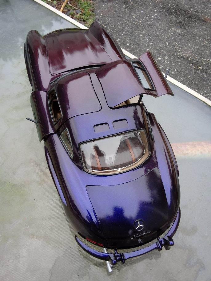

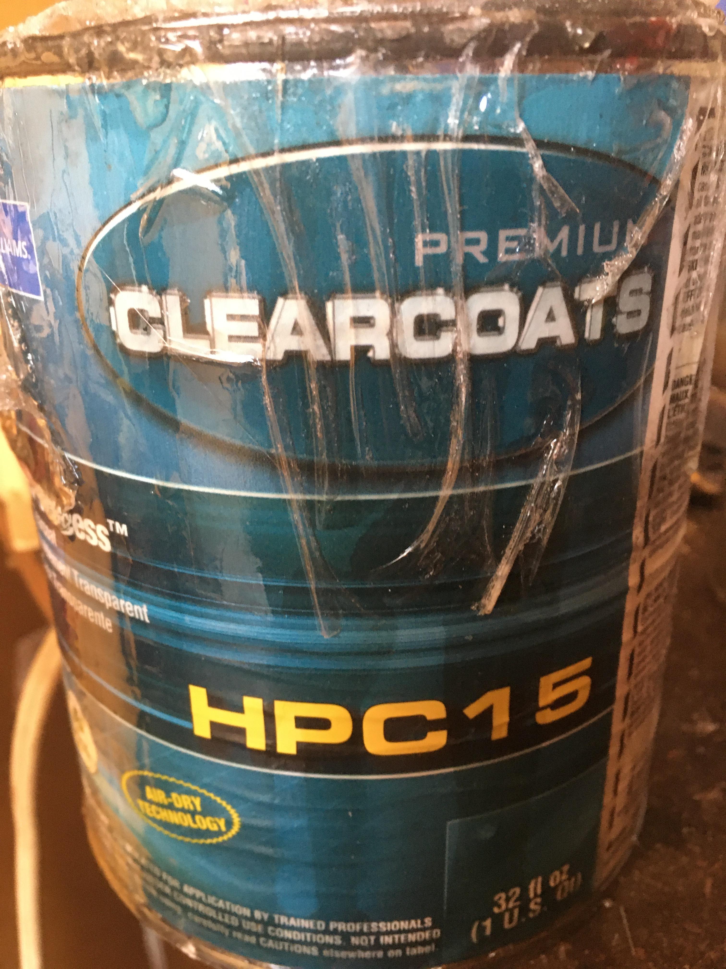

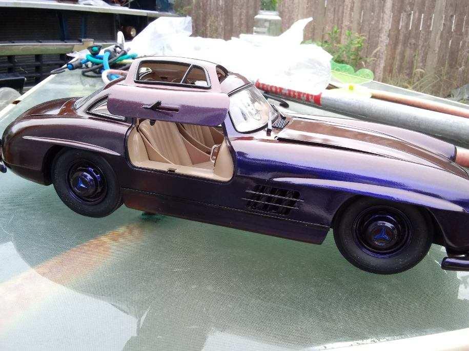

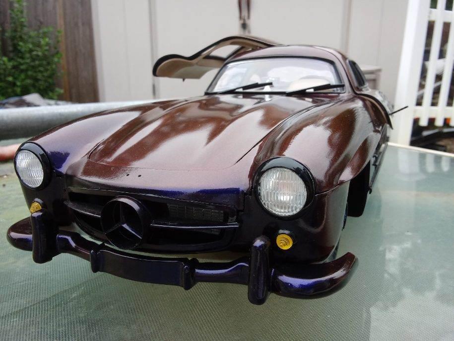

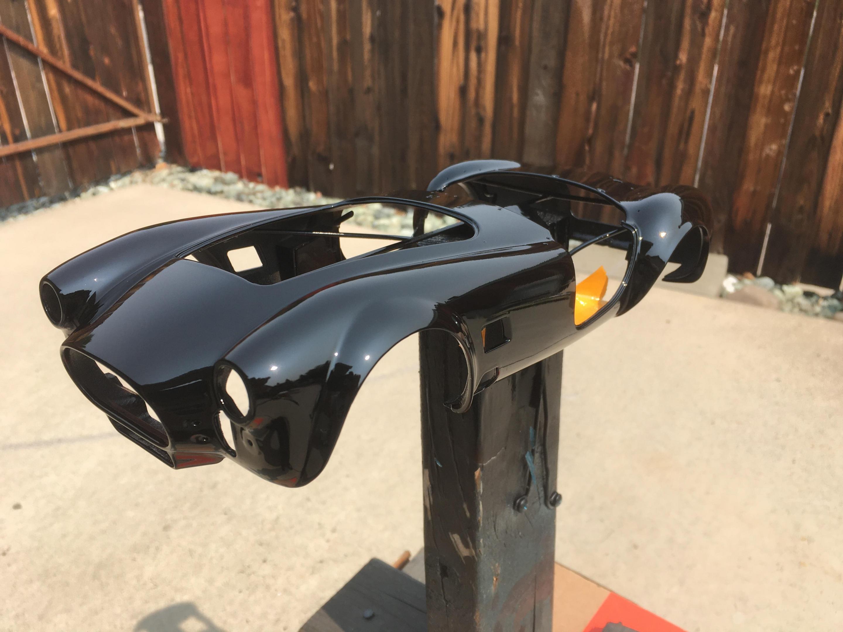

Thank you guys. All of you guys are world class builders. Me , not so much. Here is the base coat paint I used. And the spray gun I use. The clear I use is sherwin Williams HPC 15. You need hardner  and reducer also. The clear is like water when mixed so it goes onto models in scale. All 2k clears are not created equal. House of color is very thick , so not so good for models. The bad part on the sherwin Williams HPC 15 is it is going out. It’s a older product. So I will find another soon. PPG has some good clears I will try out. The base is bmw color systems base. Water based so it is a little harder to work with. BMW changes out their paints every 2 years. So the old stuff goes into the recycler. ( thrown out). So I take them home for my models. Saves them hundreds of dollars for disposal fees and I get free paint. The spray gun I use is a iwata lph 400. Full size spray gun. Has  great adjustments for fine refinishing. Hope this helps. Here are some pics. Thank you guys
Link to comment
