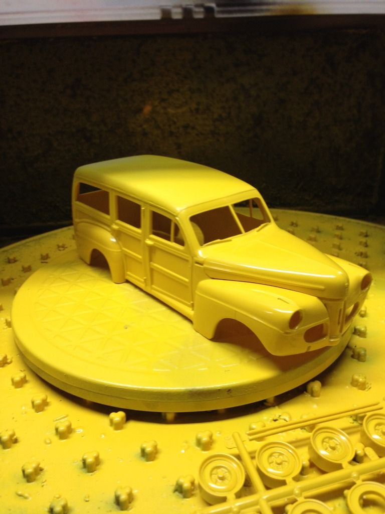

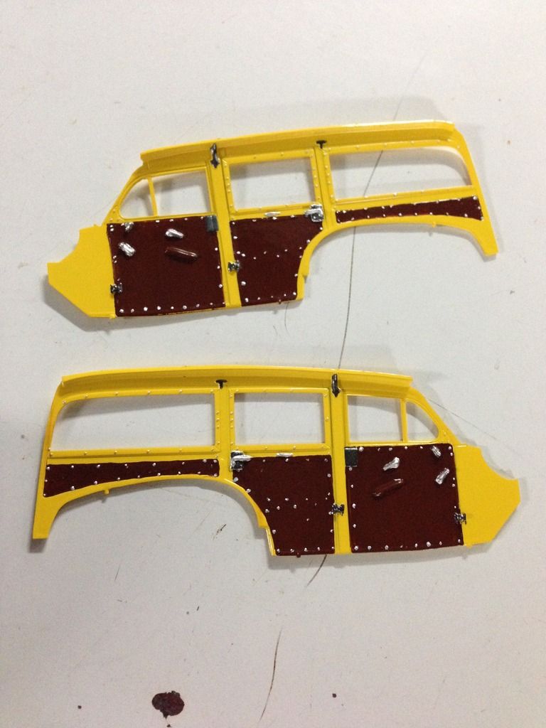

Here's the "progress":
The color is brighter than what I was expecting, but I can work with that.  The inspiration is a Hot Wheels '40 Ford Woody that I had as a kid.  I no longer own it, so I will be workign from memory lol.

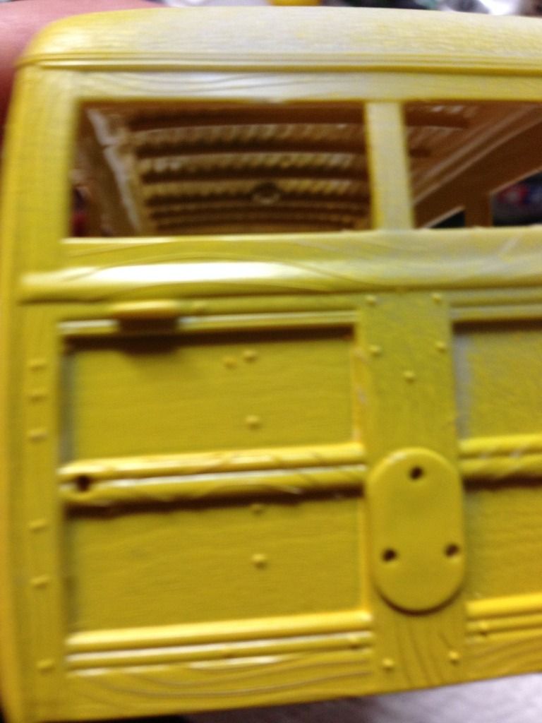

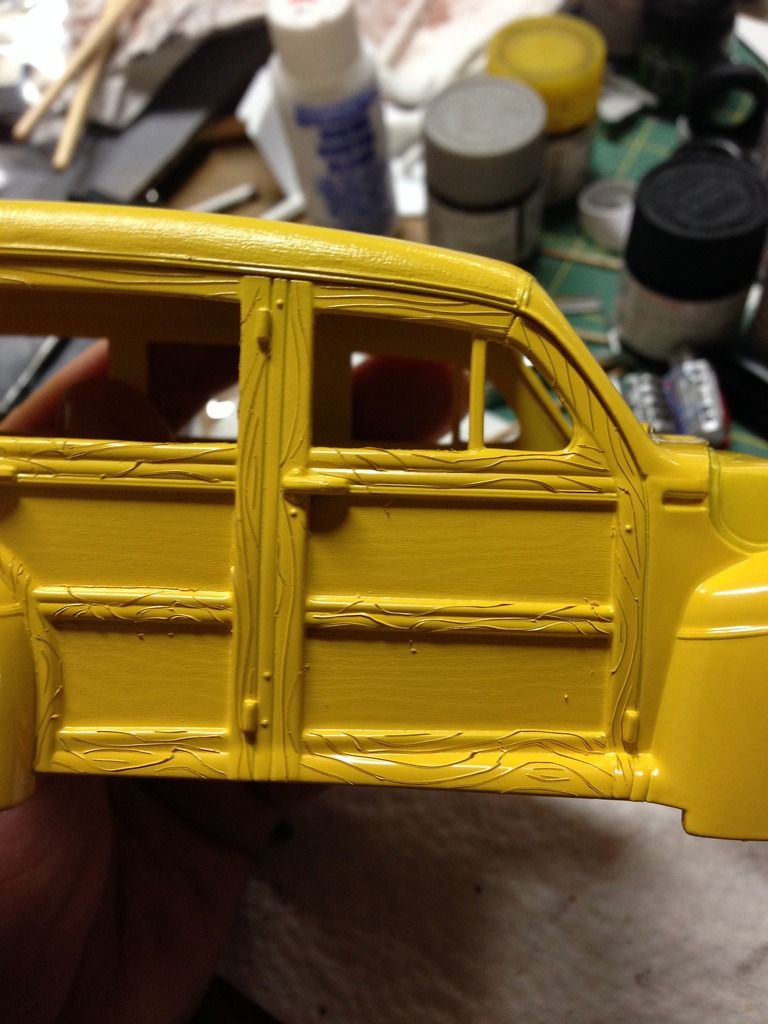

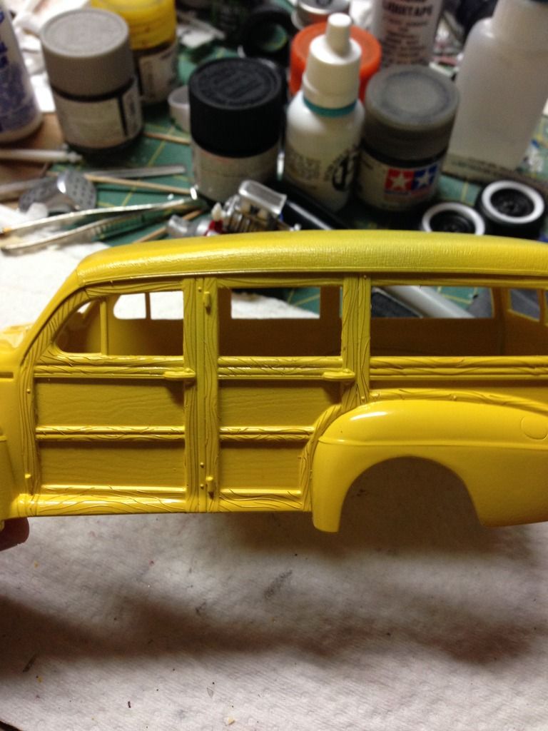

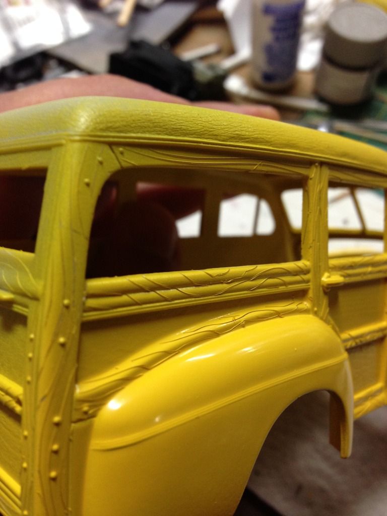

Now its time to focus on some wood.  My biggest complaint so far on this kit is the lack of wood grain molded onto the Woody body.  I suppose thats fine if you're using decals, but that's not what we're doing here.
So the first step is to take out the knife and cut some curves and swirls:
Looking better:
 photo image_zps8izmi4b2.jpeg photo image_zpsaiwme3sl.jpeg photo image_zpspaeckqeu.jpeg photo image_zpsblffgkqq.jpeg

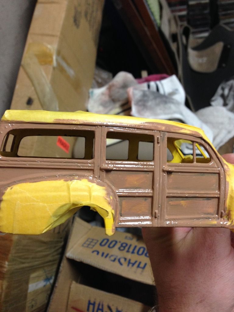

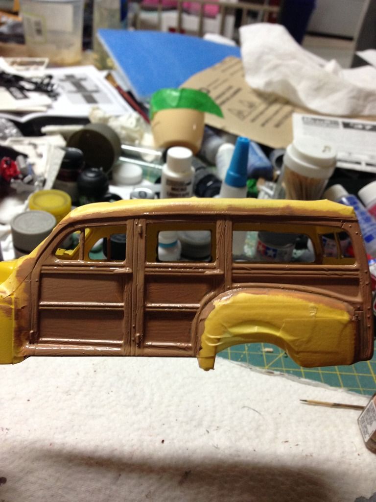

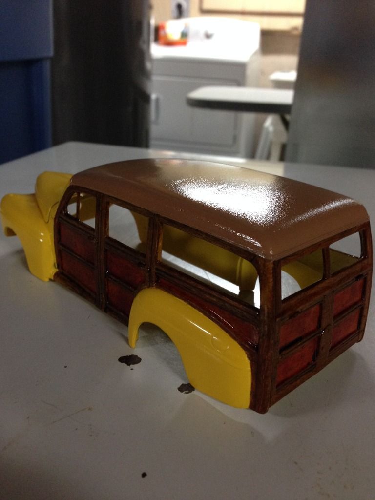

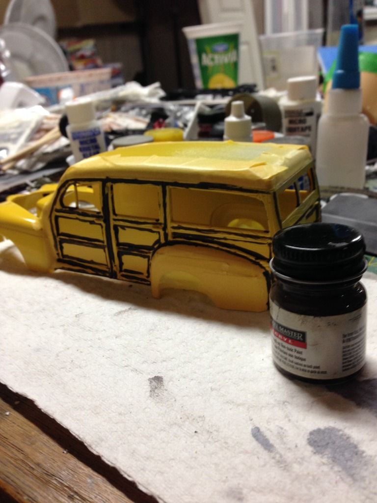

Next is the shading.  For this I used Raw Umber.  If you are skilled with an air brush, this would be a great time to flex your skills.  Since I don't own a workign air brush - I did mine the old fashion way.

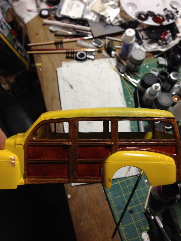

Now its time for dry brushing - this is the whole reason why I "cut" the wood grain into the plastic
 photo image_zpsapqdn0li.jpeg photo image_zpsl8wwlimw.jpeg photo image_zpscj67ooqv.jpeg

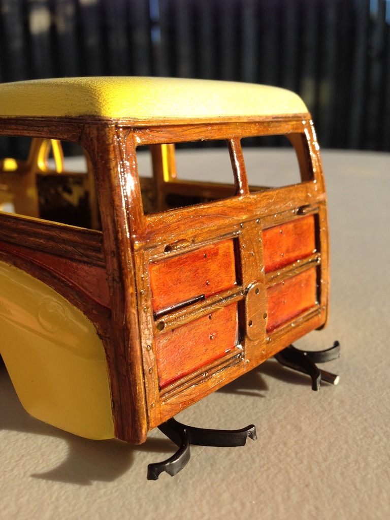

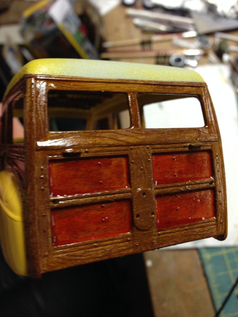

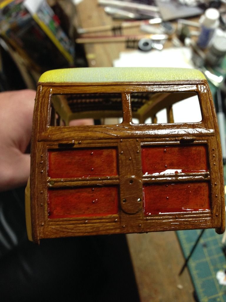

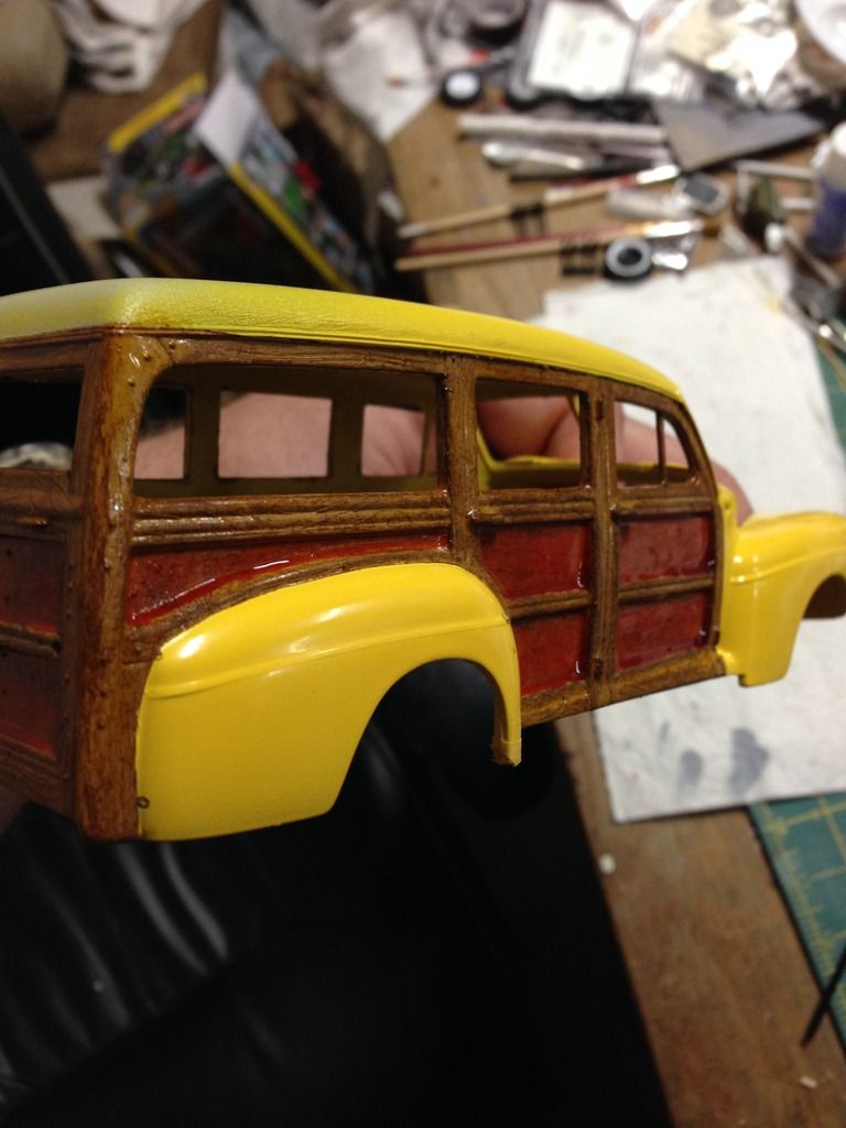

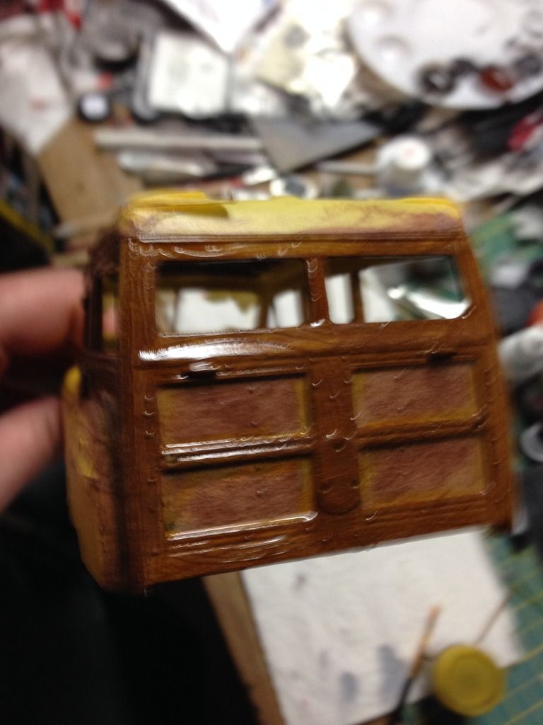

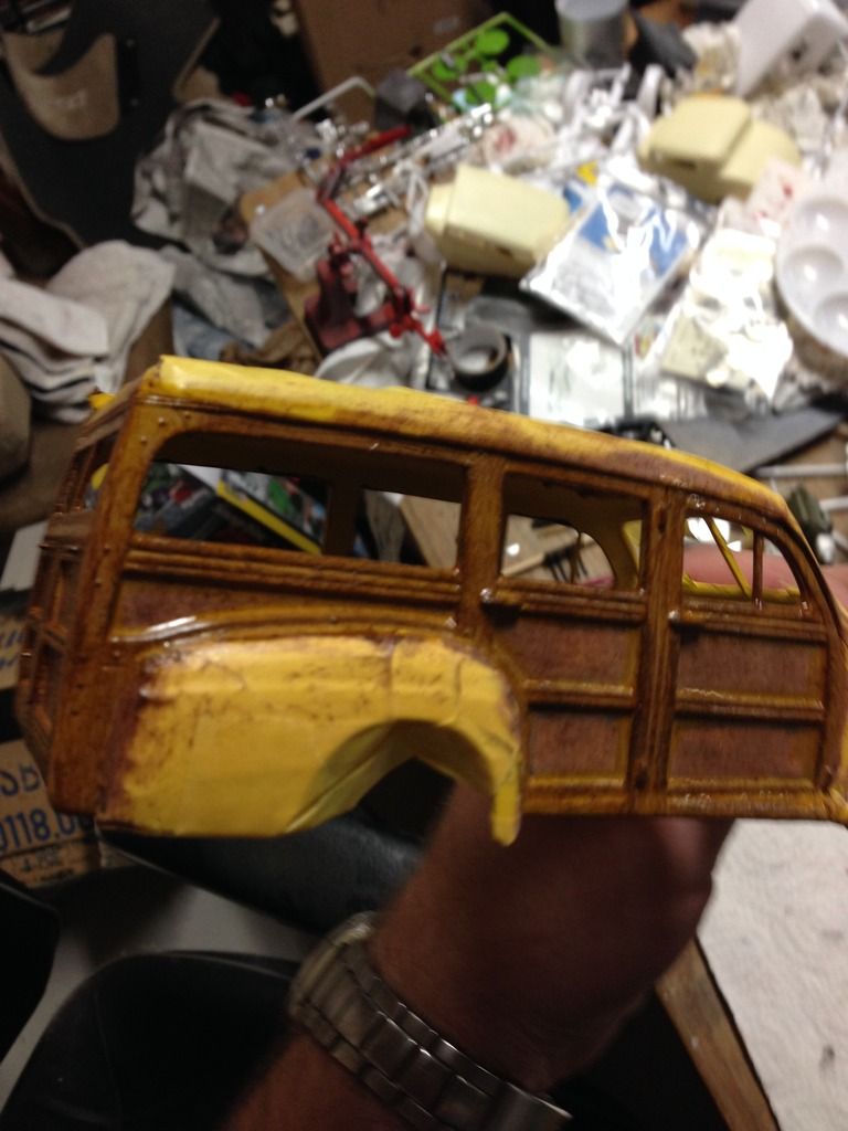

Almost done - this is my favorite step as this is were the results start to happen.
Applying the Tamiya clear (yellow or orange depending on the look) makes all the difference.
 photo image_zpspfkj5lzi.jpeg photo image_zpsvclt8d4l.jpeg photo image_zps6umxcvwz.jpeg photo image_zpsh5d5qscw.jpeg photo image_zpszcqrxqlv.jpeg
Still a little more work to be done, but I'm pretty satisfied with the results so far.
Share this post
Link to post
Can we assume there will be some wiping way of excess paint soon?
There is a little clean up to be done on the body, but the masking tape took care the majority of the mess.
I don't feel like I used "excessive" amounts of paint for the wood portion, but I did watch some tutorials on YouTube that would lead you to beleive otherwise.

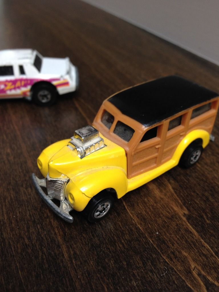

I dropped the kids off of at Grandma's house over the weekend and look what I found - the missing Hot Wheels Woody!
My little guy is only 2yrs old, but he loves it!

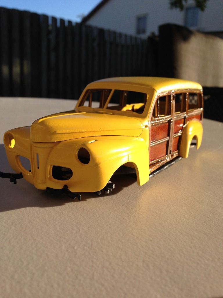

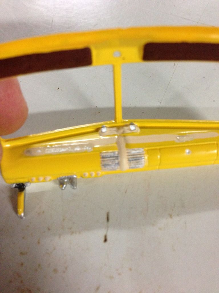

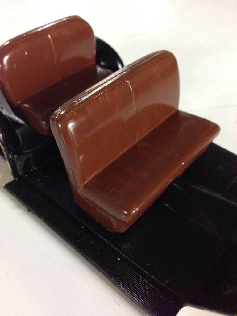

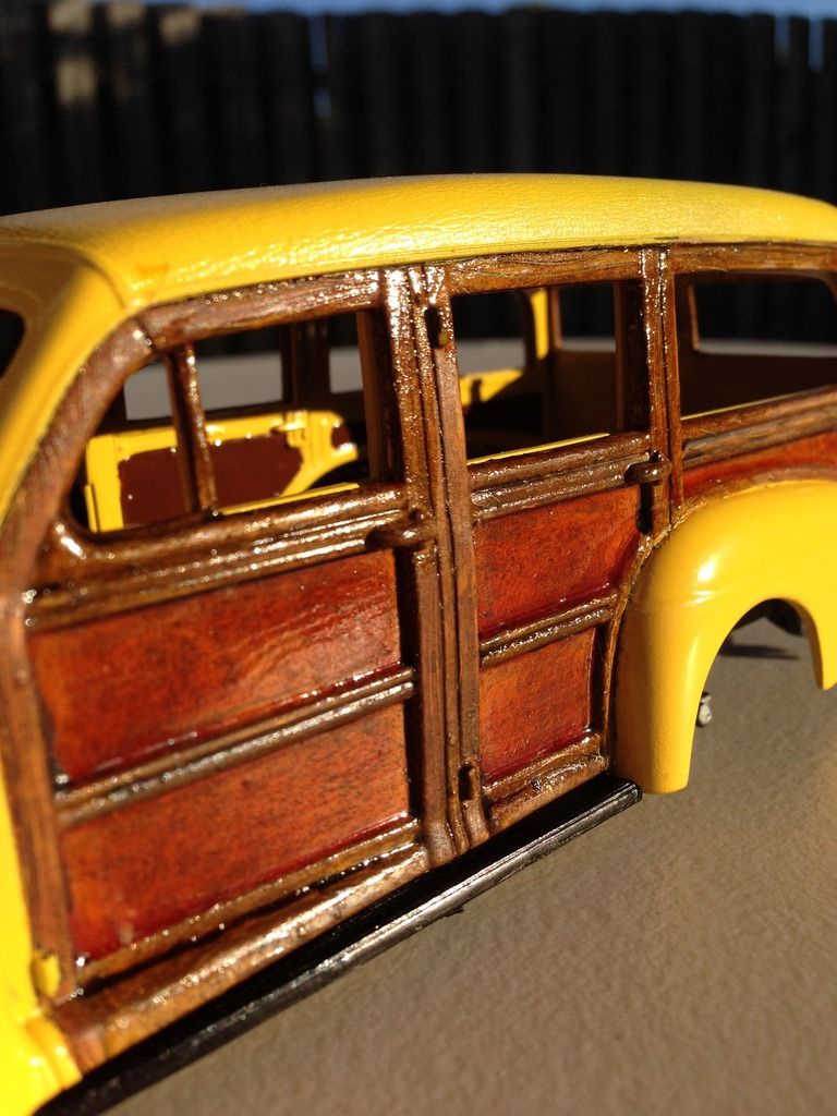

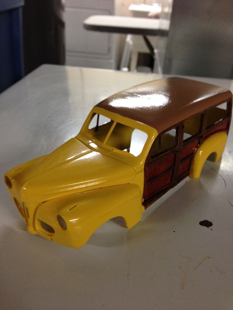

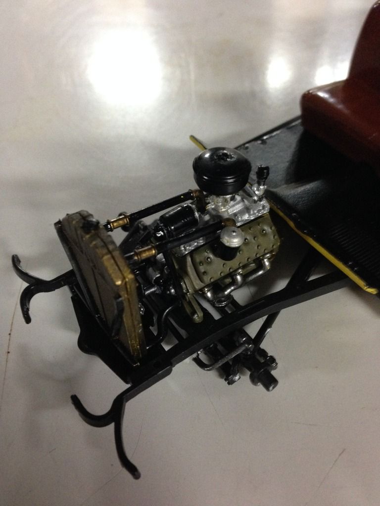

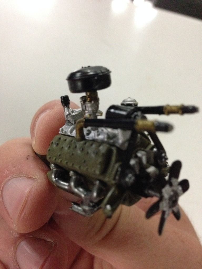

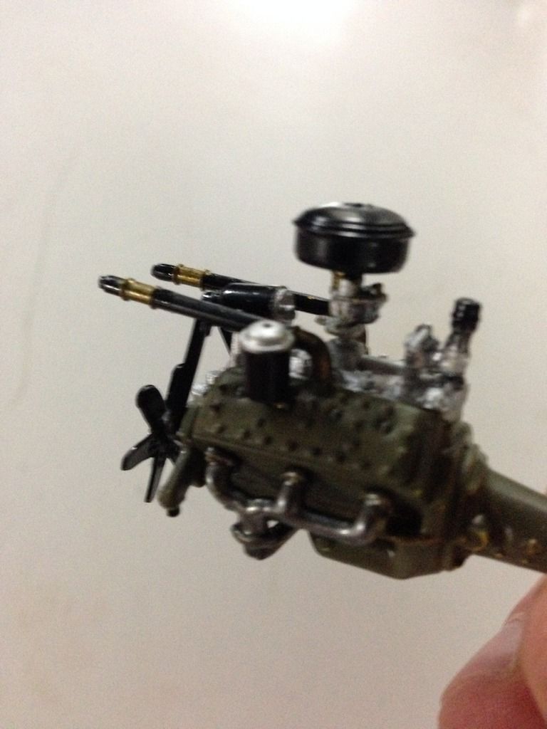

Started work on the Woody again.
Progress on the chassis, engine, and interior.  Wasn't satisfied with the paint, so I gave it a couple more coats of paint.
The sunset last evening was perfect for pics, so I snapped a couple of the car.  Pics are after paint, prior to polishing.  Lots of work to be done still, as with some minor touch ups.
 photo image_zps24bmqm6f.jpeg photo image_zpsmuruiudc.jpeg photo image_zpsi674w8av.jpeg photo image_zpsky1qzdij.jpeg photo image_zpsgu0qa7qh.jpeg photo image_zpswvdcl0vr.jpeg
