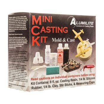

Bullitt Posted June 7, 2016 Share Posted June 7, 2016 I have been thinking o casting some parts from kits to use on future projects, wheels, carburators etc. and am wondering how hard it is to get started, I saw this small kit at Hobby Lobby, and was wondering if it would work as a start up to get going. Quote Link to comment Share on other sites More sharing options...

oldcarfan Posted June 11, 2016 Share Posted June 11, 2016 This Hobby Lobby kit is pretty good to practice with. Be sure and use the 40% coupon though to save money. I bought one a while back to make a copy of a wheel that I only had three of. The only thing about it is that the RTV was very hard, so it wasn't very forgiving when taking out the molded parts. Use plenty of mold release and try not to have any big undercuts... Quote Link to comment Share on other sites More sharing options...
Greg Wann Posted June 11, 2016 Share Posted June 11, 2016 Yes, undercuts can be a problem. Yes, plenty of mold release but don't get it so thick that it actually covers detail in finely detailed parts. Quote Link to comment Share on other sites More sharing options...

davysmodels Posted June 22, 2016 Share Posted June 22, 2016 I have also used the Alumilite starter kit and agree with OLDCARFAN, the rtv rubber molds cure too hard and makes removing the parts difficult.Now using the Smooth-On starter kits. The blue RTV rubber molds are flexible and strong. Review the Smooth-On web site as they offer different strengths of RTV rubber.The S-O starter kit is excellent and includes a HUGE instruction booklet and DVD video.https://www.smooth-on.com/products/pourable-silicone-starter-kit/https://www.smooth-on.com/distributor-regions/canada/ Quote Link to comment Share on other sites More sharing options...
