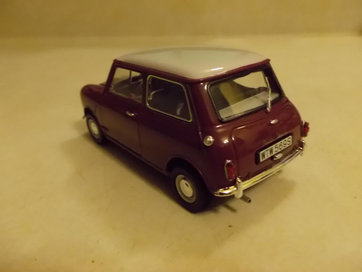

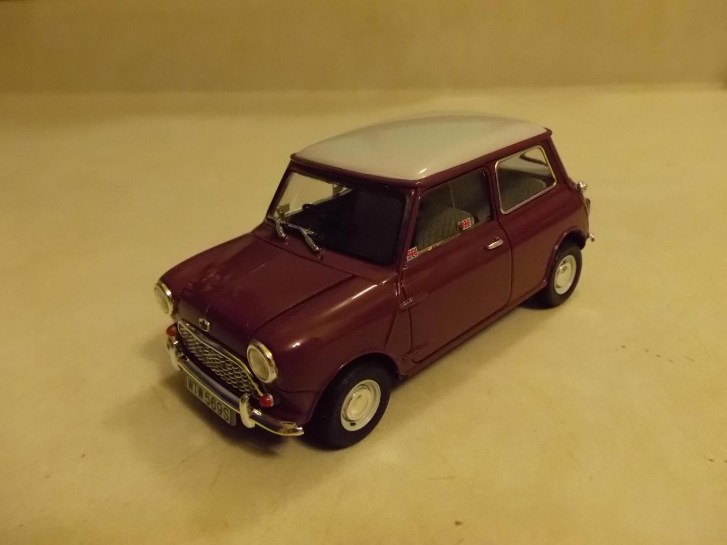

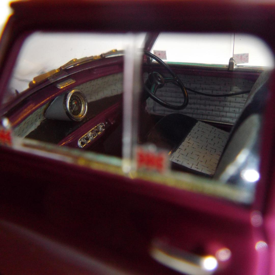

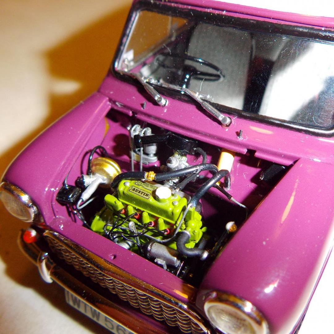

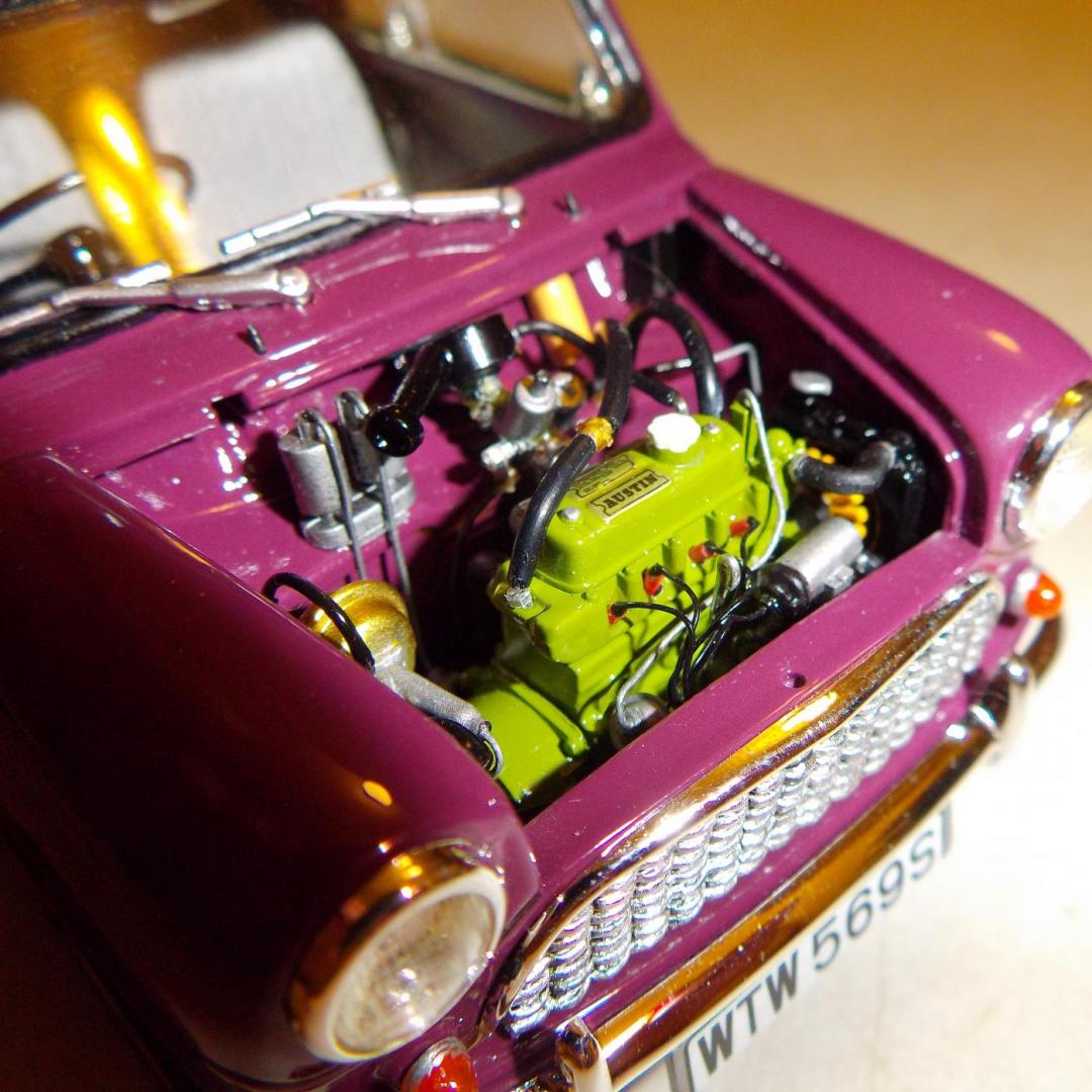

Retrograde of Tamiya's Mini Cooper.  Motor wired and plumbed, intake manifold converted to single carb setup.  Interior:  the instrument cluster
was converted from multi-gauge to single gauge.  Scale Motorsports used to provide a fabric decal that approximated the Austin fabric pattern.
Colors are stock, mixed lacquer with a two-part urethane clear coat.

Wow great detail under the hood and the interior is spot on.If I may ask, how did you get the seat and the door panels to look like that?

 I always wondered how air enters  to the front of the radiators on these cars.  Is there a duct or something to redirect the air?

The cooling fan sucks air from under the front air deflector and blows it across the radiator. Not the most efficient system since the air is already hot, but they did this to keep the car short and for the fan to remain on the accessory drive belt.

The inner fender that the radiator mounts to has louvred punched into it to allow air to be drawn through by the engine driven fan.
On a seperate note, those license plates would indicate the car was registered 1978 in the UK. The front plate is correct, black digits on white, while the rear should be black on yellow. Our pre mid '70 s plates were white or silver on black.

Great build and detailing. Nice to see the drip rail on the roof being body colour. Most modelers don't do that.

The license plates come from Hannu Mikkola's 1979 Ford Escort Mk II RAC rally winner (Revell, former ESCI kit).

There is a special fan for hot weather climates which moves more air than the standard (U.K.) fan.  I had one on my Mini for a while here in Washington state, it ended up cooling things down too much in the early spring and late fall months, so they work.

Very nice Mk I Mini, I've seen that color or colour combination on a Mk I Mini at British car shows.  Most of the Mk I mainline Mini's I've seen are either the light blue and Old English White top or light green and O.E. White top, the other red ones I've seen were the darker red single color paint scheme.  Nice job on the dash looks like the Mk I center binical Mini's I've seen a time or two even has the correct speedometer only, Cooper and Cooper S had the three gauge binical plus the twin carbs which you addressed on yours.  Looks like you either did your research or had a nice example of the real thing to refer to.  Nice job!

Very nice work.
However, just one point. The rear window wiper was never available on that model of Mini. It would have to have been an aftermarket item.
