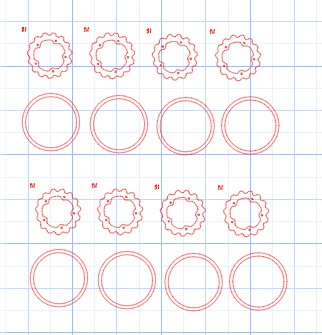

Then laid a few out in the cutter's software so I can cut them from super thin styrene sheet.  The cutter doesnt like to cut anything too thick, but I had some really thin sheet here that will run through it with no problems

To give you a better ideal - this is a screenshot of the software. The grid represents the piece of material (with the grid markings on there to help work out where exactly on the material you want it to cut) and the red lines are where the machine should cut.  Anywhere that there's a red line, the machine's blade will lower and cut through the sheet.
