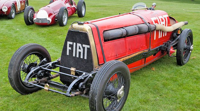

In 1969 the car was bought from Eldridge's heirs by Fiat, when it underwent an extensive restoration and was repainted red (it had originally been painted black). It is now part of Fiat's historic collection in Turin, Italy. Here is the restored car as it exists today...

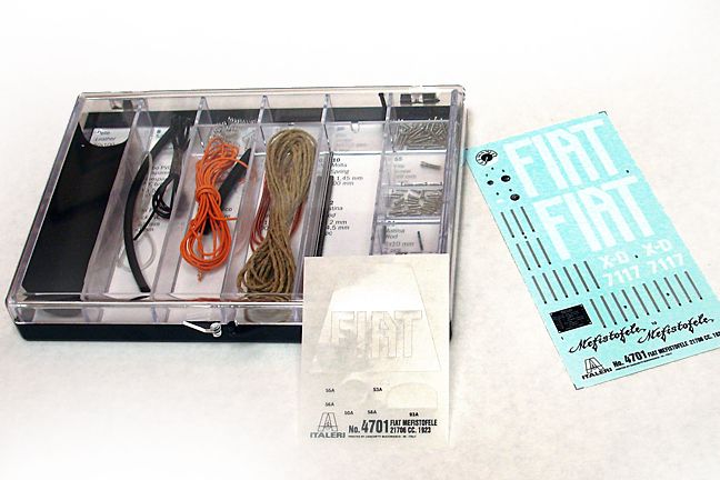

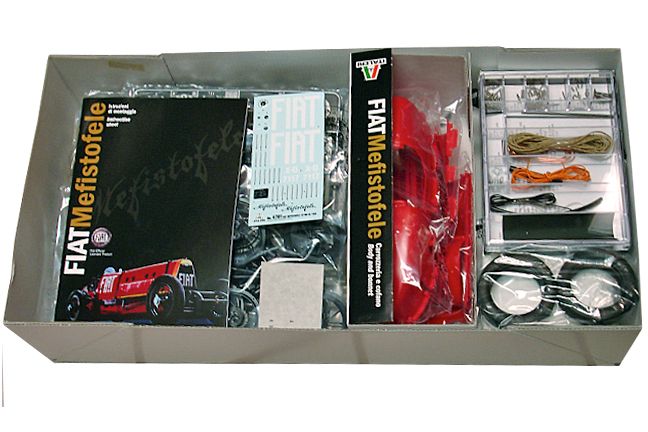

The kit is nicely packaged...
and includes a plastic box full of tiny screws and miscellaneous hardware, wiring, tubing,etc., a clear plastic stencil so you can spray the "FIAT" logo on the radiator, and of course a decal sheet...

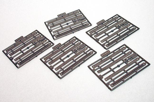

You have to build the drive chains link by link, just like a real chain...
Share this post
Link to post
That car looks huge ! The chain links would stop me dead in my tracks !  : )

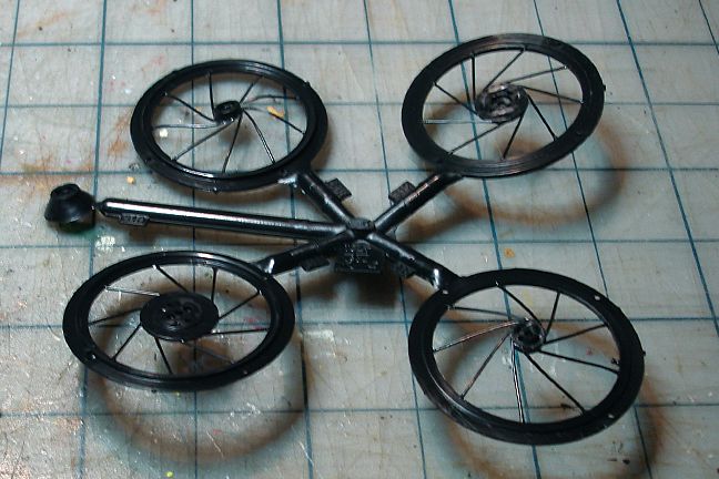

I'm in.  Good luck with those chains.  How do the wire wheels look?
Share this post
Link to post

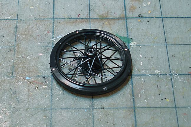

Pretty good. The spokes are pretty close to scale thickness, and there is no flash. Each wheel builds up from four separate layers.
The four layers are connected around the rim by screws...

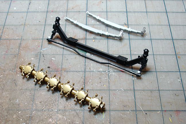

Well, today the sciatica took a day off, thank God... so I was able to put some time in on this. First thing I always do is glue together any parts or subassemblies that will be painted the same color...
For some reason they molded the springs in light gray, but the shackles in black! Also, the tie rod is supposed to be attached using the "heat the pin sticking out and press it down to flatten it" method, but I don't like doing it that way, so I made "nuts" out of hex-shaped styrene rod (that's why the tie rod nuts are white... they aren't from the kit.

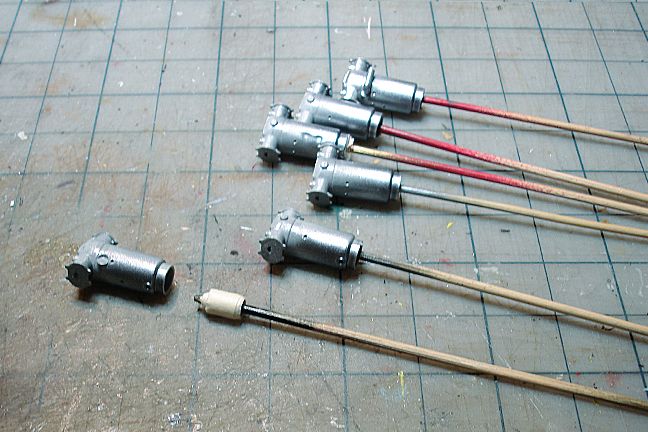

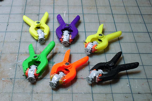

Sometimes you have to come up with a clever way of attaching the handle to the part you want to paint. In this case, I wrapped strips of masking tape around the ends of some shish kabob skewers until the tape was just the right diameter to slip into the cylinders.
The reason there's metallic paint sprayed on the bottoms of the cylinders is because I temporarily press fitted them onto the block, so that I could spray the block and keep the mating surface between the block and the cylinders free of paint. No need to scrape paint later! The fact that the cylinders got paint on them doesn't matter, as they will be painted black.

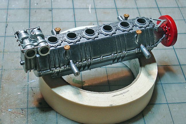

I'm just getting started on the engine. The block was sprayed metallic silver, then two coats of Testors Transparent Black window tint. If you look closely you can see where the mating surfaces where the cylinders will go are clear of paint... because I placed the cylinders on the block first, then sprayed the block... so no tricky scraping needed around those areas; I can just glue the cylinders in place.
And of course, the block got a wash of Future and acrylic black, to bring out the detail.
This engine has well over 200 pieces, so it's going to be a while...

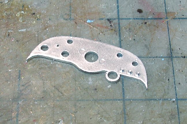

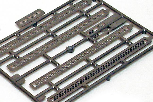

Ok, here is a real pet peeve of mine... poorly engineered and poorly thought out parts trees. Here is the kit dash...
Notice all the ejector pin marks? That means I will have to sand the dash smooth, repaint it, and scratchbuild the switches on the right side. All extra work that I as the consumer should not have to do! There is absolutely no reason why they couldn't have designed this parts tree with the dash flipped the other way... so that the ejector pin marks would be on the back side of the dash, where you would never see them, But no! They had to do it the stupid way. Sheesh... :rolleyes:
I expect better from a kit at this price point (MSRP $195!!!). Even though I paid much less, still... boneheaded mistakes like this have no place in a "premium" model kit. :angry:
