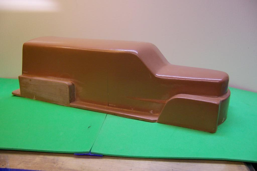

Danno:  Got your message regarding the Anniversary Series Seagraves that Mike Eisbrenner did back in the '80's.  I first met Mike at the Toledo Toy Show back when it was in Toledo at the Civic Center.  I think by then Mike was doing the second series of castings at that time and I remember purchasing one from him along with his pewter Ahrens-Fox piston pump kit.  Along the way I ended up with 2 other second series castings and one of the original "smoothies" as I will call it.  I thought the first one was numbered but it must have been the second series.  It was marked with a felt marker on the inside of the casting as #18.  The numbered one was used on one of the rigs I built.
The first castings were smooth on the outside and may have been done as a slush mold judging from the rough quality of the inside of the casting.  You can see that in the photos below.
1_001.thumb.jpg.b164096d845162e96622b2401_002.thumb.jpg.2d6c88689be67e85bbf33546
No detail whatsoever on the outside so it was up to the builder to mark out the windshield, side windows, scribe the door lines, hood and cut out the wheel well openings.  The back also had to be cut out if the sedan version was going to be built.  Notice also that above the rear fenders there is no hint of the treadplate that Seagrave used.  That came on the updated casting.

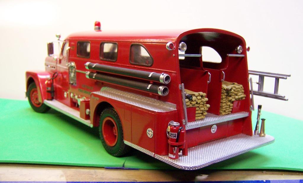

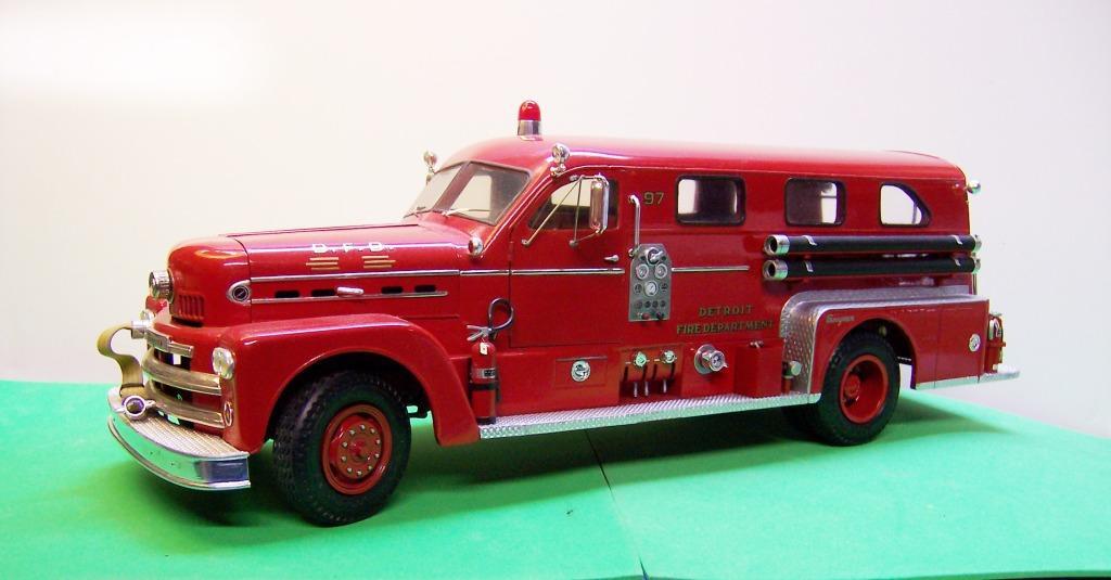

The later castings had raised trim and that shows up on the Detroit Sedan below.  The later castings were also much thicker,  and made of a different material something like alumilite.  When it is sanded little flecks of metal seem to show up.  The resin is also very brittle as was evidenced by one of the castings I obtained.  The corner of the fender had broken off and had to be glued back in place.  The trim lines being raised made it easy to cut out the various openings and get them lined up.  In actuality it may have been more correct to sand off the raised portion after the openings were cut out.  If you compare it to a 1:1 rig you don't see the rubber trim around the windshield.
1_005.thumb.jpg.eb2595ce58b04842f60118bd1_008.thumb.jpg.c8750f578f1a9080e58c9068

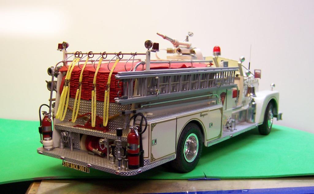

In the rear view you can see the Seagrave treadplate that was applied to the top of the rear fender compartments.  I added my own to the side of the running boards and rear step.  If you look closely at the rear view of the Detroit piece you can see how thick the casting was at the sides of the body.  The top has a small lip to it that makes it appear even thicker.  When I did the windows I trimmed them close so I could place them nearer to the outside of the body.  Gluing them directly to the inside of the opening would have been hideous.  Information on how the Detroit sedans looked was obtained from Matthew Lee's books on Seagraves.

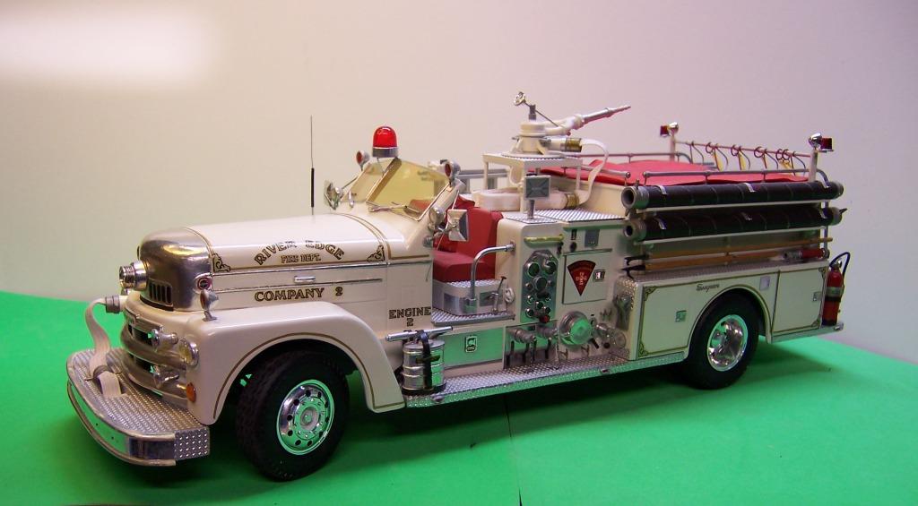

Here is actually the first Seagrave I did using the second series Eisbrenner casting.  This rig I saw for the first time at Croton-On-Hudson, New York at an annual fire muster.  It's a '62 model but contains some details that were not with the original when first delivered to River Edge such as the bright wheel rims, the raised deck gun and higher hose bed.  One of the most fancy Anniversary Seagraves around... and it still is around at River Edge, NJ.
1_009.thumb.jpg.e17cd8cf839b7596c0fce4521_010.thumb.jpg.517096084cd2d83d4df66861

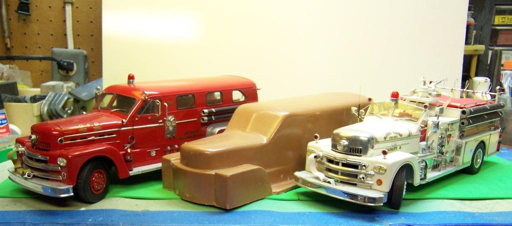

Here is a shot of two models with the original casting in the middle.  Now that I look at it I think Mike made some adjustments in the second series of castings in addition to the raised window outlines.  The unmarked windshield looks high and the corners of the hood appear much sharper.
I'm glad I got these when I did and had the chance to build them up.  These were the days of real classic fire apparatus design.

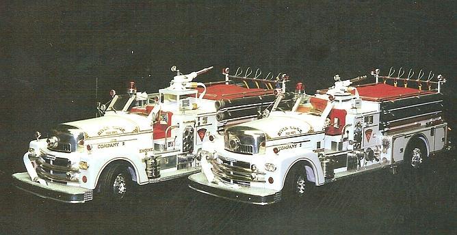

May as well go all the way, eh?  Here are some photos of the second River Edge piece.  This one was done based on Seagrave drawings and some help from the River Edge FD, Co. 2.  When the model was delivered I got to ride the actual truck!  Awesome experience!

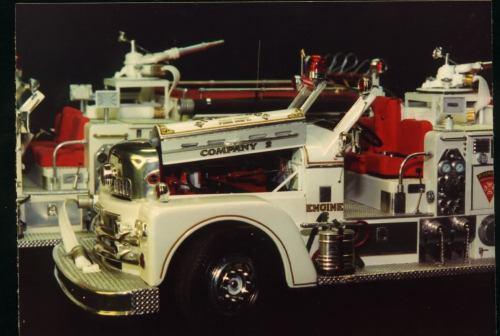

The hood on this one is hinged brass.  Nose is covered in Bare Metal Foil.  The hose body is slightly higher than on the first model and more closely resembles the modifications that River Edge did after a few years on the job.  Initially it had white rims and a standard height body.

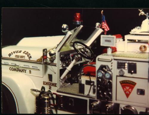

River Edge insisted the model had to have the American flag flying from the radio antenna.  You can see it in the last photo.  With the opening hood I was able to open up the horizontal holes in the hood sides and put a piece of material behind them which is prototypical and a detail I left out of the first two.

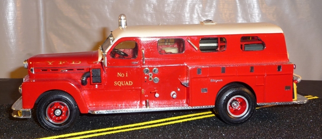

Well you two have dragged me into this thread. I also met Mike at the Toledo Toy Fairs back in the days of the Maumee recreation center madhouses.
Here is a pic of my version of his original casting that I got that had yellow release on the fiberglass.
P1040448
Here is the two versions of the cabs I have an original fiberglass and second version # 56
P1040443
P1040442
My version of the safety sedan was one of the only three built by Seagraves. It is based on Youngstown Fire Department's 1958 truck
It is only rescue and carries only a booster pump and water tank. the hose bed area is crew and equipment space
P1040447
P1040444
Bits and parts are from the AMT ALF pumper, Aurora ALF Pumper, Don Mills emblems, Johan police vehicle, AMT van kit doom window, and plastic fireman sacrificed the masks and air packs
P1040449
The siren was made using parts from the AMT ALF kit, front bumper was forced straightened ALF with chrome tape center
grill cross bars are evergreen square stock sanded to round.
The original truck had single headlight fender but was updated through the years with various rehabs including being repowered by a Cummins diesel which why there is an outside air cleaner. This model shows the last rehab paint scheme but with the old lettering the truck had
P1040450
Danno: looking at your pics of your castings I can't say where they are from as they don't match what I know of Mike's castings
