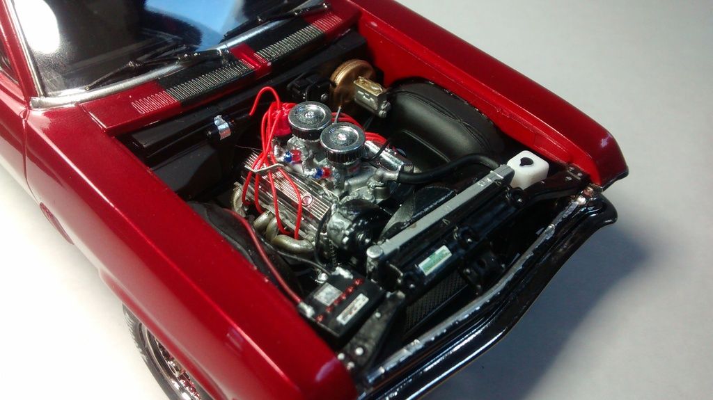

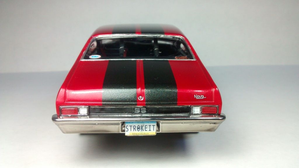

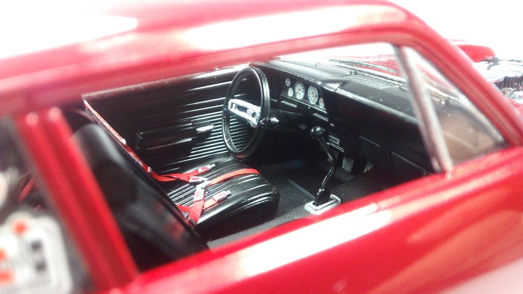

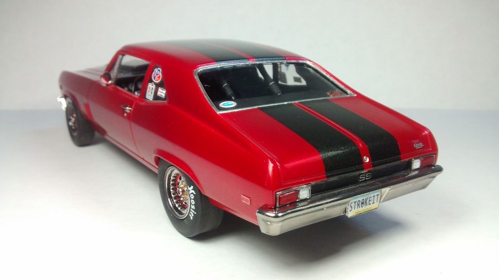

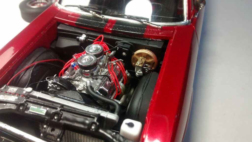

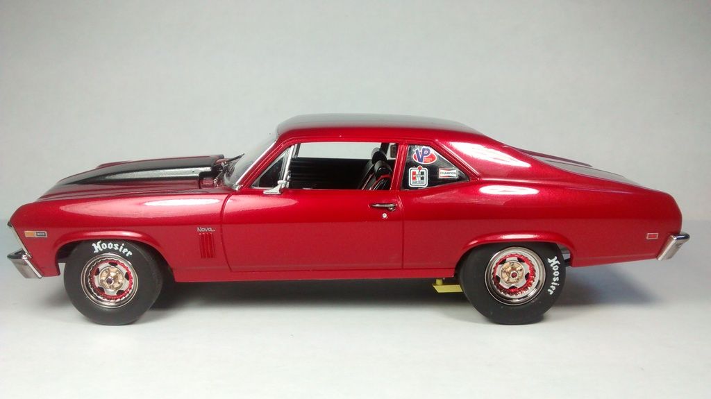

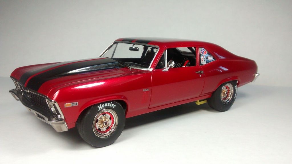

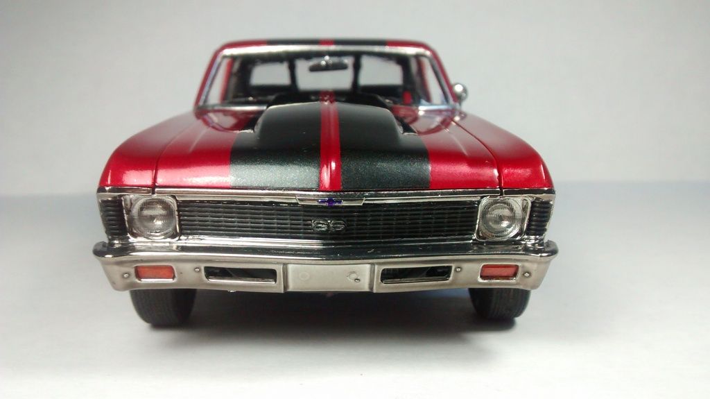

Tyler62990 Posted July 15, 2016 This one started out as the Revell 69 Nova SS. It's pretty much an out of box build with a few things added to jazz it up a bit. I build on a budget, so a lot of the detail parts are made from household items like solder, aluminum foil, etc. The list of mods includes: Beading supplies for the fuel lines and fitting, vacuum lines, and battery cables and overflow tube. Styrene rod fuel log Solder and styrene strip throttle linkage and return spring MAD Distributor Styrene strip for wire looms Solder for the brake lines Kanthal wire for the alternator wires The coil was moved from the intake manifold to the firewall, with a piece of aluminum foil to imitate a bracket Battery labels are reduced images from Google License plate from Acme License Plate Maker Harness made from textured paper and styrene strip Roll bar padding made from heat shrink tubing and solder for the ties The paint is Tamiya White Primer, Duplicolor Garnet Red, Testors Blazing Black and Testors Wet Look Clear. Well that about wraps it up. Thanks for looking! Quote Share this post Link to post Share on other sites

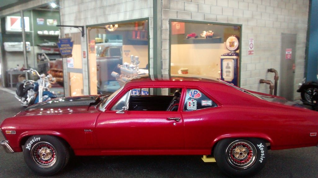

KWT Posted July 16, 2016 (edited) Man, this is a sick Nova.. awesome job!! on a side note, love the diorama too! Edited July 16, 2016 by KWT Quote Share this post Link to post Share on other sites

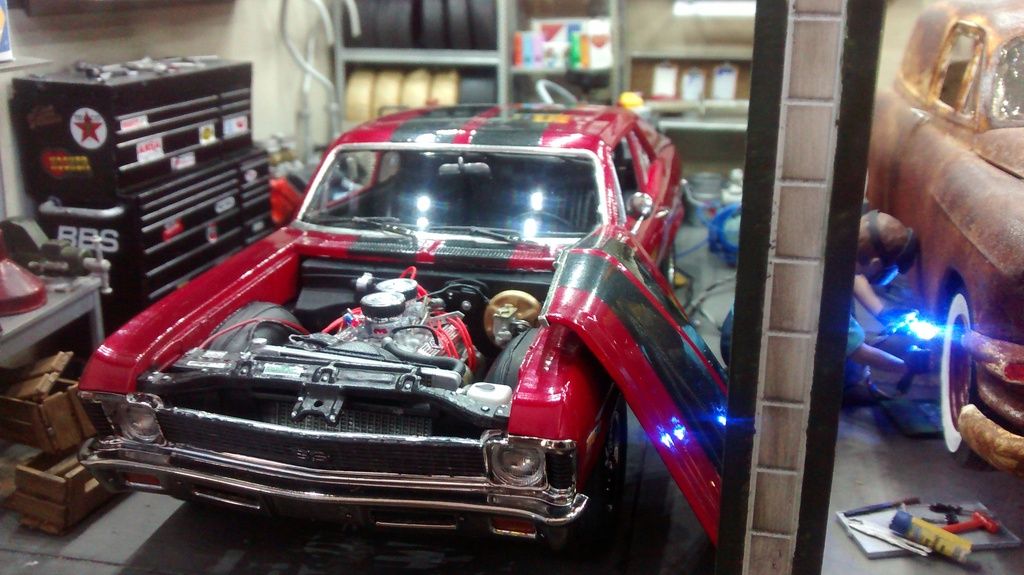

Lowlife ! ! Posted July 16, 2016 Very nice looking nova, paint is stunning ! Love the dio too, in the last pic how come the guys welding ???? Quote Share this post Link to post Share on other sites

Snake45 Posted July 16, 2016 So, in other words, not "out of the box" at all.Pretty nice job, though. I like the paint. Quote Share this post Link to post Share on other sites

mustang1989 Posted July 16, 2016 Great work on that Nova Tyler! What is that guy welding on over there? and What did you use for the welding light? Quote Share this post Link to post Share on other sites

espo Posted July 16, 2016 Beautiful build. Your "budget" detail work on the engine looks as good as any other . Quote Share this post Link to post Share on other sites

Tyler62990 Posted July 16, 2016 Thanks for all the kind words guys, I really appreciate it!Very nice looking nova, paint is stunning ! Love the dio too, in the last pic how come the guys welding ???? Great work on that Nova Tyler! What is that guy welding on over there? and What did you use for the welding light?I have the welder on a separate circuit from the other lights, I just forgot to shut it off lol. That 54 Chevy is pretty rusty, though. It probably could use a patch here or there.The welder is a modified piece from the Fujimi Tools set, drilled out to accommodate two nano LED lights from Woodland Scenics, one bright white, one blue. They're both connected to a strobe circuit I purchased from eBay. Quote Share this post Link to post Share on other sites
Tyler62990 Posted July 16, 2016 So, in other words, not "out of the box" at all.Pretty nice job, though. I like the paint.Yeah, I guess not. What I meant was that the car, with the exception of the added details, can be built with what's in the box. No suspension mods, no chopping/bodywork, no aftermarket engine parts, etc. I need to brush up on my modeller lingo lol Quote Share this post Link to post Share on other sites
