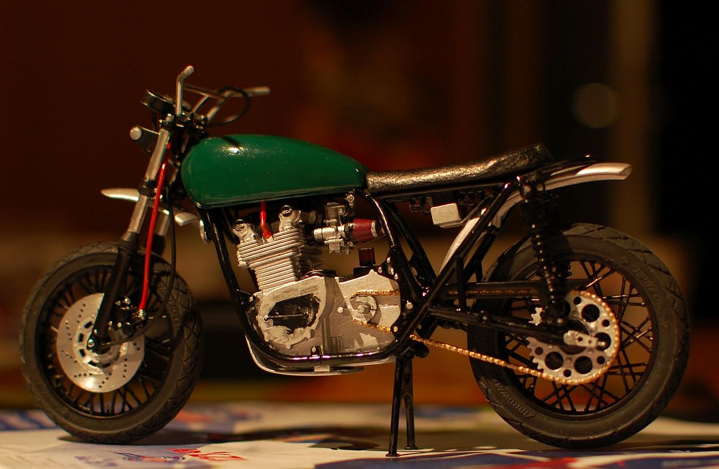

unfortunately the stance was the one of a chopper and not of a offroad bike (although i already extended the length of the rear shocks). after shortening the forks and building 3 further sets of shocks i was happy:
DSC_8481.thumb.jpg.fcf4431a40b7f781fa7f1

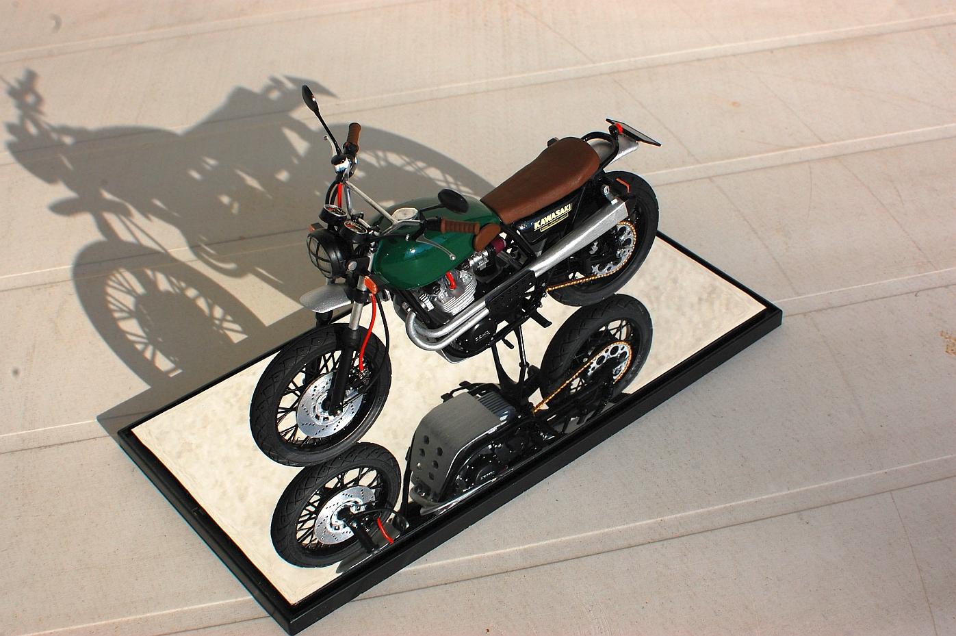

and here is the final result:
DSC_8497.thumb.jpg.8159c0f618045ba3bfe19DSC_8496.thumb.jpg.9f937b21211a376125344DSC_8486.thumb.jpg.e83dfaf1d890a9778ac9dDSC_8489.thumb.jpg.be626ab184ddc985f5548
