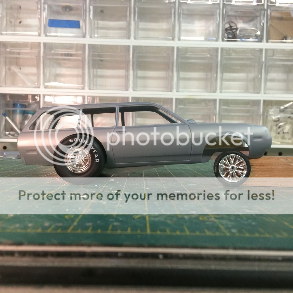

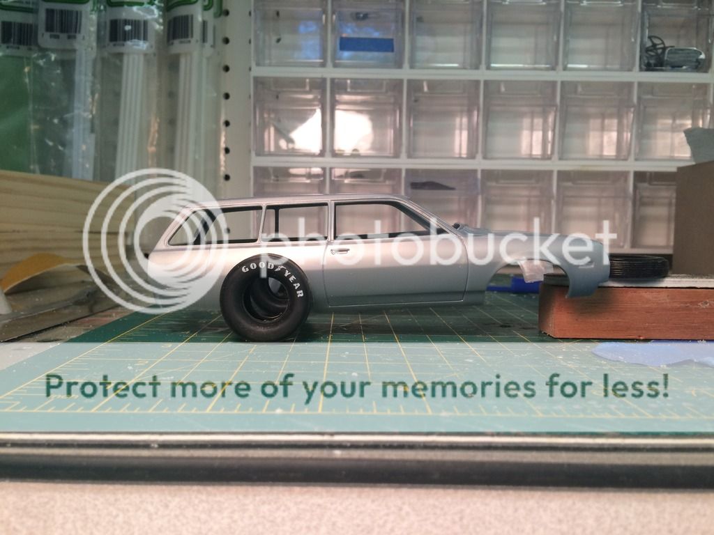

So getting started I grabbed the rear slicks from the JawBreaker Dragster, and started cutting up the rear fenders till the stance was pretty close

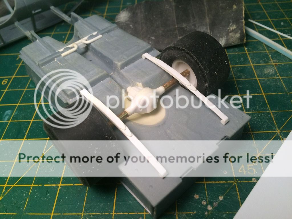

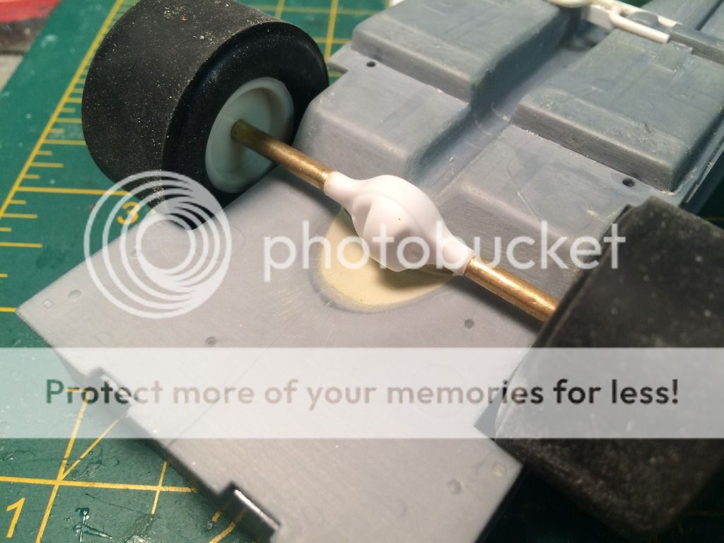

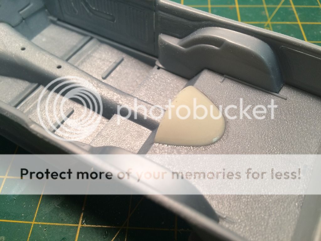

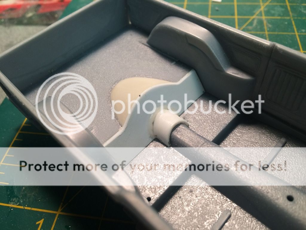

Then I fully sanded the toy-like detail off the chassis plate...  Using the Ford 9" from the new 29 roadster and some brass tubing, I realized rear-end clearance will be an issue.  Some sheet styrene and wendys spoons to the rescue.

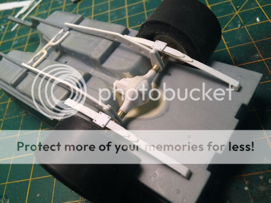

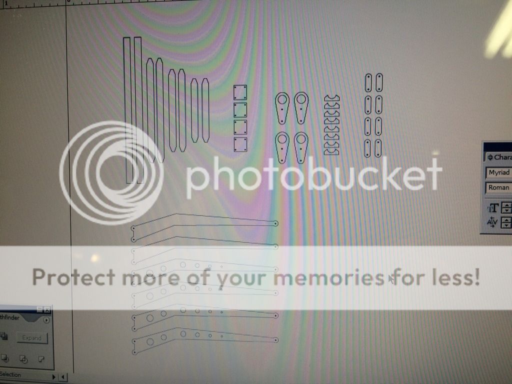

Using my scrapbook cutter I drew up and cut out the springs, plates and ladderbars.
Then started building the rear suspension:

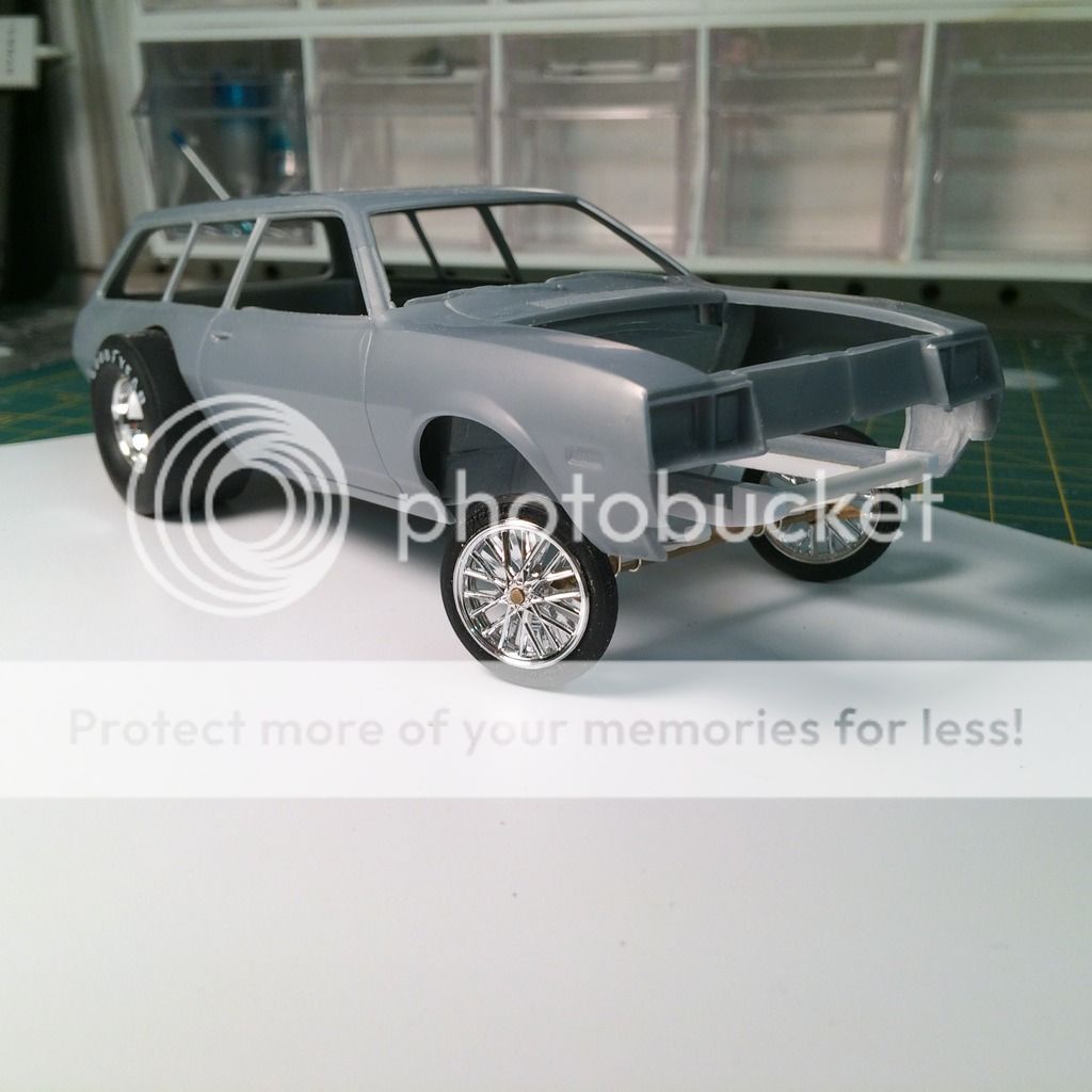

then it was on to the front..
Using the spindle mount wire fronts from the Jawbreaker setting up the stance .(future plan is to upgrade these to photoetched wires from Herb Deeks, and lathe turned hubs and rims)

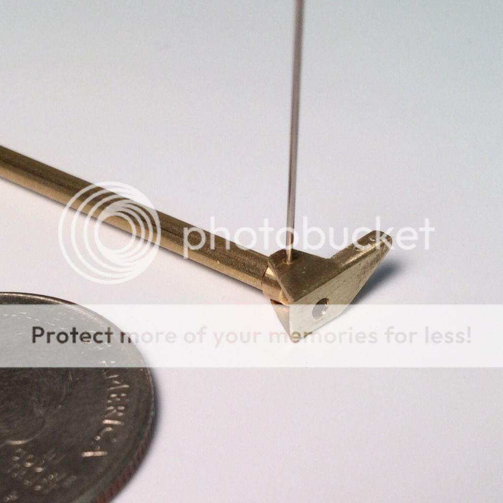

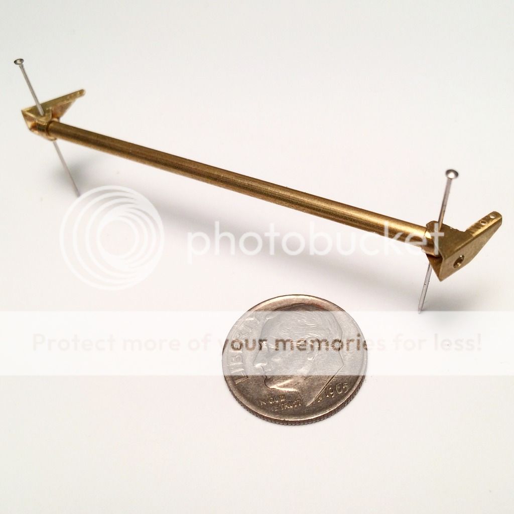

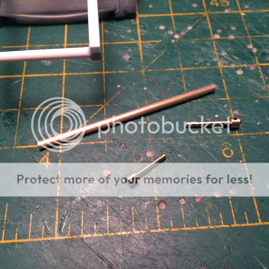

Brass Tube axle and lathe turned ends:

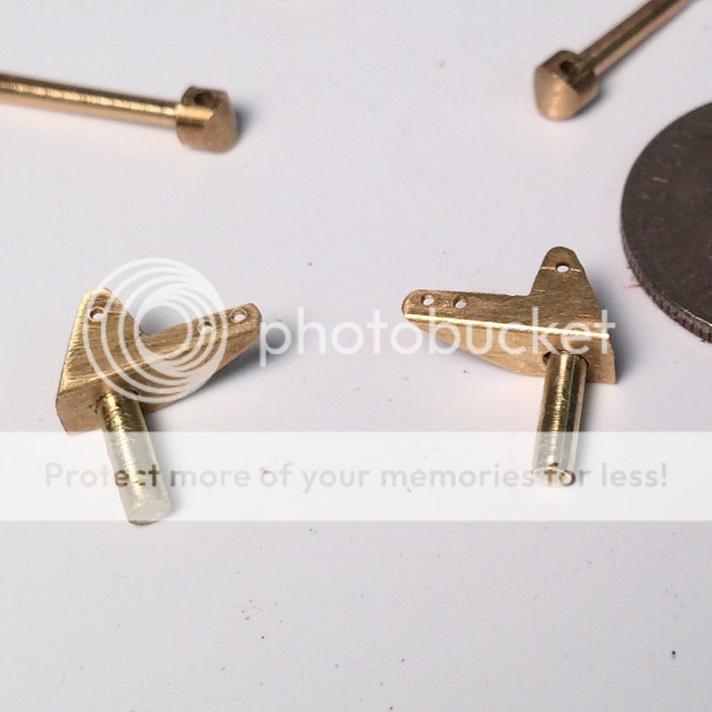

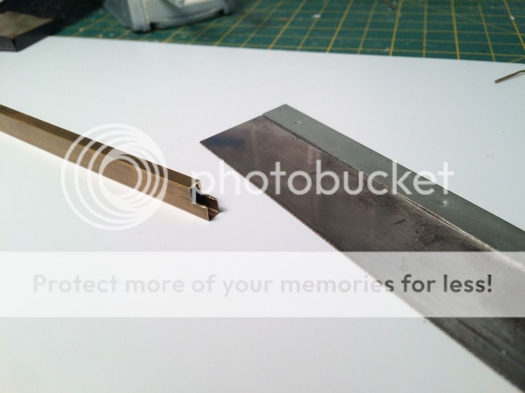

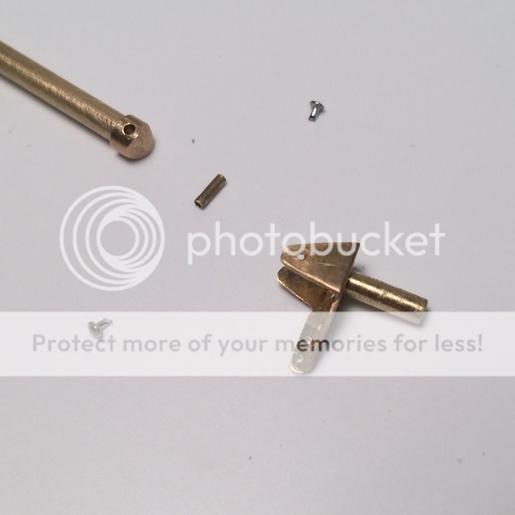

pull back saw and some rectangular tubing I was able whittle out some knuckles (yes,my fingers still hurt)
the i lathe turned the spindles with a nail type head to be inserted from the back side:
KingPins out of tiny brass tubing and 2 cut off straight pins:
Now I just need to assemble these and make the front springs and shackles...tonight's project.

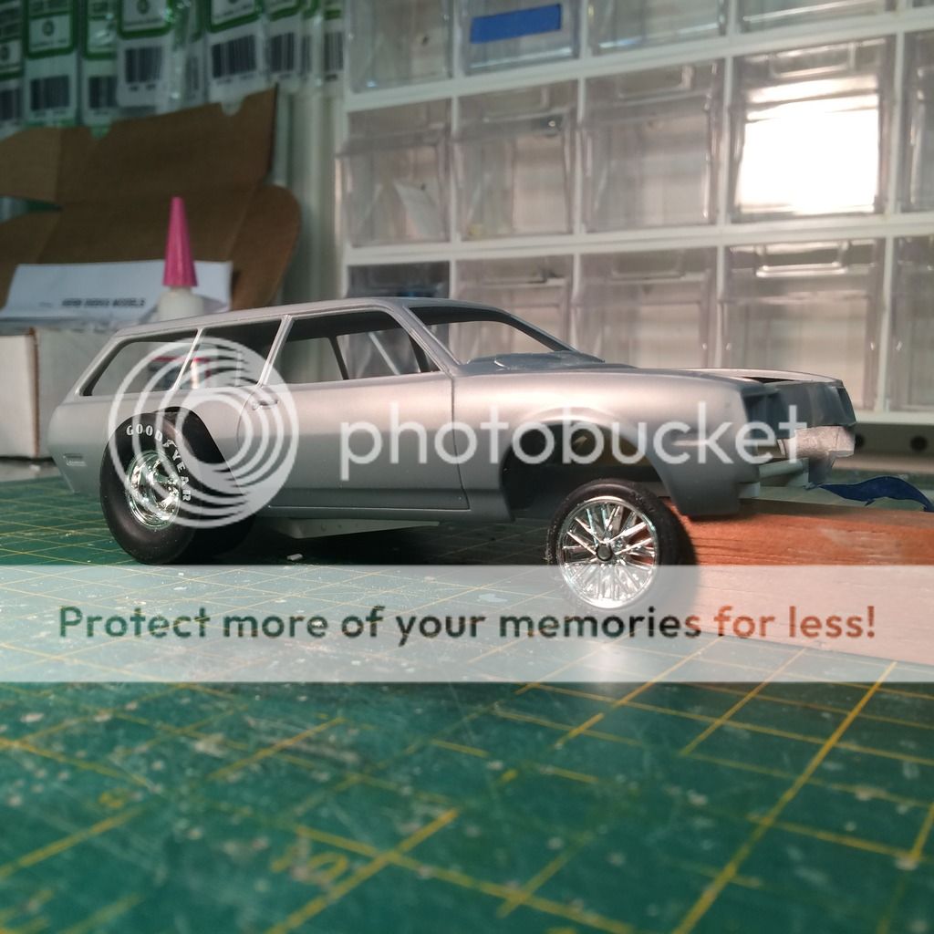

Seeing this I can't help but think that for a drag car, it would look so much better with about 3/8 of an inch removed after the rear wheel well. Just my opinion.
Rob that is a really good idea... I will have to play with it once I get into the body, that can also help with the rear bumper/roll pan situation going on back there.

Thanks brian!   Yes, I have a Silhouette Portrait scrap book cutter, so cutting repeat shapes out of .020 or thinner styrene has gotten much easier.

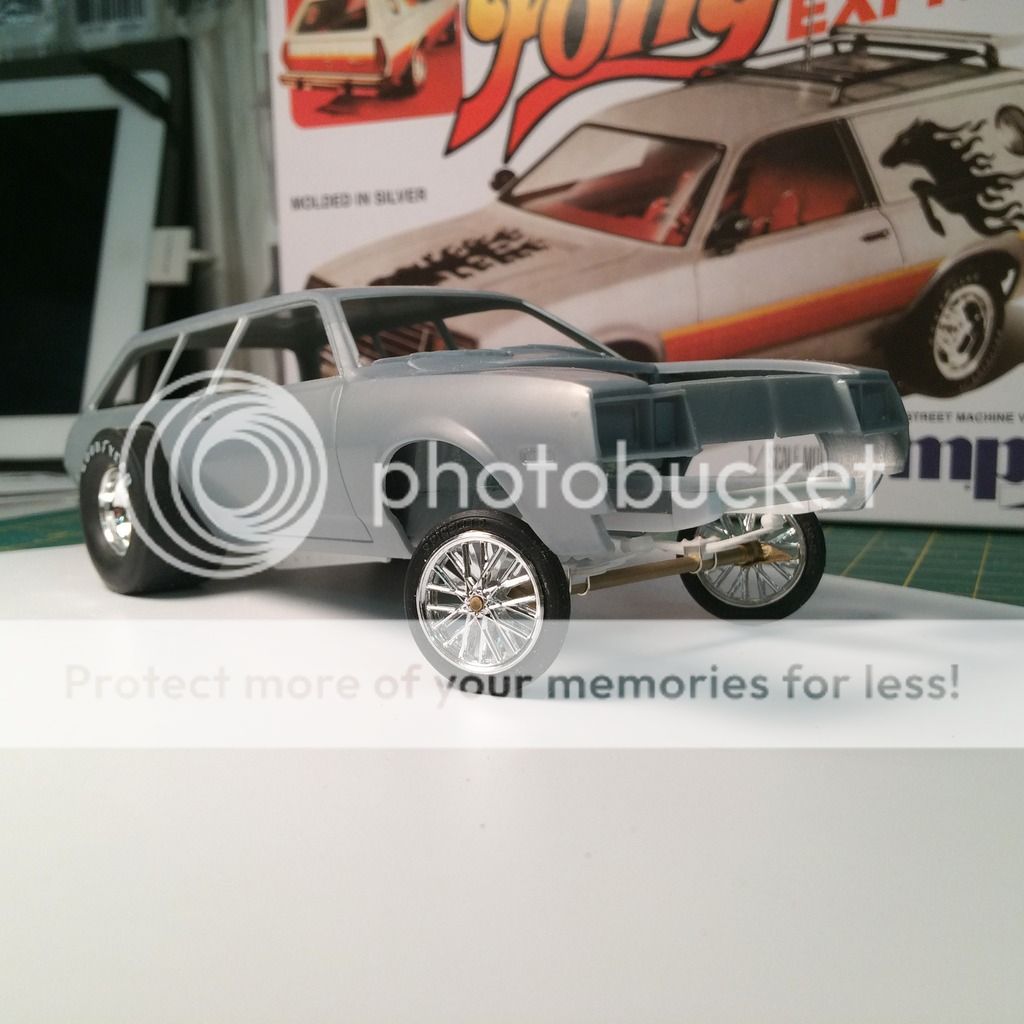

Here are a couple things I managed to get done this week:

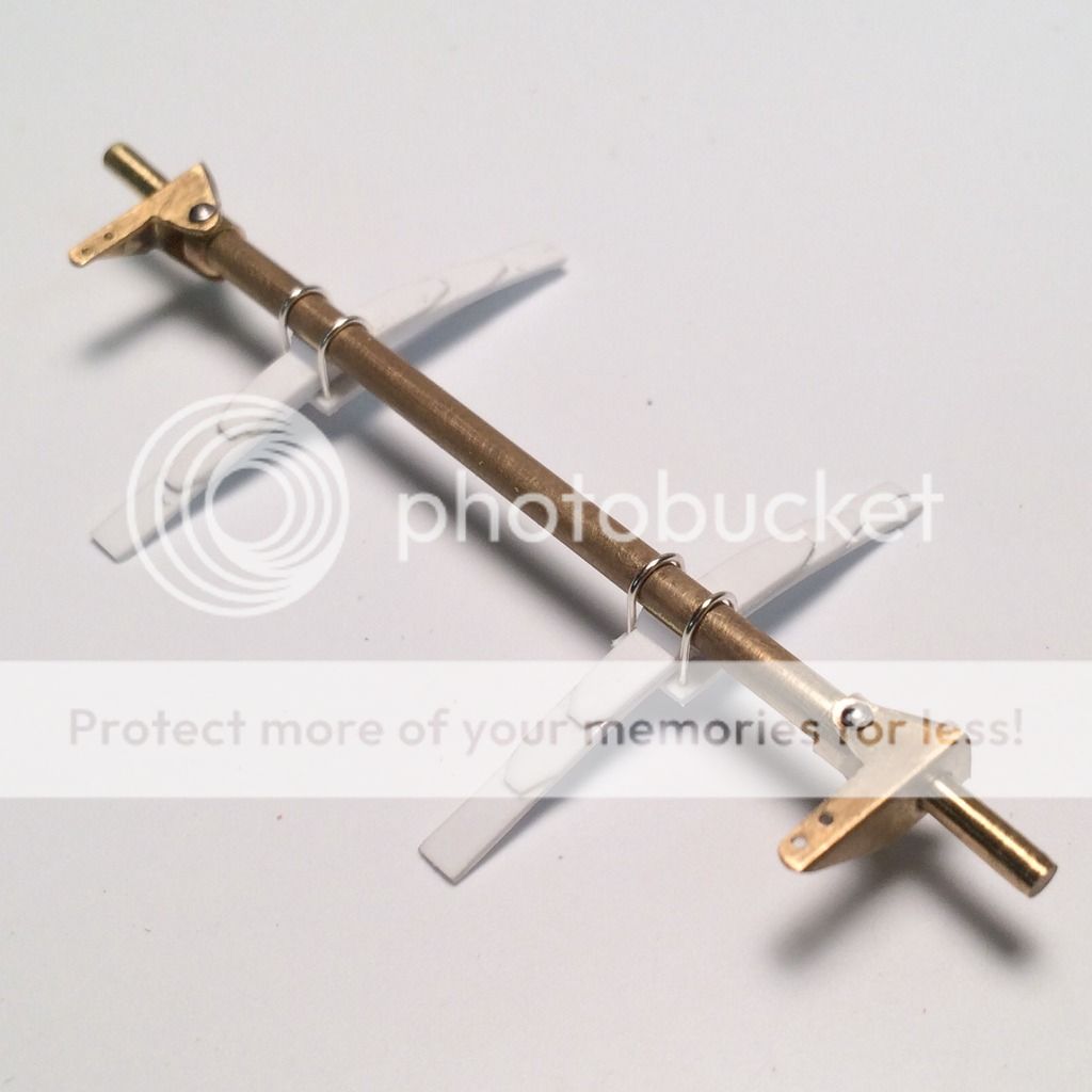

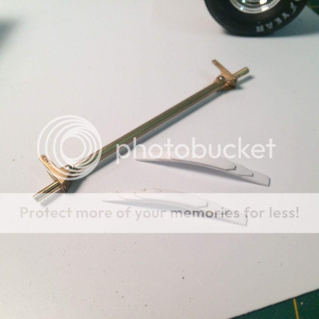

Axle assembled and front springs and plates made.

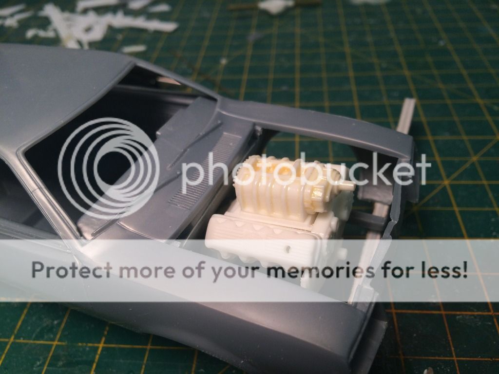

I did this earlier, but forgot to post....The 429 SOHC engine is mocked up... I used the engine from the Tommy Grove mustang funny car, which seems similar to the 33 Willys one, but with a front plate mount.
Now i need to mess around with these valve covers to make them look a little closer to the 1:1 and less like a cartoon dinosaur.

That Silhouette Portrait scrap book cutter looks really interesting. My wife is a crafter so buying it would be good for both of us. Have you used yours enough yet to get an idea of how long the cutter blade lasts cutting the plastic? And I am believing that the .020 is the thickest you can use with this? Been reading up on it at Amazon, sounds like really good reviews for the most part.

I really like mine... the cutter will cut .030 as well... but its more of a score and snap operation... and the cuts aren't quite as clean because the blade doesn't get as deep. As far as blade usage, I bought mine used off ebay and it came with 2 blades, a used one and a new one... I flopped the new one in right away, and i have done a ton of cutting with it.. no real signs of dulling... I read up on some stuff, and the blades seem to last quite a while.
Check out the Cricut machine as well, its a physically larger machine and seems to cut the thicker stuff better, holds small details and circles better.   The downfall seems to be the software is a bit more cumbersome to use, and its a big machine.   I personally like the software and compact size of my silhouette portrait.
The main thing is just playing around with it, I would encourage anyone to get one and try it. In the silhouette software you can draw basic shapes easily and to size, so even for simple rectangles I now just use the cutter.
I really need to set up a camera and do a YouTube video on this, but i think that will be a winter project.

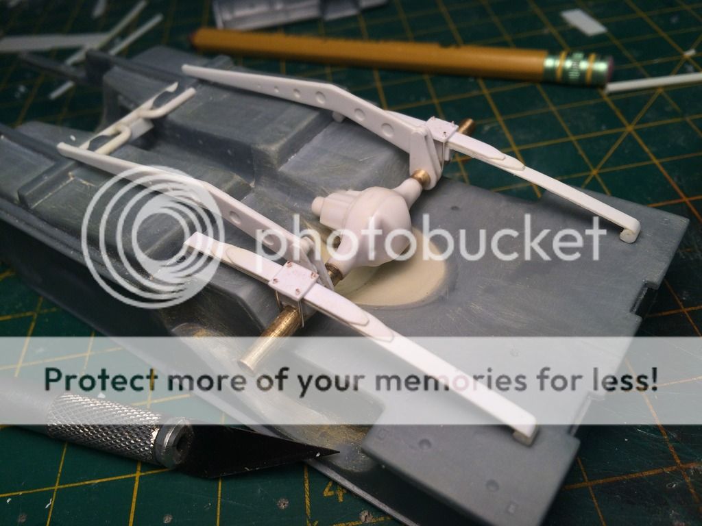

Here is some progress from the weekend and last night:
Springs, plates and U-Bolts installed!  Still going to add some .080 rod to simulate the spring eyelets on each end.

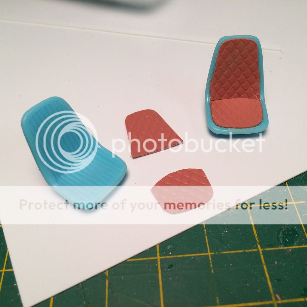

Grabbed the Malco Gasser seats and made some diamond tuffed-ish inserts with some N-scale tile roof sheet.   (Thank you Mr. John Teresi for showing this on here)

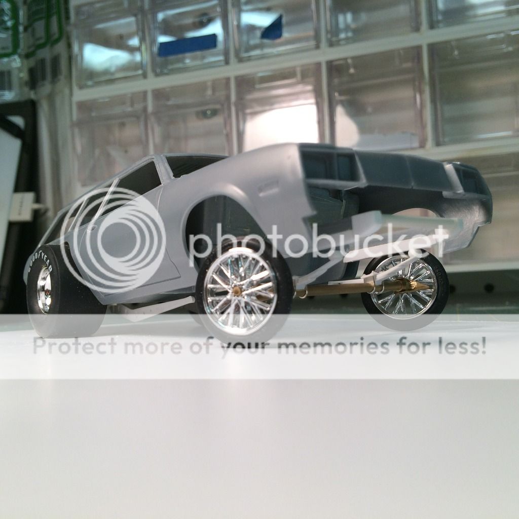

and finally a quick mock up...
