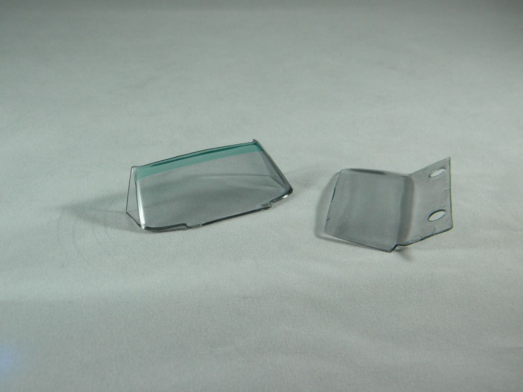

I can see a very light green tint on the glass overall.
Do you think it would be possible to dye the strip across the top & then the rest of the glass?
Usually, I shoot a strip across the top with acrylic paint & then spray the entire glass with Testors "Window Tint".
It works pretty well but I would prefer a green overall tint rather than "smoke".
Steve

Exactly right Steve.
Your method is almost the same as mine. But I use a custom mix of Tamiya acrylics instead of smoke. Then I clearcoat them and polish them out .
Here's a shot of some from the last batch I did last week. These are a bit darker than the ones in the other pic and look about twice as dark as this in person. For some reason it  doesn't show up as dark in the pics.
