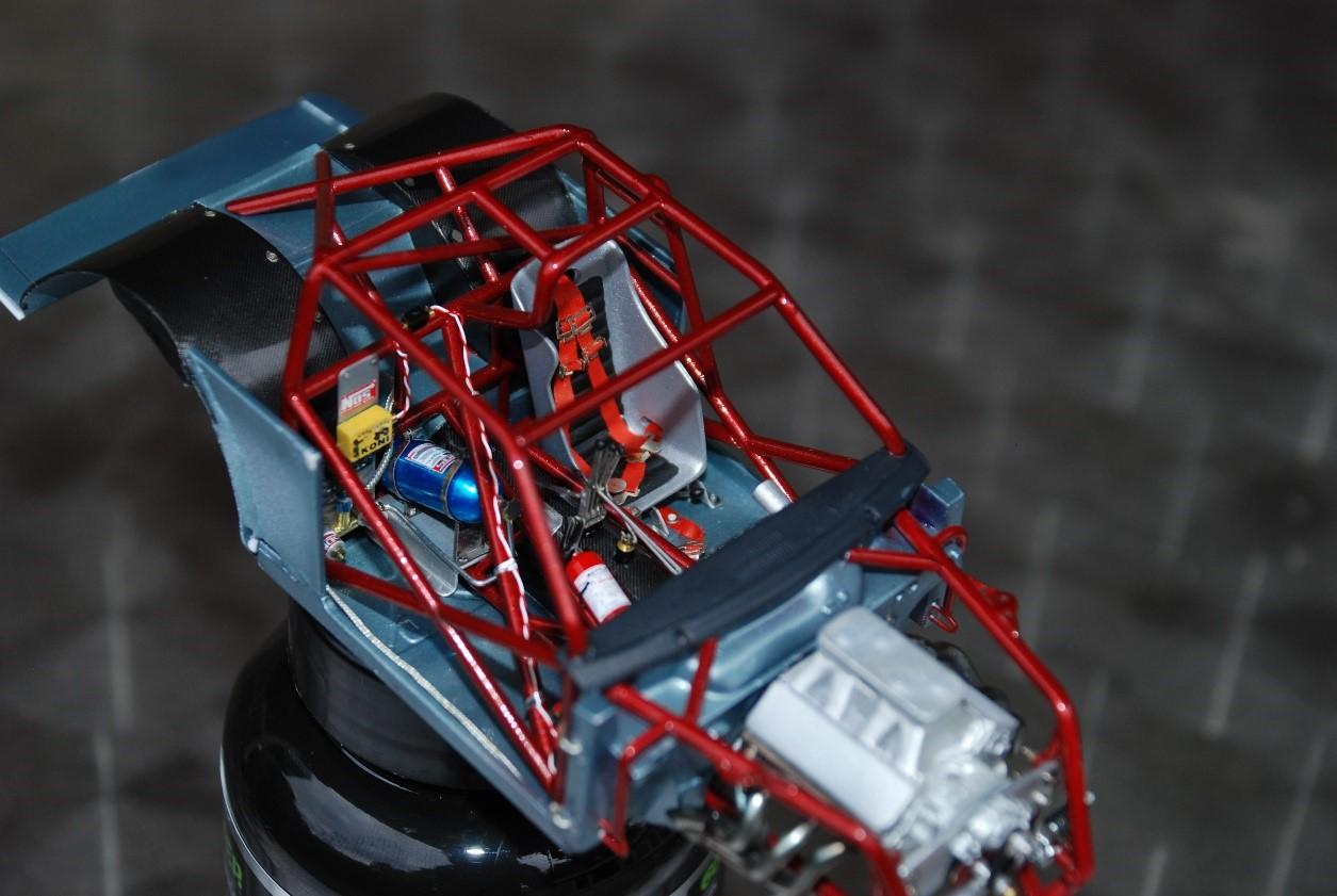

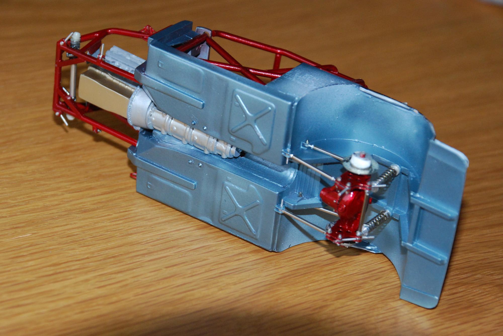

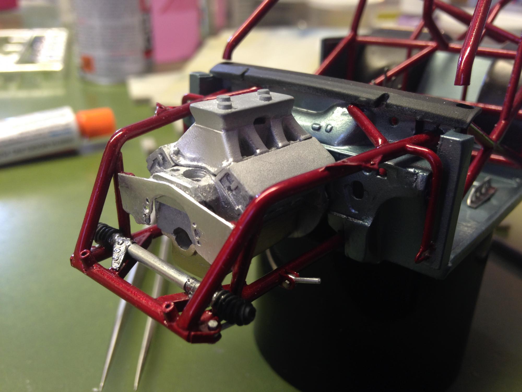

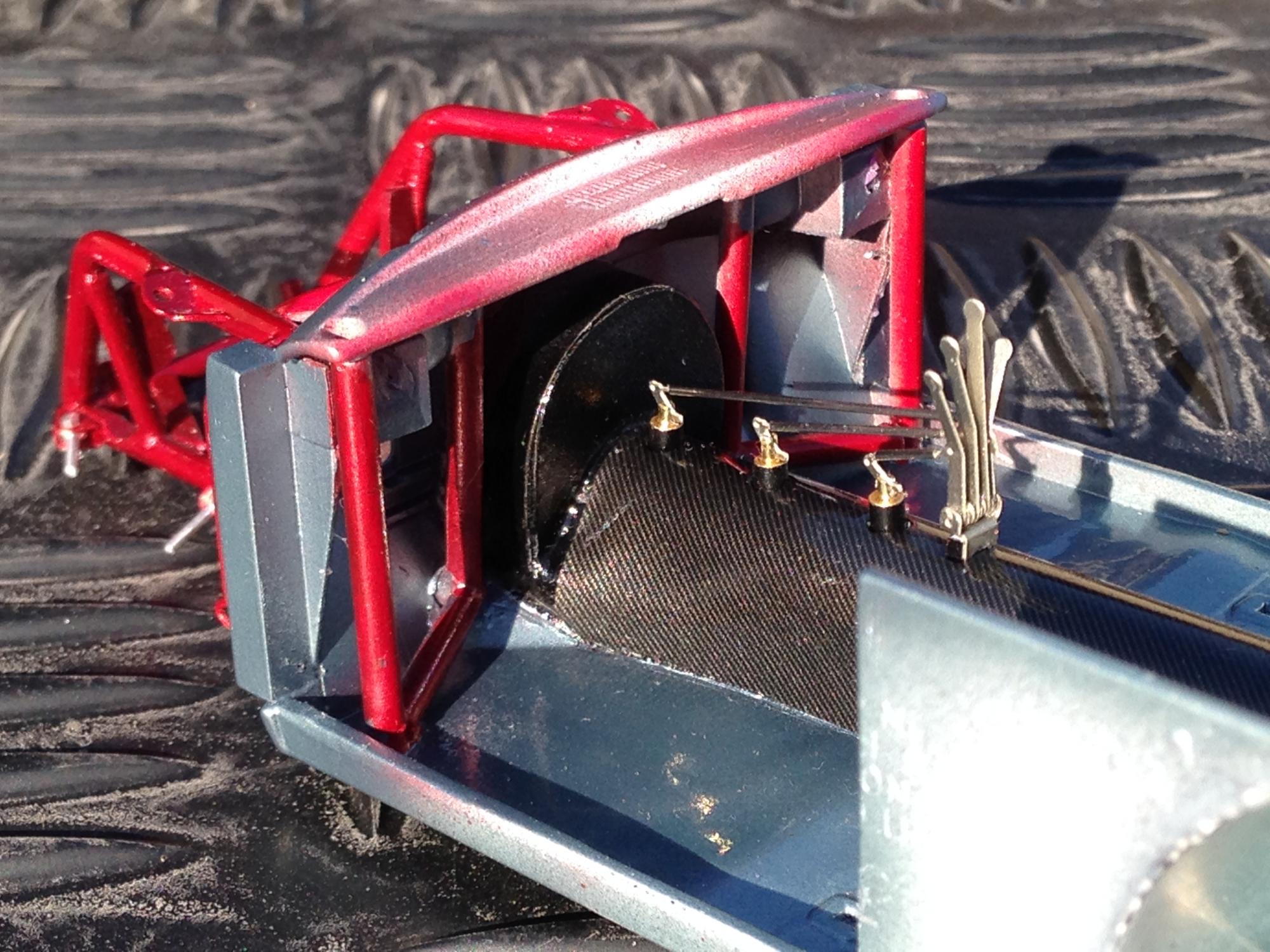

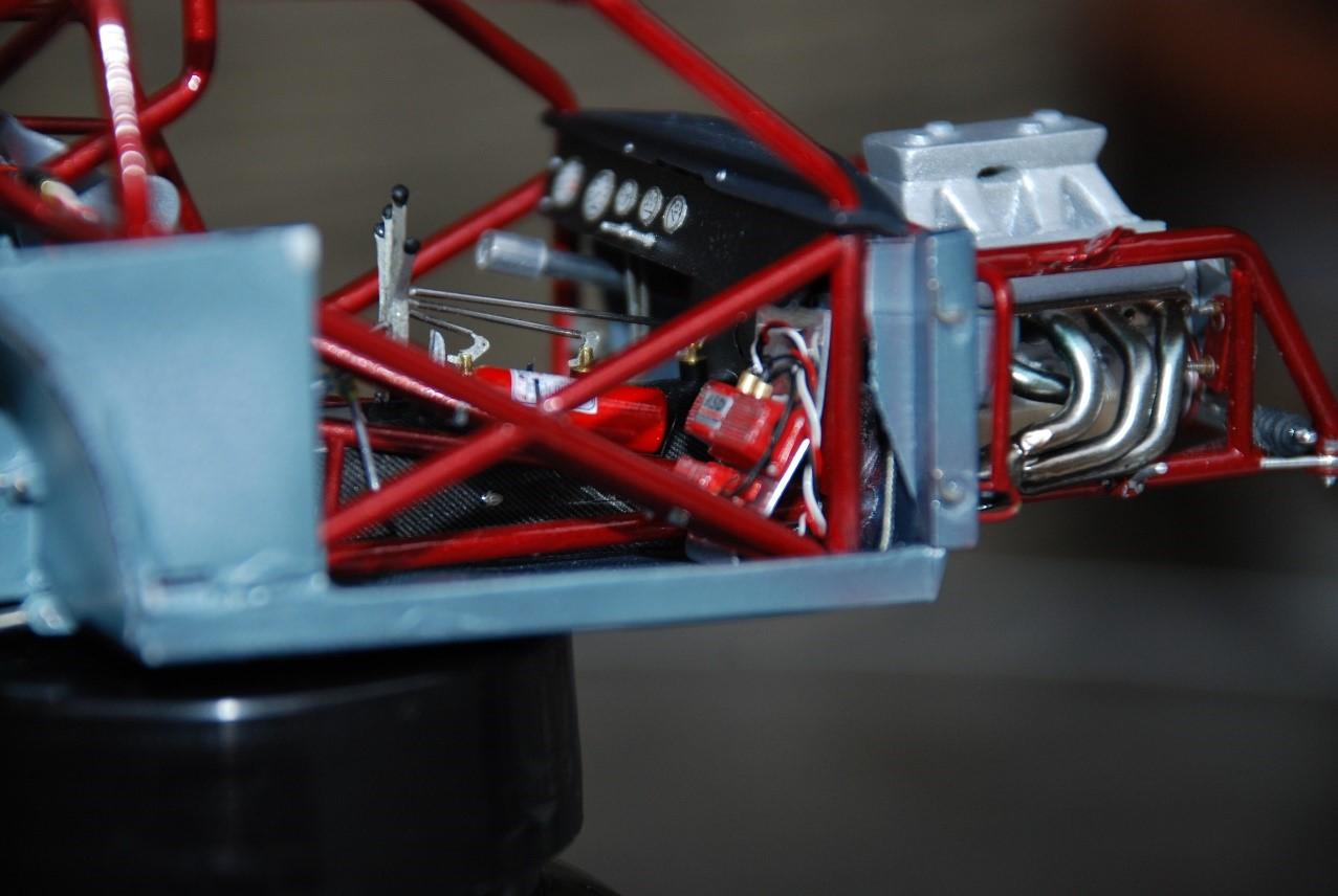

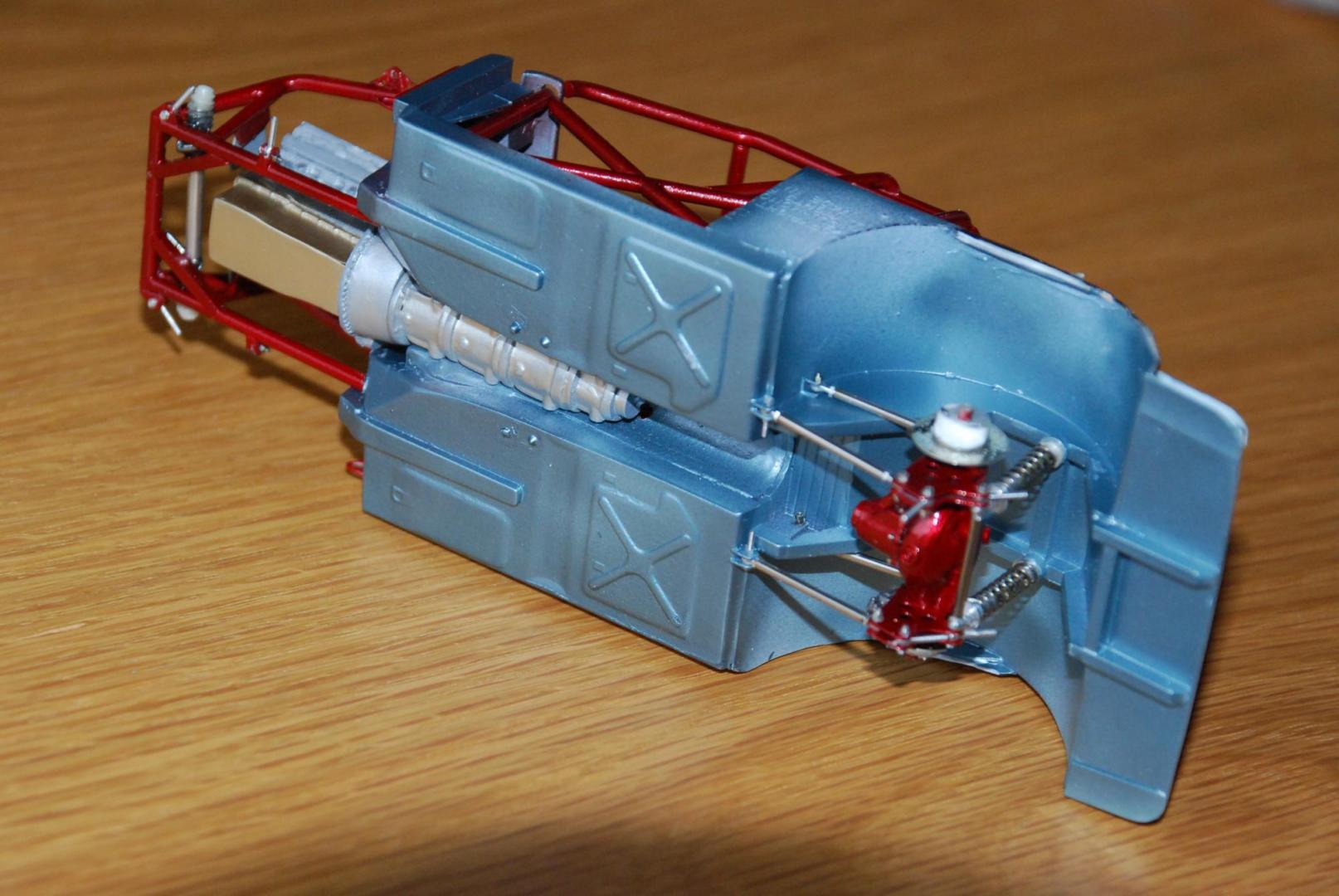

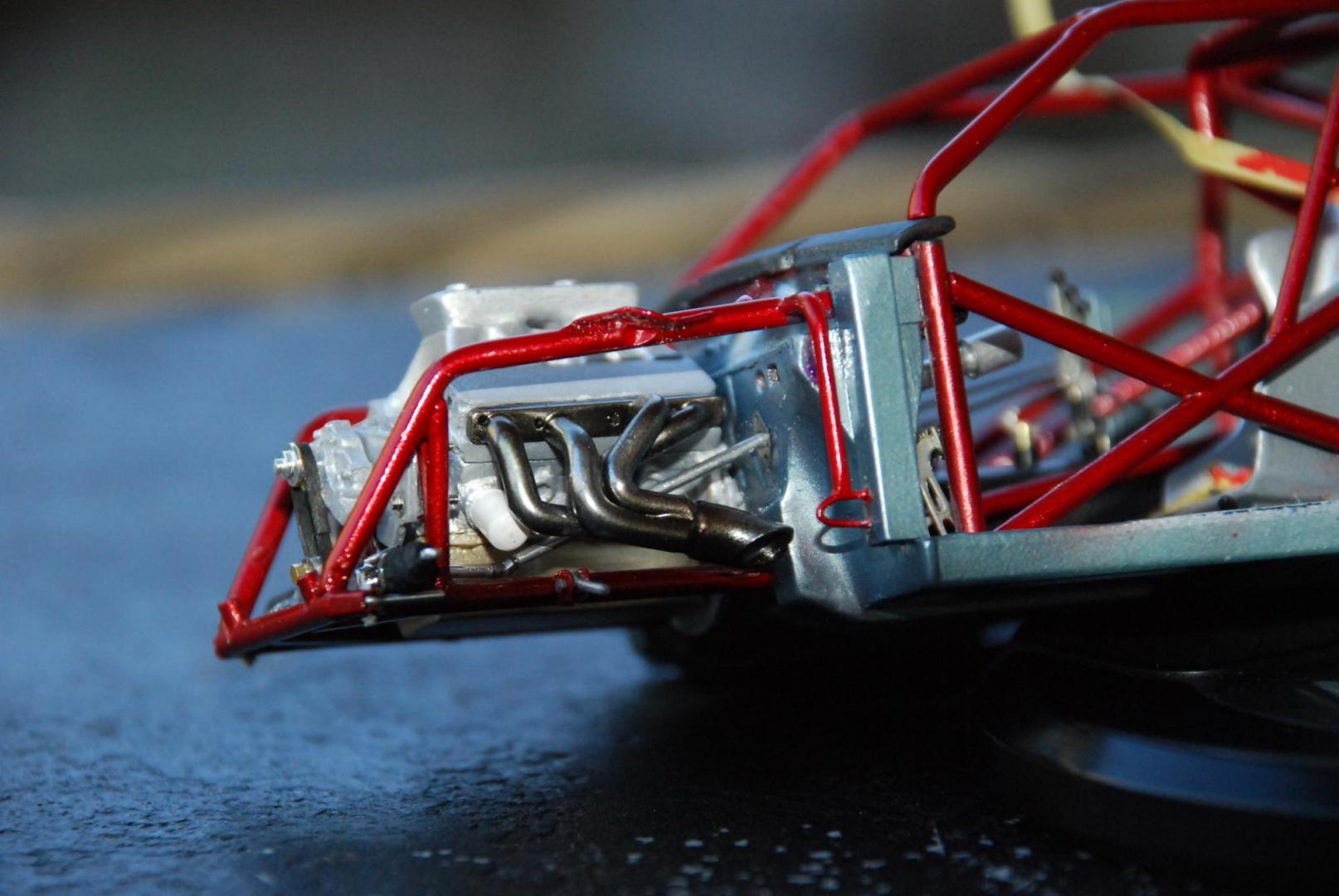

LeadFred Posted August 17, 2016 Author Share Posted August 17, 2016 (edited) Ok now I think I've found the images with the details of some interior construction and some chassis parts that have been installed. This is the power plant with lenco transmission,it is painted and i will install the engine in the chassie before i start to detail it. I find it easier to detail the engine when it is fixed in the frame just that the paint lightly rubbed off from the corner when you have to hold it in your fingers all the time. Here you can see the rear end mounted on the chassis, wheel tub are not particularly attractive from below but it will not be seen then when the rear tires are mounted. I have also mount rod ends in the tabs that will hold the front wheels.Also a rack and pinion steering are mounted,its made of a aluminum tube with the ends from the Revell 1/24 Pro stock Firebird kit They have been alclad before mounted. And Here we have the headers been alclad. ready to be istalled. here we have the lenco shifter kit,that where I have put brass tubes into the holes in the tunnel and then a stainless steel tube with a sawed groove in it....sitting in the brass tube.There I then attached the photo-etched detail of the struts that will go up to the levers.The sides of the brass tube are painted black, and only the top are brass. Edited August 17, 2016 by LeadFred Quote Link to comment Share on other sites More sharing options...

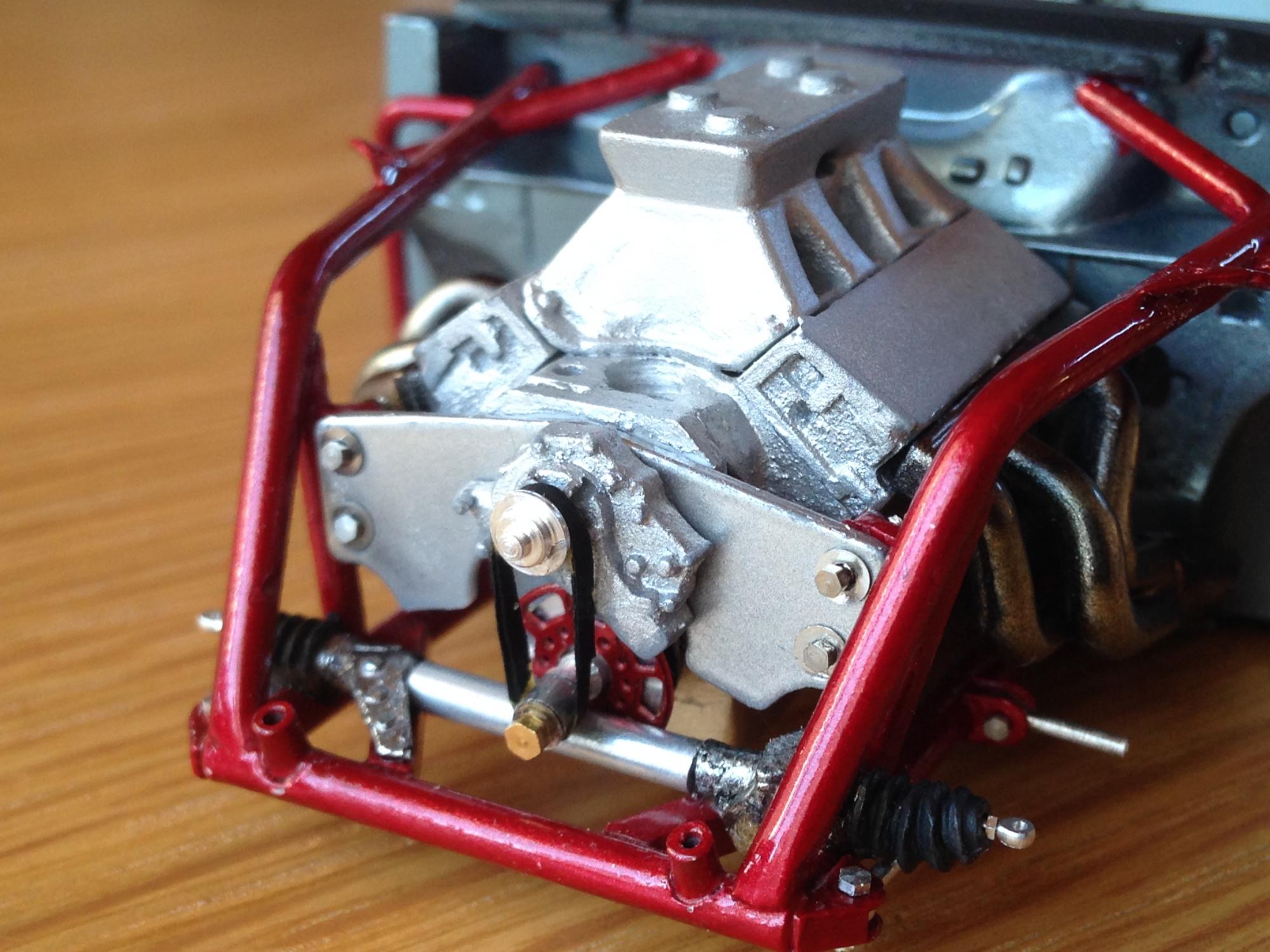

LeadFred Posted August 17, 2016 Author Share Posted August 17, 2016 The lenco shifters are mounted. But not the strut to the reverse gear. This is the engine mounted , Here you can see some scratch built pulleys made on my lathe and the belt are made of Tamiya masking tape and painted black. You can also see the headers are installed. Fred Quote Link to comment Share on other sites More sharing options...

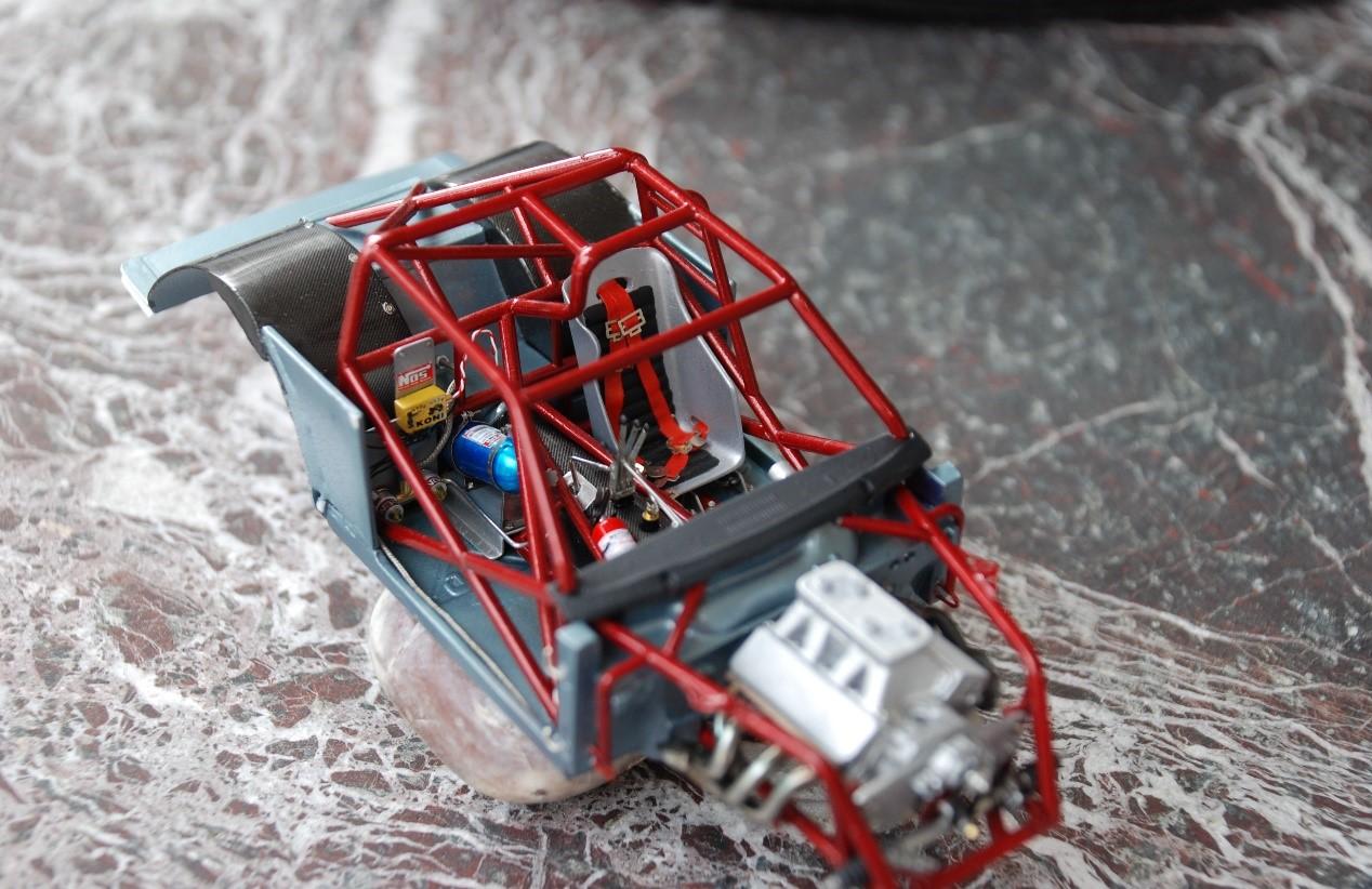

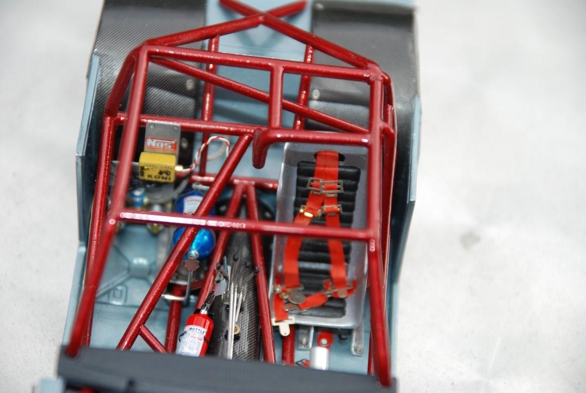

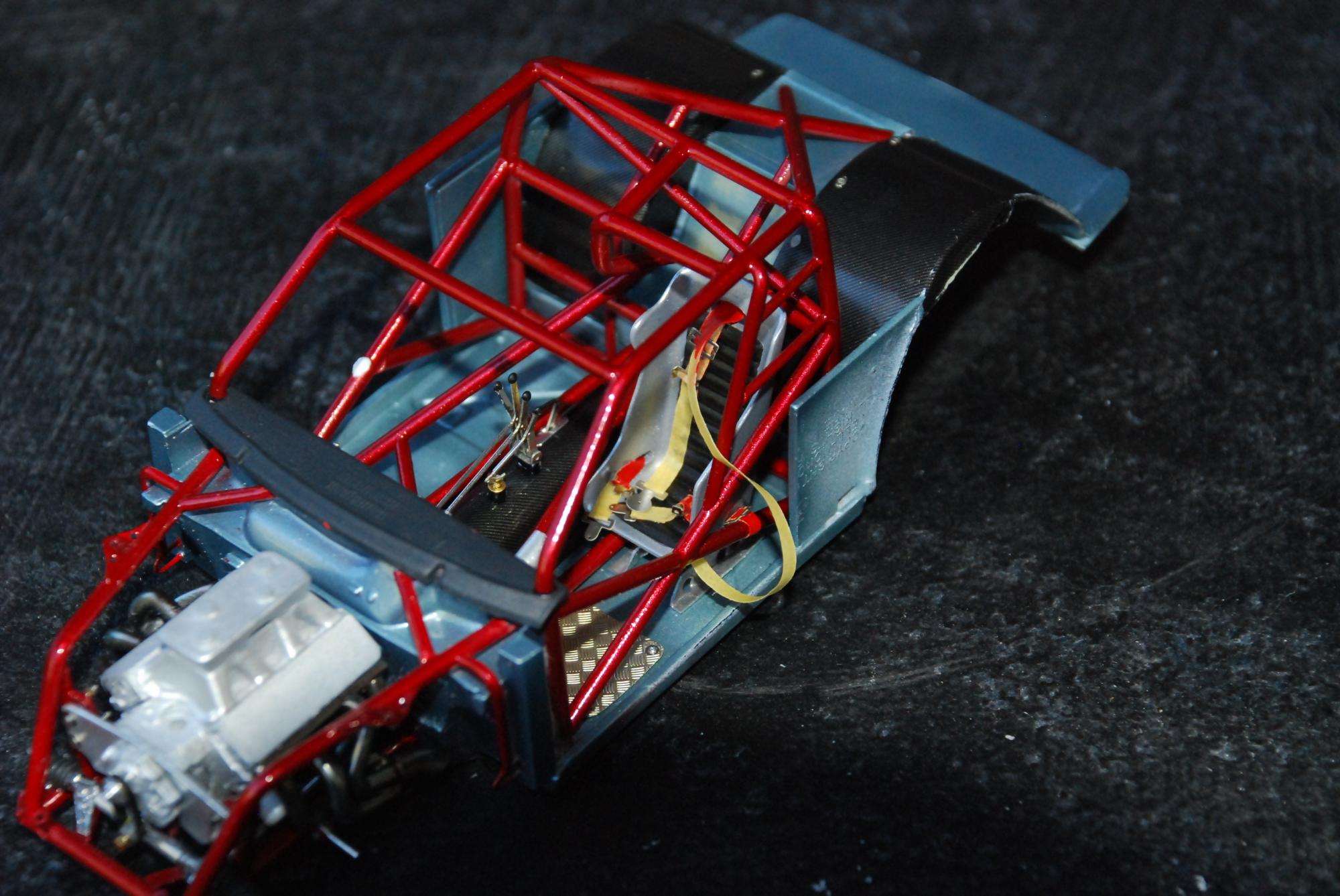

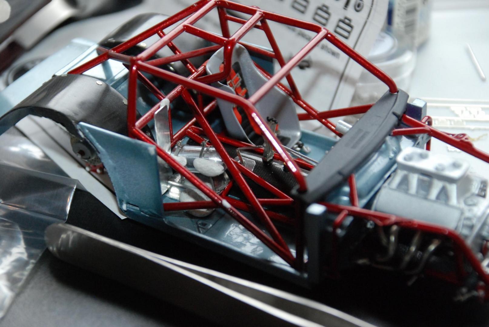

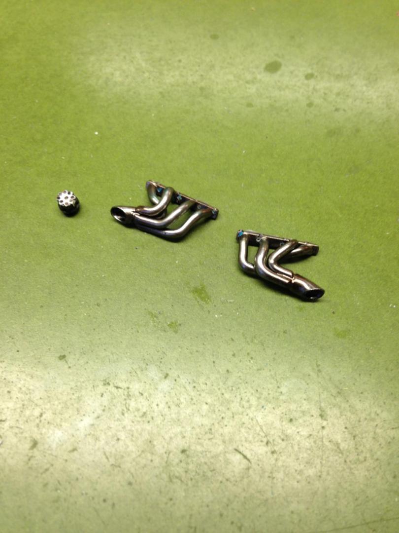

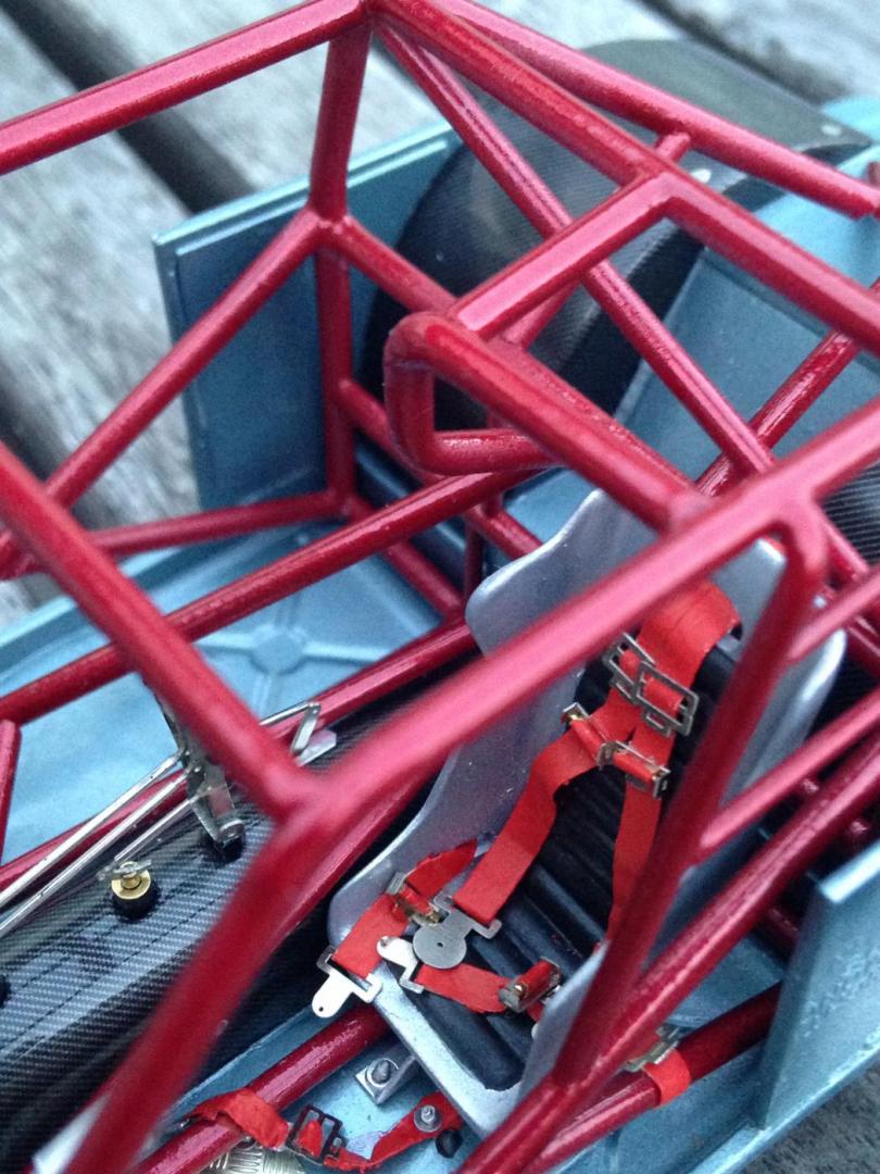

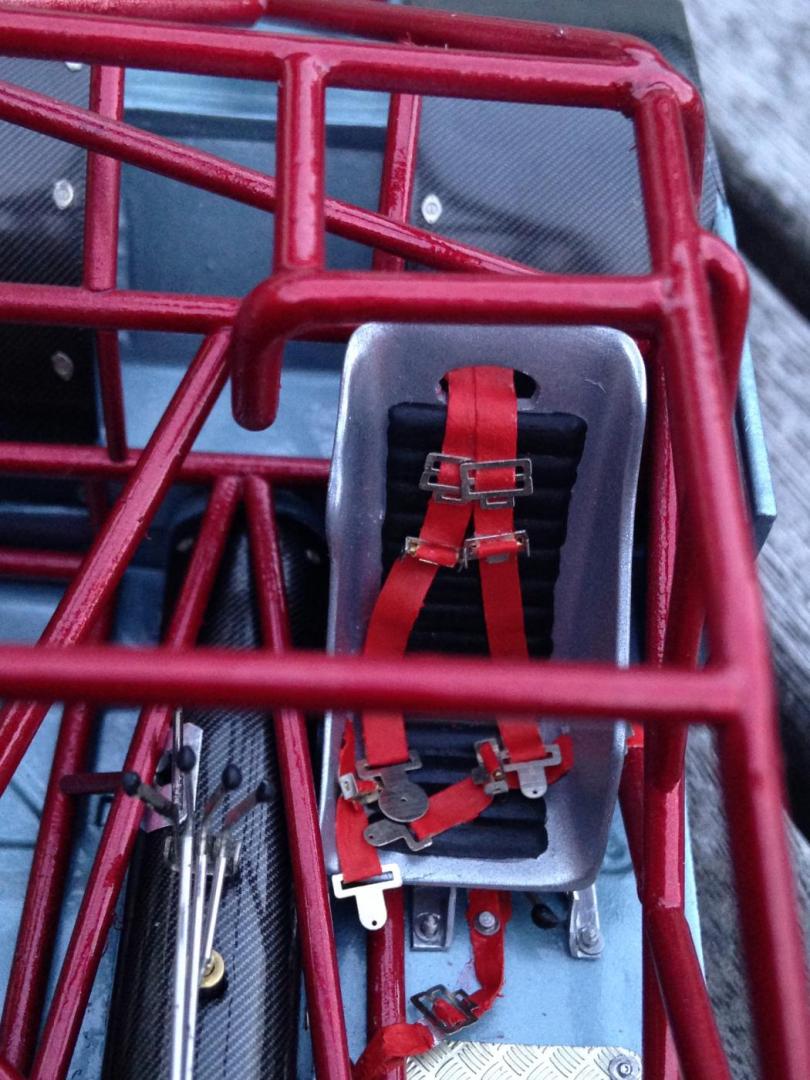

LeadFred Posted August 21, 2016 Author Share Posted August 21, 2016 Dan,Thank you, glad you like the Datsun project. Anyhow, I have a good picture of the headers after the assembly that I forgot to show the last. Ok , back to the interior construction. Building belts can be difficult to get to a natural "hang". . They may not see to stiff out, then it takes away the realistic feeling,i think. Seat belt hardware comes from the Model Car Garage .... I think ??? I'm not sure. And the belt is made of Tamiay masking tape . The belts are brush -painted with Humbrol paint. Here are the belts mounted in their brackets and the seat from the Firebird kit that i have made holes in order to pull through the belts . I have also detailed the mounts for the seat with some boltheads and washers. The padding in the seat are the original pattern from the Firebird kit and i have brushpainted it. Next update will be about the nitro bottle and some electronic boxes. Opinions and comments are welcome.Opinions and comments are welcome.Opinions and comments are welcome. Quote Link to comment Share on other sites More sharing options...

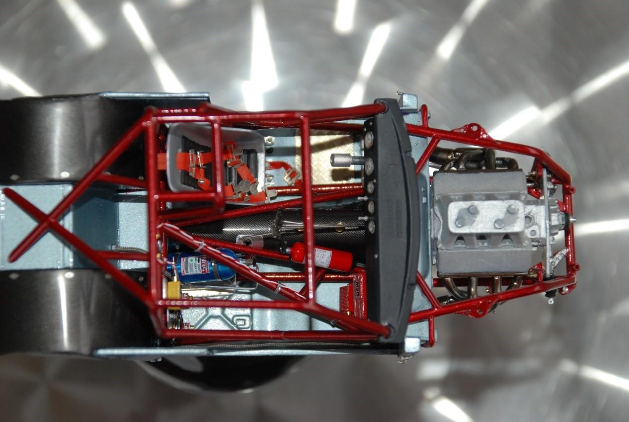

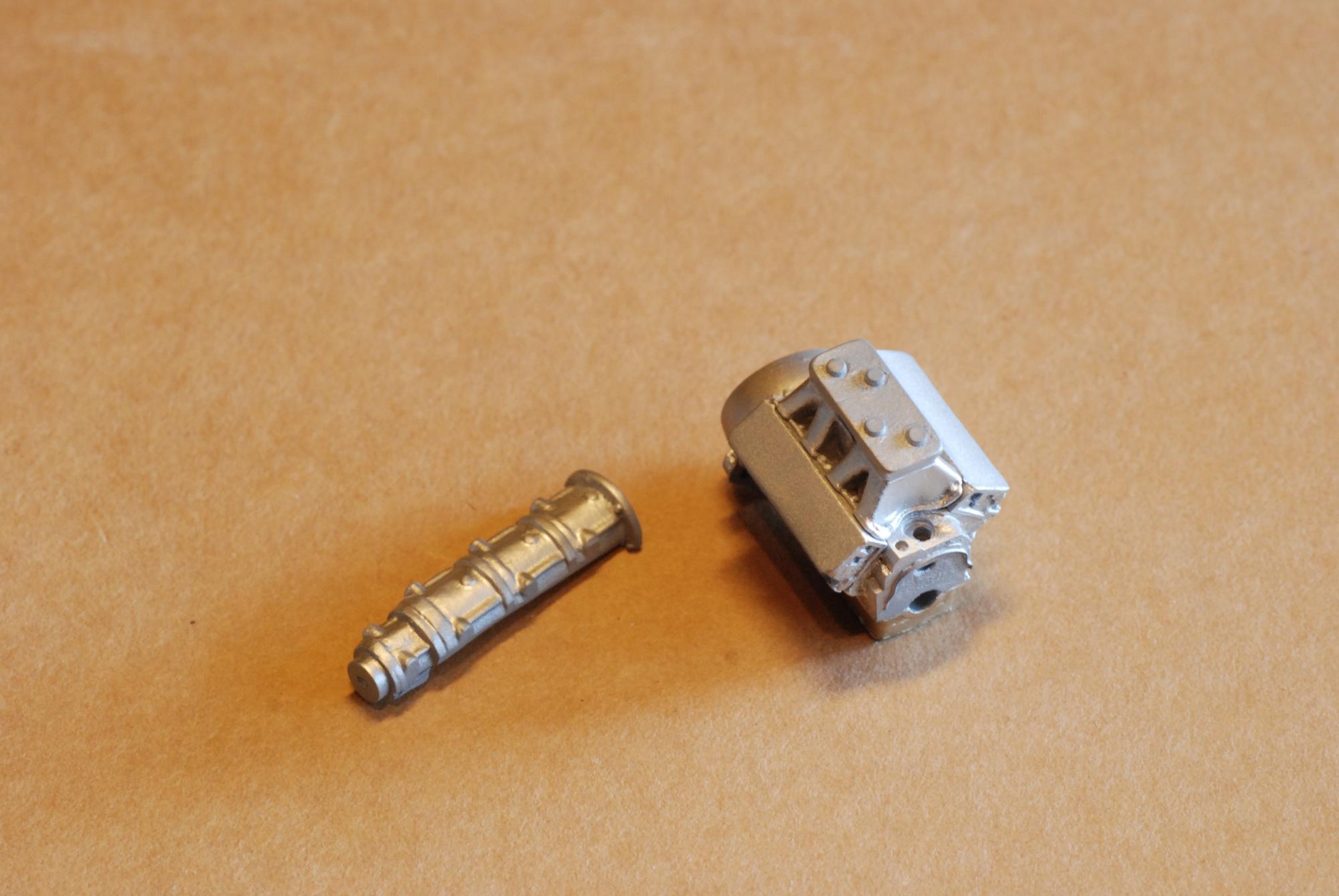

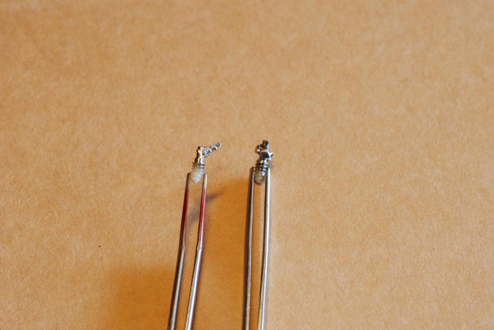

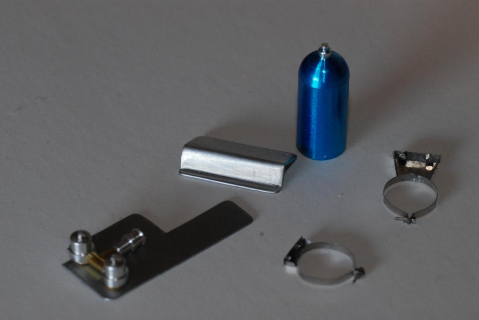

LeadFred Posted August 23, 2016 Author Share Posted August 23, 2016 (edited) John,Dave, thanks for your kind words. I have some pictures of the Nitro bottle. First you see when i have mocked-up the bottle with the mounting hardware and the aluminum plate that i will mount in the cage, it is only mocked-up with adeshive clay just to secure that is going to fit. second picture shows the Nitrobottle painted in clear blue, and i have also made two pumps on my lathe that i will connect the fuel system and the nitro bottle with. I will after this put on some decals on the bottle and the pumps and the install and glue it in place,and detail it alittle bit more. to be countinued. Fred Edited August 23, 2016 by LeadFred Quote Link to comment Share on other sites More sharing options...

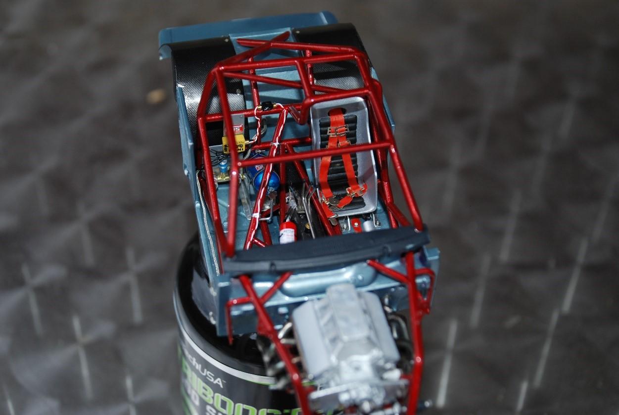

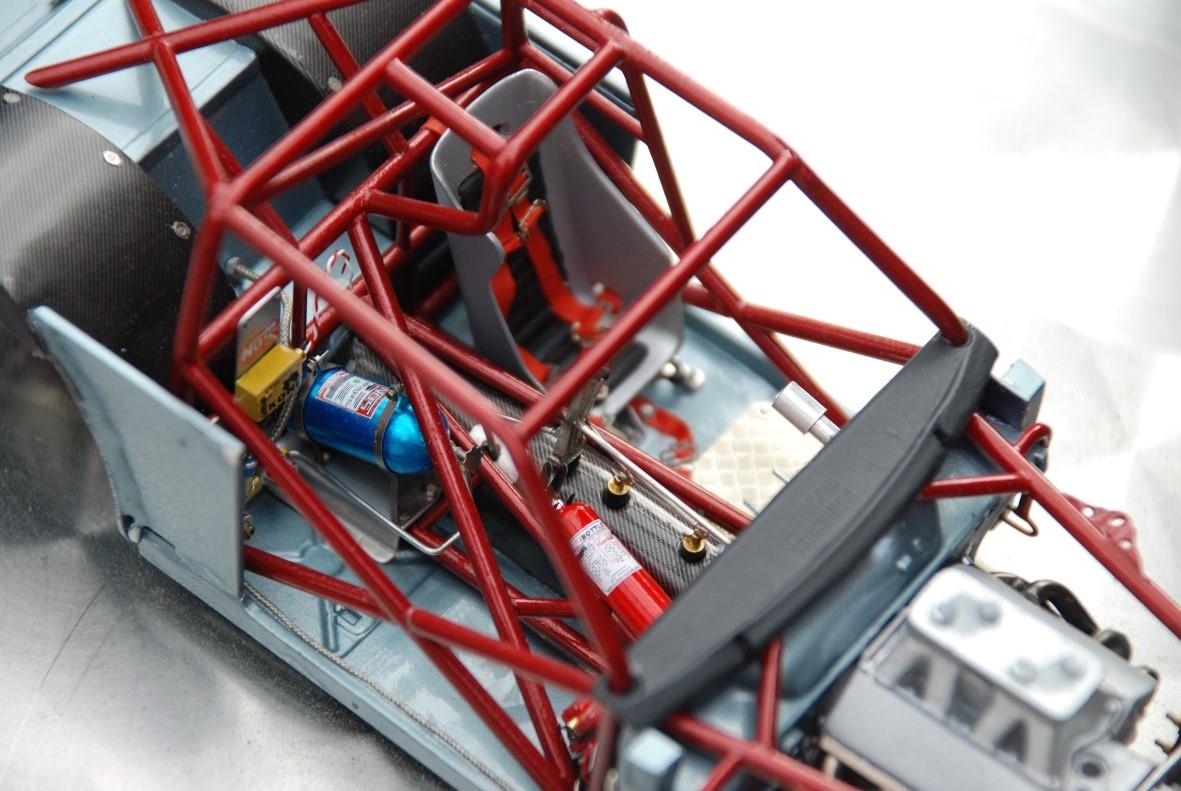

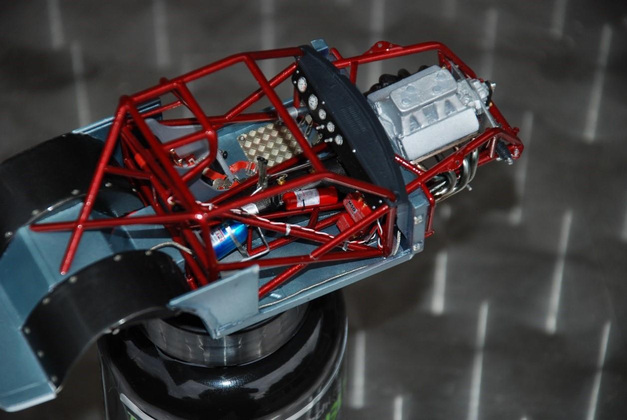

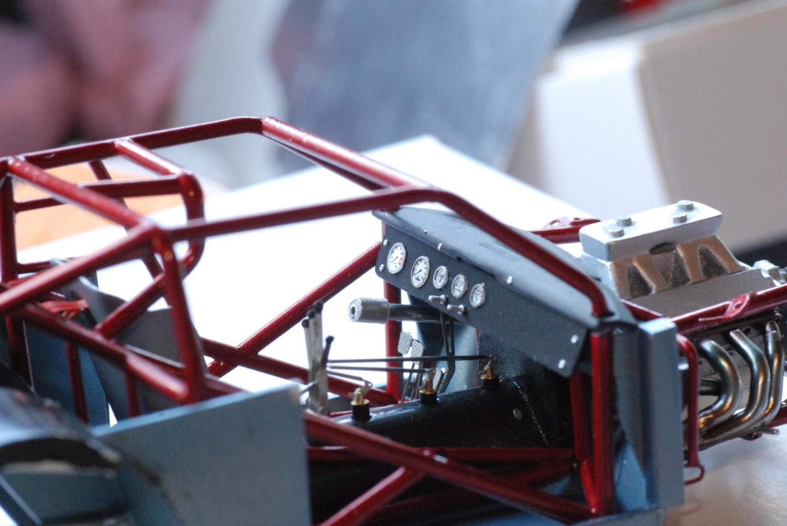

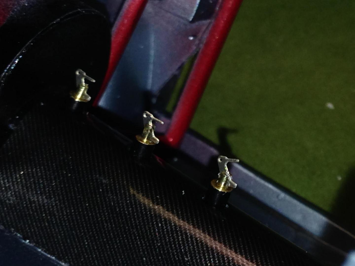

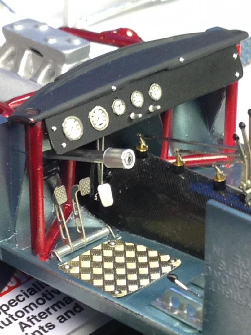

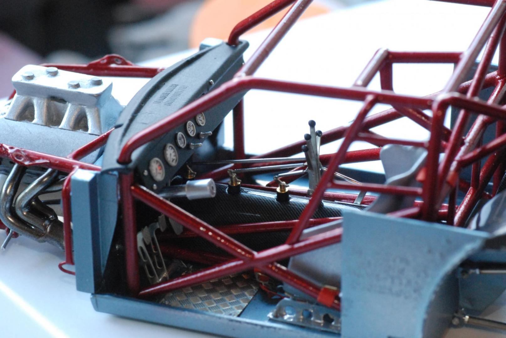

LeadFred Posted August 26, 2016 Author Share Posted August 26, 2016 Paul,Rob, thanks for your support. I have finished building interior nitro assembly and even mounted some electronic boxes on plates mounted inside the interior.Even a fire extinguisher that is made of aluminum painted red with a decal and some photo etch detail. Finally, the devices were also wired. OK , this is the interior, the steeringwheel assembly will be at a later time,because the doors are opened so i can mount it later. So the next move on this build is to paint and mount the body on this chassi/interior. I have already begin with the body,but i will polish the clear coated body and do some more tests and sorted out some photos. So you have to hold on with these interior photos for now. Hope you like it so far.... Happy modeling , Fred Quote Link to comment Share on other sites More sharing options...
