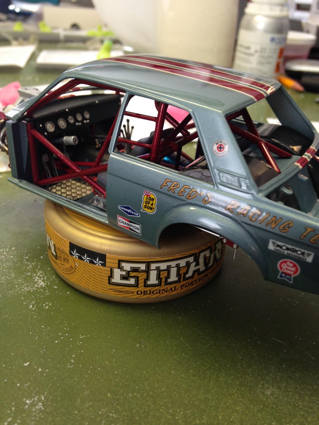

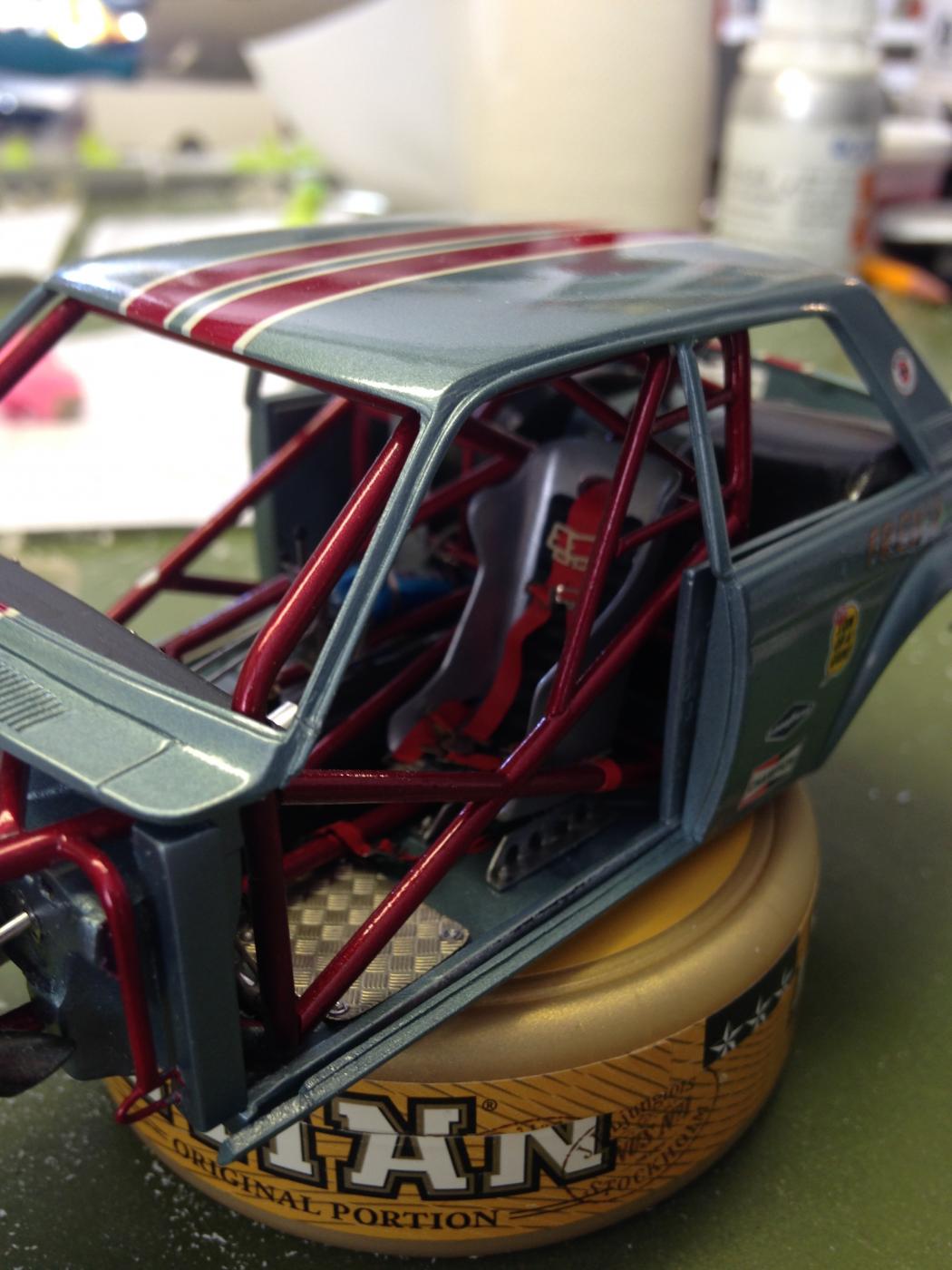

LeadFred Posted September 4, 2016 Author Share Posted September 4, 2016 (edited) Hi guys, Thanks you for comments,Leonard,John and Edgar. No one has a proposal in which class this car can fit into ? , Anyway, we'll go ahead with some new pictures of the painting and assembly of the bodywork. The first picture shows the primed body,tamiya white fine surface primer is used. The taillights lenses are masked off so i still have them clear. Here is the body painted and also decaled and the red stripe with the thin white line over the hole body is painted. it is also one layer of clear over the body, only for decals should stay in good condition. As you can see , the surface is a little rough so far, but after a little sanding between clearcote layers as you build up a nice and smooth varnish that ultimately did not need much polishing , because the paint is already very smooth . I have done a impression from a uncut body and making a support/stand for the body,that i will polish now. This is a must,because the body is so fragile when it is cut open like this,and when you do the polish and want to rub up the shine you have to rub a little harder and the body would just get broken if it does not have the support. Edited September 5, 2016 by LeadFred Quote Link to comment Share on other sites More sharing options...
LeadFred Posted September 4, 2016 Author Share Posted September 4, 2016 (edited) Here you see the uncut body that i use for the impression. Now,i can polish the fragile body,without worry to broke anything. I do not want to sand to deep on the first layer of gloss as you see, Here you see the third layer if gloss and it is sanded down to a smooth flat finish, Here is the final layer (4) of gloss, a little bit moore polish,just little,and the finish is ok. Edited September 5, 2016 by LeadFred Quote Link to comment Share on other sites More sharing options...

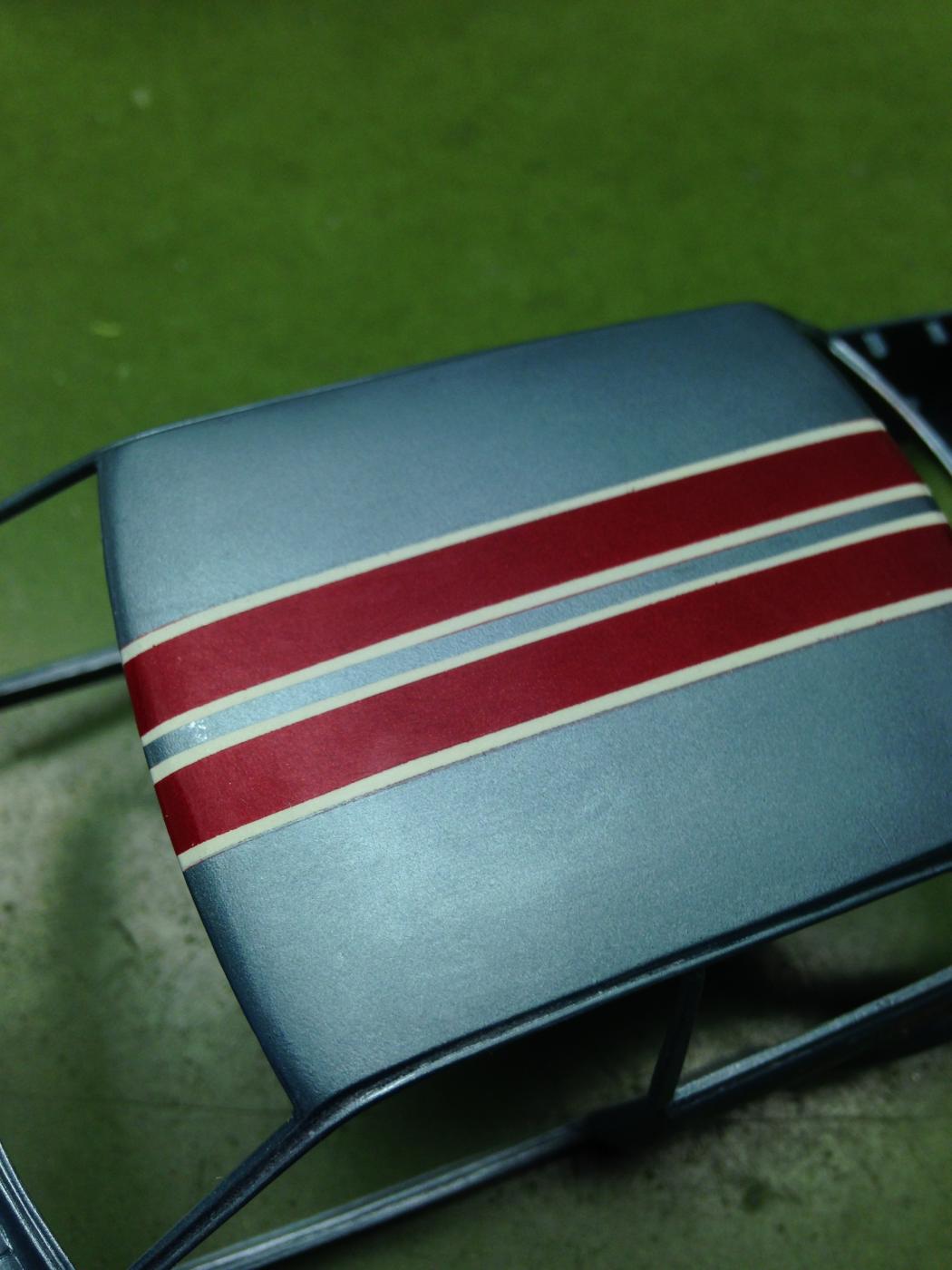

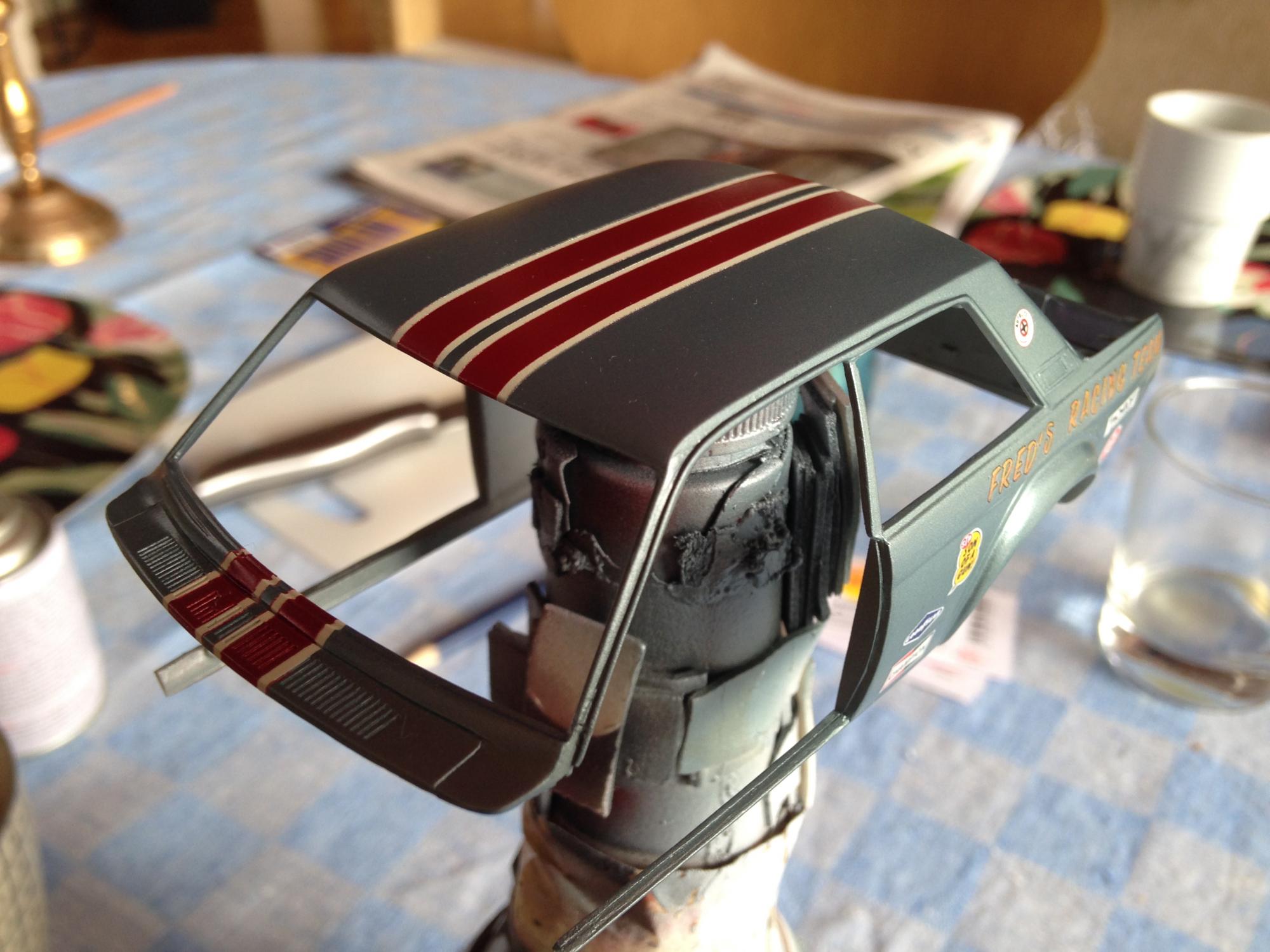

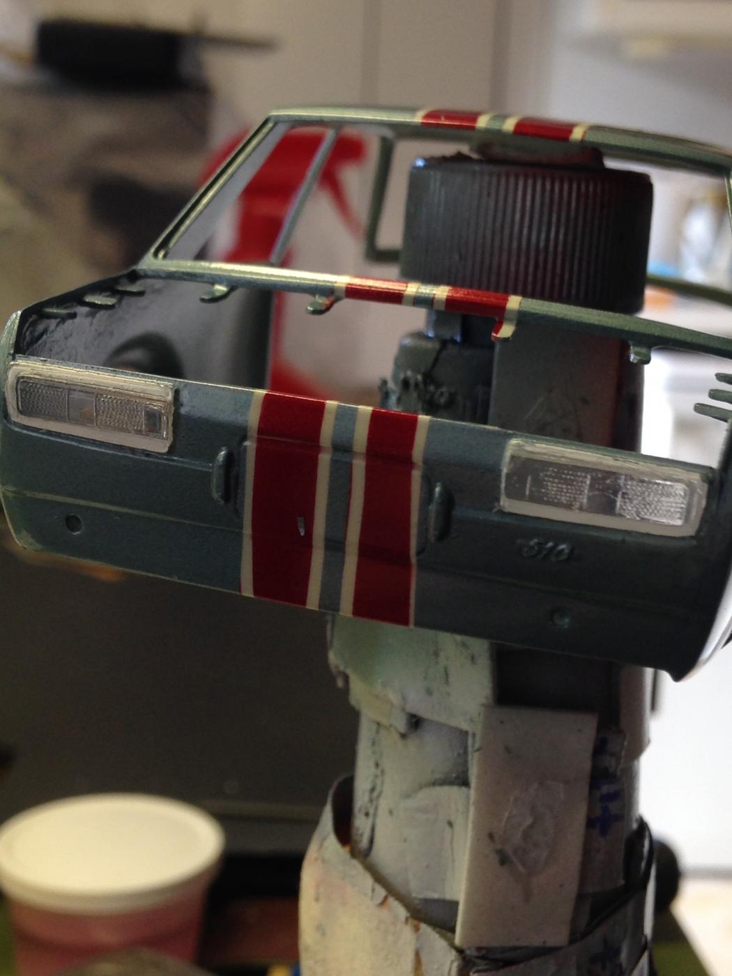

LeadFred Posted September 4, 2016 Author Share Posted September 4, 2016 (edited) Some more pictures when the body is on the chassi. One thing about this body is that it was not symmetric , and I discovered it too late, so I pulled out the stripes from the roof position , so they came not in the middle of the rear panel , so that's why it is a compromise of the stripes on the rearpanel.. But fortunately, there will be more details that will focus later in the build, so this will probably be pretty good in the end. You can see that the right stripe is a little bit thinner than the left side Some test fits on the chassi. Ok guys, this is it,for the moment, strange that i have to do 3 updates to get all photos upploaded that i want do show you, Comments are welcome, Fred. Edited September 4, 2016 by LeadFred Quote Link to comment Share on other sites More sharing options...

LeadFred Posted September 4, 2016 Author Share Posted September 4, 2016 Thank you Bill. The picture of the rearpanel was a very close-up picture,but i can show you another picture,and if you think that there will be mountings for a parachute that will take some focus from the spotlight,perhaps the stripe does´nt make such a big notice,If so.......i will put some decals over it. Hope this is a picture that is more "natural" of the rear panel. Fred Quote Link to comment Share on other sites More sharing options...
MrObsessive Posted September 4, 2016 Share Posted September 4, 2016 From that pic I don't see much difference at all. If you're going to put the parachute mounting brackets and such over that, I really wouldn't sweat it! We can be our own worse critics sometimes! Quote Link to comment Share on other sites More sharing options...
vintagedragcrazy Posted September 5, 2016 Share Posted September 5, 2016 That looks awsome when it's done it's going to be a show stopper and bills right you can barely notice it in fact if you would not have said anything I doubt anyone would. I would just camo it with a decal or the chute mount and not worry about it!vince Quote Link to comment Share on other sites More sharing options...

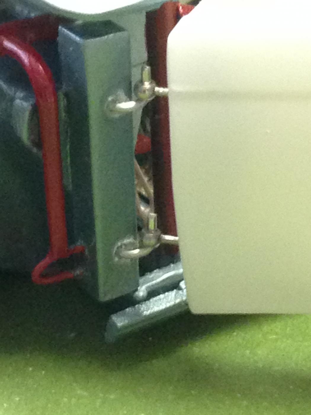

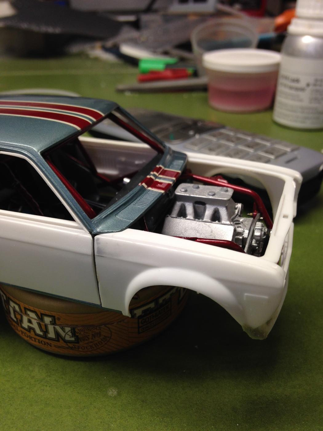

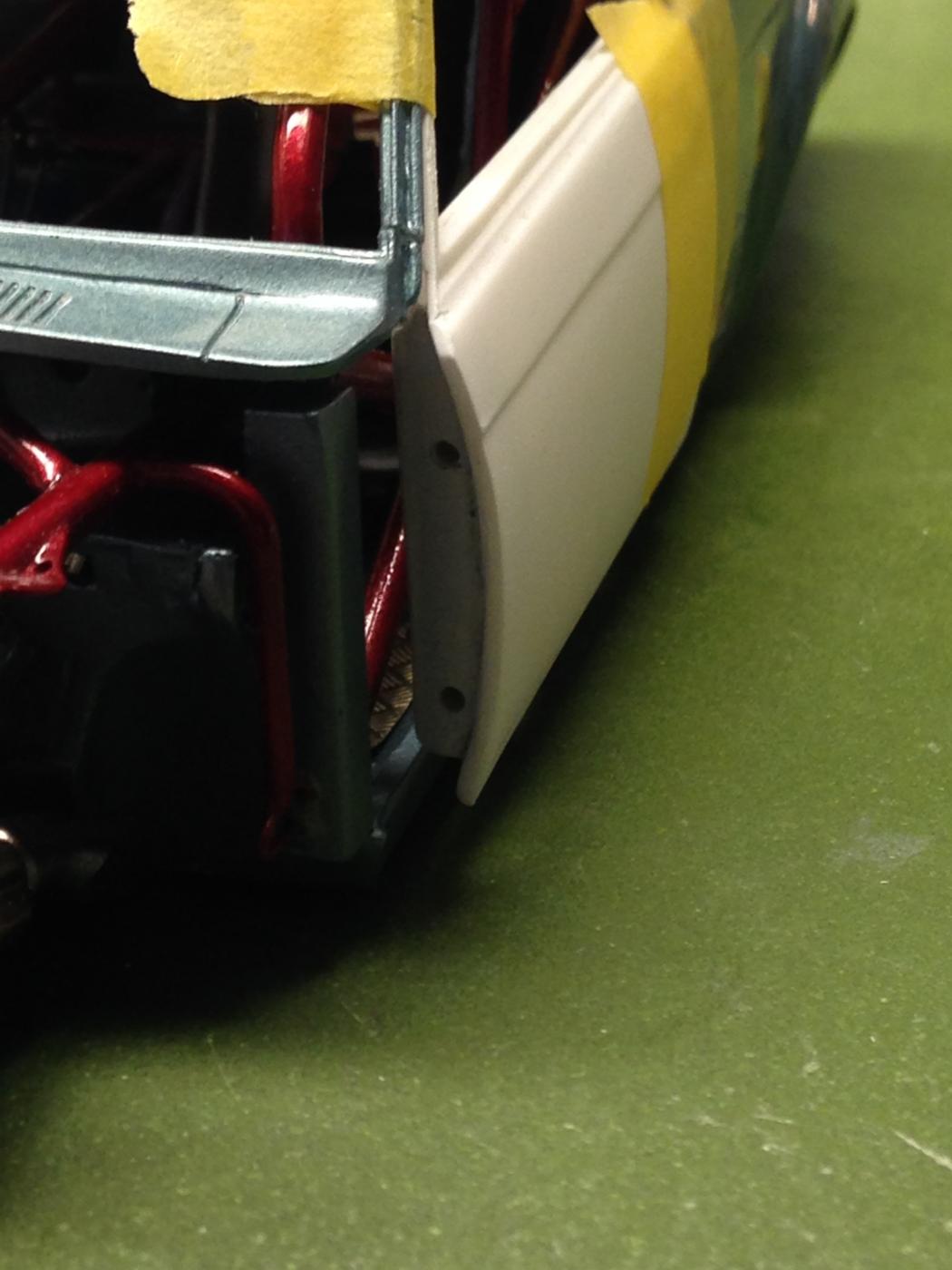

LeadFred Posted September 13, 2016 Author Share Posted September 13, 2016 (edited) Hi again all of you, and thanks for comments,Bill,Vince,Carl,Kerry,Walter,John,Dan ! When the body is glued/fixed to the chassie the assembly of the doors and front begins. It was quite difficult to get the doors in place, while they should be placed nicely in the closed position and at the same time be opened. Anyway, so I installed some hinge made of metal pins and then I 'll catch on rod ends , which I then assemble in the door. I made a little larger hole in the door where the rod ends to be attached , just to bond with an epoxy adhesive. then I can only catch on rod ends onto the metal pin and ,,,then fit on the door and place the door closed in the body , and let the epoxy glue harden. This way, everything is in the correct position,Open or closed . Here i testfit the door. The holes in the door are there. The Metalpins glued in place. I have used a soft metal pin, so i can adjust the hinge if i need. Sorry for the bad picture,but you can see that the rod ends are mounted in the door and it all work. From another angle. The front are just mocked up to see that it will fit. Next move will be to paint the doors and front in the same color,and i will use the same diluted paint and, exactly the same pressure when i do this painting as the earlier painting,that is very important when you paint a metallic paint in more stages than once. Just because you can easily get a shade of difference if you are unlucky. Normally, i spray the entire body at the same time. but i knew that i would have to do it over again after fitting the doors and front. Paint rubbed off easily when you have to use your fingers on the panels . Comments are welcome, Fred Edited September 13, 2016 by LeadFred Quote Link to comment Share on other sites More sharing options...

John Clutch Posted September 13, 2016 Share Posted September 13, 2016 Looks fantastic. Now with the fenders/hood in place, you can see just how much space that motor takes. What are you gonna do for a radiator? Quote Link to comment Share on other sites More sharing options...
John Clutch Posted September 13, 2016 Share Posted September 13, 2016 Im building a 1/12 Camaro to X275 class specs. It will be a single turbo set up, with the turbo being placed in the center, right behind the front spoiler. So I will make two independent cooling systems for each side of the engine. In through the cylinder head, out through the block. That could be a consideration for you also. Quote Link to comment Share on other sites More sharing options...
LeadFred Posted September 13, 2016 Author Share Posted September 13, 2016 Thank you, Dave and John.-John, i have to build a small scratch build radiator. I have already done the mounting for the radiator in the front of the Tubeframe. One of the most tricky mounting of this build is just to mount the radiator. Because i have very limited space left between the engine and the front/grille. If i place the radiator too near the grille, it Will push out the front and it Will be to much space between the Doors and fenders. So i guess i Will sweat a lot to get it right.One of My goal, When i Cut up a body like this is that the body should Look realistic in both closed and Open Doors/panels. It would be easier if i had took a Bigger car/body.so this is a challenge for me.My plan in the future is also to build the 1/12 Camaro in a drag version.but i have not found Any great rear slicks in 1/12. I have never before build a big scale model,but thinking a lot to " Do it". If i find Any slicks .?Fred Quote Link to comment Share on other sites More sharing options...
