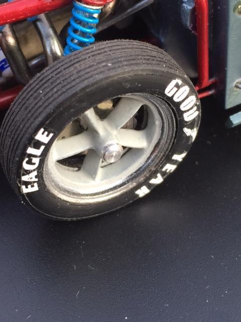

LeadFred Posted September 15, 2016 Author Share Posted September 15, 2016 And here are some more pictures. Quote Link to comment Share on other sites More sharing options...
LeadFred Posted September 15, 2016 Author Share Posted September 15, 2016 So ...guys, I will be posting some more pictures later when the parts are mounted. Comments are welcome. Fred Quote Link to comment Share on other sites More sharing options...

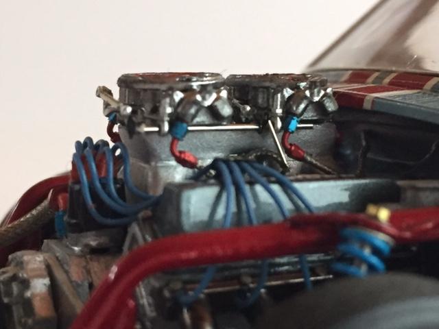

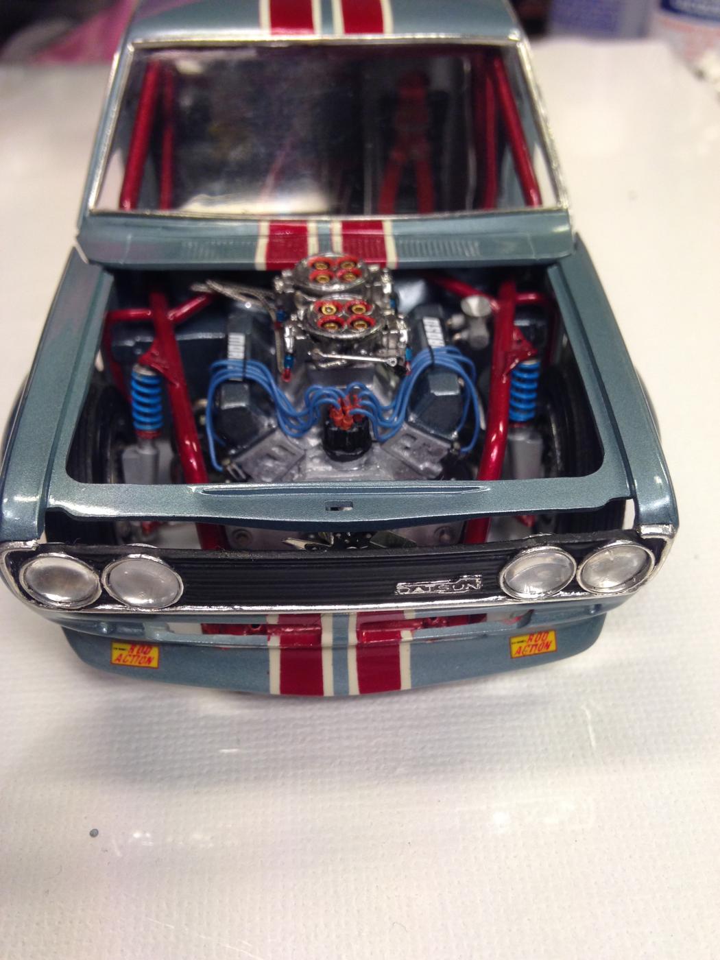

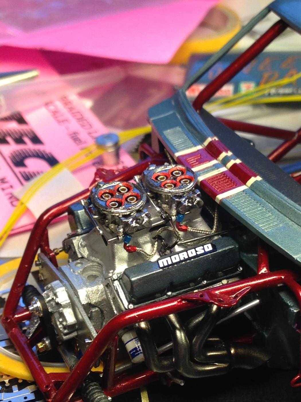

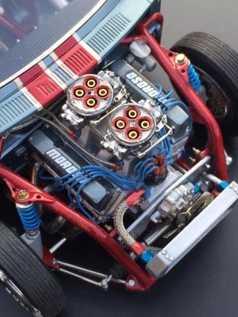

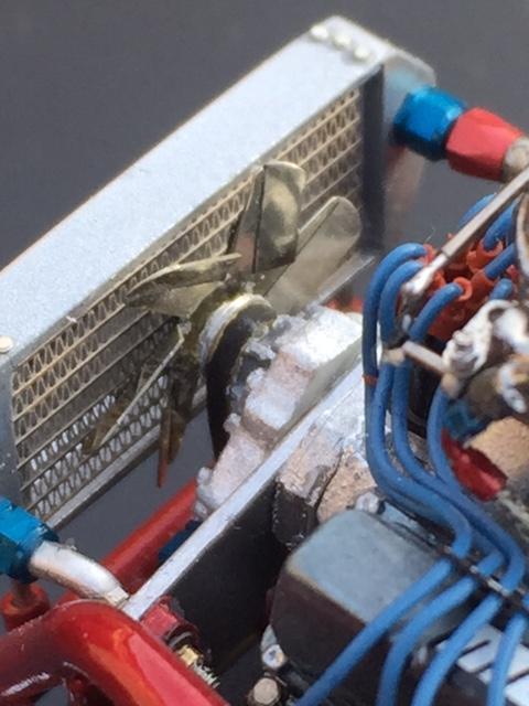

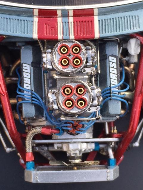

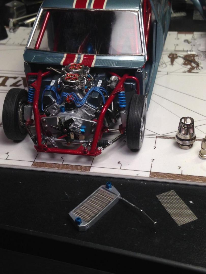

LeadFred Posted September 19, 2016 Author Share Posted September 19, 2016 (edited) Hello, Thank you Carl and Ray. I have some new pictures from the assembly of the engine. I have paint the valve covers in the same color as the body,and the put a decal on it. Mostly parts comes alive when you have paint,decals and some detail on it. When you test fit a unpainted plastic part on a started build it is difficult to see how it is gonna be, i´ll think the composition are getting better. The radiator are scratch built from evergreen,and a photoetched mesh,but i had to place it,i´ll think,ten times in different positions before i could get the front on as i wanted it. It was very tuff to get it right,because i have no space left in the engine room. Here you see the Carbs mounted with some fuel lines and linkage. also you can see the oilfilter that had get a decal on it. Here you see the sparkplug wiring and also a photo-etched fan with some boltheads on . And the front wheels are just mocked-up in this picture,just for the photo. You can also see the scratch built radiator with a needle in some mounting holes, The Front wheel is importend to have on the chassie when you working with the radiator fit,just to see that the body front sits in it right place when youre done. And Yes!!! here it is mounted. it dont looks so difficult when you look at it in these pictures,because it is only two pins that the radiator are mounted on from the chassis. But it was,very tricky to get it right,so i also could get the front on. This is from above. Here is the front struts and wheels mounted/fixed. Guys, I hope you enjoy the pictures,and to next time. Happy modelling. Questions and comments are always welcome. Fred Edited September 19, 2016 by LeadFred correct some spelling Quote Link to comment Share on other sites More sharing options...
Davewilly Posted September 19, 2016 Share Posted September 19, 2016 Man that looks fantastic! That's a lot to stuff in a small space and you have done a excellent job of doing it with it being just clutter. Quote Link to comment Share on other sites More sharing options...
John Clutch Posted September 19, 2016 Share Posted September 19, 2016 Fantastic planning LeadFred. You really did your homework on this one. Never in a million years did I think you could fit a belt driven fan in the engine bay with that engine. Cant wait to see the nose on it. Quote Link to comment Share on other sites More sharing options...

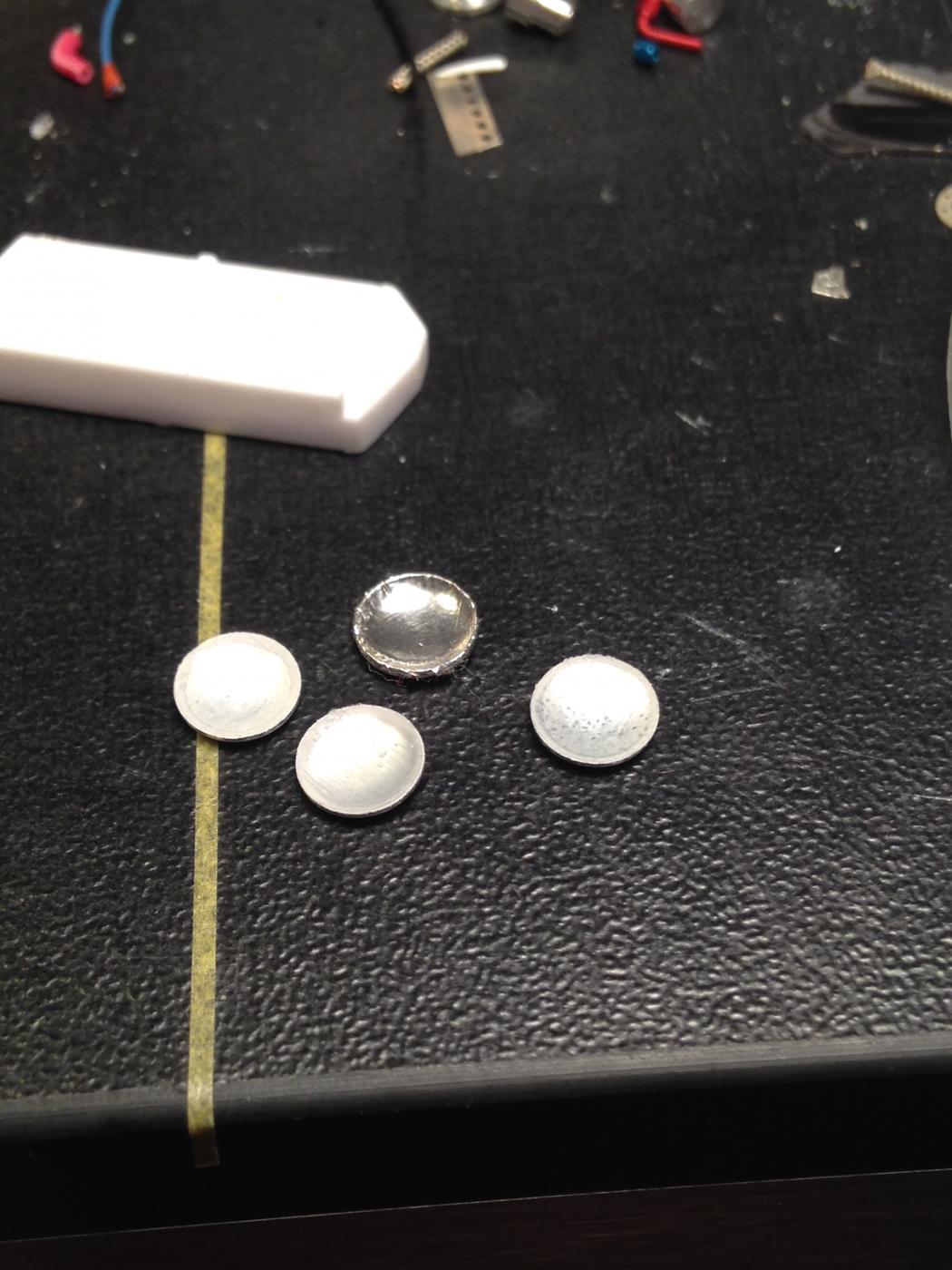

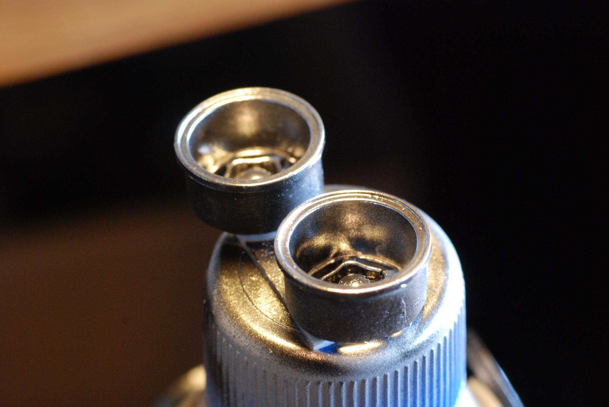

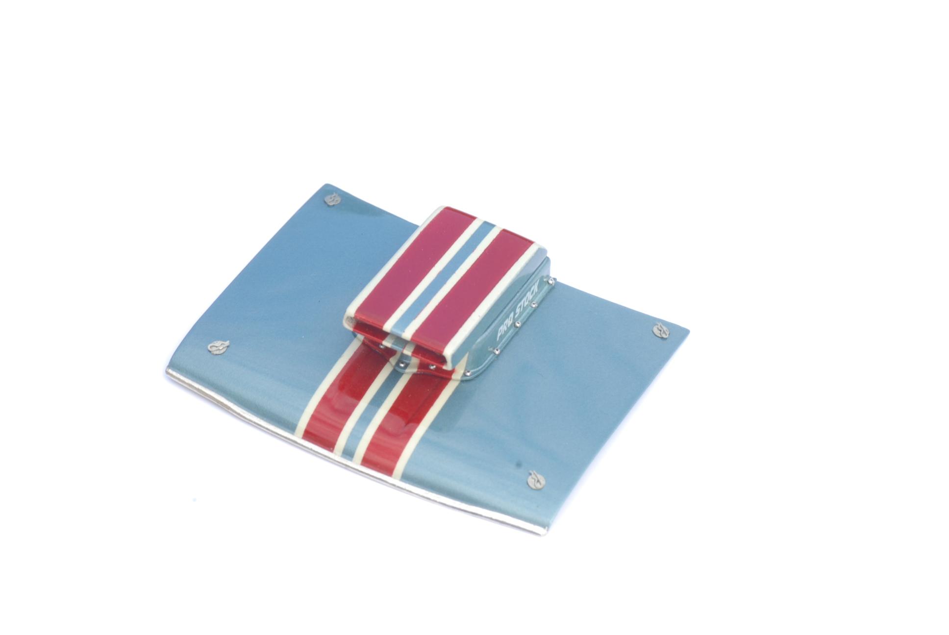

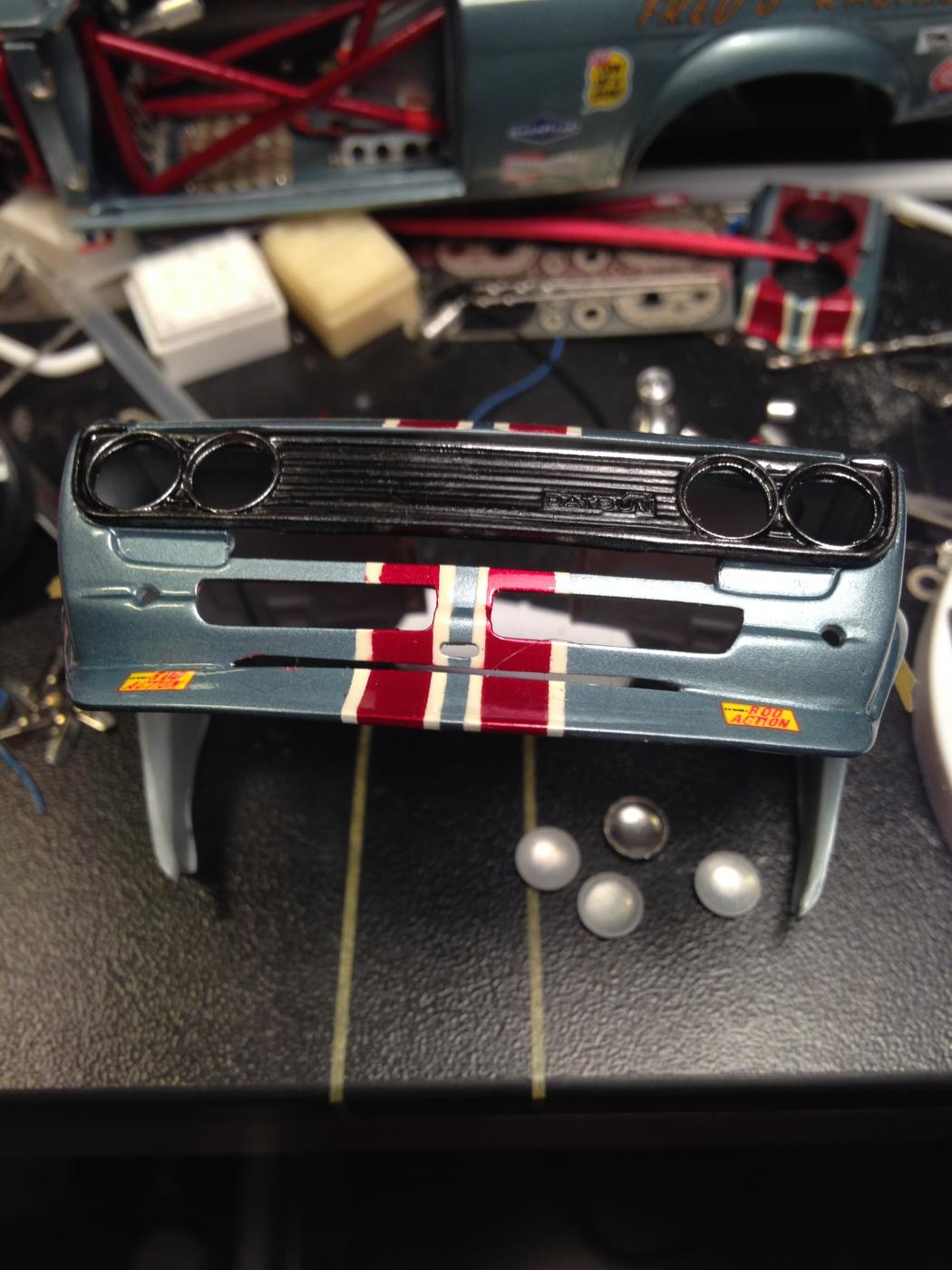

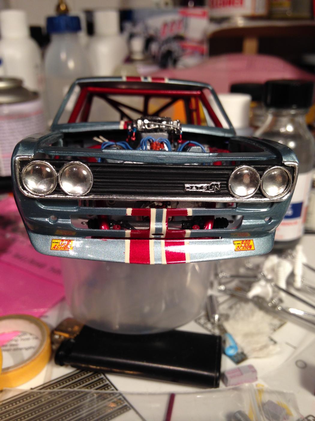

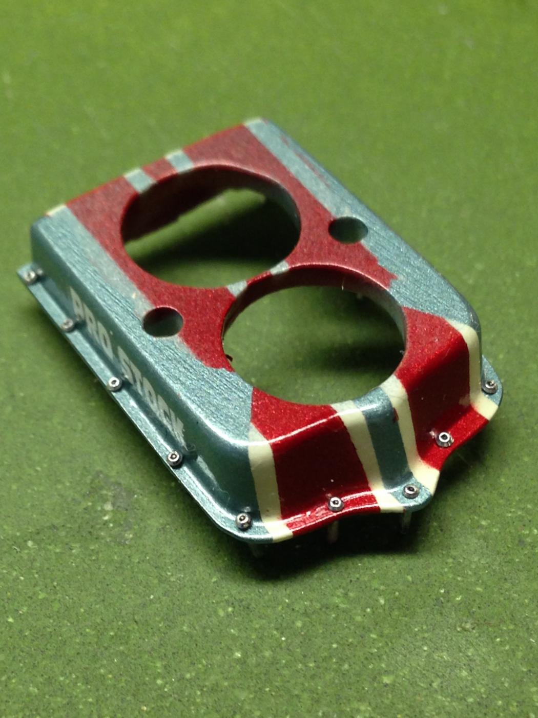

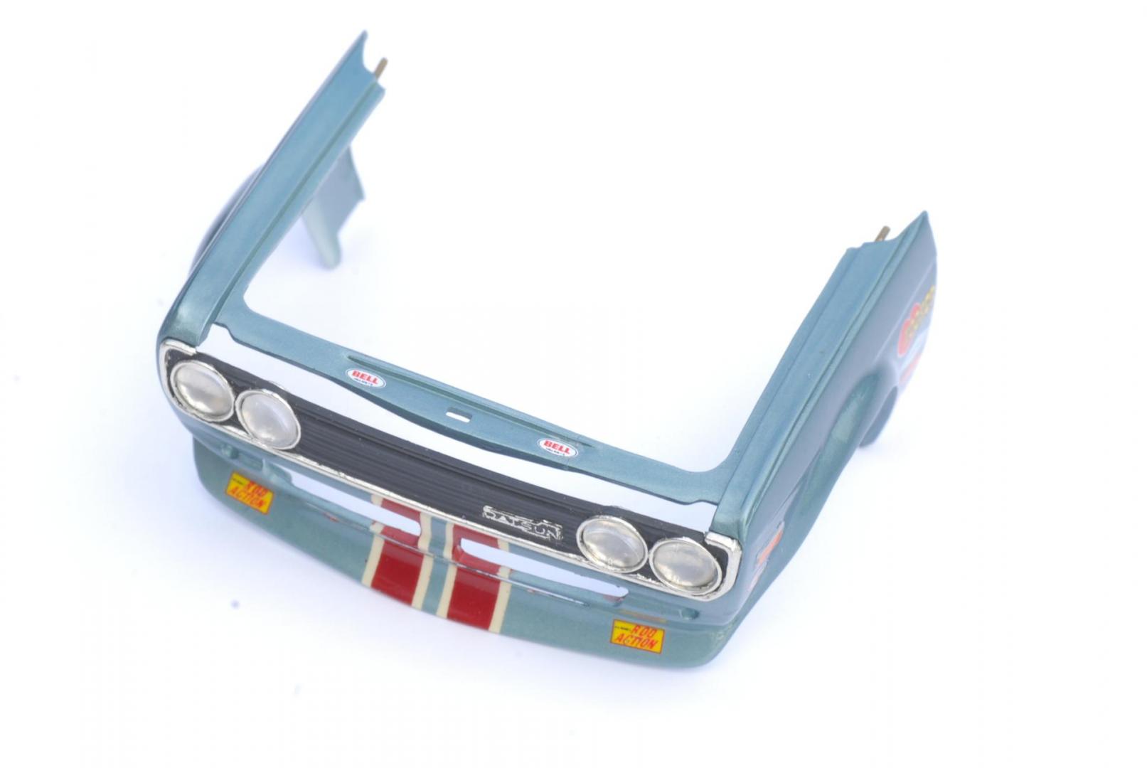

LeadFred Posted September 23, 2016 Author Share Posted September 23, 2016 Thank you Dave,and John. The front and grille has been been modified to get a better lights on it. I have drilled out the lamp reflectors ,but i will use the kits lenses. I Have used some rivets that i found in a hobby shop for artists,and the rivets are actually for clothes. But if you put some bare-metal in the concave side,you have a good reflector for the headlights. Here you see the result. Quote Link to comment Share on other sites More sharing options...
LeadFred Posted September 23, 2016 Author Share Posted September 23, 2016 Its getting closer to the final steps, i have the trunk and wheelie bar and the rear wheels left. Fred Quote Link to comment Share on other sites More sharing options...
LeadFred Posted September 23, 2016 Author Share Posted September 23, 2016 Sorry i forgot to uppload the picture of the complete hood. But here it is. Fred Quote Link to comment Share on other sites More sharing options...
Intmd8r Posted September 23, 2016 Share Posted September 23, 2016 Very impressive work. I own a couple of the Datsun 510 kits and know first hand that there is not alot of real estate space for all the goodies you crammed in there. It takes skill to make it look like it belongs and you pulled it off well. Job well done! Quote Link to comment Share on other sites More sharing options...

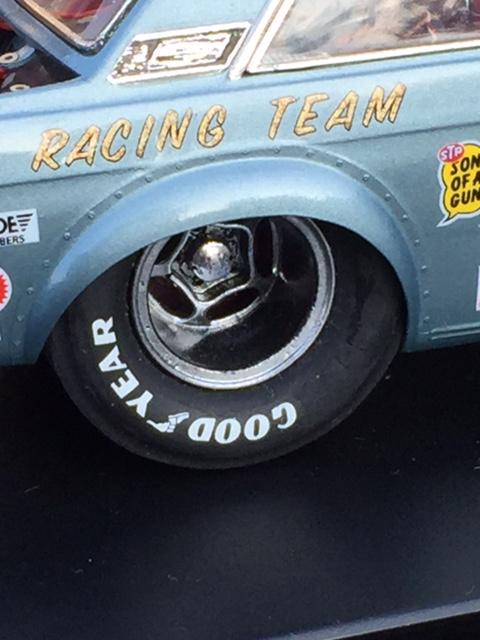

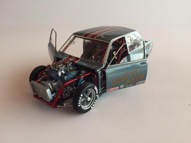

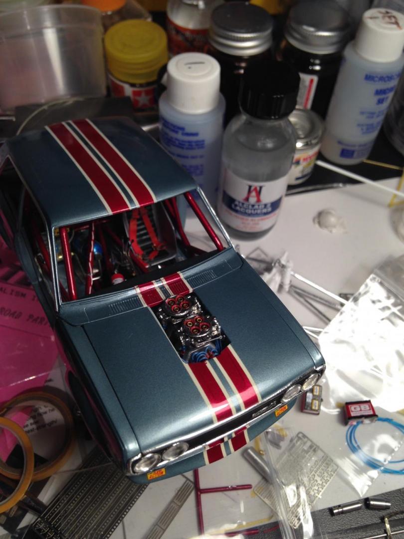

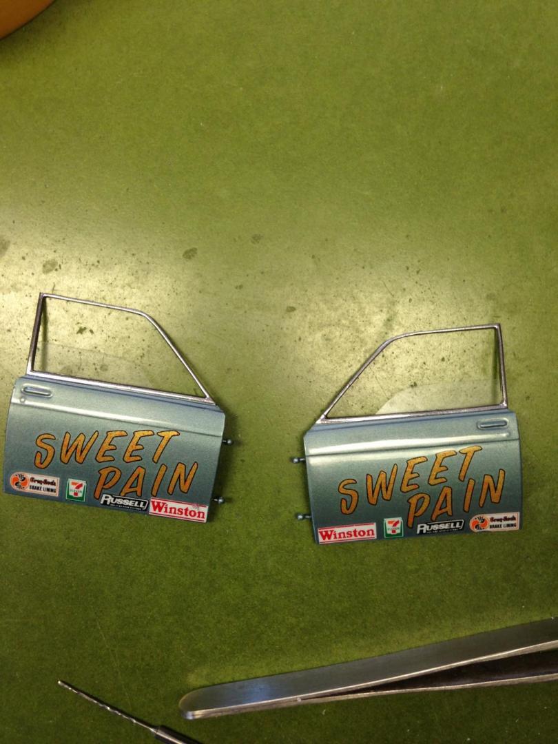

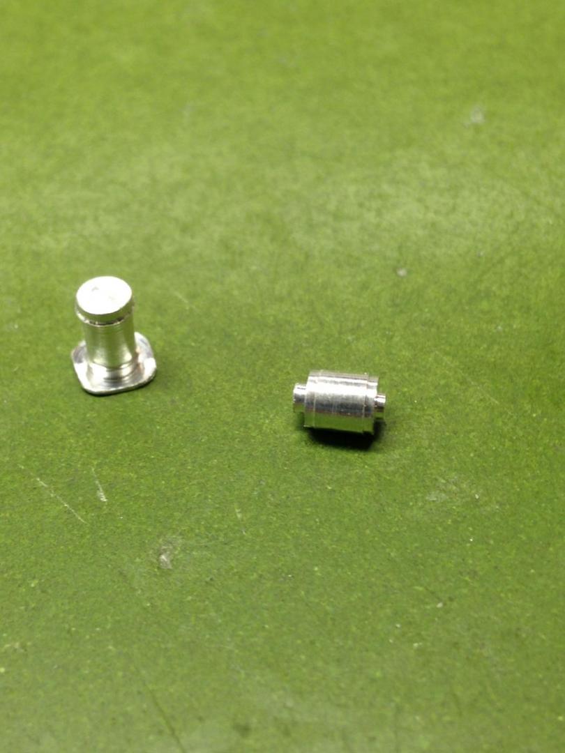

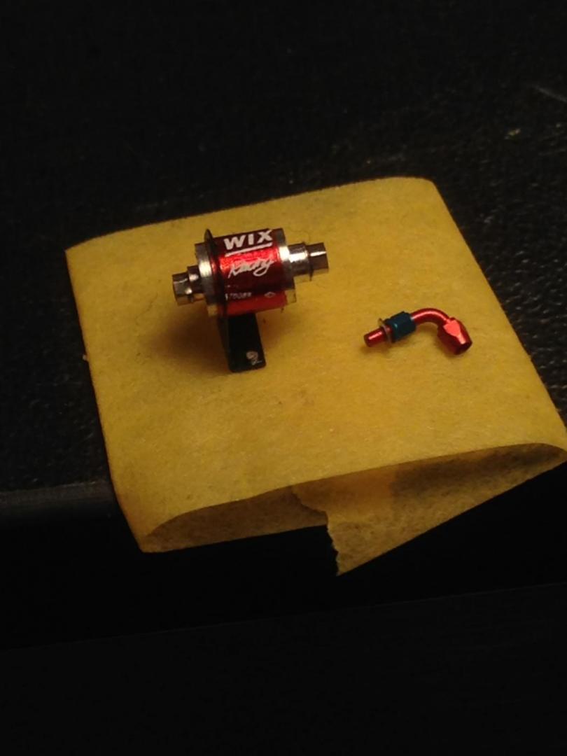

LeadFred Posted October 2, 2016 Author Share Posted October 2, 2016 Thanks Steve,for your comments,and yes,i could had done it more easy if i had choose a little bit bigger car. But the challenge was to do this contrast of "small and big" in the same composition. Time to update some pictures. This is the doors,as you could see,i have named the car "Sweet Pain",and that is a name that i will associate to this build. Because sometimes it was so tricky to get parts together,so i was almost giving up the build. BUT.... when the tricky parts was mounted,the fun and joy came back. I have paint the window frame on the doors with Alclad chrome, it was to fragile to do the bare metal foil. I have done also a fuel filter and a fuel pump on my lathe that will mount in the trunk area where the fuel cell will be mounted. With some paint and decals and some brackets and nuts the details will come alive. Quote Link to comment Share on other sites More sharing options...

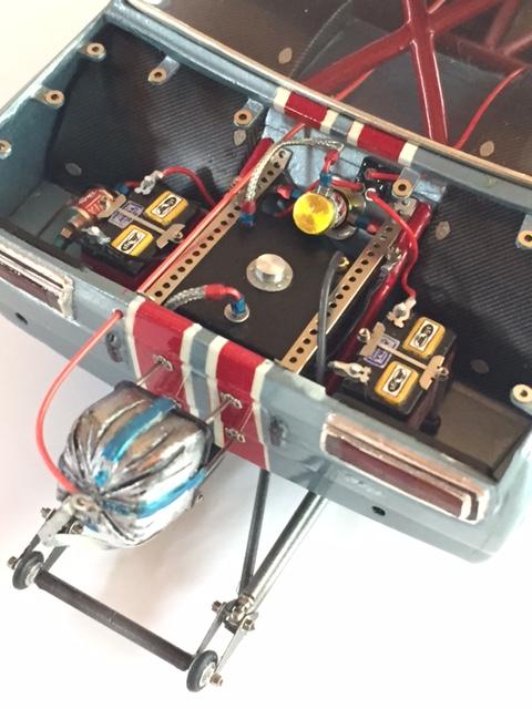

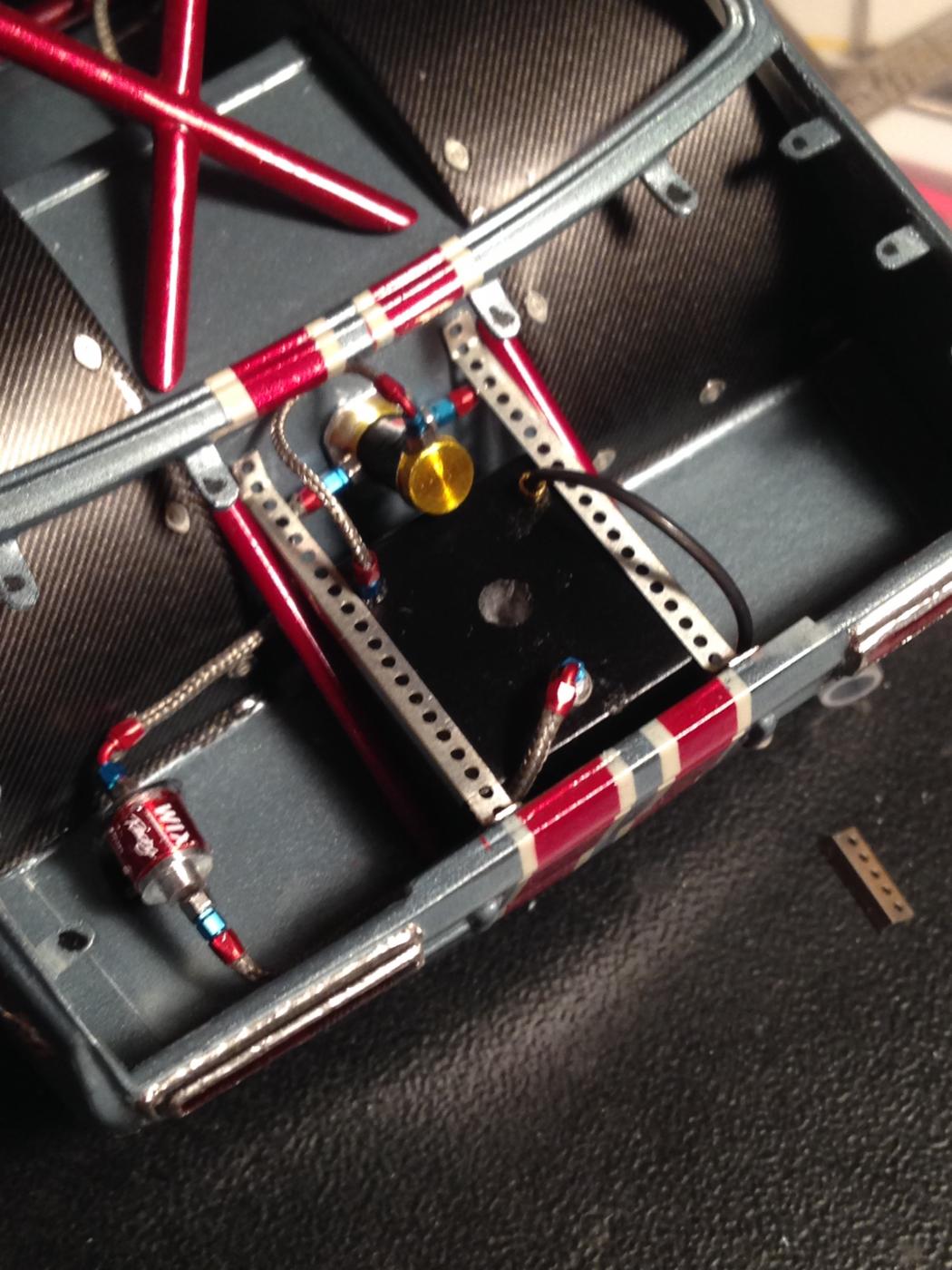

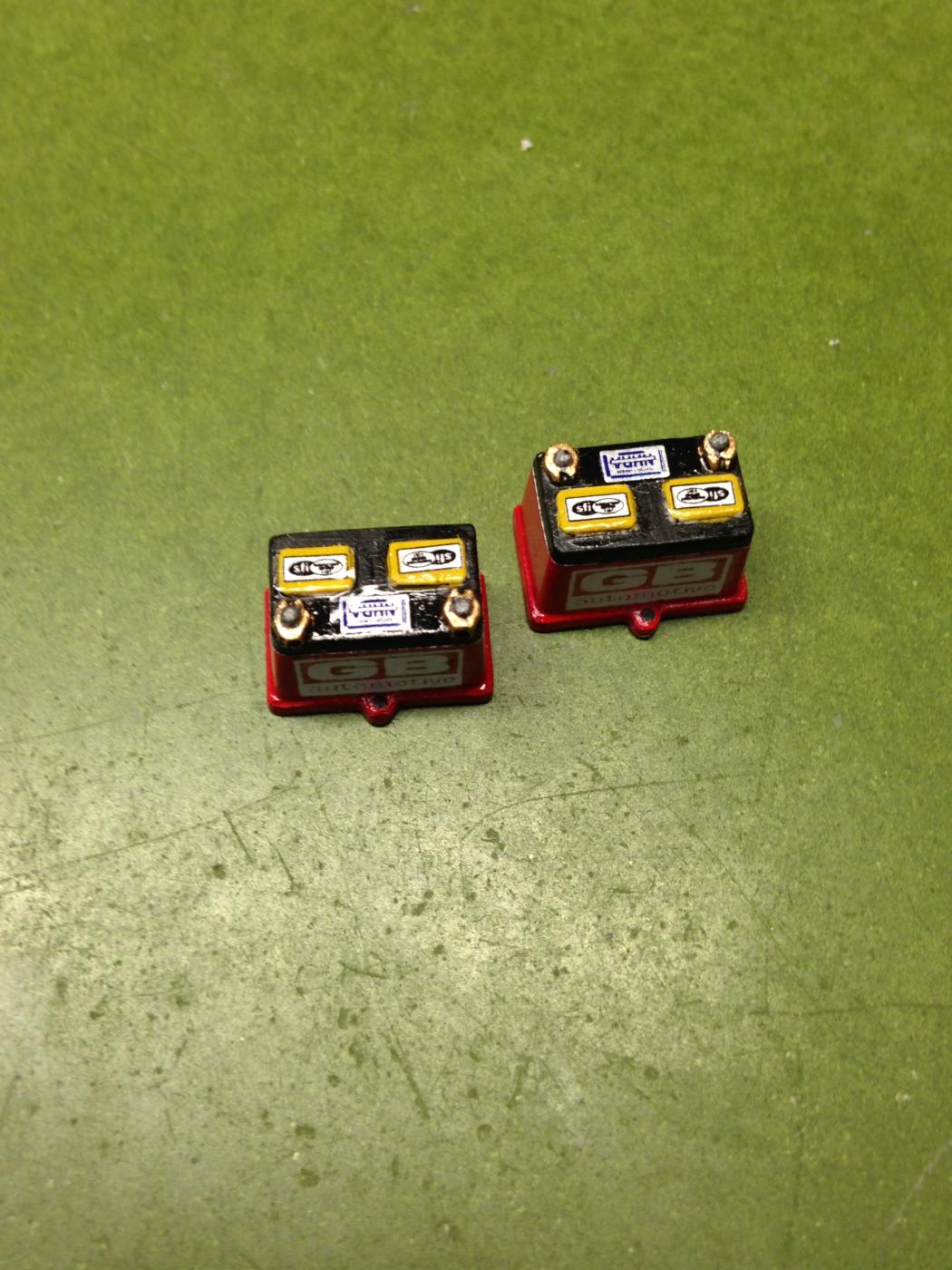

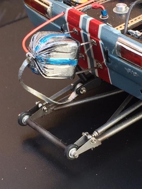

LeadFred Posted October 2, 2016 Author Share Posted October 2, 2016 (edited) This is the fuel cell mounted in the trunk,its scratched of a plastic piece and the fuelpump are painted and mounted. First i tried to mount the fuelpump on the bottom of the trunk,but the trunk area are so small with two batteries and a fuelcell,so this mounting was the only way,so not the trunk would see to much cluttered. i found some photo etch parts that i modified so they worked as mounting brackets for the fuel cell. I will also do a fuel cap on my lathe. The batteries are painted and decaled and will also be in the trunk, but i change the battery terminals after this photo was taken to metal pins and some photo etched details. You can also see the gloss clear on the battery,this is only for the attach of the decals.later i will do a satin finish on the battery. Comments are welcome. Fred Edited October 2, 2016 by LeadFred Quote Link to comment Share on other sites More sharing options...

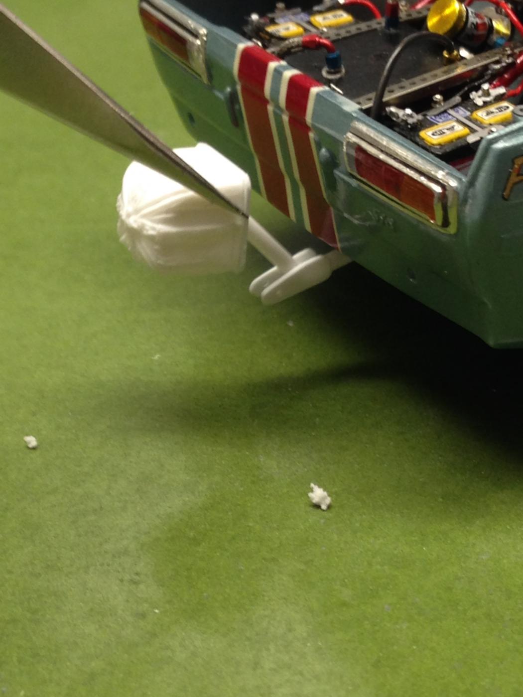

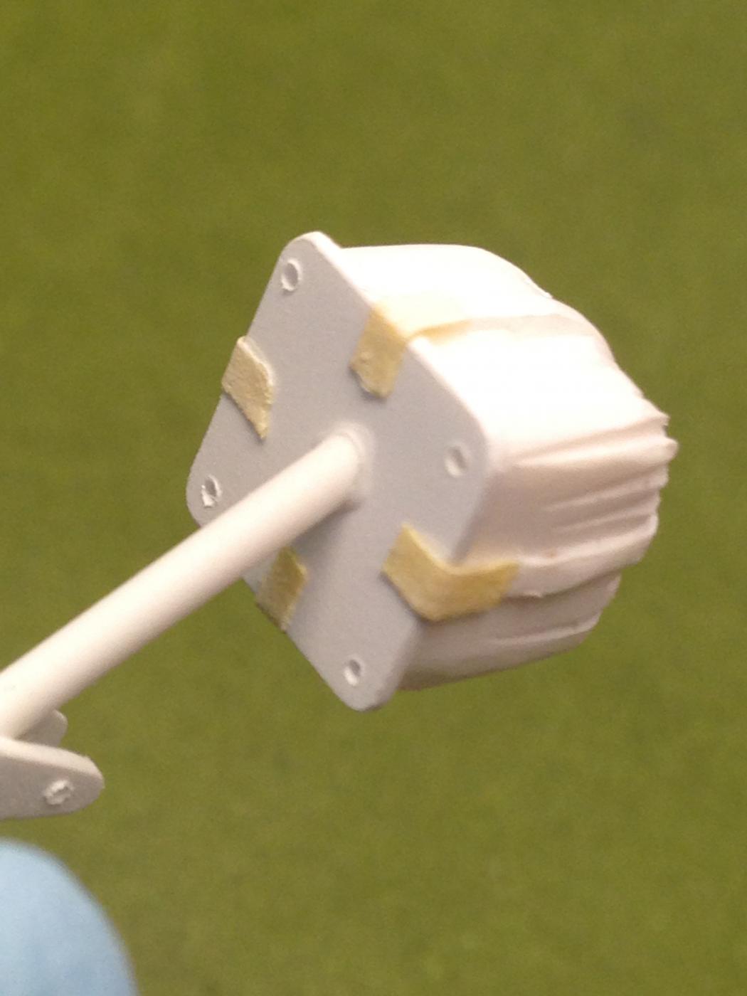

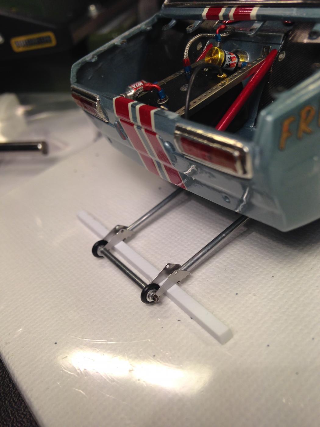

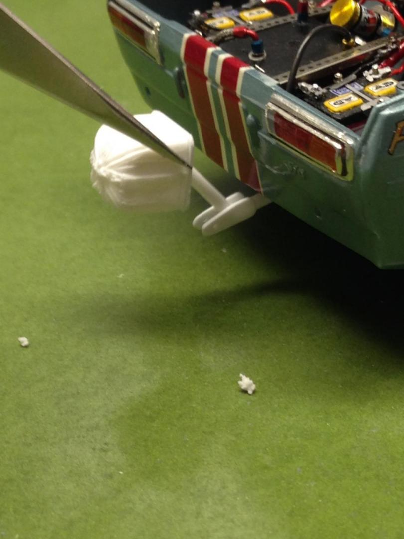

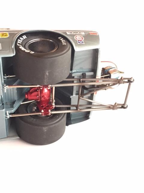

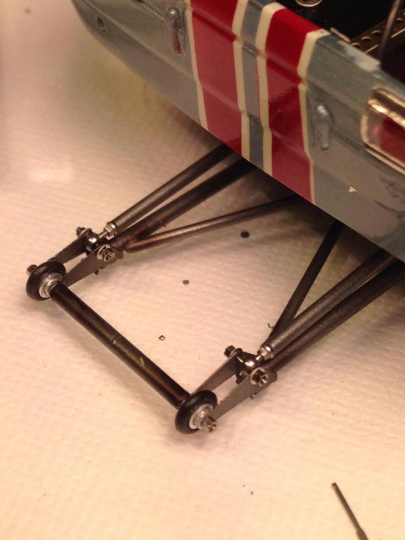

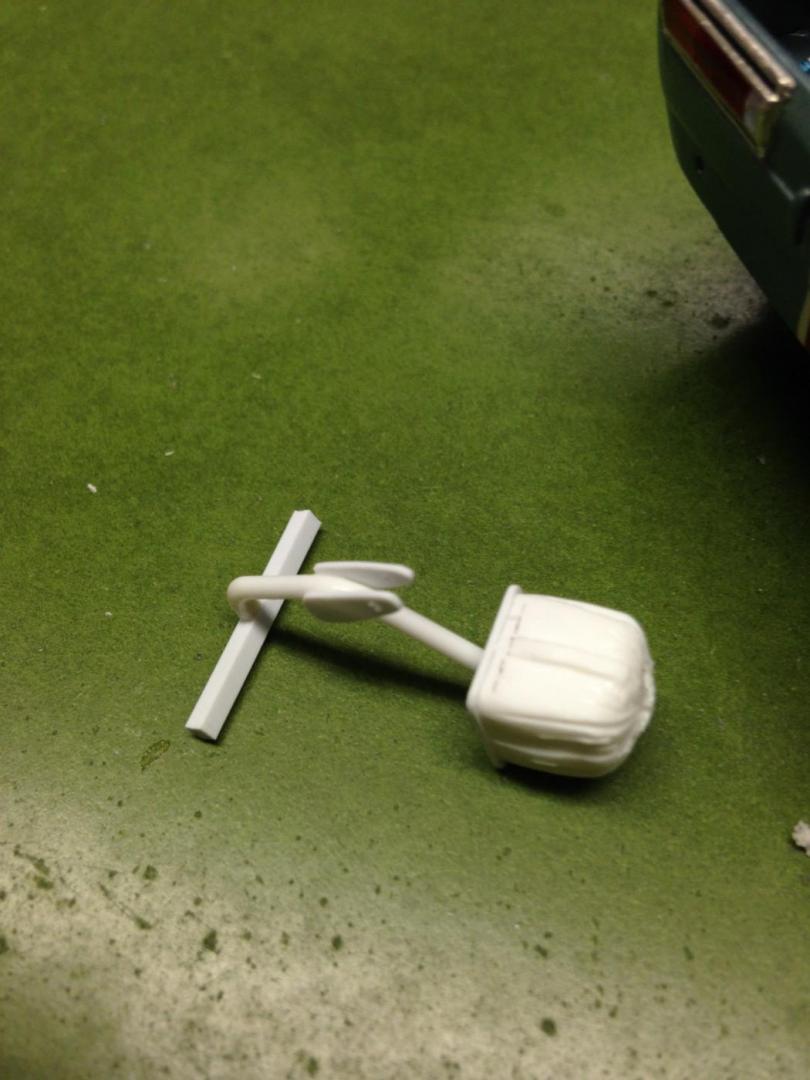

LeadFred Posted October 3, 2016 Author Share Posted October 3, 2016 (edited) Steve,Jesse,Ricky,Dave, Thank you so much for your kind words. The chute have a scratchbuilt mounting bracket that is mounted on the frame,but first i have to mount the rear wheels to see the correct height of the rear. Otherwise it will be difficult to get the correct height of the wheeliebar and also to get a nice angle on the chute bracket. I will be upploading some more pictures of the completed build soon and also a list of material and all brands that i have used. Anyway... here are some pictures of the rearwheel and the chute and the starting point of the wheeliebar. On this picture,you can see a little of the batteries in place with the photo etched detail,but i will uppload better pictures soon. Edited October 3, 2016 by LeadFred Quote Link to comment Share on other sites More sharing options...

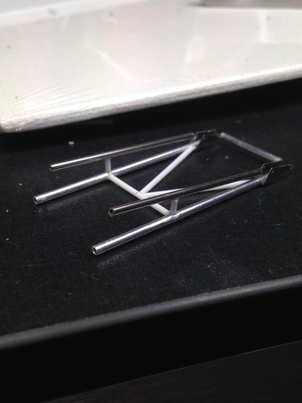

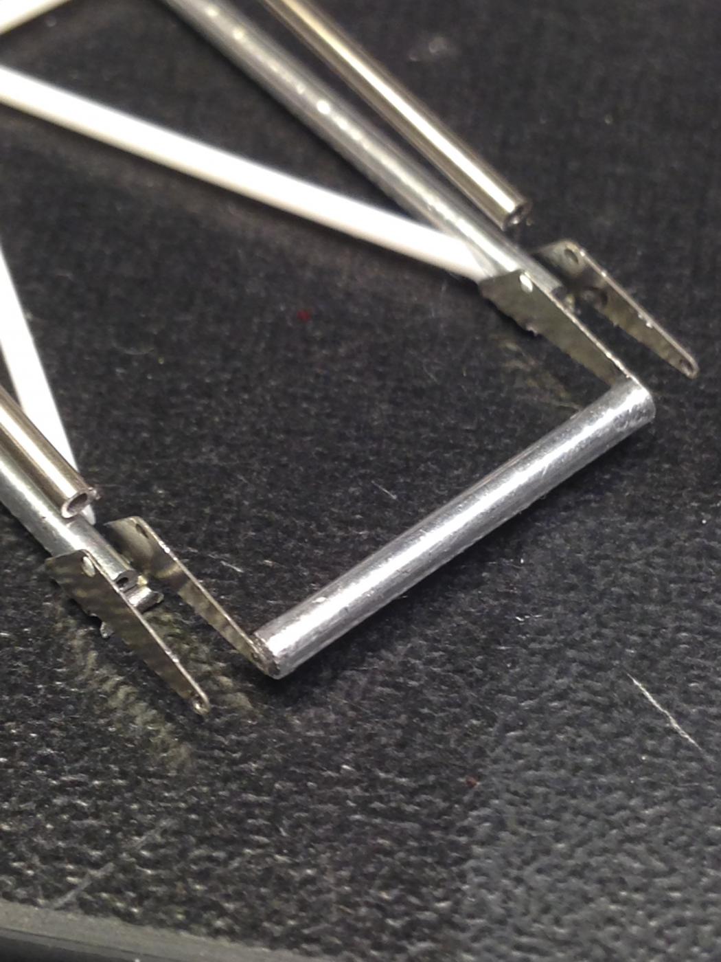

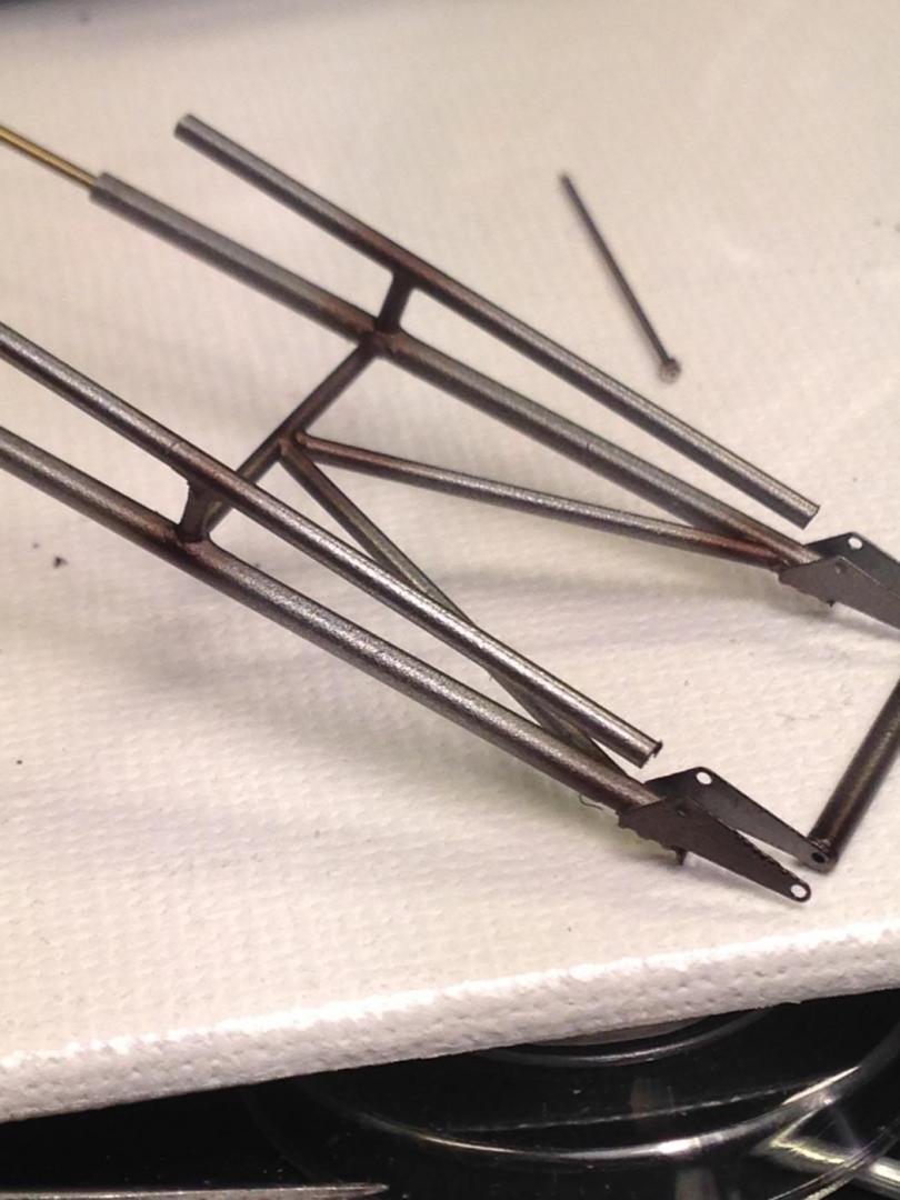

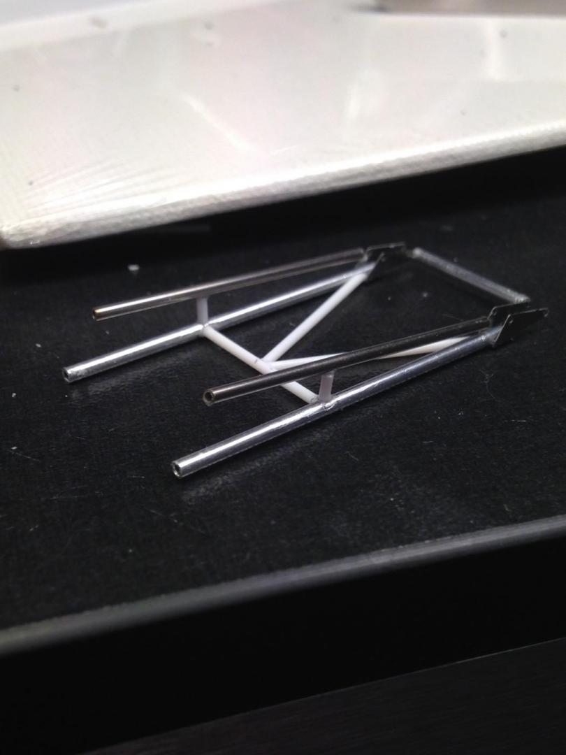

LeadFred Posted October 3, 2016 Author Share Posted October 3, 2016 (edited) Here is the wheeliebar and its made of both stainless tubing and plastic rods with photo-etched details. the tubing will be connected/attached to the rod ends in the 4-link plates. Finaly i will paint the wheeliebar as it was row unpainted steel. Comments are welcome. Fred Edited October 3, 2016 by LeadFred Quote Link to comment Share on other sites More sharing options...

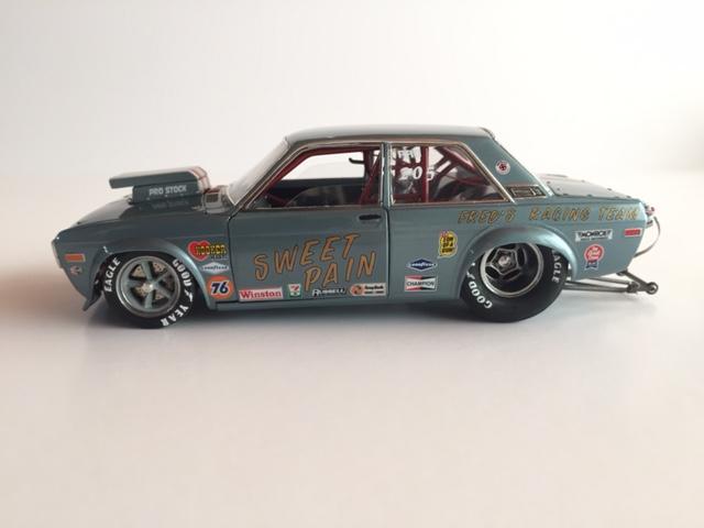

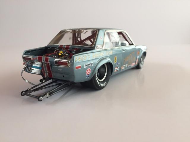

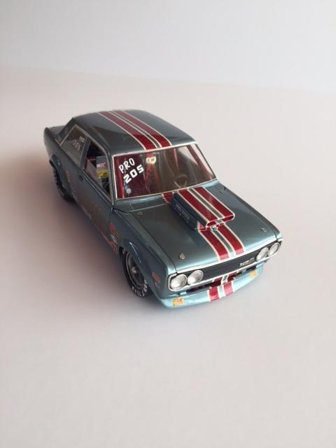

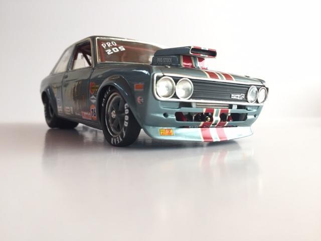

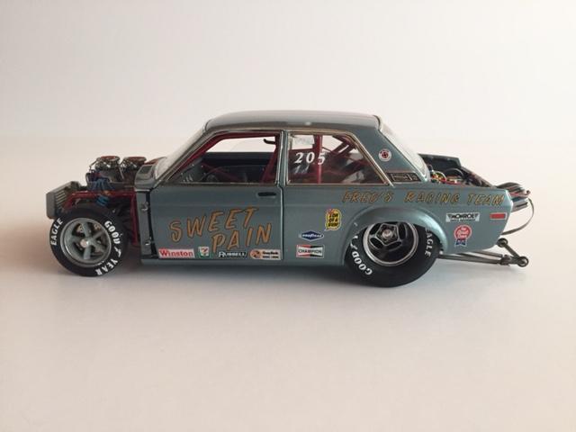

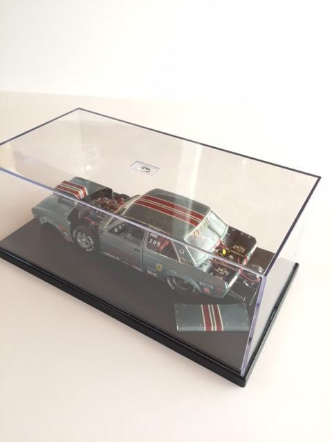

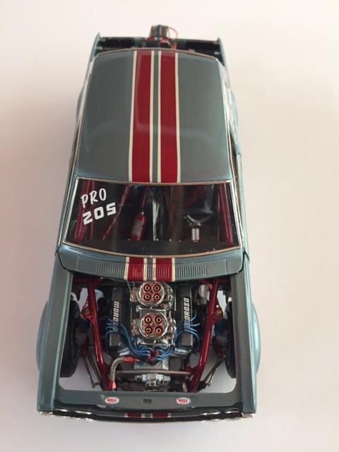

LeadFred Posted October 4, 2016 Author Share Posted October 4, 2016 Dave,Scott,Tyrone,john and Art, Thank you guys,your words means a lot. It is time to uppload the completed build,and of course,if you want to ask something or see a picture of some details that are blurry on some picture,i will try to uppload a better picture. And also again,thank you all,for watching this build,maybe you could use it as a guide,or just inspiration. We all want to build better models and this forum is a very great source. My competition is primarily against myself,but if i visit a modelshow and takes a trophy,it´s a bonus. I have also done a list of what i have used for this build, and if you like to read it or not ?,after the list comes the completed pictures. The original kit: Revell 1/25 Datsun 510 Used from kit: Body, firewall, only two halves without the transmission tunnel, floor,glass, upper dash, Door panel (inside) headlight lenses. Cardan tunnel: Scratchbuilt of a ballpoint pen. Hood scoop: Competition resin. Rivets on scoop: Model factory hiro. Headlight reflectors: scratchbuilt of metal rivets for clothes. Paint: Zero-paints Body Color: Aston Martin Celeste blue. Stripe Color: Aston Martin Toro red. Bolts,Nuts,washers: Scale hardware and RB-motion. Wheeliebar: RB-motion stainless tube, Evergreen rod. Wheeliebar Photo etch: Machine aluminum specialties. Wheeliebar WHEELS: Scratchbuilt. A/N fittings: RB-Motion Carburator linkage: Model car garage. Seatbelt hardware: Model car garage Seatbelt: Tamiya masking tape. Gauges: Model car garage. Nitous bottle with photo etch: Detail master. Nitrous pump: Scratchbuilt Fire extinguisher: Detail master. Seat: Revell Firebird Pro Stock. Pedals: Futurattraction Fuelfilter bracket: Machine aluminum specialties. Ignition wire and battery cable: Detail master. Wire looms: Pro tech. Braided line: Pro tech. Fan: Pro tech. Rollcage: Scratchbuilt of Evergreen rod. Wheeltubs: Scratchbuilt of Evergreen platic sheets. Trunk floor: Scratchbuilt of Evergreen plastic sheets. Tube chassis: Scratchbuilt of Evergreen rod. Chassis tabs: Dirt modeler Rack and pinion: Scratchbuilt 4-Link plates: Futurattraction Rod ends: RB-Motion. Brakes: Futurattraction Front struts: Futurattraction Headers: Scratchbilt of Evergreen rod, Painted with Alclad Chrome. Engine:351 Cleveland/lenco transmission : Futurattraction Pulleys: Scratchbuilt. Radiator: scratchbuilt. Hinges: scratchbuilt. (Made of rod ends and pins.) Rear end springs: scratchbuilt in aluminum. Checker floor plate: Aber Electronic boxes: SMBC Knobs on dash: Model factory hiro. Decals: Slixx Rear tires: Competition resin Front tires: Revell Jungle Jim Vega F/C Front rims: competition resin,painted with Alclad and Humbrol grey. Center cap: Scratchbuilt. Rear rims: Competition resin,painted with Alclad. Rear panel: cast in clear and replaced. Chute: Revell Vega F/C Chute bracket: Scratchbuilt of Evergreen plastic. Fuel cell: Scratchbuilt of plastic. Batteries: Revell Olds Pro stock, (separated) Fuel filter/fuelpump: scratchbuilt. Battery harware: Detail master. The painted wheeliebar. Scratchbuilt wheels and some Hardware. Sorry guys,i have forgot to assamble the cardan axle,.....i will... Ok guys, this is it ! I ´m just wondering what build i will do next?? any suggests ? And comments are welcome. Fred. Quote Link to comment Share on other sites More sharing options...
