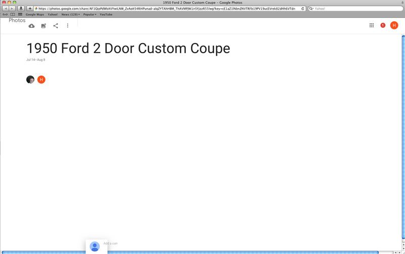

see the google album below
satin slipper
