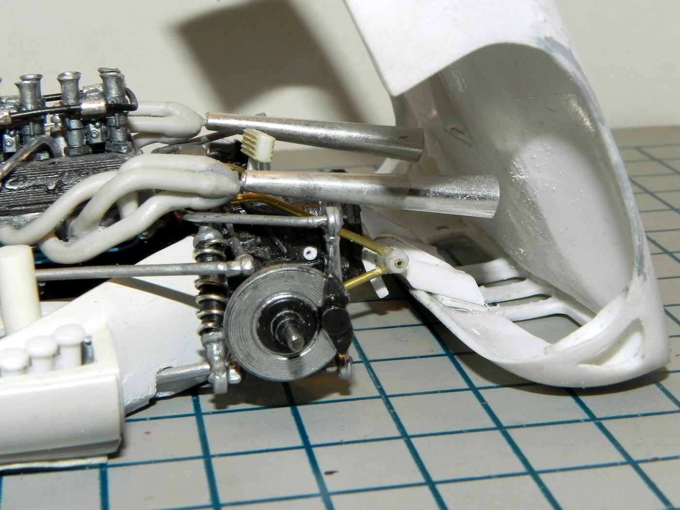

Phildaupho Posted November 5, 2016 Author Share Posted November 5, 2016 I lost count how many times I removed and re-installed the engine/transaxle assembly coming up with an engine cover tilt and support arrangement. I am surprised the suspension struts survived so much abuse but will likely require pinning before final assembly. Certainly the engine/transaxle assembly will need touch up from all the handling. I had to cut 3mm from the MPC Eagle headers to lower them and bring them closer to the engine so they will fit under the engine cover. A friend found the “megaphone” pipes in a craft store. They are made from rolled aluminum sheet. He also gave me some made of brass. I also came up with the rest of the engine compartment ancillaries like oil coolers for the engine and transaxle, a cooling system over-flow tank, fuel transfer pumps and reservoir. Quote Link to comment Share on other sites More sharing options...

RancheroSteve Posted November 5, 2016 Share Posted November 5, 2016 It's really starting to come to life, Phil!Makes sense that the header fit would be tight - I think the bumps on the engine cover (later opened up as scoops) were originally for clearance. Quote Link to comment Share on other sites More sharing options...

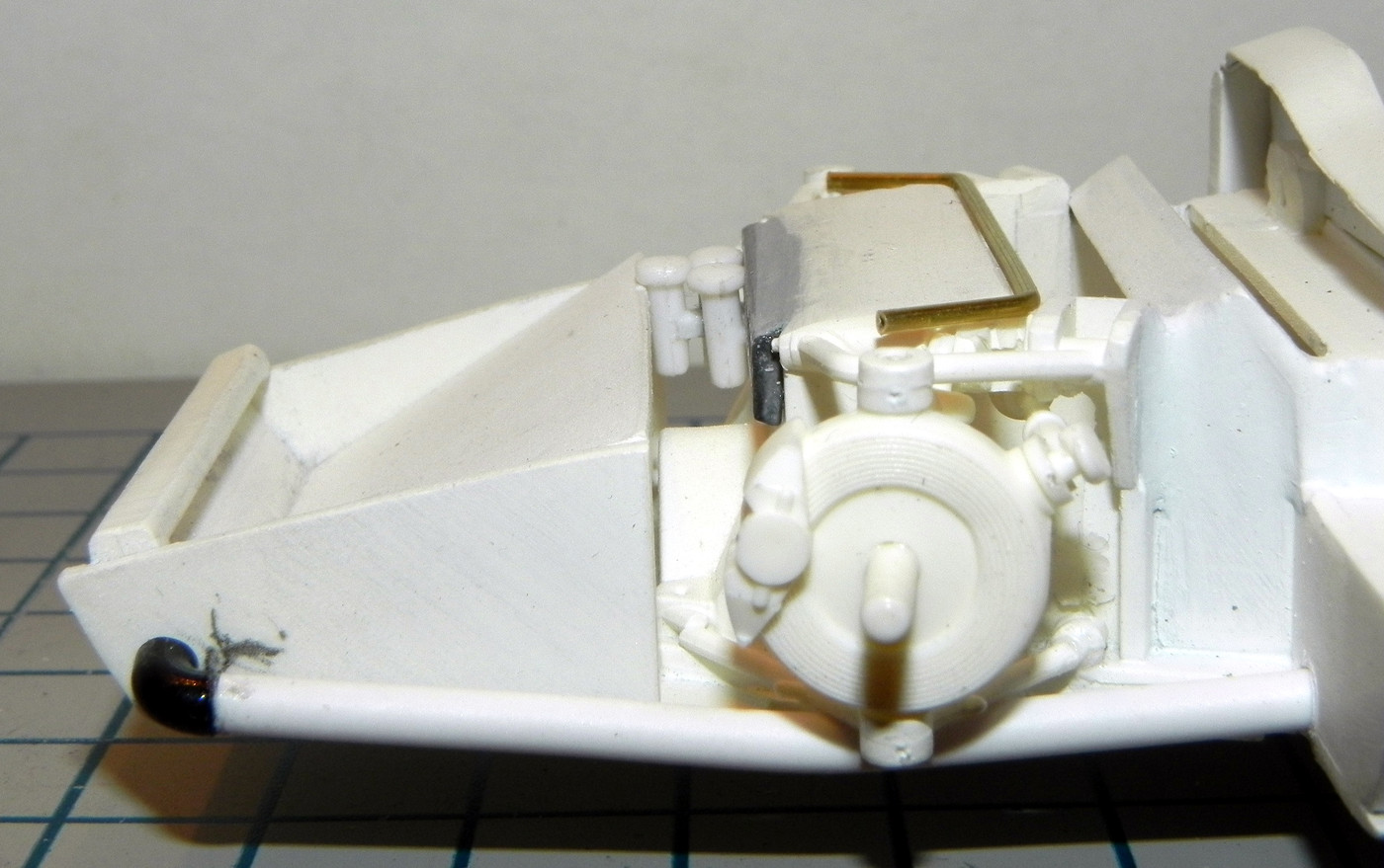

Phildaupho Posted November 12, 2016 Author Share Posted November 12, 2016 I finally got around to paying some attention to the front end of the Lola. Although once fully completed the front section of the body will likely not be removed but I want what is under the skin to at least resemble what would be seen on a 1/1 Lola and plan to photograph it before the body is installed. The Lola front suspension and steering system differs from the Ford GT-40 in that the Lola has front mounted brake calibers and the steering rack is to the rear. I added some extra detail to the front bulkhead, an upper sway-bar and water lines back from the radiator. Quote Link to comment Share on other sites More sharing options...
